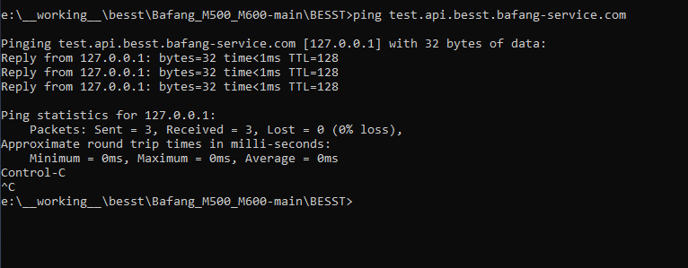

You have a problem with hosts file. Be sure, that your windows hosts file (located in System32/drivers/etc/hosts (not hosts.txt - typical error!!!) must reply to
ping test.api.besst.bafang-service.com with 127.0.0.1 which is localloop, not with bagang IP!
this is how it should look like
I can fix it remotely if you cannot, but it will cost you a beer...just sent me meeting id and i can have a look.
record in hosts file (not hosts.txt, just hosts) should look like this
127.0.0.1 test.api.besst.bafang-service.com
Thanks again for the speedy reply. It has worked! I have realized the mistake. The hosts file was in the right format. But I had the domain set to api.besst.bafang-service.com instead of test.api.besst.bafang-service.com... That was suggested in the readme for github.. Also I have tested that before, but when I saw the script wrote 'test.api.besst.bafang-service.com forwards to 139.196.174.48' instead of 'test.api.besst.bafang-service.com forwards to 127.0.0.1' I have changed it back to how it was, assuming the IP was of the real server and not the localhost.. Mystery solved!

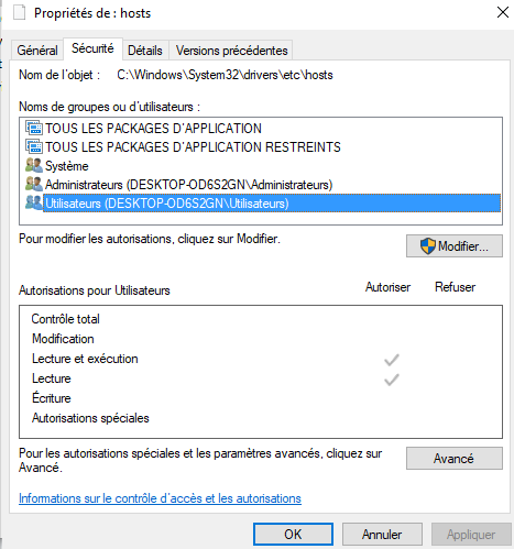

true with the password delivred by bafang i'm very limmited in functional use of BESSTtool. I have tried to follow the tuto
- install PYTON custom made => OK
- command prompt in admin => OK
- pip install simplejson =< OK
- edit (wordpad) “C:\Windows\System32\drivers\etc\hosts => Ok
- insert 127.0.0.1 test.api.besst.bafang-service.com => OK
But i can't register the modifcations, the file haven't right in write (window10) ? how i can do to open it in "administrator" who have the right to write ?
You can't edit it in that folder, but you can edit it elsewhere. Just move the file to your desktop, edit it and then move it back. This worked for me on Windows 10
OK, i will try. I hate computer science. i purchase an object who i don't have any control.
Well done. thanks. i pass the step register file "hosts".
