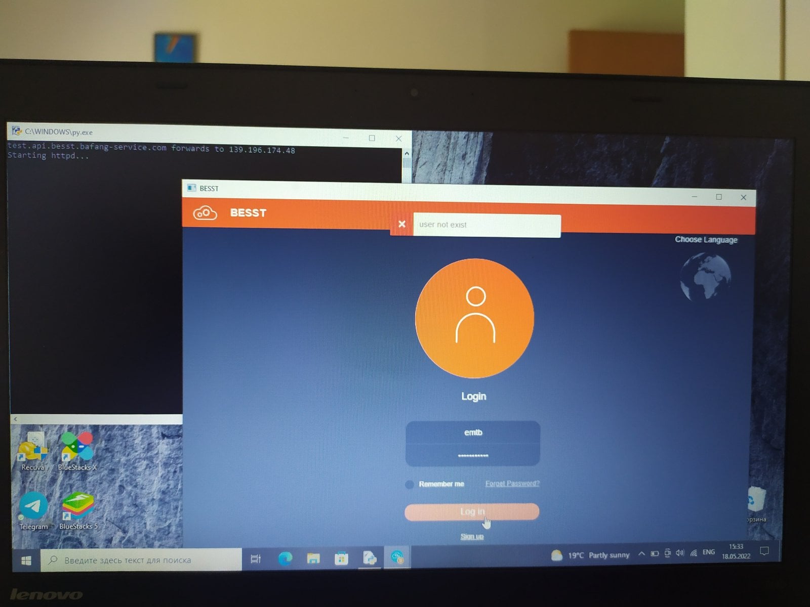

I used the latest patch presented in this thread, I am also using an older version 1.2.18, what am I doing wrong? Maybe I need to use the latest version of the program to work correctly? but I have heard that most works with version 1.2.18, and with it there is no problem

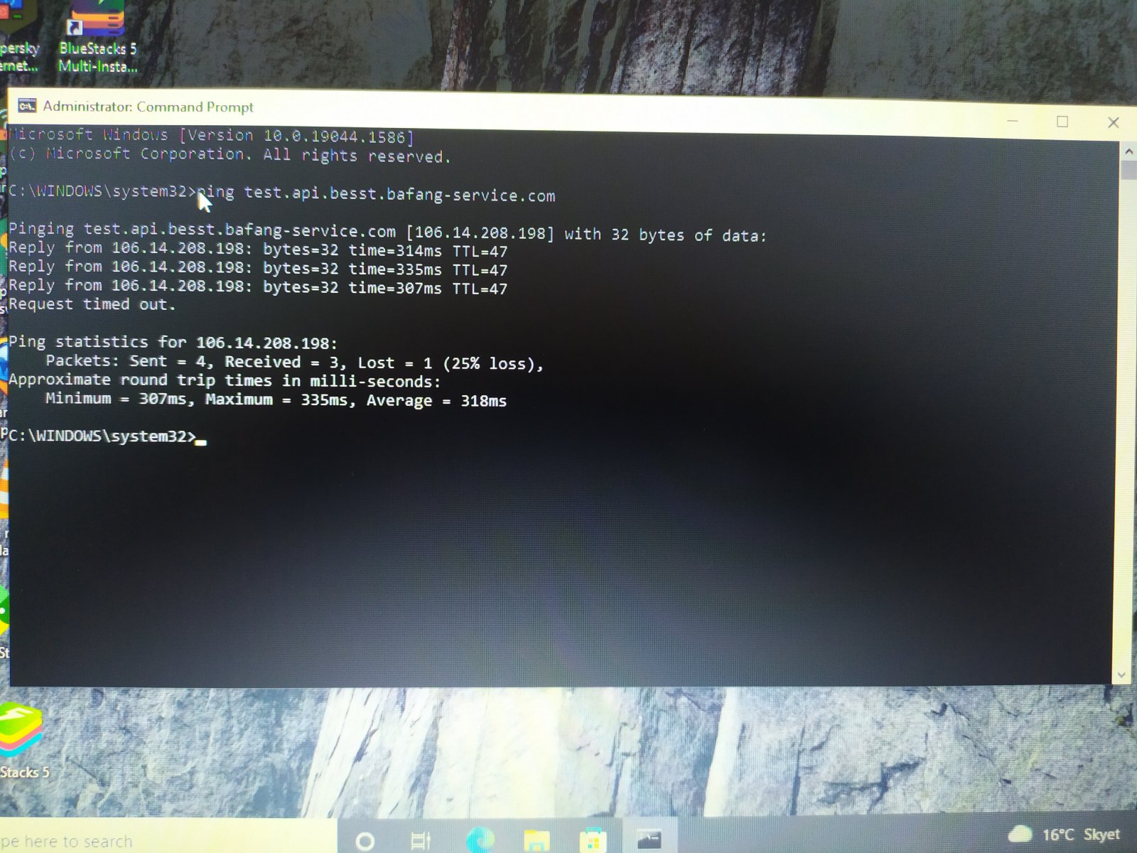

Without digging into this (I haven't run this but am aware of the process and networking etc) - your background command line window seems to be resolving the bafang host externally instead of to your localhost... which is kind of the point of the 'bypass' to work..

You are not following step by step plan, so concerns about your ability to flash are correct.
If on windows, enter into command line command cmd.exe, white window will open. there insert command
ping test.api.besst.bafang-service.com and share result

I did as you said and this is what I got

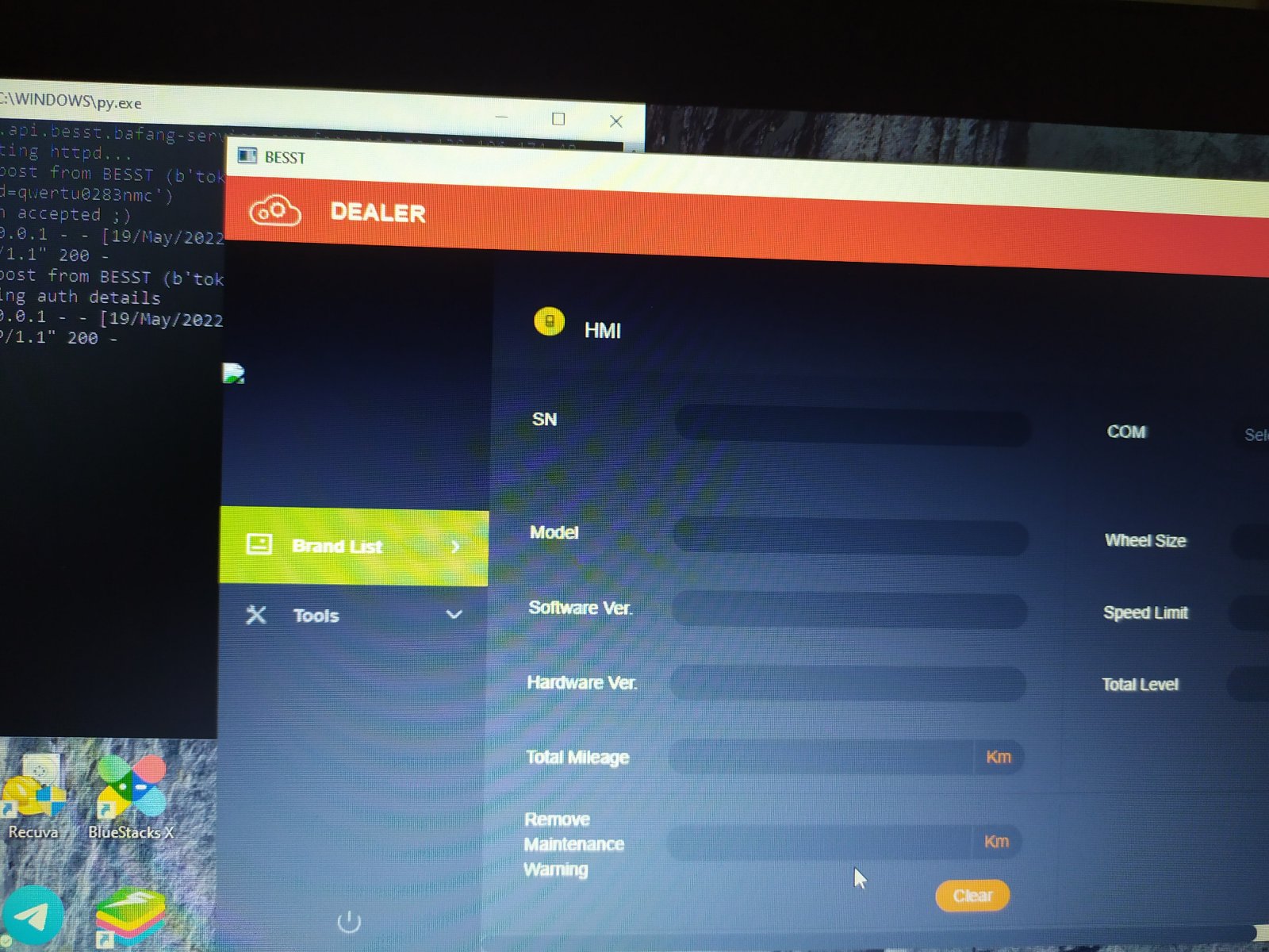

More thanks to everyone for the help, I saw my mistake after my last post, I fixed everything and it worked😅, have a nice weekend everyone 😉

You have a problem with hosts file. Be sure, that your windows hosts file (located in System32/drivers/etc/hosts (not hosts.txt - typical error!!!) must reply to
ping test.api.besst.bafang-service.com with 127.0.0.1 which is localloop, not with bagang IP!

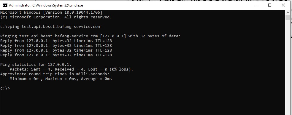

this is how it should look like
I can fix it remotely if you cannot, but it will cost you a beer...just sent me meeting id and i can have a look.
record in hosts file (not hosts.txt, just hosts) should look like this
127.0.0.1 test.api.besst.bafang-service.com
