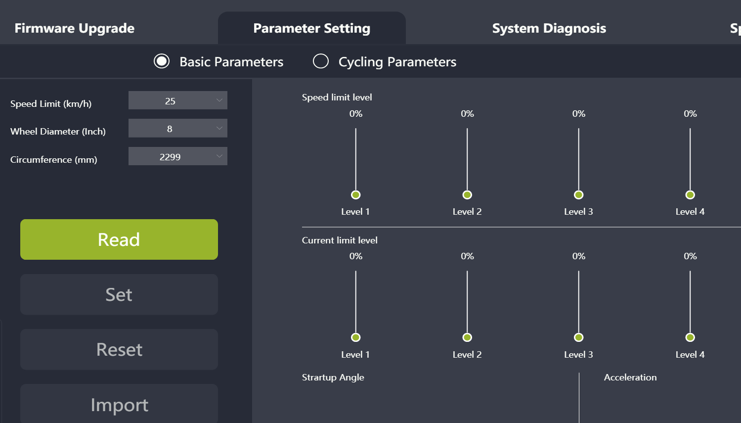

I would like to know why I can't read my paprameter with besst tool pro?
I have a error message
thanks for your help

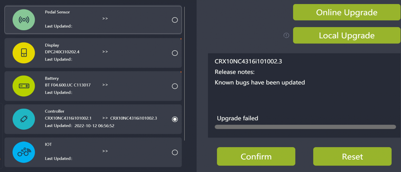

I would like to update my firmware but I have a failed message after the sound of besst tool
why?
Slaine, as far as I'm aware the M600 firmware is not useable with the BEEST Pro. Only the later revisions of the M510. If you wish to upgrade the Firmware then you will have to use only the original BEEST software.
