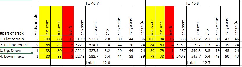

I made some pictures yesterday on my short test circle with different profile to see/compare battery gain on older fw. Today i will recharge/flash my own bike and repeat exercise and compare. Will try to report today evening.

4) generally speaking = from table below consumtion looks bad on steep uphill, but eco-flat terain is better. Should be confirmed on longer track with exact conditions...
Notes:
track is divided into 4 sections:
1) flat- slow uphill - +50m PAS5
2) steep uphill + 250m PAS9
3) up/down - flow PAS1
4) down- flow PAS1 - normally i am doing this with 0, but for testing i left it on 1
all values are in kilometers (special for british folks)

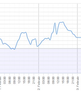

Note the very flat voltage discharge curve of a Lithium battery at lower temps below and you can see why it is very very very difficult to use only voltage as a comparison.
