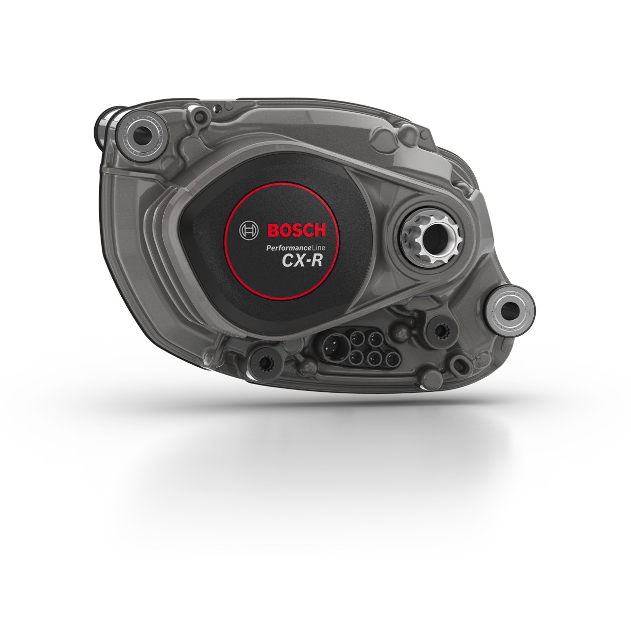

Bosch · Performance Line CX Race Limited Edition (BDU376Y)
Performance Line CX-R
Bosch's 2022 race-only twist on the Gen 4 CX platform: the same 85 Nm and 600 W as the standard motor, but with an exclusive Race mode dialling support to 400% and pushing usable power to far higher cadences. Built for UCI E-MTB starting grids, not extra torque.
Performance Line CX-R eMTB motor
Bosch Performance Line CX Race Limited Edition (BDU376Y) drive unit, official Bosch press image
0250500406080100120600 Wcadence (rpm) →power (W)
Builds quickly to a broad ~600 W plateau around 75-90 rpm, then, unlike the standard CX, Race mode keeps it pulling strongly past 110 rpm before tapering. No dyno exists for the CX-R itself; as a real-world anchor, independent tests of the standard Gen 4 CX it's based on have measured a peak in the 600 W region, in line with Bosch's claim, which is the curve replicated here with the Race-mode high-cadence extension added.
The verdict
Bosch Performance Line CX-R is best understood as what it officially was at launch in September 2022: the Performance Line CX Race Limited Edition (motor code BDU376Y), a tuned variant of the familiar Gen 4 CX hardware aimed squarely at competition. The headline figures don't change from the standard unit, 85 Nm of torque and 600 W of peak power, because the differences live in the firmware and the trim, not the gearbox.
What you actually get is an exclusive Race mode that lifts support from the standard 340% to 400%, removes the gentle start-up ramp for an instant hit of assistance, and keeps power on tap at extreme cadences, up to 120 rpm or more, where the regular CX has begun to back off. Extended Boost is pushed as far as UCI rules allow, so the motor keeps shoving for a beat after you stop pedalling. Bosch also shaved roughly 150 g from the casing, quoting a bare drive-unit weight of 2.75 kg, and added red accents and remote LEDs so you know Race mode is live.
Honest caveat: there is no independent dyno of the CX-R specifically, ebike-lab never logged this variant, so the 600 W here is Bosch's own peak-power claim and the curve below is the well-documented Gen 4 CX shape with the Race-mode high-cadence extension layered on. If you want more torque or more peak watts, this isn't it. That story belongs to the 2025 Gen 5 CX-R, and it's worth being precise about what that is: the Gen 5 CX-R launched in May 2025 at 100 Nm / 750 W, and crucially it is the same Gen 5 CX hardware in race trim, not a wholly different engine. Bosch made the point itself by pushing standard Gen 5 CX motors to that same 100 Nm / 750 W through a free over-the-air update a couple of months later. The 120 Nm figure people now quote for the family is a separate, later step (Performance Upgrade 2.0, May 2026), which lifts torque to 120 Nm and support to 600% while peak power stays at 750 W. That is exactly the firmware-not-hardware logic this 2022 motor lives by, one generation on. This Gen 4 unit is the same engine as the standard Gen 4 CX, with the gloves off.
