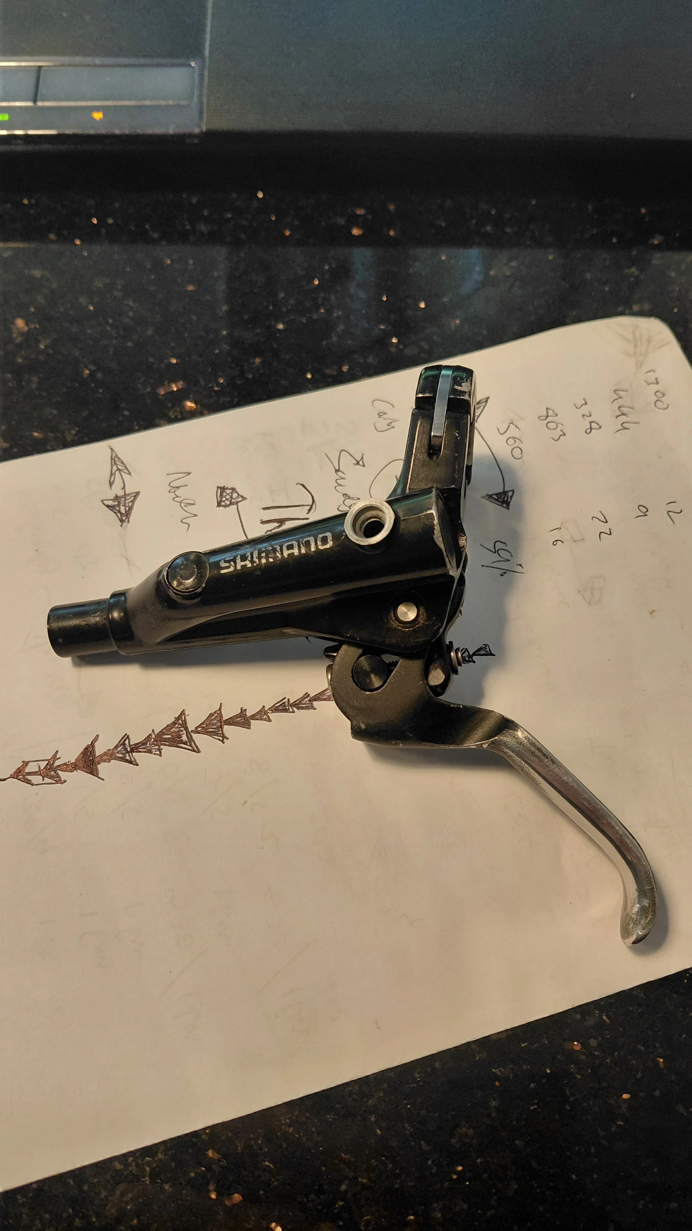

Rebuilt the leaking lever, now ready to go back on the bike for another 7000 miles. Definitely one of the more fiddly jobs I've done, refitting the lever spring took three you tube tutorials & two hours, most of which was spent looking for the spring.

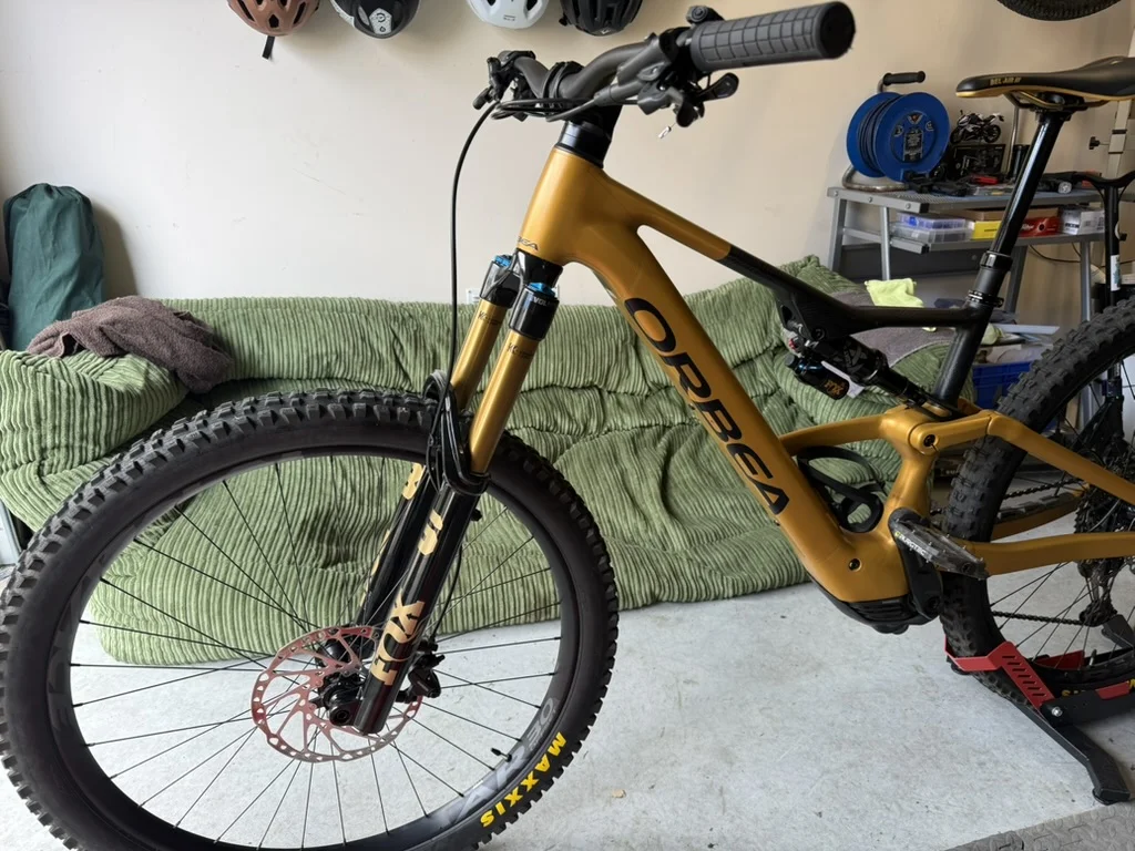

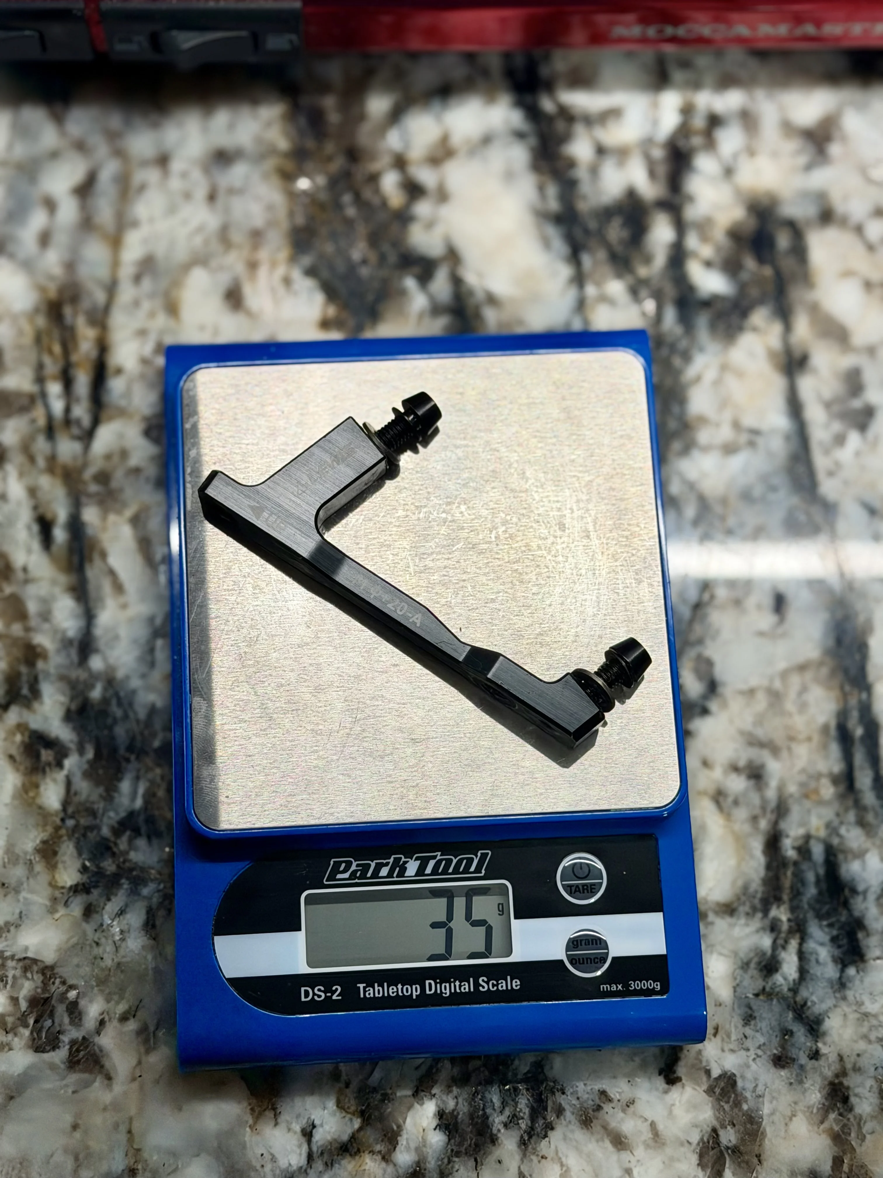

Ever since upsizing my Lewis rotors from 200 to 220 front and rear, I’ve been dealing with noisy brakes in the rear. I’m so far down the road of finding a permanent solution, that I’m putting back on the 200mm rear rotor; if only to confirm a baseline.
While I’ve been impressed with the Lewis LH4 brakes, I haven’t been so much with their rotors. I’ll probably try different rotors, but putting back on the 200 rear rotor will be a good test for now.
I will say-when I run the 220 rear rotor I need to use a +20 spacer on the caliper. I can’t help but ponder the caliper spacer factoring into the creation of the resonance (howl). 🤔 Caliper bolts right to the frame with the 200 rotor.
Saved 35g in unsprung weight. 😐
All I can say is that we have Swissstop Catalyst Pro 220 rotors front and rear now with Swissstop D27 RS pads but previously with Shimano D03S pads, never had any noise issues with either. Only switched to D27 pads because they last longer. I know that's no help to you.
Try a thicker disc, it will vibrate at a different frequency, so it will not respond to the particular set of circumstances that, on your bike, is causing your current disc to vibrate.

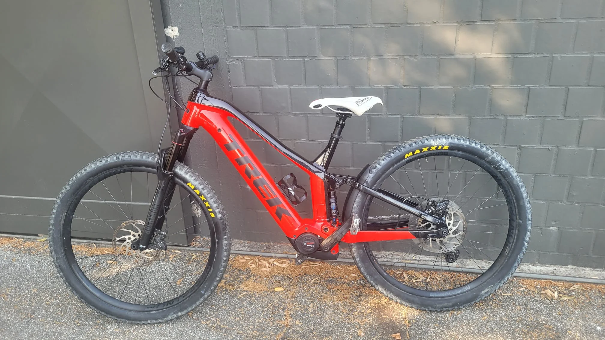

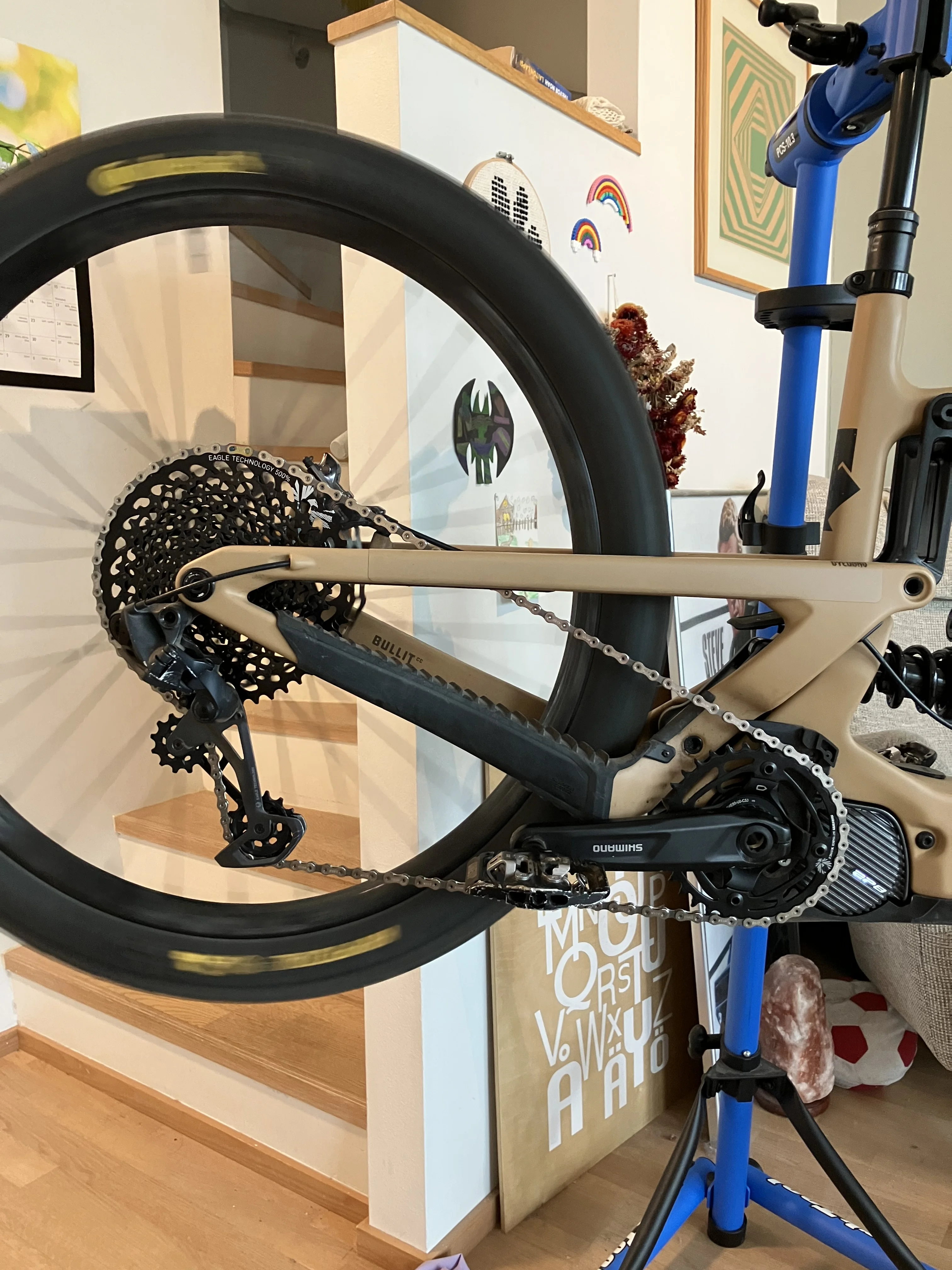

Today I changed the two complete drivetrains on our Trek Rails
- Chain
- Cassette
- Front chain ring
- RD jockey wheels
My Trek Rail 9.7 was very overdue : I still had the original chain since purchase fitted, over 2 years ago and 1,300 miles later : when I lined up the old chain against the new chain, it was almost a complete link of stretch difference :oops: It explains why shifting was very jumpy 😝
On my sons Rail 5 : Trek did an interesting choice, instead of going for a Microspline hub for his 12 speed, they chose to go with a Shimano HG hub meaning there is only one cassette choice available : a SunRace CSMZ800. This will probably be the only time I'll change the cassette before he outgrows this bike but defo a strange product choice from Trek there!
I don’t think I can go thicker than the 2.2mm that the Lewis is, but I’m thinking to a different rotor design would also deliver a different resonant frequency.
While changing back to the 200 rotor it looked like the 220 rotor might not have been sitting absolutely flush on the hub. I block sanded the hub surface to make sure the 200 rotor was mated 100%.
Did a quick bed-in around the parking lot, and there was no noise. I’m going to do a quick test ride tomorrow morning at Dreamy Draw/Phoenix Mountain Preserve before work, mostly to test a different suspension setup before I head up to Sedona this weekend. I’ll see if the rear brake stops complaining. 🤞🏻
Following up-Rear brakes were dead quiet on m 8 mi test run yesterday. Sedona this weekend will be the big test, but I'm feeling confident.

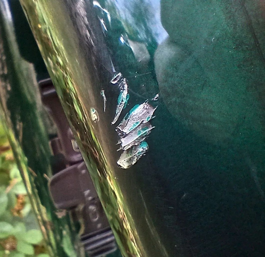

Look what I did to my ebike this week! :eek:
That is the carbon fibre top tube on my frame-wrapped Santa Cruz Vala 90, that I have had less than 5 weeks! Yikes ! :eek:
I was out clearing a trail using my folding saw as a slasher. I returned to my bike, which was leaned on a tree, slashing as I went. As I got close, I did something that caused the bike to start to fall over. I reached out to stop it with my nearest hand. Unfortunately it was the hand holding the saw! From top to bottom in the picture the gouge is about half an inch long. Not sure what I'm going to do with it yet. I'm sort of hoping the framewrap will heal itself, as its proponents are fond of saying. But I think this may be too much of an ask.

I skipped my chain stay off a rock in a fall a while ago. I took off the protective film, wet sanded the area; and reapplied film. Looks a lot better now. The carbon is dark, so it'll look better once you remove all the flaky material and re-wrap it. Good luck.

Ooh, that's not pretty. But at least if you crash it now more scars will matter less.

Ouch! Finger nail paint and 800 grit emery, then 1600 grit.

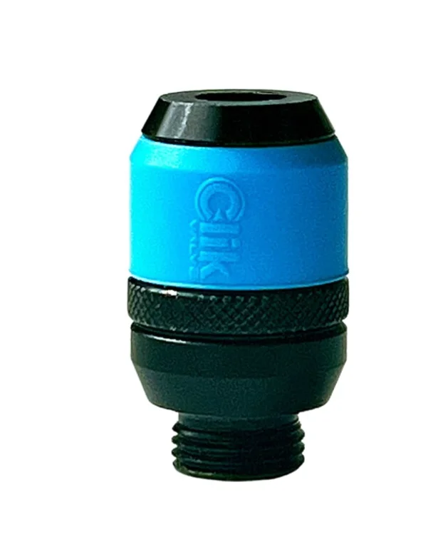

Bought two of these for our Cycplus AS2 PRO tyre pumps directly from the Oz Pumpa website. Screw directly into the pumps so don't have to use the pump to Schrader extension hose included with Cycplus pumps. Pack nicely into our EDC kits with the other get you-home stuff. Took a week to arrive.
Clik Head for Fumpa pumps Clik Head for Fumpa pumps

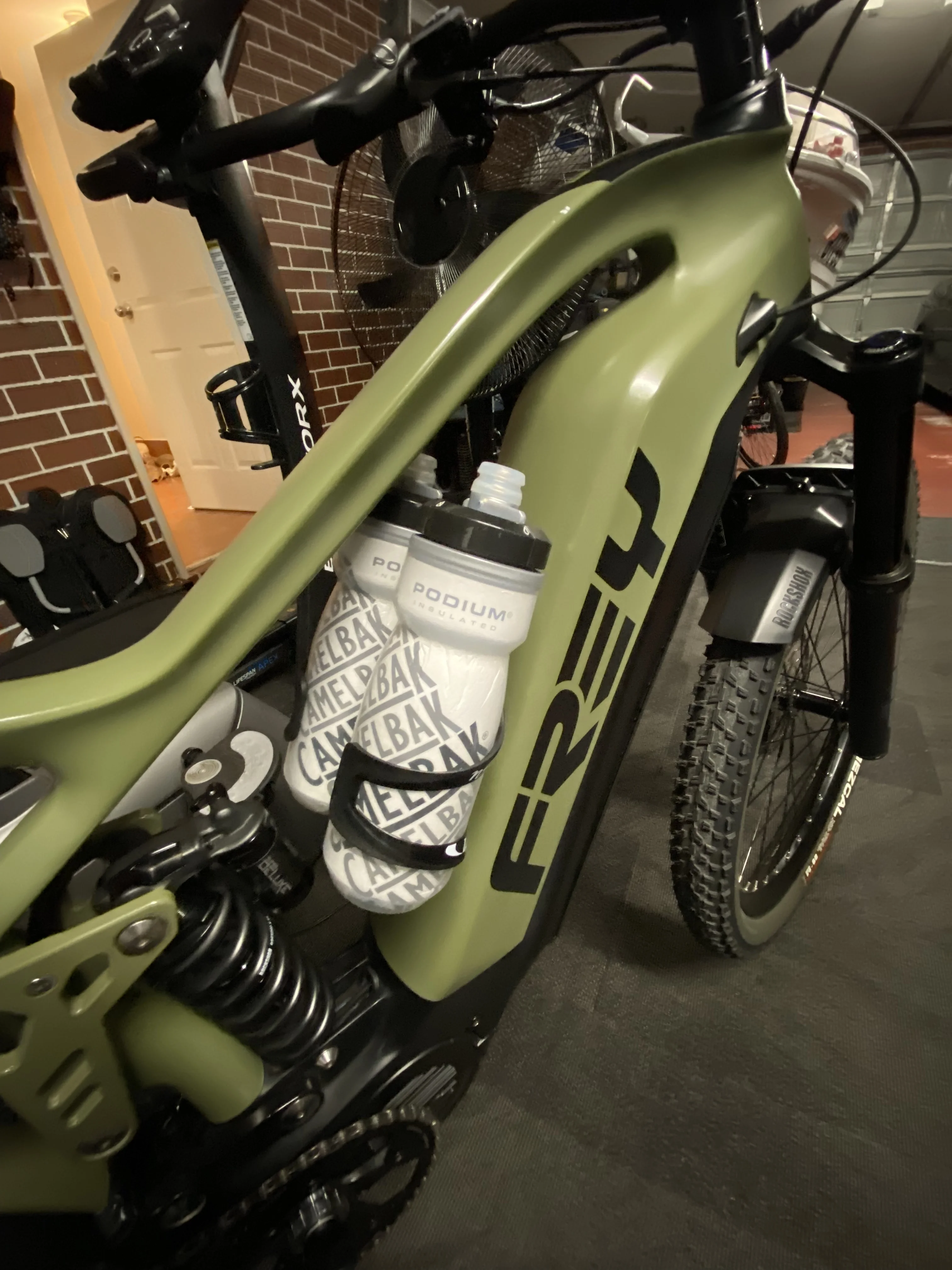

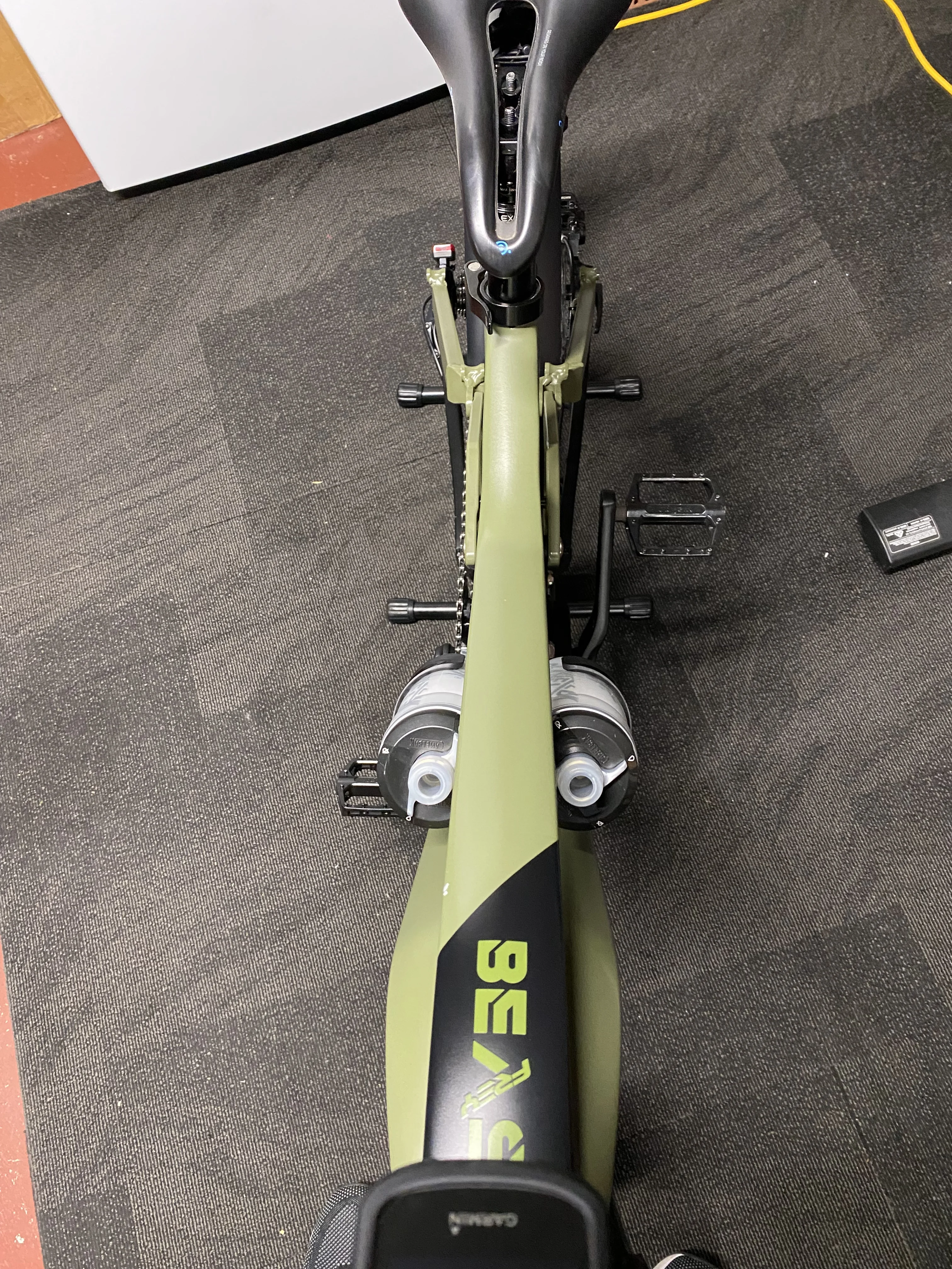

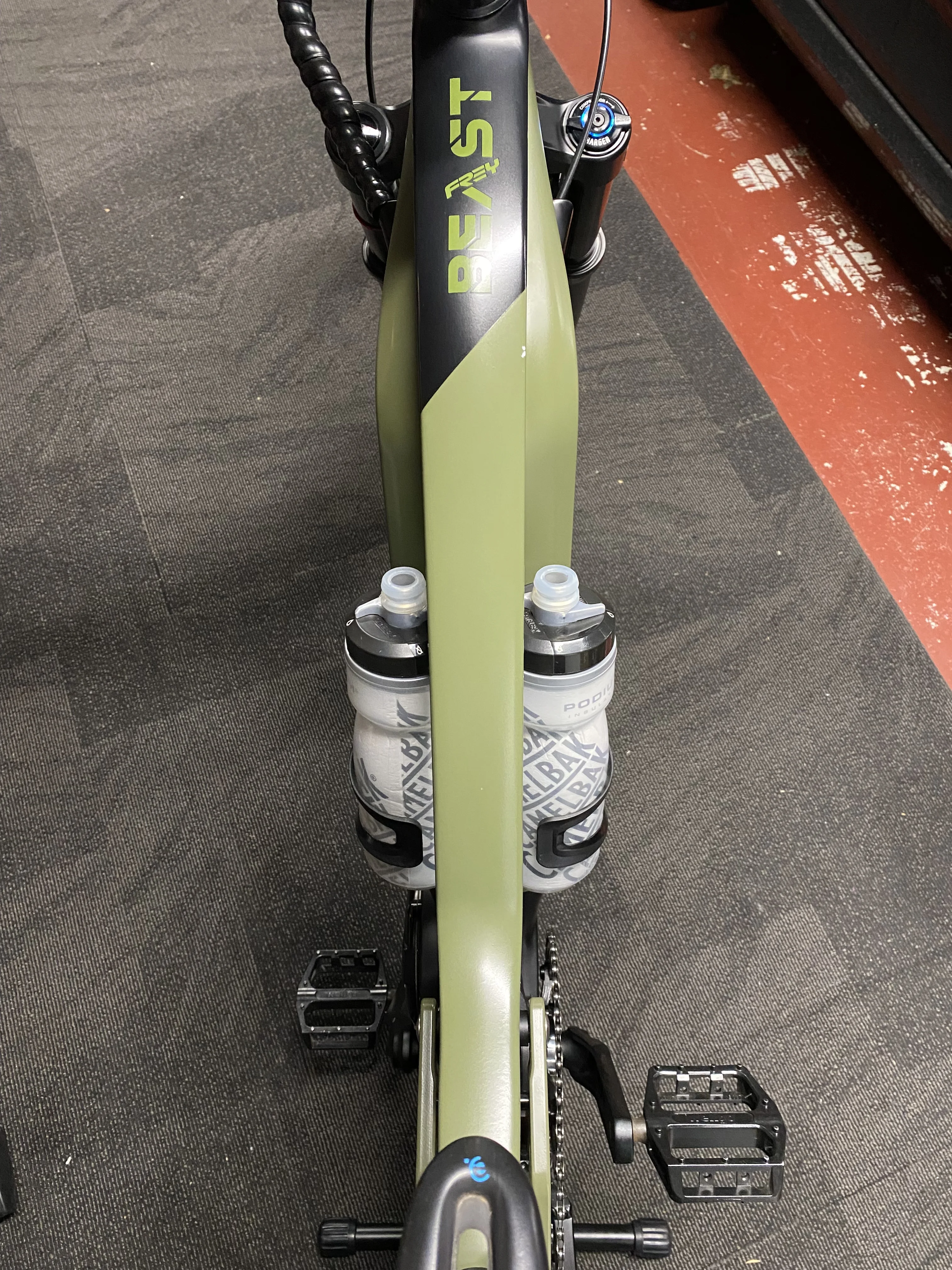

Dont your legs / feet hit them?
Photos are deceptive - the bottles are within the inside of the crank arms. So feet dont hit them and nor do calves/legs. The only time my knees rub them is if i'm standing peddling up a steep incline and moving the bike sideways. Otherwise no issues.
