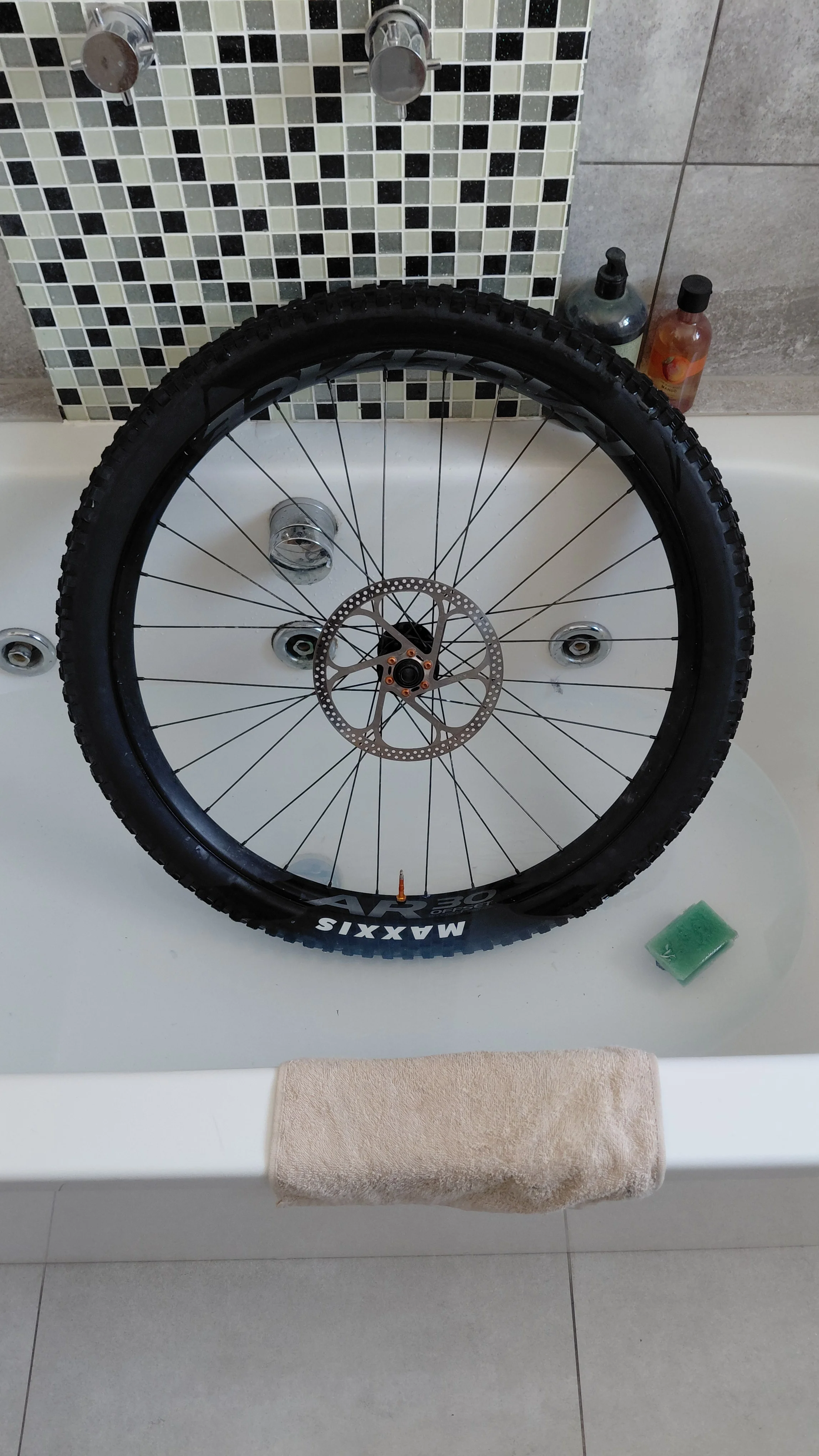

how did you eventually get it?
Soapy water in the end but took five attempts. It's a Race face arc 30 & always been an awkward wheel to work with. Also has an offset valve hole which makes sealing the valve difficult too as it can't sit flush against the rim.
Seen here in the Rusty advanced tyre sealing laboratory test facility.
Right …my snow/winter wheels are Race Face Arc 35. Offset valve hole also. They were a pain to set until I inserted the Cushcore plus. That wasn’t easy.
I used the Cushcore levers (saved my knuckles) and had to chase the bead around several times. Adding air was no problem though …but it was tight.
I've also swapped the rear tyre, that's on a Specialized rim & it went on first try with just a little soap & water. Not all wheels are equal.
the missus has these rims - absolute PITA
I mount the bead to the rim edge with the longest lead in first, then keep blasting it until it gets there
absolutely hate changing the rubber on them
Also the angle of the rim means half of the valve is unsupported
