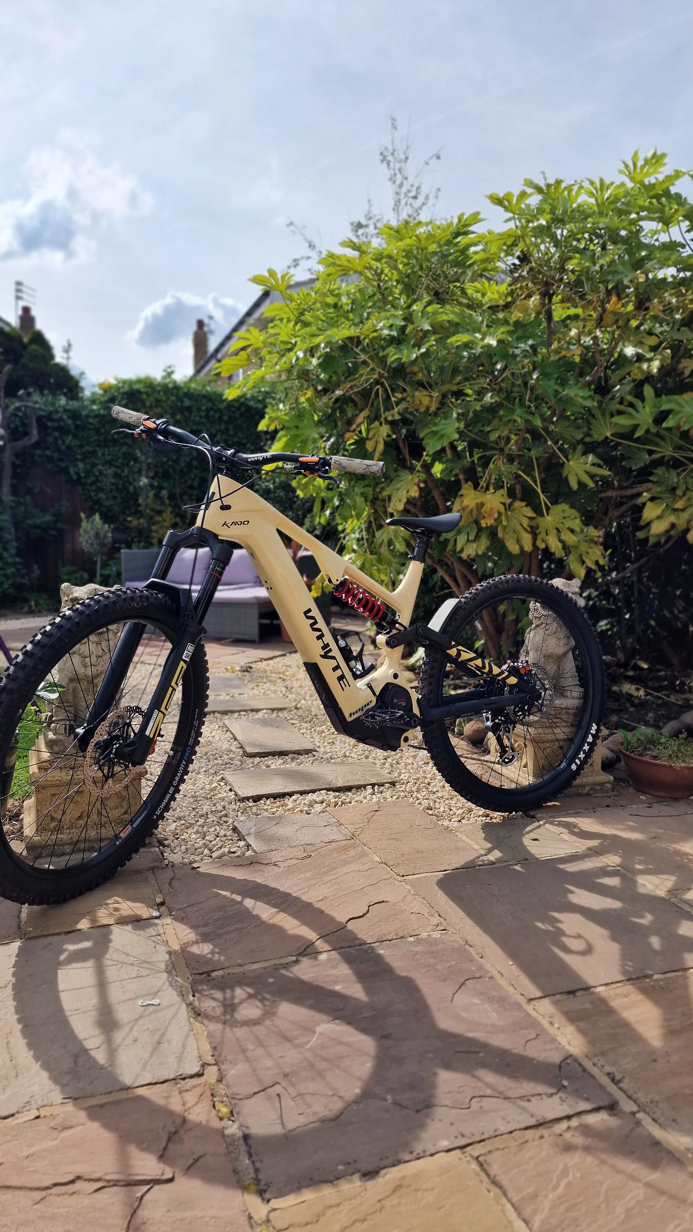

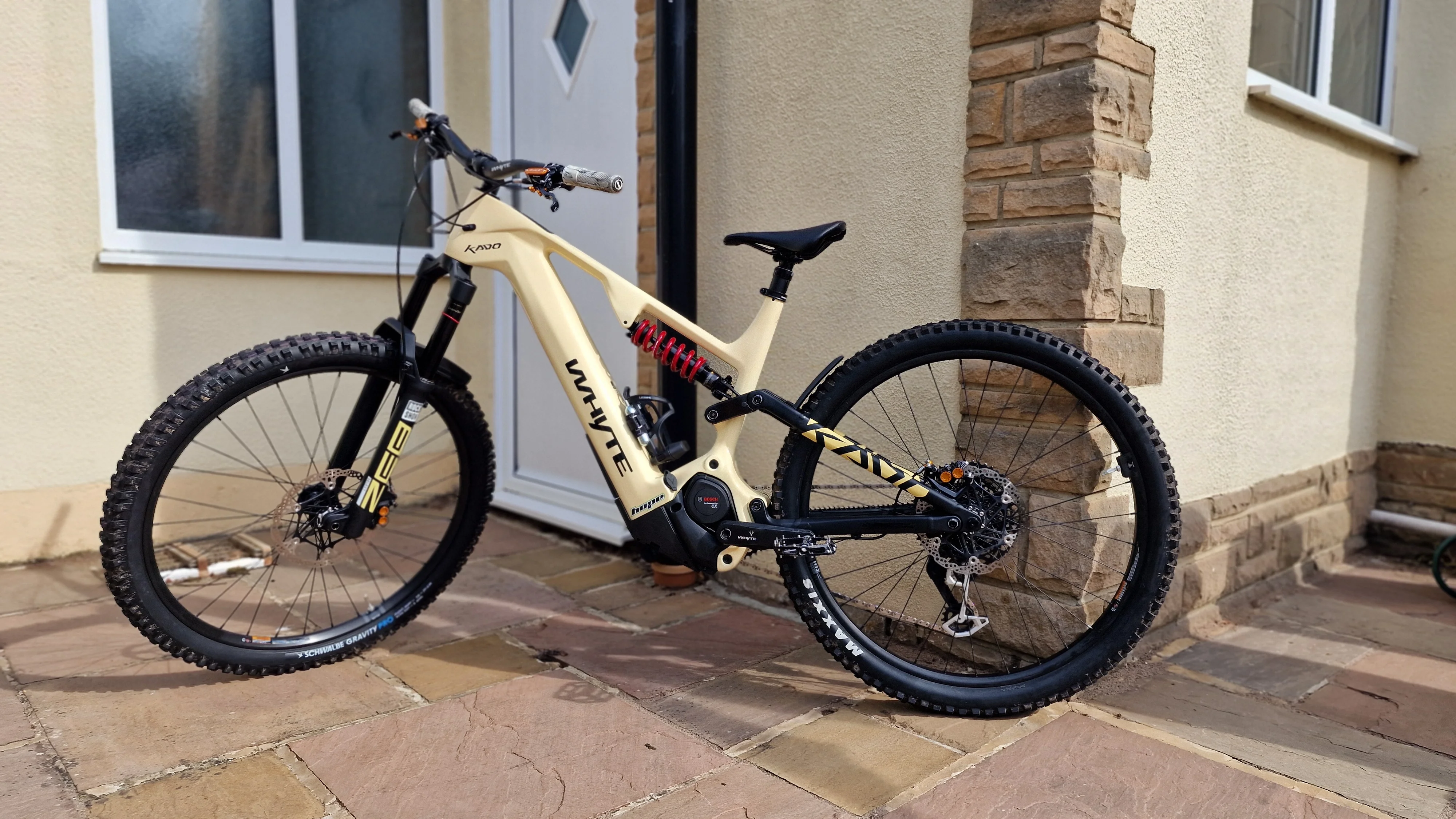

So for any other kado owners out there interested in fitting a coil shock..
You need standard/standard eyelets, 230x62.5mm is too much over stroke to run the flip chip in high, will only run in low, even then the tolerances are eye wateringly tight and generally not safe to run.
230x60mm is too much over stroke to run the flip chip in high and only permits low, and again, tolerances are a potential issue. Approx 4mm between seat tube and rear triangle at full compression which for me, allowing for frame flex under severe bottoming out was still too much of a risk.
230x57.5mm is the safe bet in high and low settings as it's the same stroke as the stock shock.
On kado s you need to run the piggy back at the top tube mount. On kado rs, rsx and works you need to run the piggy back at the shape it link.
In the end I ended up going for a vivid ultimate instead, I had some qc issues with the super deluxe that got delivered.

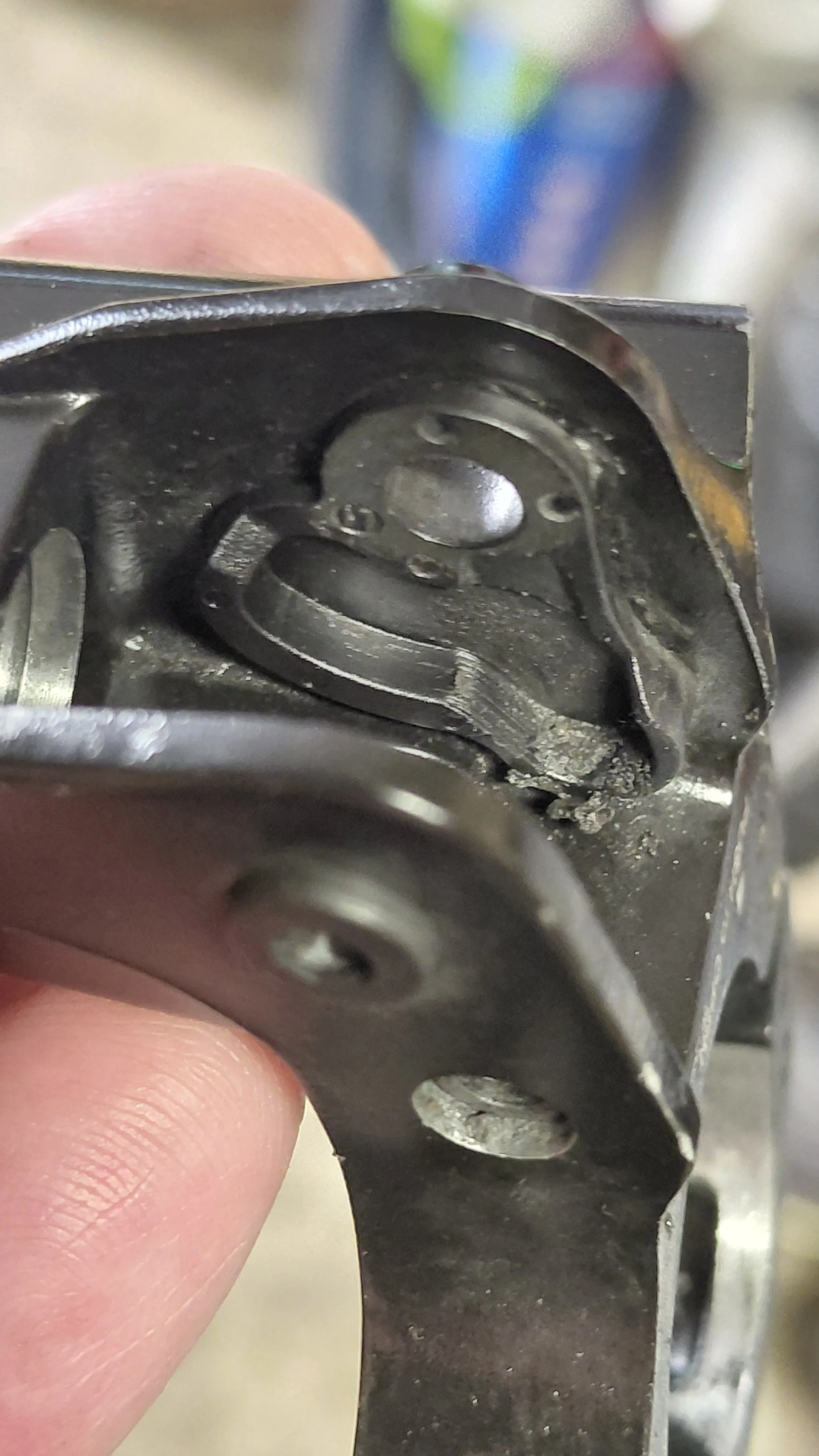

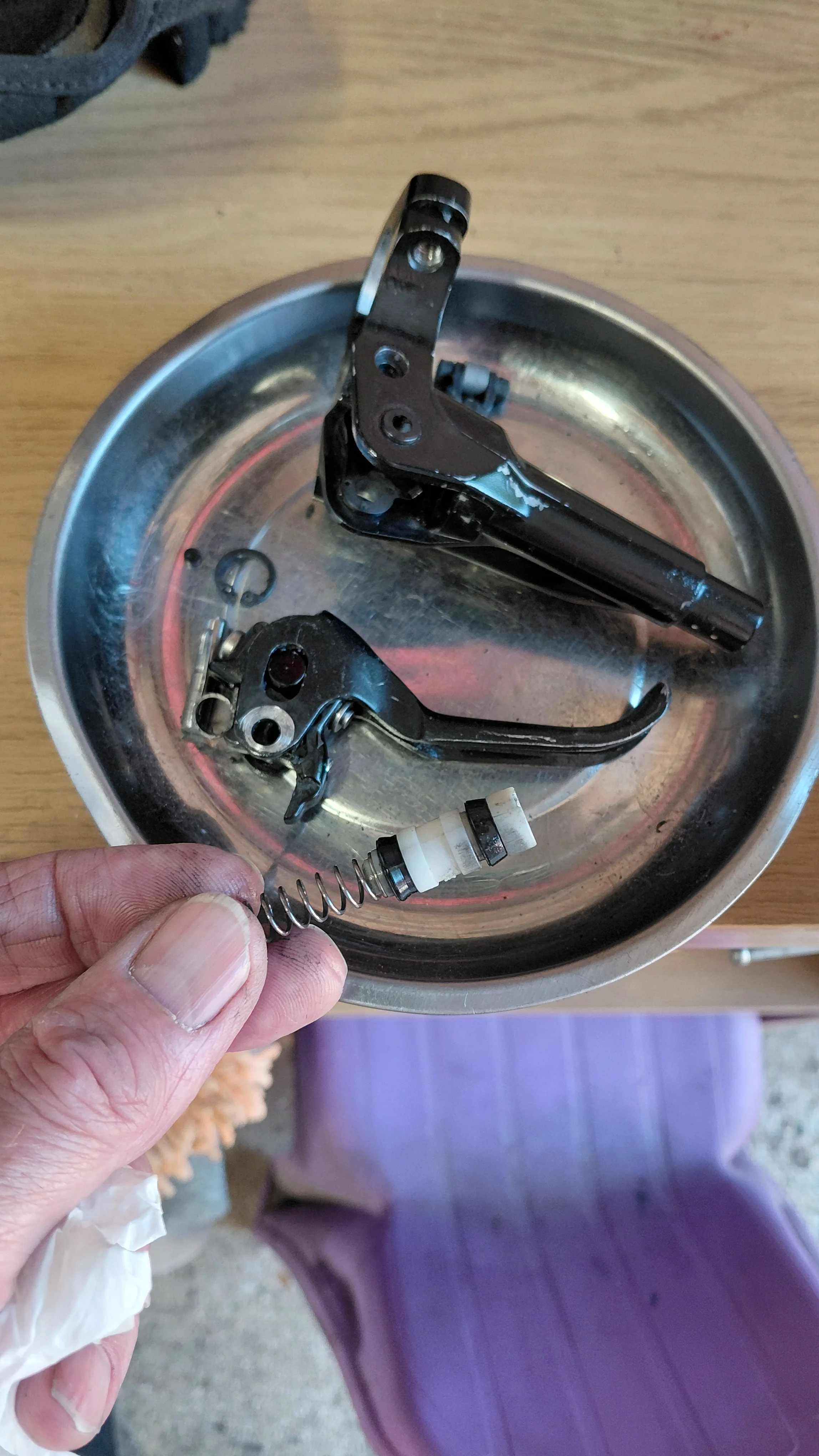

Near disaster today. All set to meet for a ride & my rear brake lever is pulling all the way to the bar. Definitely a seal gone judging by the fluid leaking. Quick rummage through the spares & I find an old slx lever. Slap that on, quick bleed & all good again
K because I can't help myself, I disassembled the lever & can see the leak originates from two apron seals on the piston. Clear that when you pull the lever the u shape seals fill with brake fluid & press against the walls of the bore.

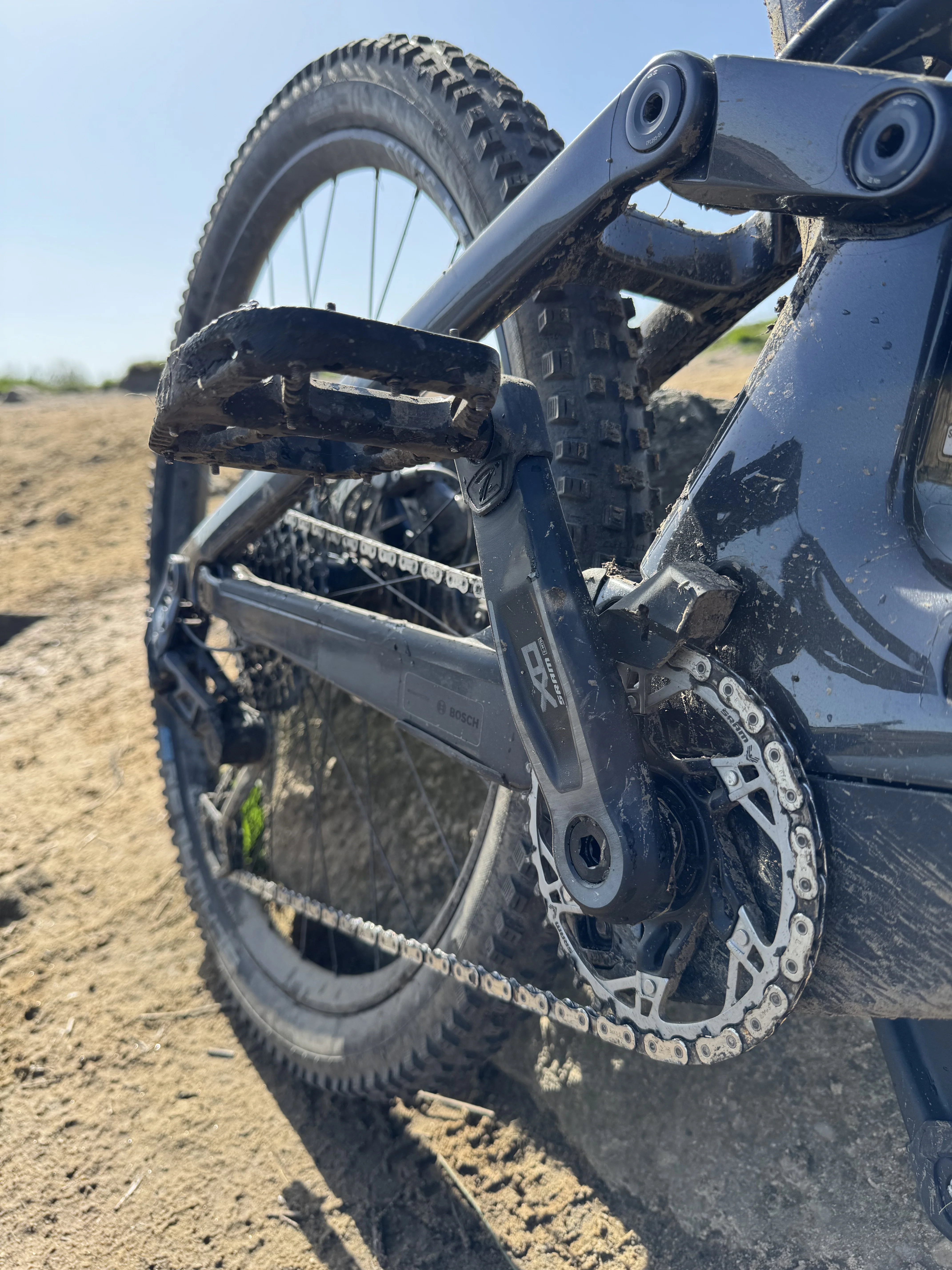

I finally bit the bullet and fitted a set of (on sale)Easton e13 Helix 155mm cranks to my SX powered bike.
3 rides in and loving them as do my pedals. Great upgrade!

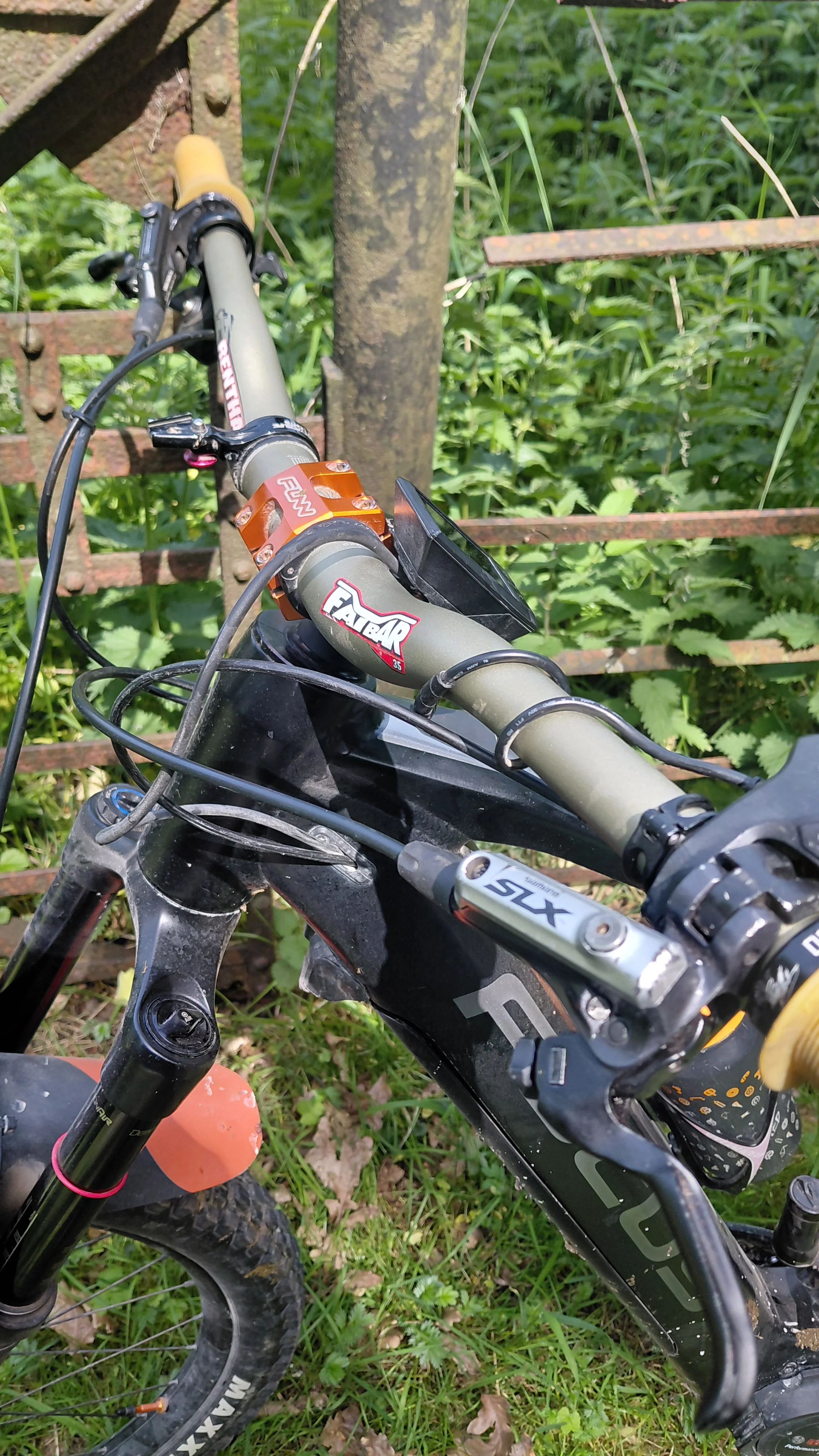

I also bought a Saint front brake expecting a major improvement over the SLX’s but too many riders have said Saints are too grabby and not that more powerful hence I’ll be sending it back for a refund as it’s still in the box unused.
(IIRC) Same size pistons in the caliper.

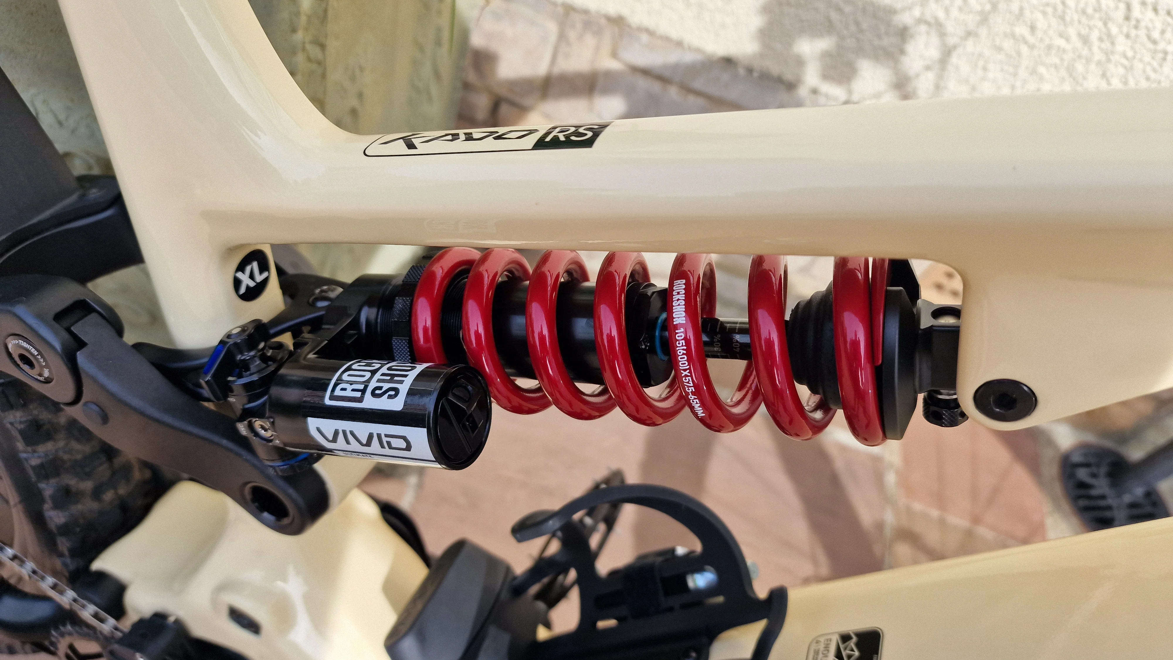

View attachment 185021View attachment 185022
Looks mint 👍🏻 what do you weigh and what lb coil did you get, I’m looking for this same setup on my Kado S 👍🏻
I'm dubious about Shimano claims on their brakes. They call it Servo wave & the idea is that the lever gives an initial bite & with more pressure, a more linear progression but since I have one in pieces you can see how it works.
It amounts to a roller cam attached to an actuator rod running in a track that has a distinct bend so that the initial pull activates braking but to pull further makes the rod & cam travel a longer path i.e. it's doing some of the modulation that should be performed by the rider but that's purely opinion. You can see clearly how it works here.
First ride out on 155mm cranks today from the stock 170mm. Night and day difference for pedal strikes. None suffered on a particularly section of rocky trail which normally has me clipping and striking rocks. No difference in pedal feel that I can tell.

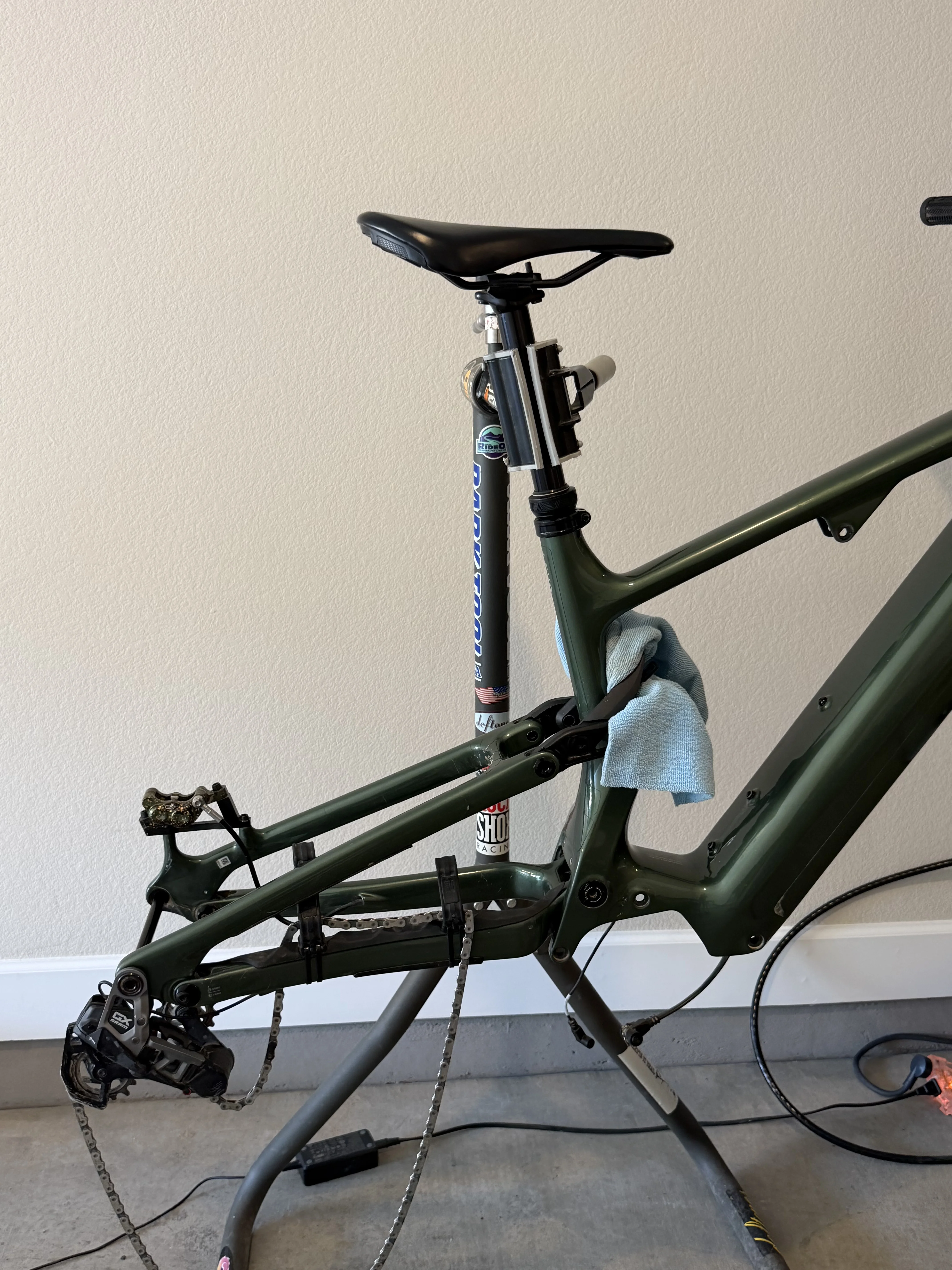

Pulled the shock on the Levo today. Noticed some cables were making noise as the suspension moved through its travel, so I dropped the motor to straighten everything out. Very glad it wasn’t my bearings making the noises.
With the shock in the shop, I’ll probably be playing golf next weekend instead of riding. 😐

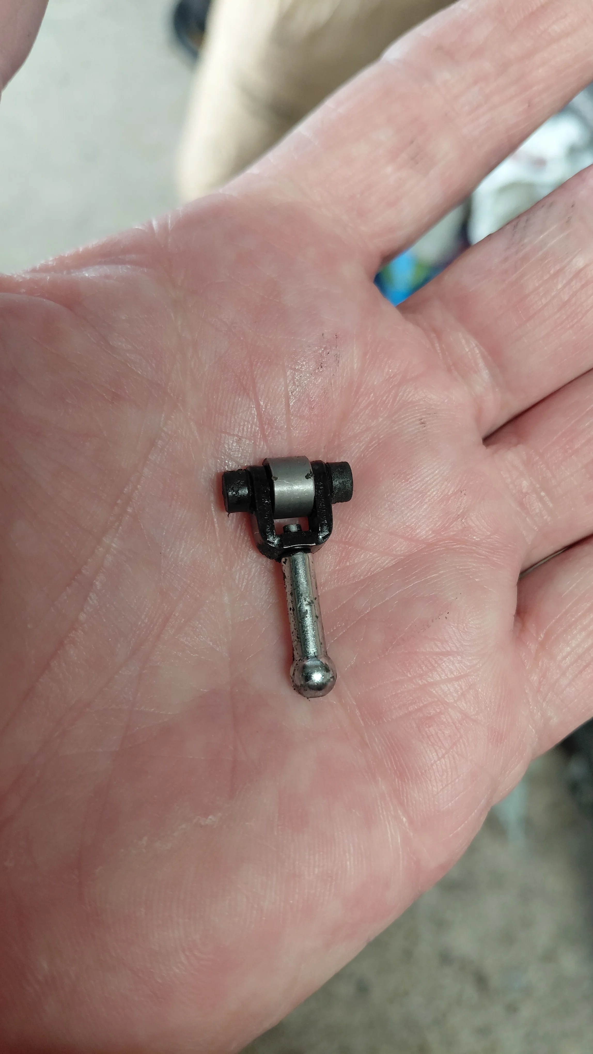

Thats a cool idea. Now do i have any springs????
Hi @VWsurfbum , I can't take any credit, I saw the idea posted on a facebook group.
I used 0.5 mm Wire, 5 mm OD, 10 mm Length
https://www. amazon.co.uk/dp/B0F8VWWGP3?ref=ppx_yo2ov_dt_b_fed_asin_title&th=1
I still have a couple left I could send to you, but it would probably be much quicker to order from Amazon.
