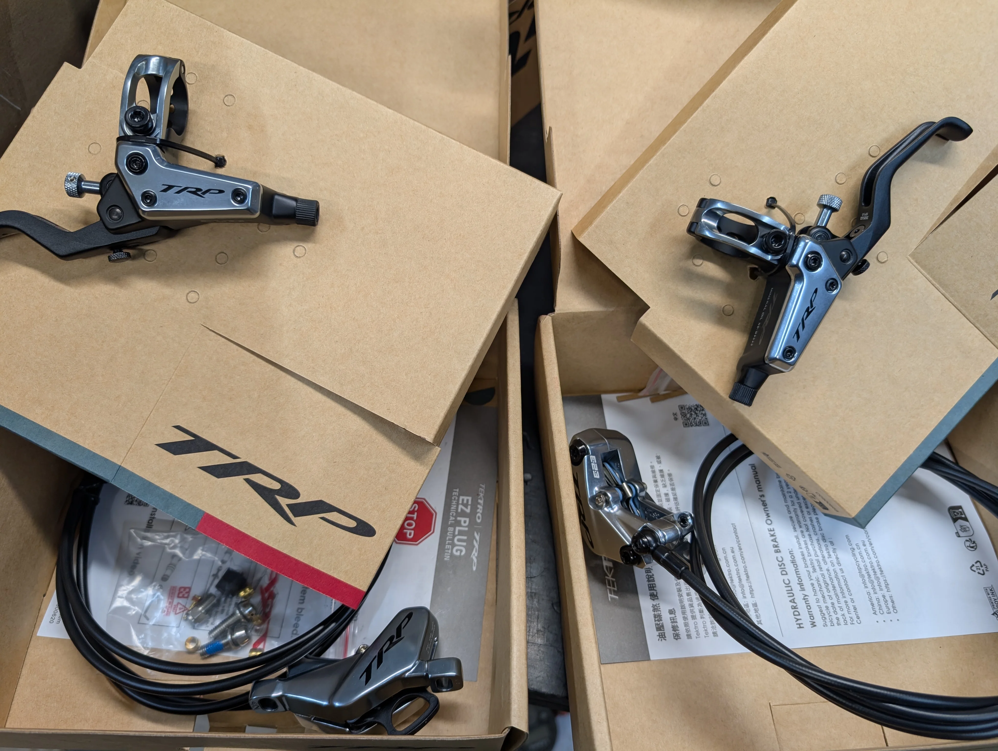

New TRP EVO PRO brakes, I persevered with the MT7's on the Amflow, switched to new pads which made them pretty good but the lever pull weight and total braking power has had me looking elsewhere. Hoping these bad boys are going to make steep gravity trails a bit more confidence inspiring to ride.

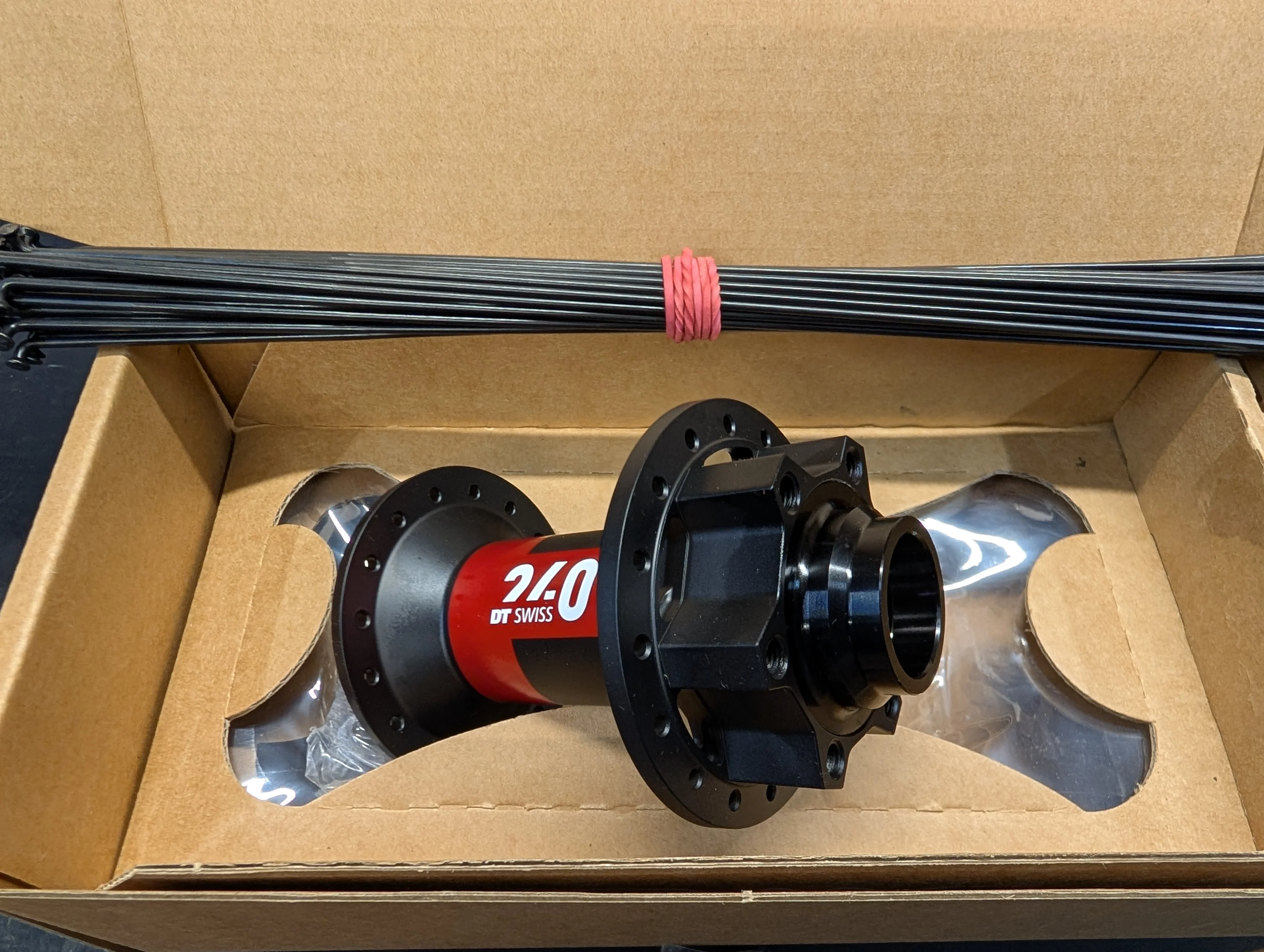

New DT 240 OS (Oversize) and new DT Comps for the Podium fork. The set of carbon wheels I was running had normal DT240 boost which does not accommodate a 20mm axle. Been running a front Nukeproof wheel for a few weeks while waiting on the new hub and spokes, contemplated just ordering a replacement carbon rim and building a new wheel but it will only end up another wheel hanging on the wall.
Remember to make the bedding well and you will immediately get good and effective brakes.

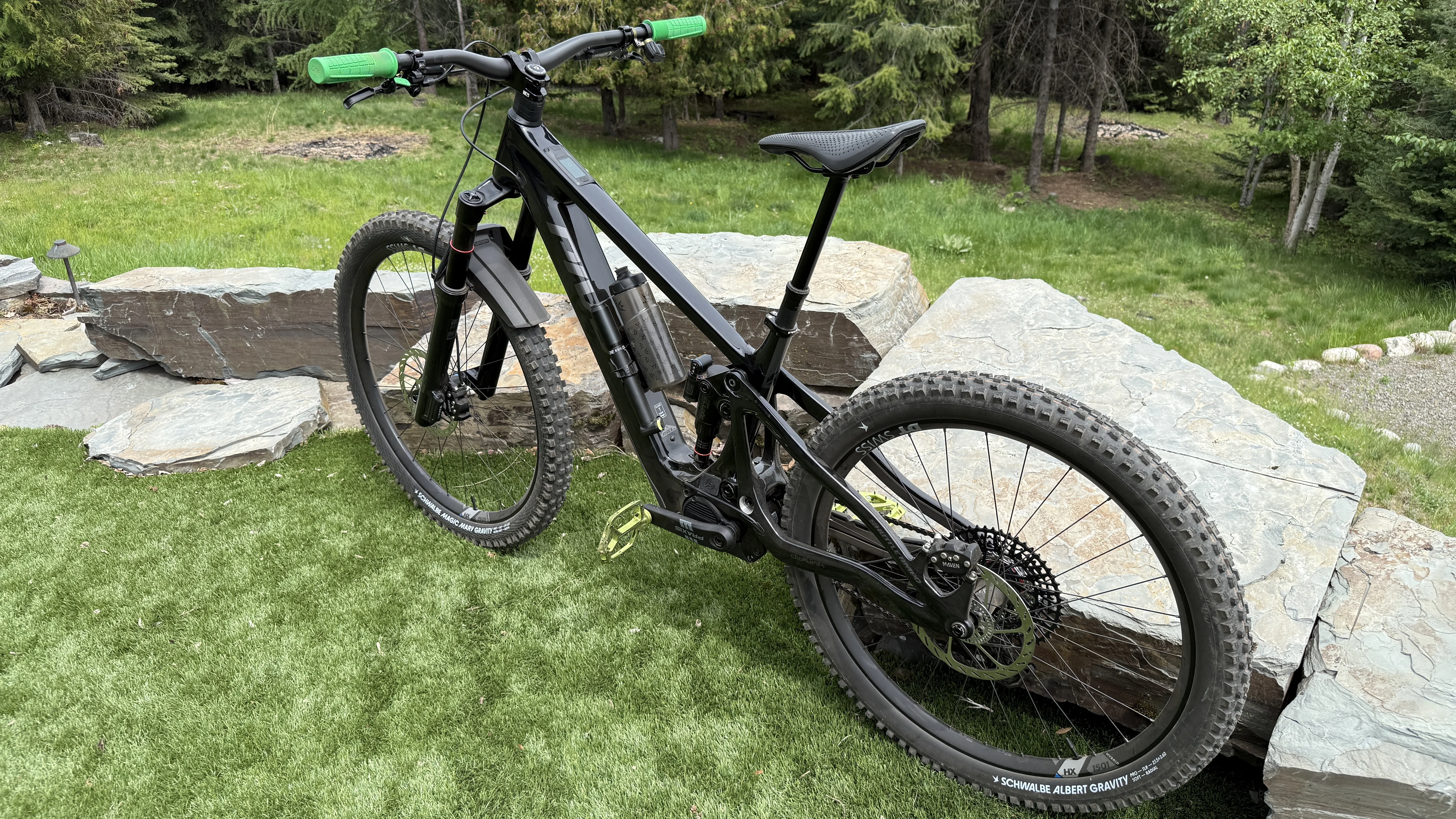

After a couple hundred miles of riding I think I finally figured out how I want this thing set up.
  1. Replaced stock Continentals with Schwalbe radials
  2. Zeb front fender
  3. Fidlock bottle
  4. Oneup pump and toolkit
  5. Race Face Atlas pedals
  6. Oneup green fat grips (with matching dropper post lever insert :rolleyes:)
  7. Freedom Coast horizontal AXS pod clamp
  8. Installed the Maven B1 upgrade kit.
  9. Replaced the stock saddle with Specialized Power Evo.
  10. Removed both Avinox control pods. I found myself never almost using them and I like a clean cockpit. I can access everything from the touch screen except walk mode.

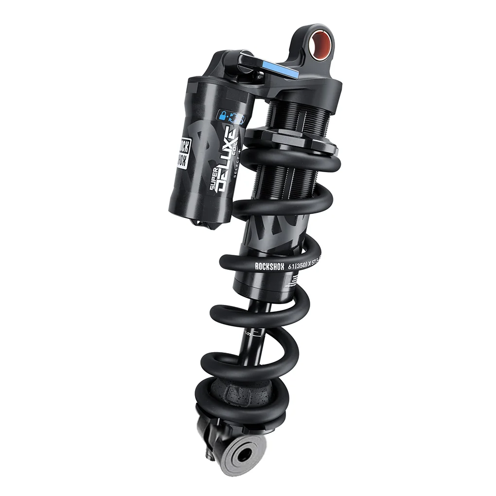

Not what I've done, yet.. But ordered this for my kado which should be coming next week, super excited to replace the crappy rear shock, even got chatgpt to do a mock up of what it will look like when on lol, will increase my rear travel from 150mm to 163mm too which will be nice

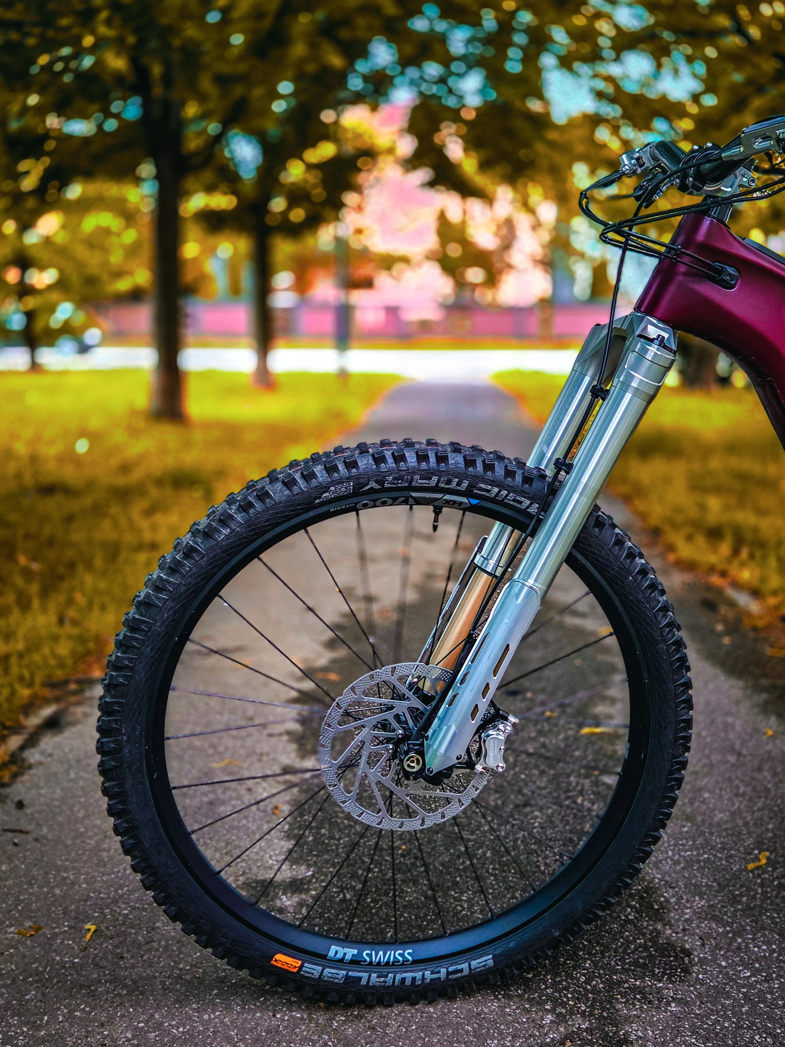

Replaced the maxxis crappegai last week with a magic Mary radial gravity pro ultra soft, finally have good grip in damp loam and soggy roots, love it. Fine the minion DHR rear for now but that will be getting replaced with an albert when the time comes

I've thought about those but the kados already a heavy bike, the coil shock I'm fitting is about 500grams more than air shock and the smash pots are about the same no? So that would be a whole kg added, I still care about battery range so will be looking to reduce some weight in future, SLS spring, Newman wheelset etc.
I do like coil forks but the zebs aren't super terrible like the stock kado rear shock is, it's fine bimbling about but struggles on long chunky enduro descents and the coil shock was a bargain 65% off which is why I went for it over an air equivalent

Why will it change the rear travel? or have you just got a longer travel shock?
Stock shock is 57.5mm stroke length new shock is 62.5mm stroke length so with the leverage curve it comes out to 13mm more travel over the stock shock, can shim it down to 57.5 but the kado frame has space for 62.5mm stroke so will take the extra travel
But will the linkage system allow that extra movement? Will the wheel hit the seat tube? Will the linkage overextend?
What I'm saying is, just because there is extra shock stroke doesn't necessarily give you extra travel.
Yes, no and no.
Based on measured clearances, linkage kinematics and a leverage ratio of circa 2.4:1, in theory it should be fine and still leave a bit of spare room to play with.
I’ll obviously still be cycling it by hand and taking proper measurements once fitted so other Kado owners have some actual data to reference.

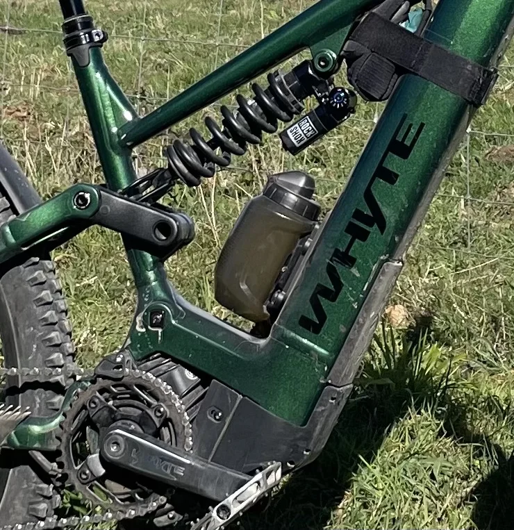

Great choice! I put a Super Deluxe Coil on my Kado straight out of the box.
You’re probably going to struggle to get a bottle in once you’ve fitted it though as the reservoir gets in the way.
My frame is a size large, I got around it by flipping the standard Fidlock bottle mount on the frame around 180° then flipping the mount on the bottle 180° to keep the polarities the same.
And now Fidlock make a 500ml chubby bottle that fits perfectly in the frame so I use that

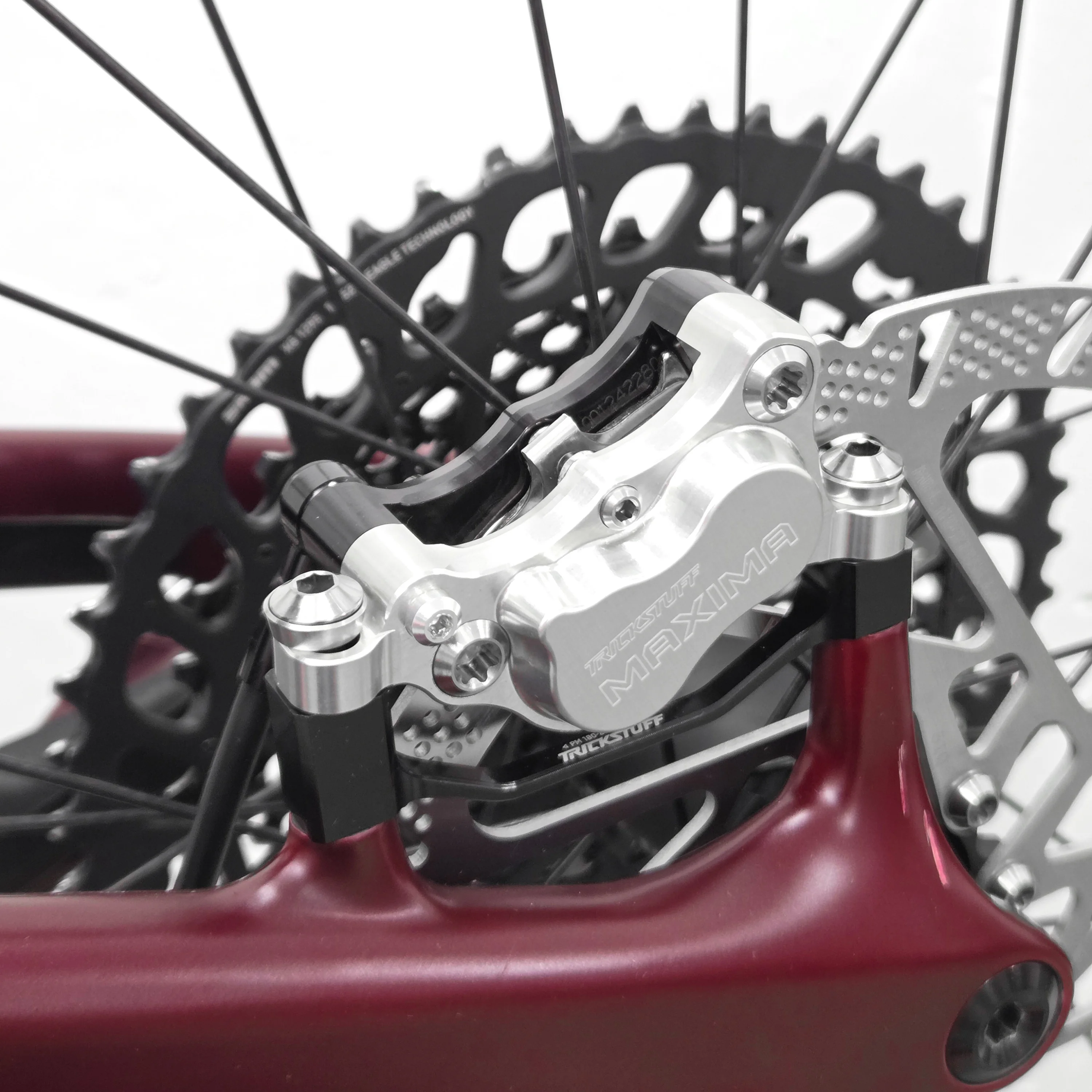

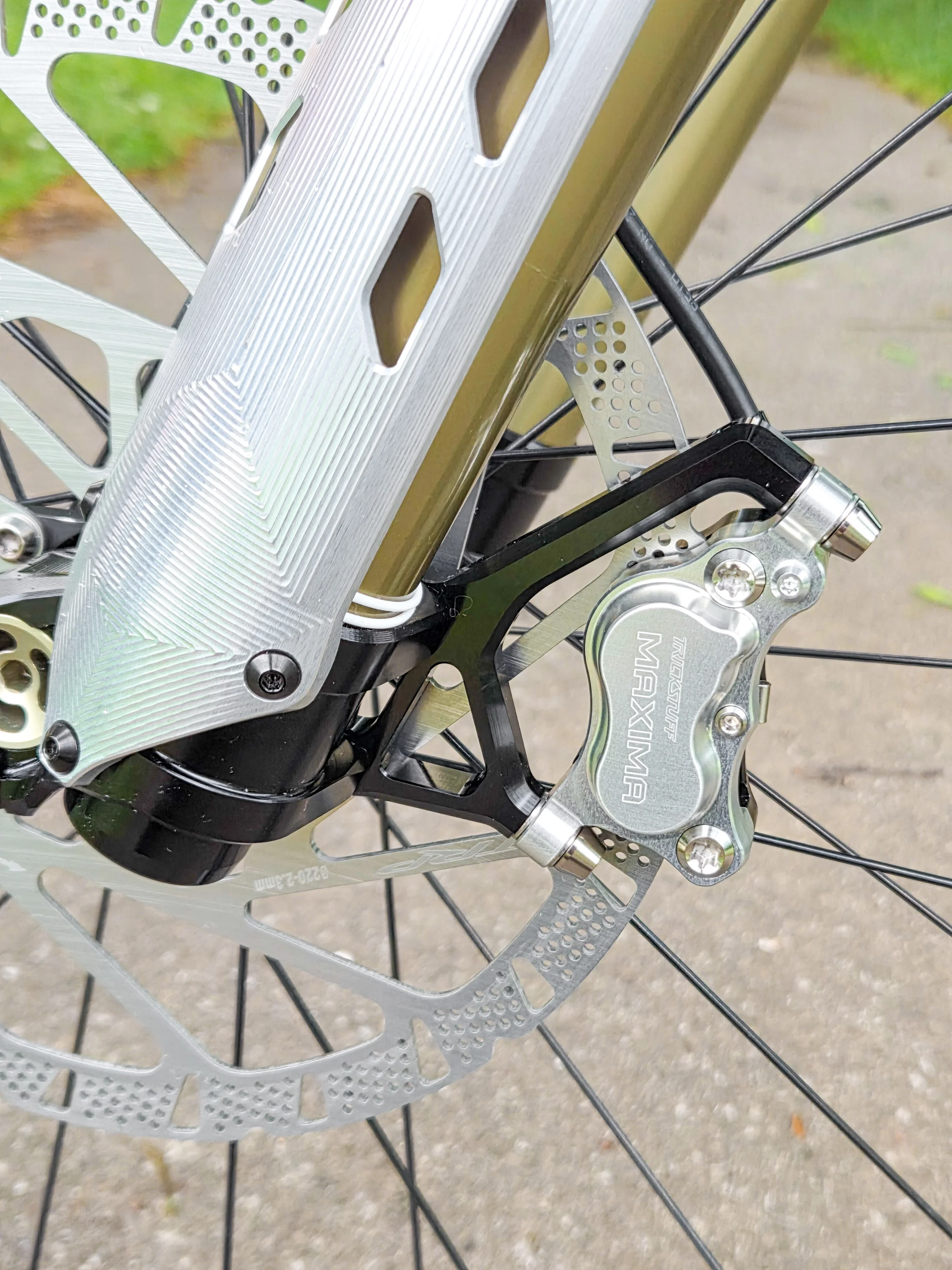

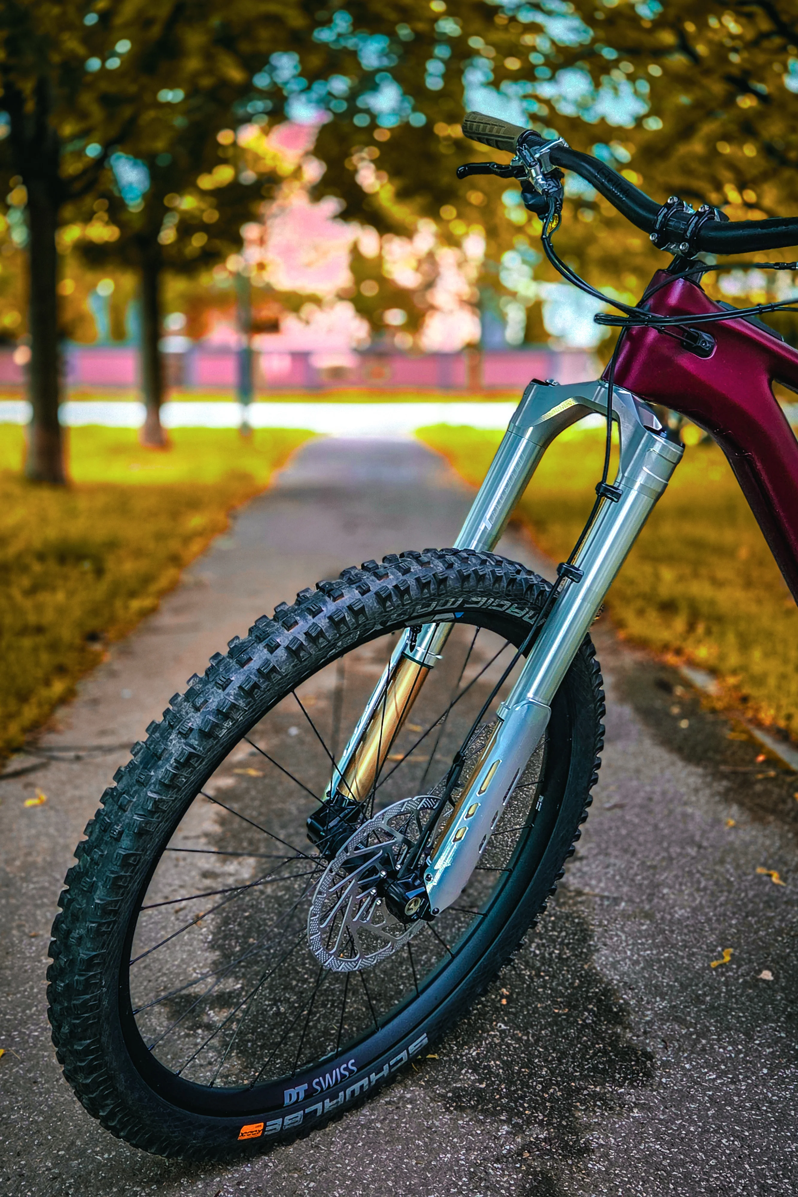

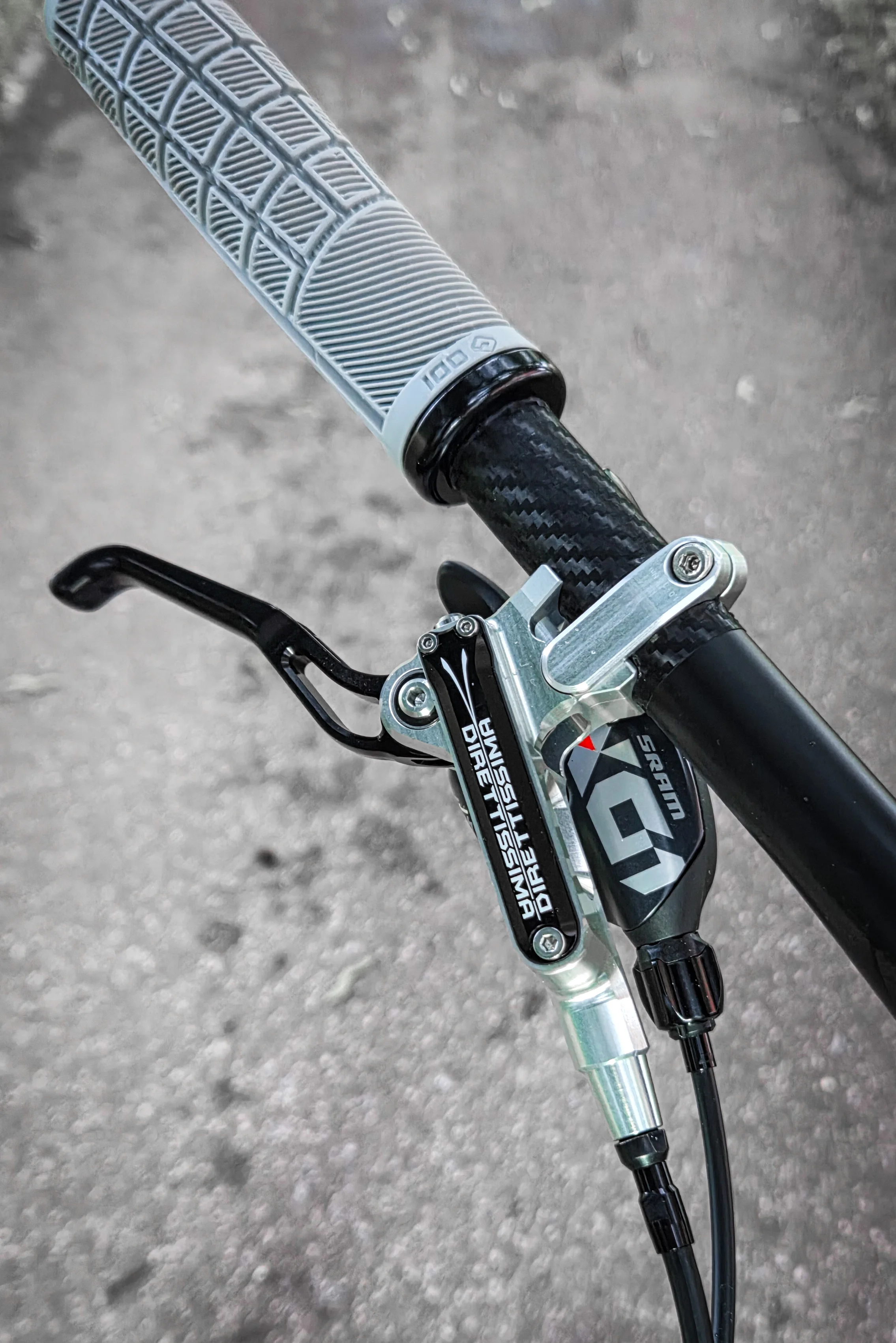

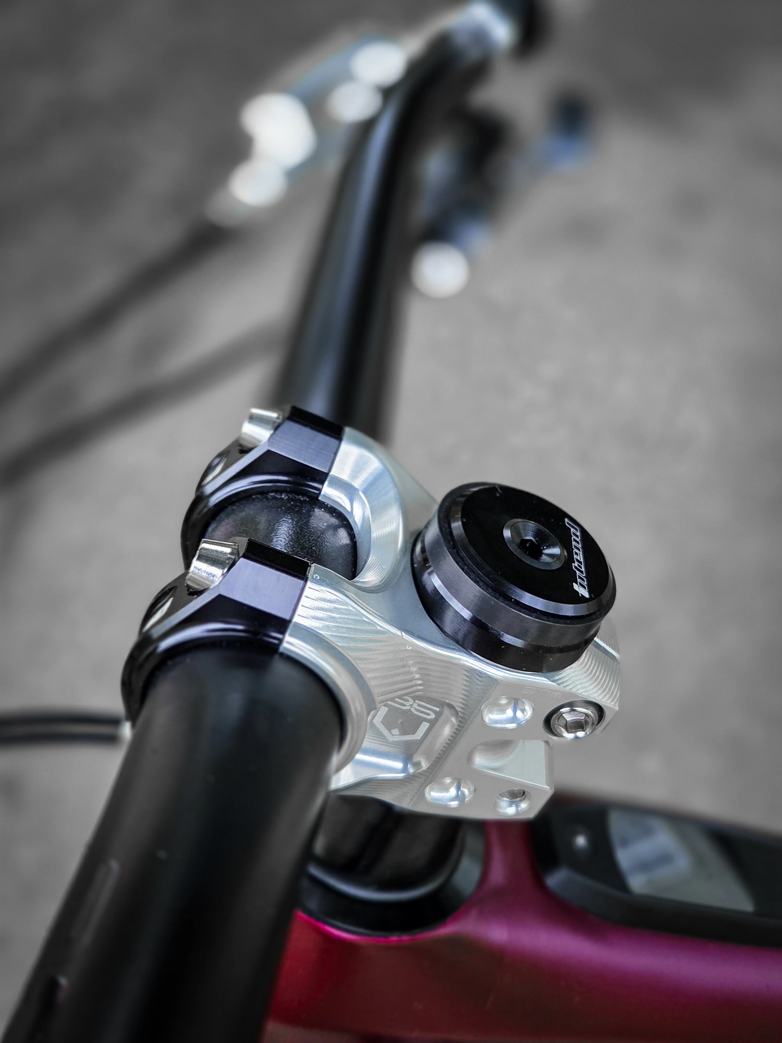

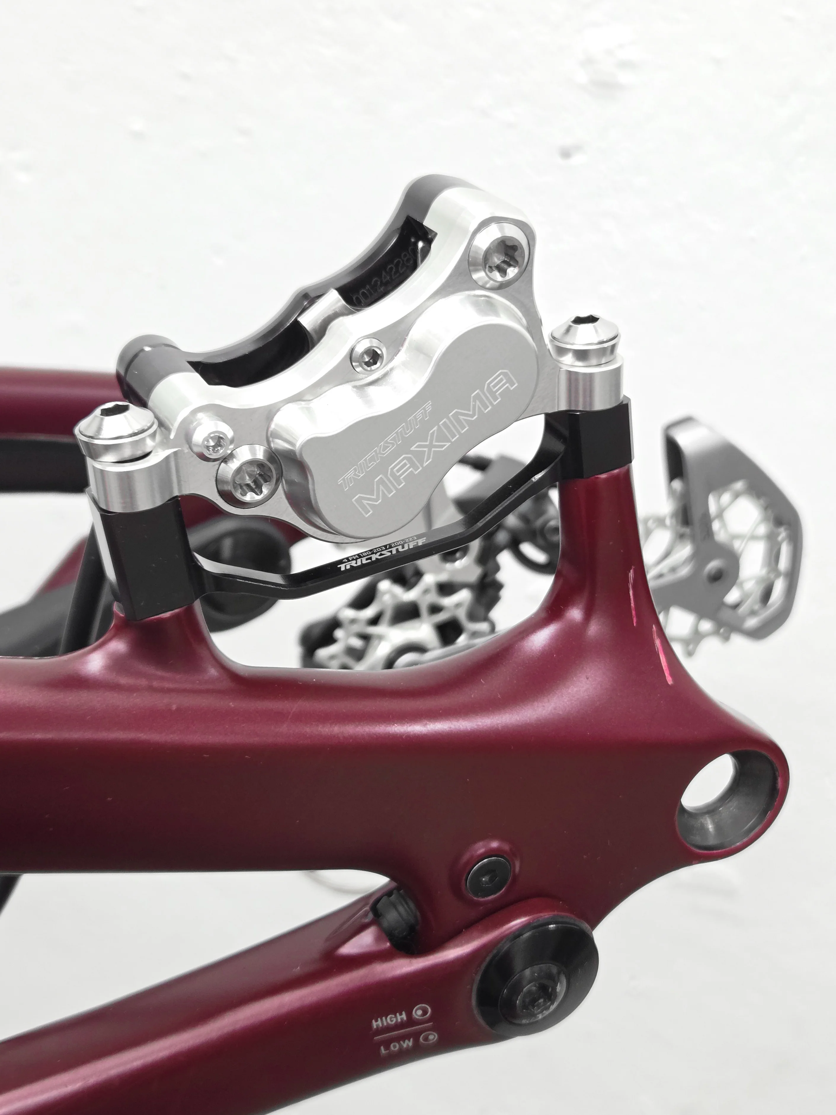

Instead of falling into all the Avinox hype, I decided to give my 4-year-old Levo a mid-cycle refresh to help combat my midlife crisis.
- Intend Flash 38 (unicorn silver)
- Trickstuff Direttissima levers (silver/black)
- Trickstuff Maxima calipers (half silver/ half black)
- Hope Gravity 35mm / 31.8 stem (silver / black clamps)
