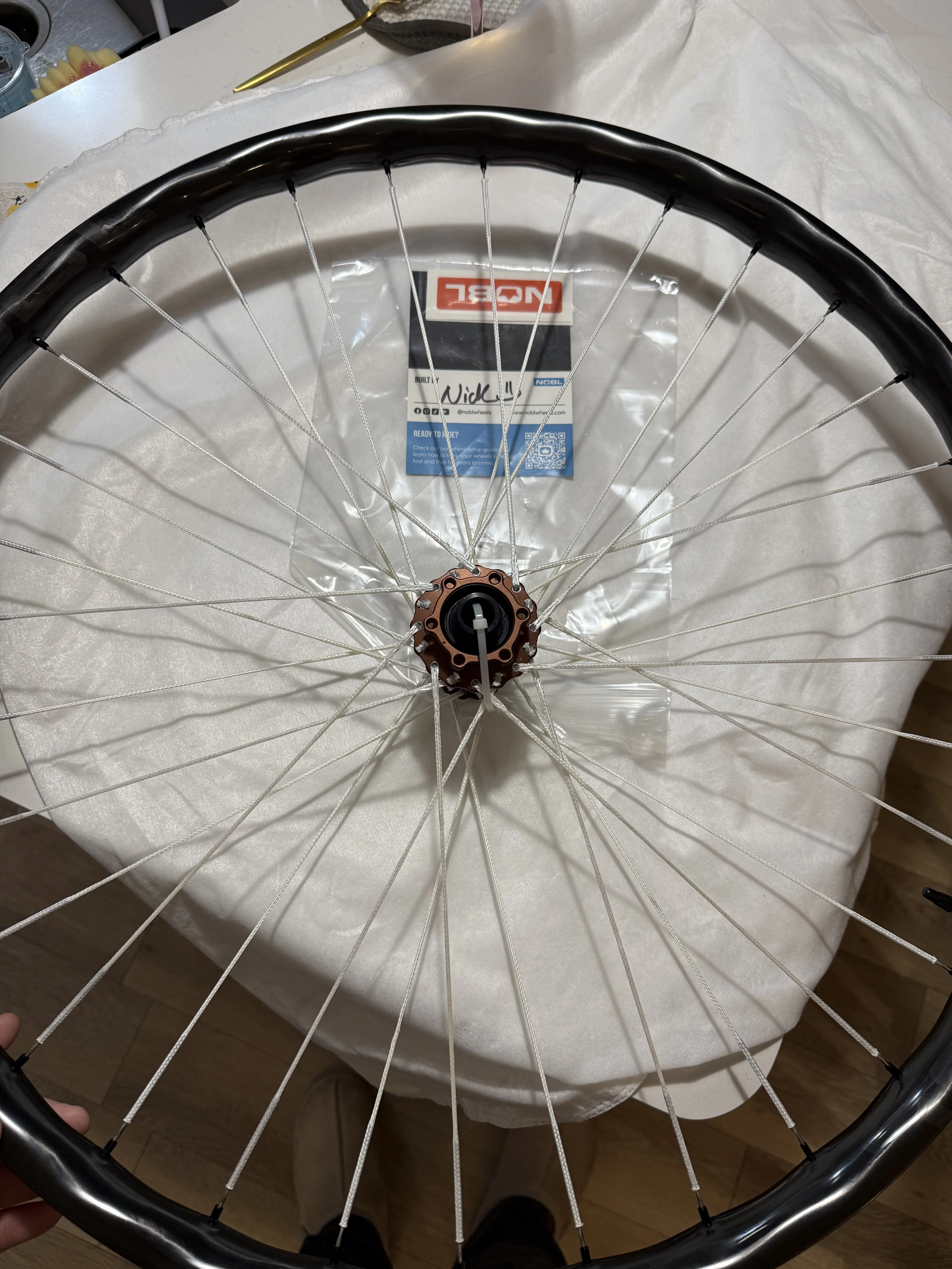

Looks like Nick at Nobl built these up for me. Got a great deal from Tim.likes.bikes and couldnt resist. Hope I like the feel, but can say they do feel noticeably lighter in my hands.
I have another set of TR37’s with Vespers, but with Sapim D-light spokes. Im going to run the two sets back to back over a long weekend trip, and see if I can notice a difference. Apparently, they are more compliant. View attachment 181118
I had considered lacing Berd spokes on a new wheel set a while ago. I wasn’t too worried about weight at the time, mostly how they fastened to the hub. Some hubs with a hook method are now available.
Hub type, wheel type, 2 cross or 3 cross, are all critical for sizing. The assembly process looked complicated so I didn’t get them.

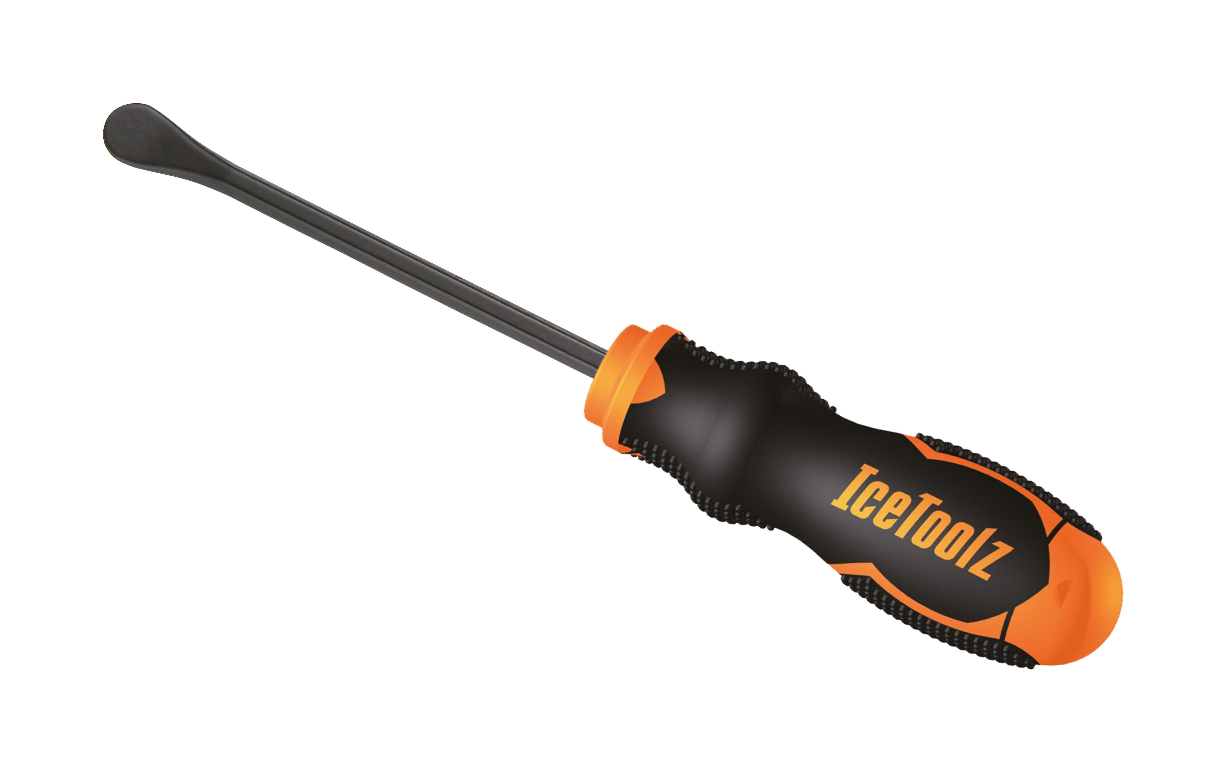

The Ice Toolz DH lever does make light work of it though (I leant mine to a mate years ago and never got it back, so really should order another).

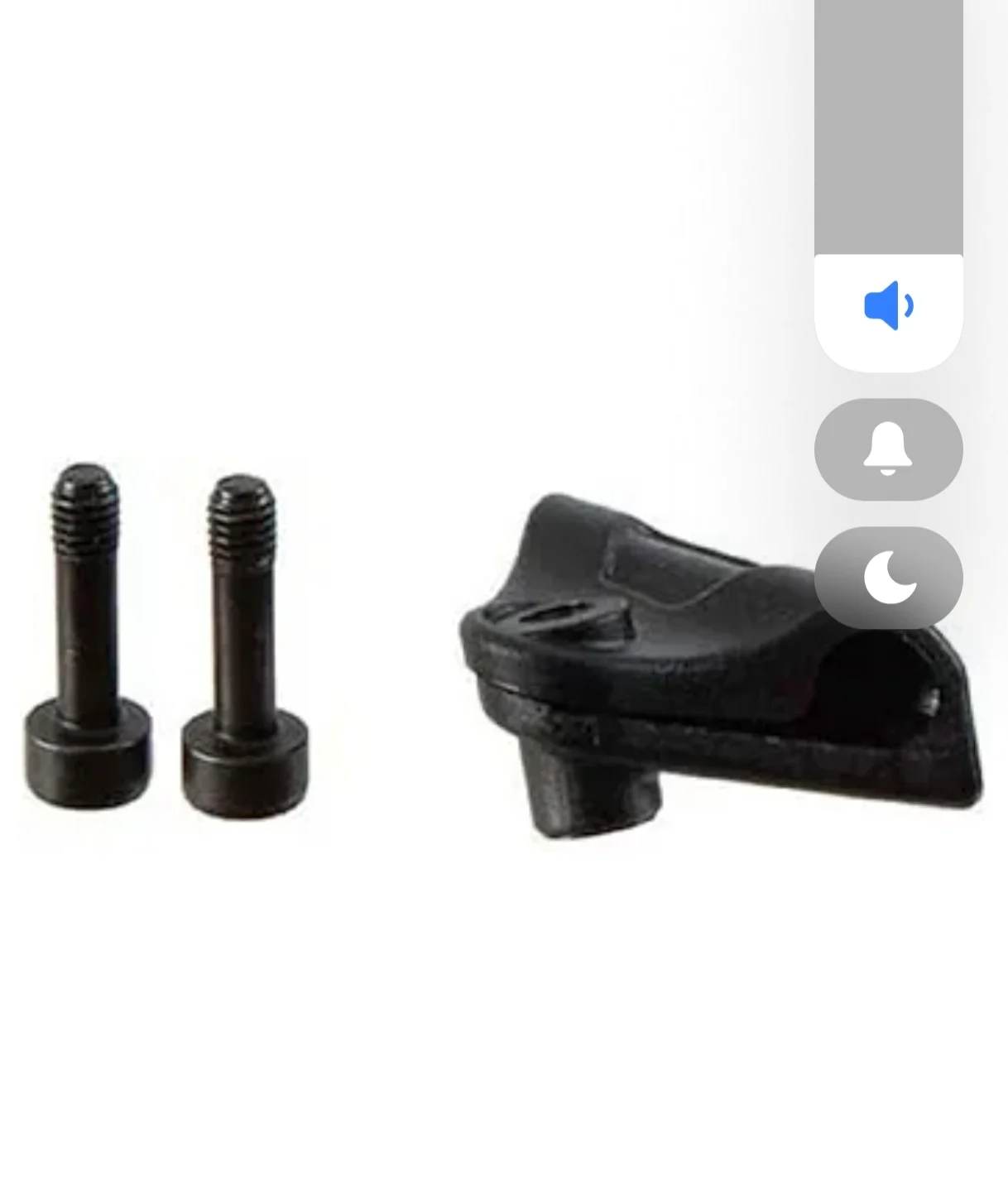

Lower fork service (Lyrik) today...how does a few ml of fork oil make such a bloody mess on the garage floor (my fault as I accidentally knocked the small container I'd put to catch the oil out of the way)....and don't get me started on the tiny hose clamp bolt made of chocolate and a what appears to be a watchmakers thread! Anyone else had problems with that tiny through bolt on the hose clamp?
Come on now they are trying keep the weight down you know that.
