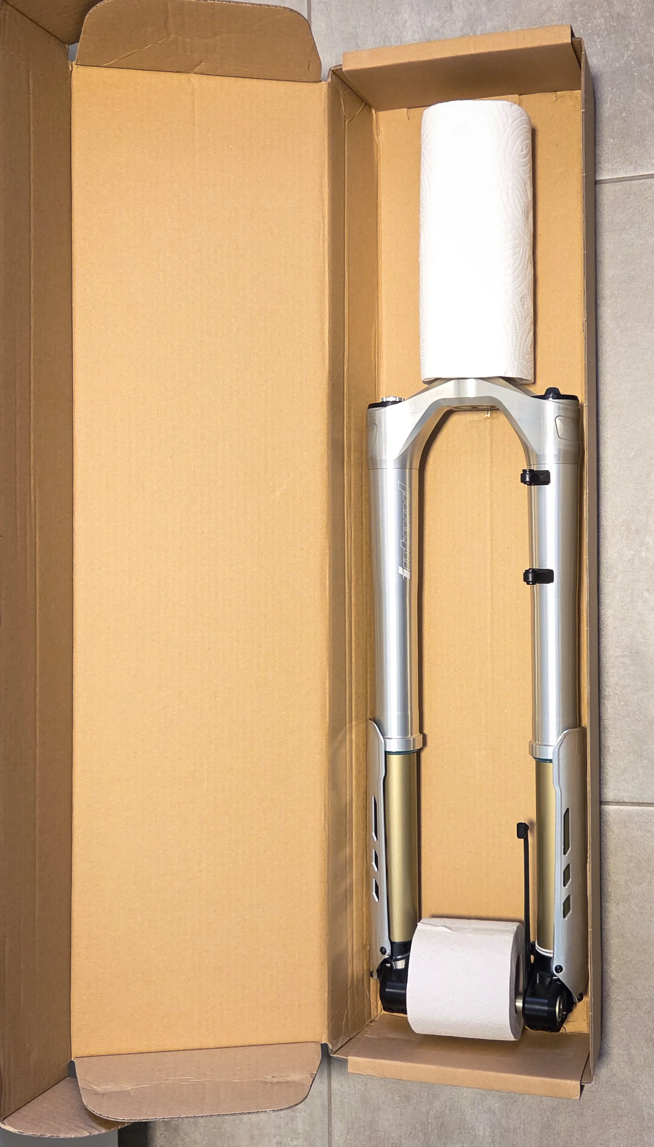

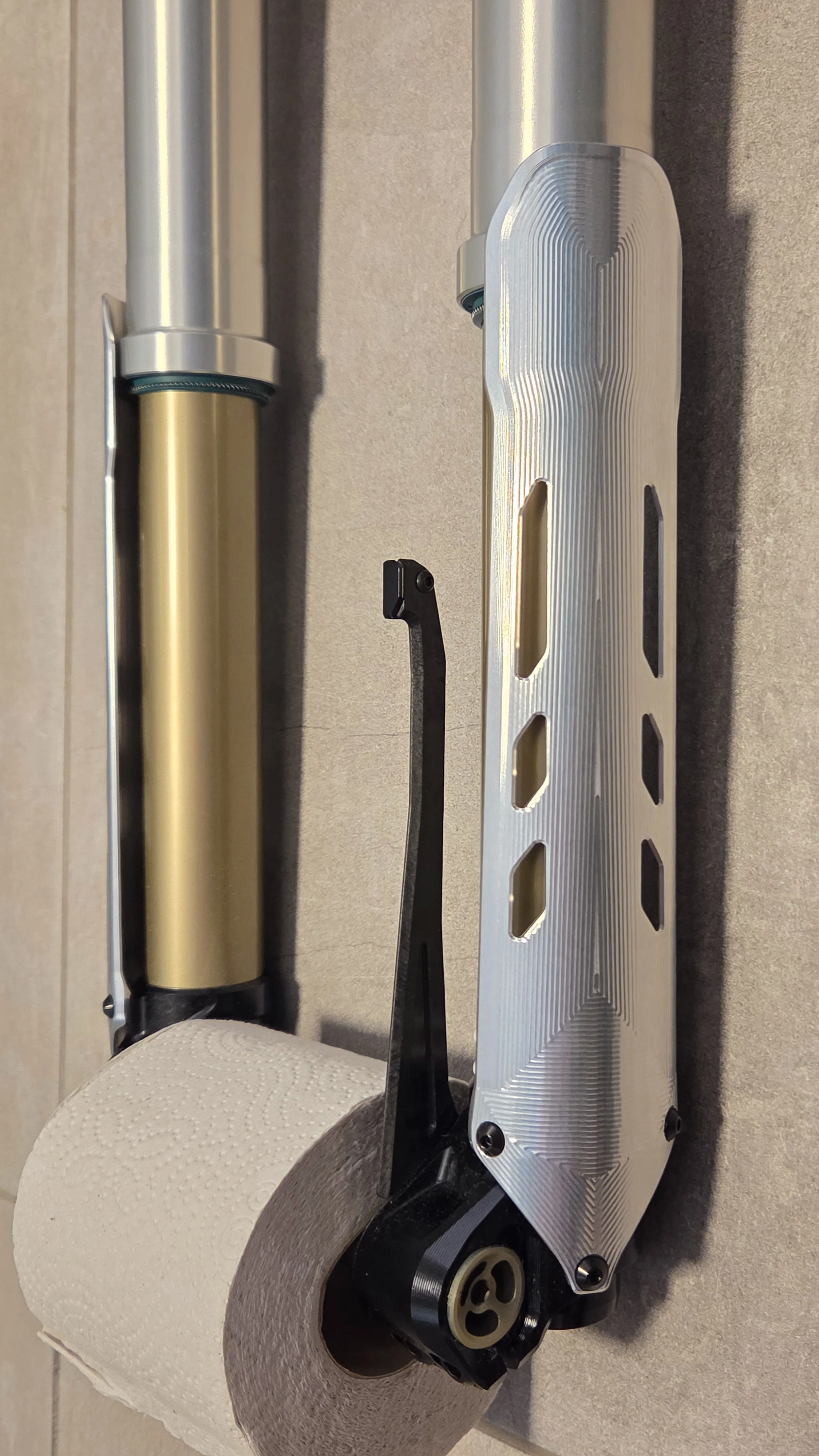

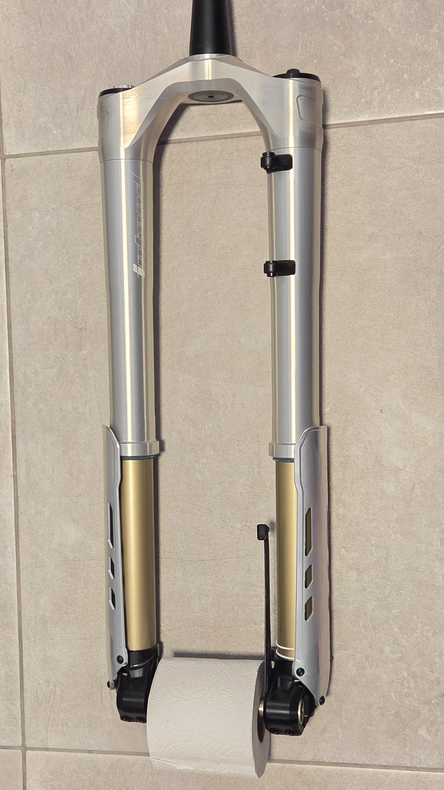

What a hoo-haa today. New fork arrives at 2pm, I'll fit it up and head out for a ride, shouldn't take much longer than a couple of hours :rolleyes:

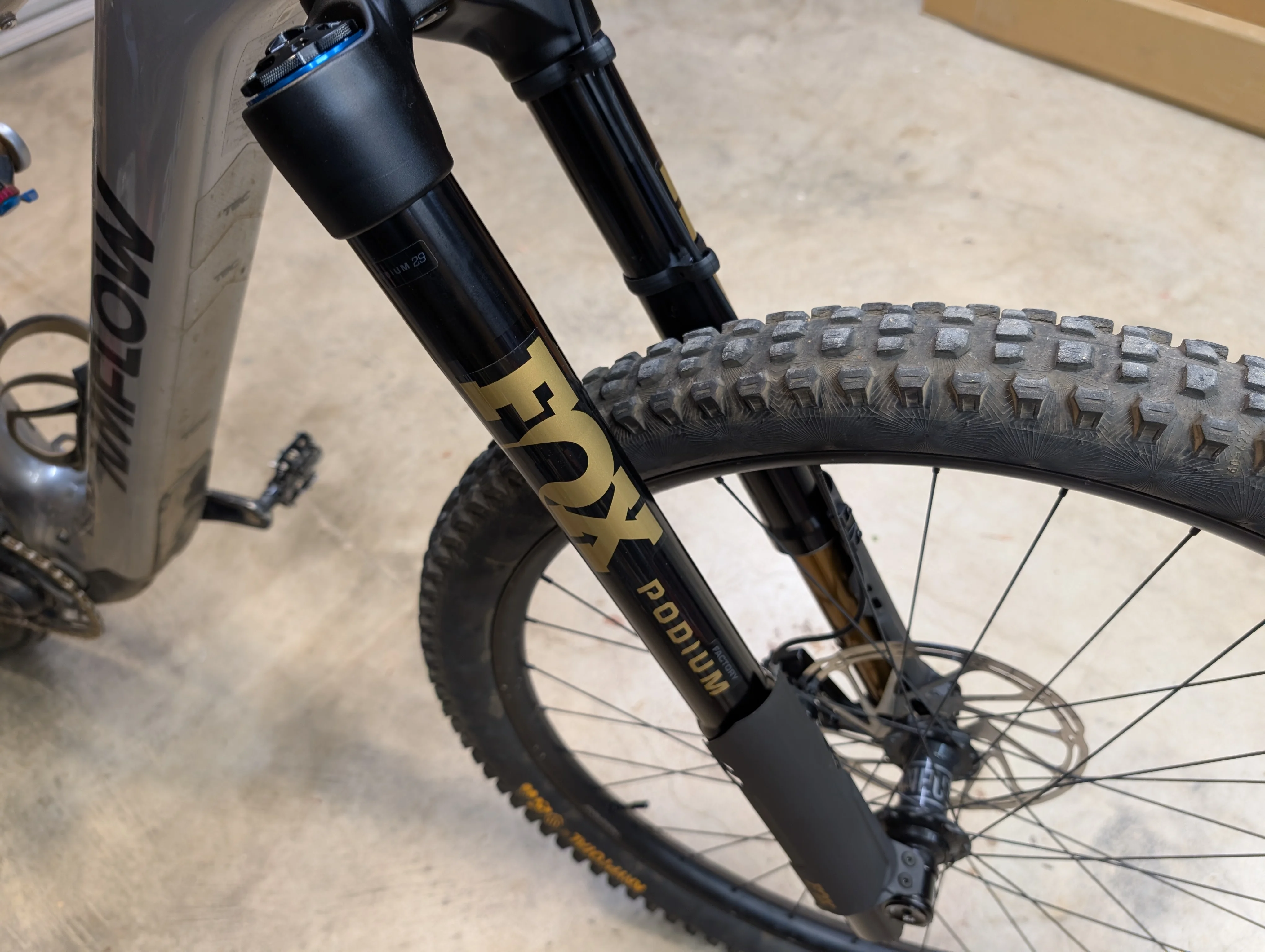

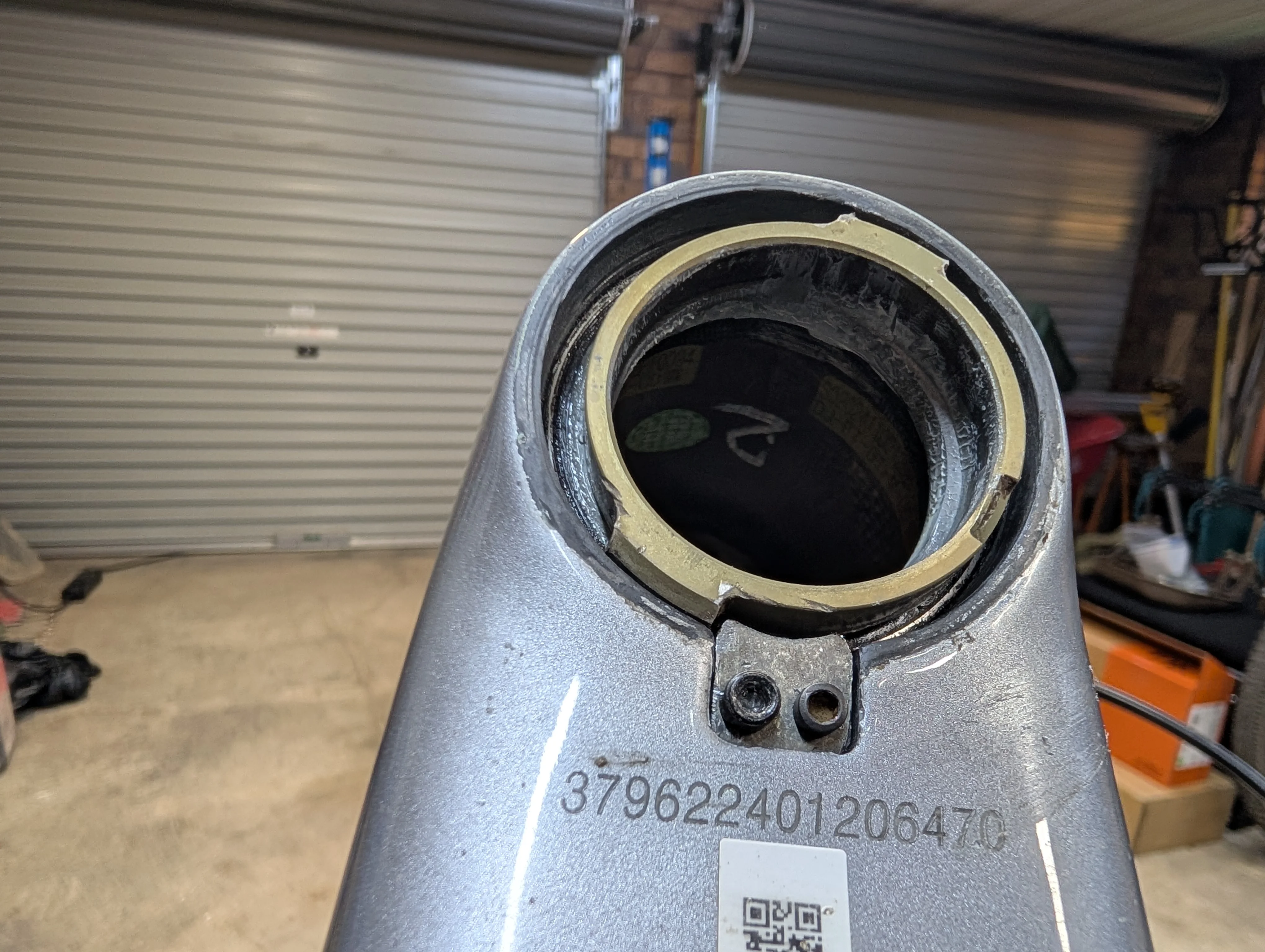

Story - the Podium was meant to fit on a size Med Amflow PL. I can tell you it does not and my experimental sizing soon made it clear that it was going to need a full 10mm spacer under the Amflow steerer crown ring to stop the dials hitting the frame, this would have moved the factory ring 10mm up the taper meaning it had no grip on the bottom tapered section.
Not sure how everyone is running 10mm spacers on the crown race to fit their Zeb forks, plus the 10mm spacer means lifting the front by a further 10mm in addition to the 10mm gained from running a 170mm fork.
Left me with 3 options, remove the dials, send the fork back or get the unused Amflow knock block working.
Not ideal as they dumped the idea of the knock block as a hard crash can apparently damage the frame. Seems to work well and do the job.... famous last words, someone can remind me when I hit up Amflow for a front triangle replacement :ROFLMAO:
Its now 7:20pm so it only took 5 hours, going get the lights on and head out for a test ride.
I have the same contact problem between the compression dials on my Zeb and the frame of my 2022 Trek Rail size M. The Trek knock block does effectively prevent this contact when just rotating the forks by hand, but in the event of a crash the torque on the end of the handlebars from hitting the ground is sufficient to blow past the knock block and I have some - fortunately very minor - scrapes on the frame and dials as a result.
So what I do now is ensure that the two bolts holding my stem to the steer tube are only torqued up just enough to ensure that the bars don't twist around from normal riding, but will allow the stem clamp to rotate in the event of the handlebar end plummeting into the ground. So far this works pretty well, and stops the handlebars being over-rotated in a crash and leading to the fork dials hitting the frame. Just my 2 cents.

Thanks @nickf, yeah aware that its only stopping gentle bar spins. Relying on the crown ring gripping the tapered steerer to stop rotation is not going to do much it in a decent crash. I'll have to deal with the consequences of that if it arises 😭
Might get some 3D printed replacement dial covers once I have the fork set up correctly. That would be the ideal outcome.

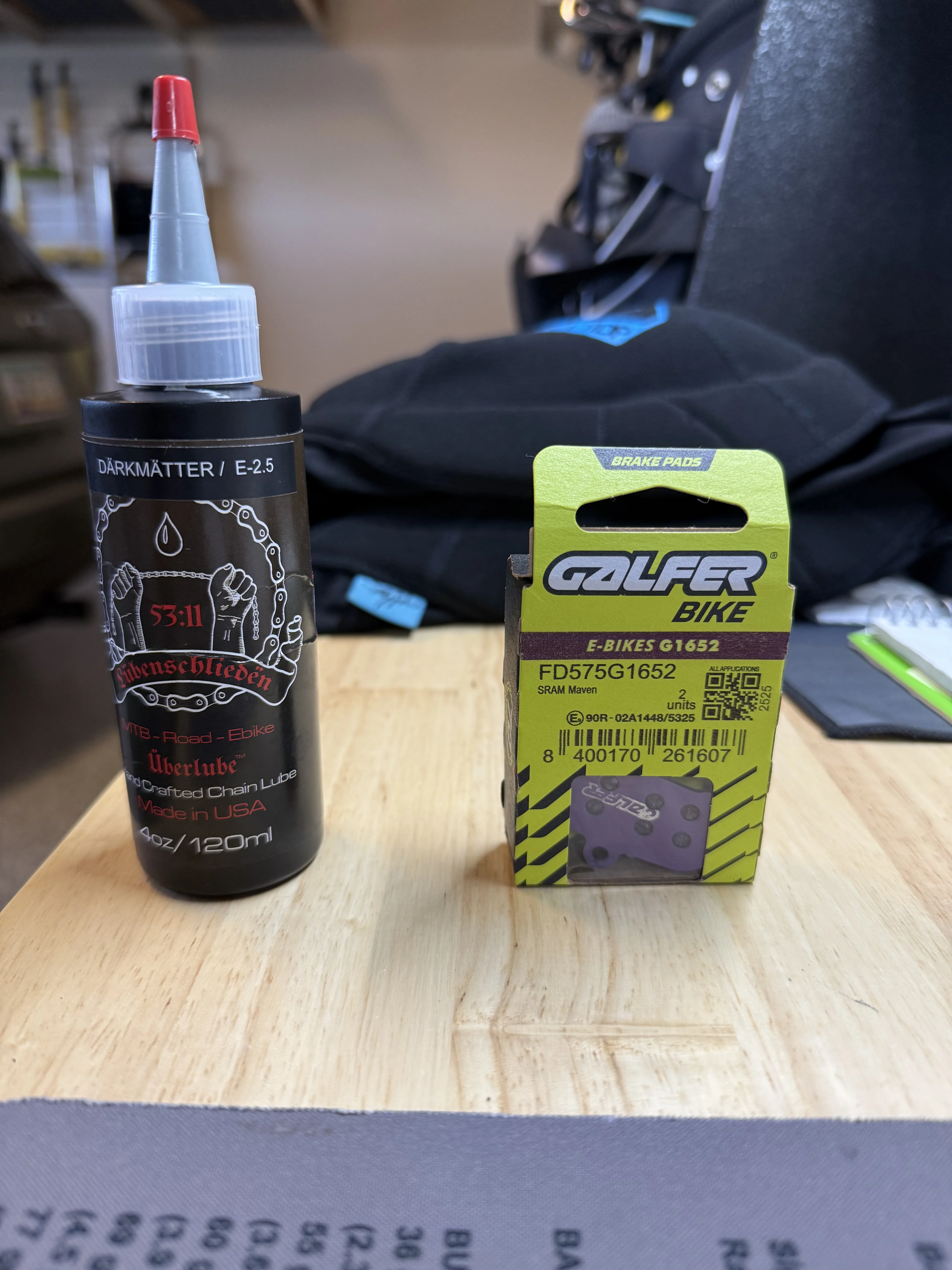

Uberlube per Powerslider’s recommendation.
Galfer purple per B-man and Polar’s recommendation. If they don’t work and I end up plunging to my doom on some mountainside, the forum has my post-mortem permission to mock both of them. ;)
Ditto I did the same for the same reasons, haven't tried them in anger yet
