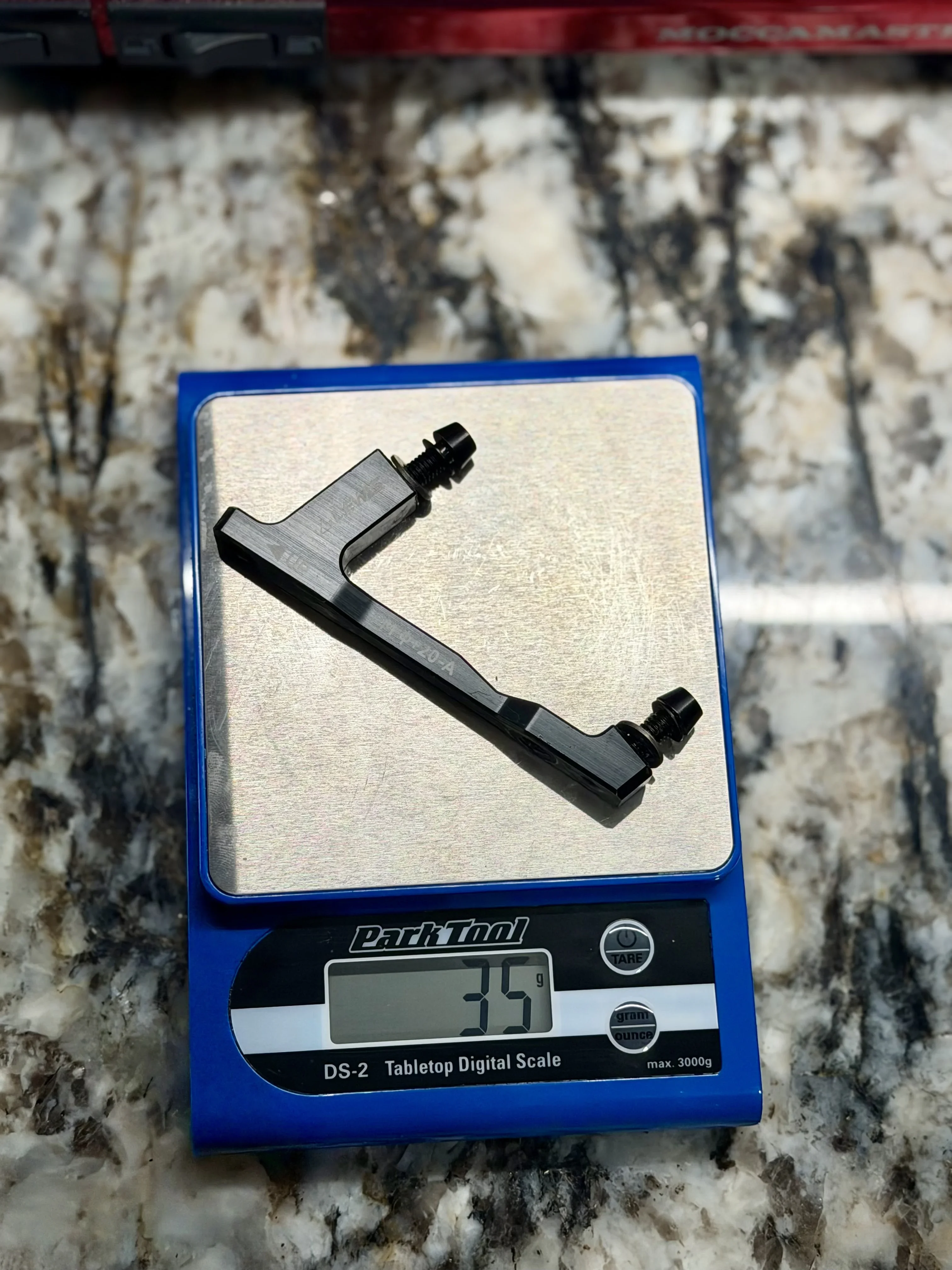

Ever since upsizing my Lewis rotors from 200 to 220 front and rear, I’ve been dealing with noisy brakes in the rear. I’m so far down the road of finding a permanent solution, that I’m putting back on the 200mm rear rotor; if only to confirm a baseline.
While I’ve been impressed with the Lewis LH4 brakes, I haven’t been so much with their rotors. I’ll probably try different rotors, but putting back on the 200 rear rotor will be a good test for now.
I will say-when I run the 220 rear rotor I need to use a +20 spacer on the caliper. I can’t help but ponder the caliper spacer factoring into the creation of the resonance (howl). 🤔 Caliper bolts right to the frame with the 200 rotor.
Saved 35g in unsprung weight. 😐
