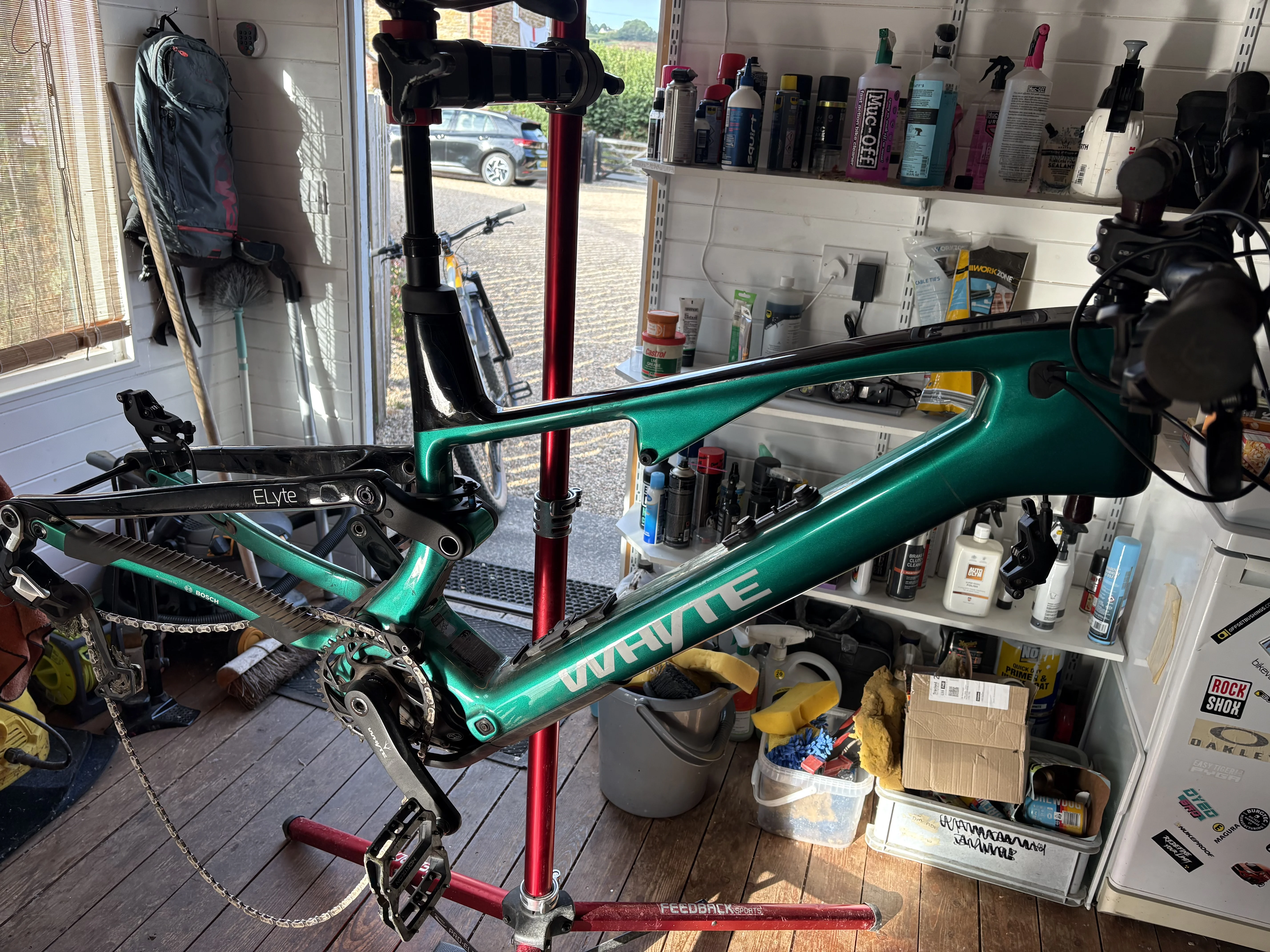

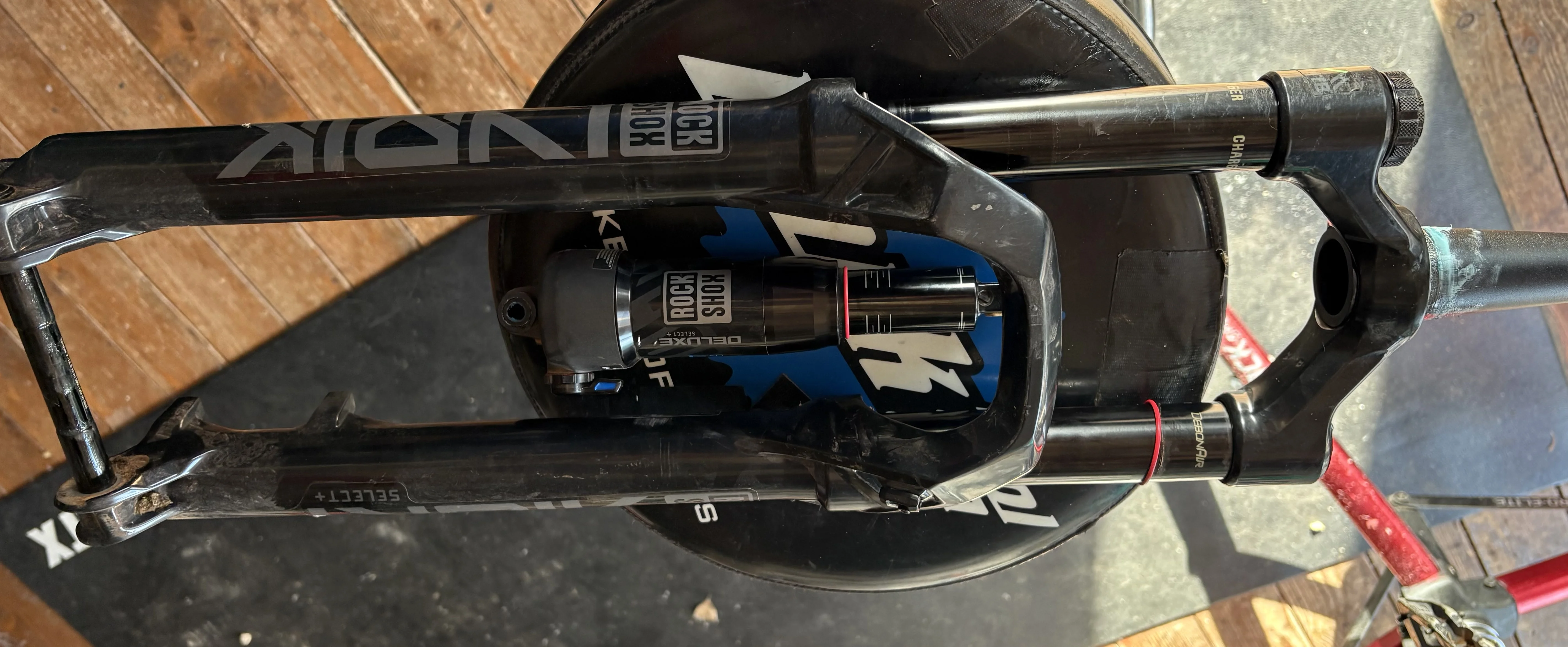

After just over 600km (in not very long), fork and shock off to my local suspension tuners (Sprung in the Forest of Dean). They aren't broken or even really in need of a service, but I get all my new suspension units fettled there. They always come back so much better. My expectation is the fork - especially- has too much grease in it/tight bushings based on previous Lyriks.
Getting the shock out is pointlessly hard as it's only two bolts. But the swingarm end has vey little clearance to the underside of the top tube and it was assembled with a lot of loctite. So small allen, lots of grunting to get it loose. Then I realised if I'd dropped the other end of the shock out and cycled the linkage forward, I'd have way better access.
At least I realised that before trying to reassemble it ;)
Need to fix some 'rock rash' from yesterdys ride that's toasted some of the invisiframe. Bearings feel super smooth and tight tho which is a relief.

Update on above. When I said there's nothing wrong with the fork and shock, it appears I was only half right! The shock has a score on the stantion. Apparently this was very likely due to an assembly issue and is 100% warrantable. Still that's going to take a week so I guess I'm going to find out how much non e bike fitness I've lost for at least 3 rides!
Forks - as expected - tight bushings, too much oil in damper side, etc.
