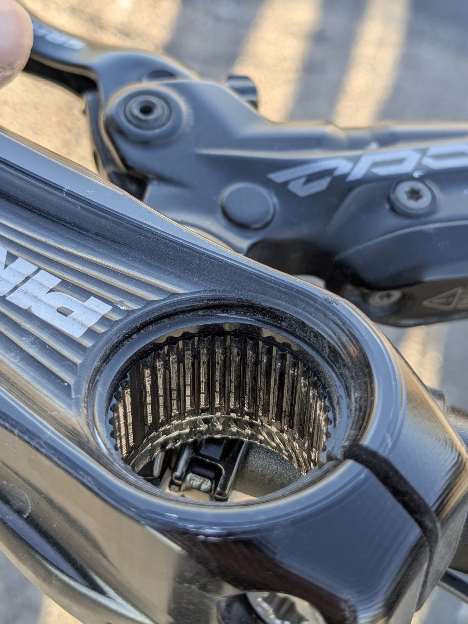

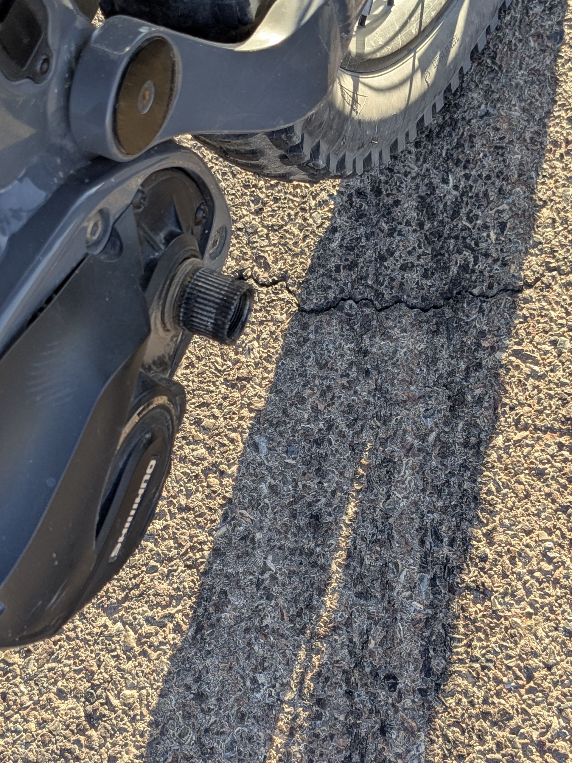

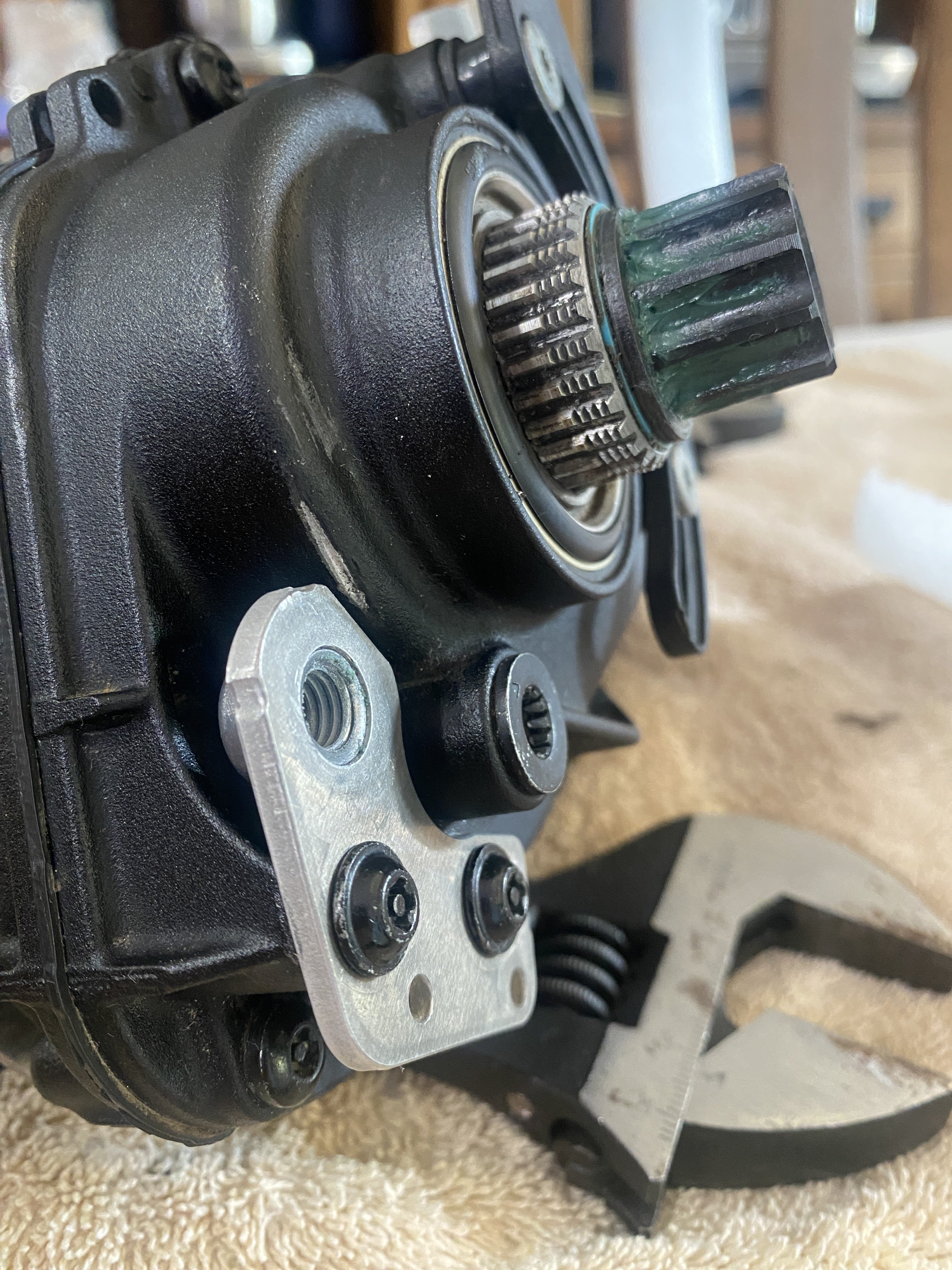

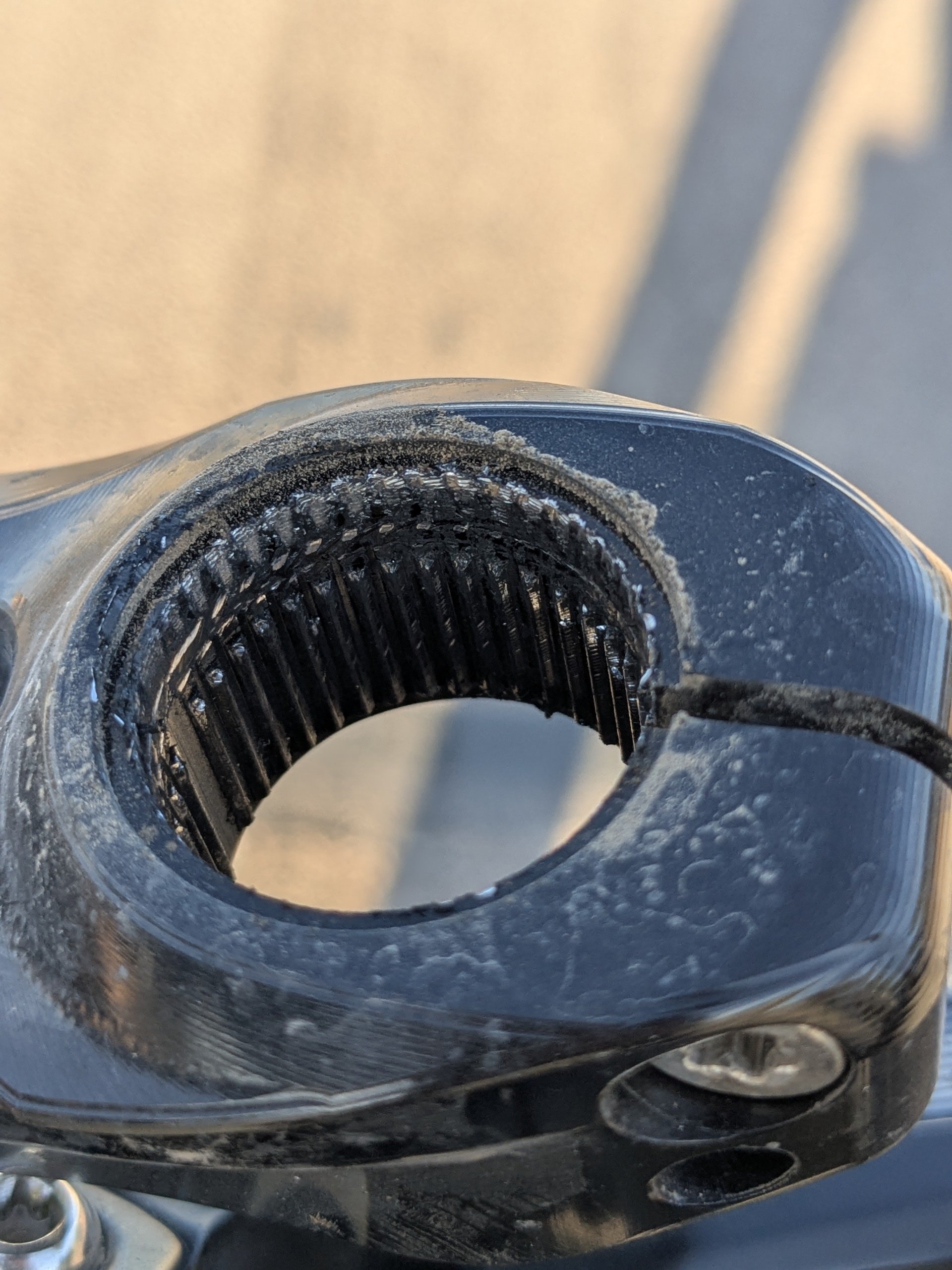

I reattached a crank that fell off mid-ride. I hate when that happens.
Backtracked to look for the sideload cap, but no luck. Just used a Shimano one I had lying around. There's no bearing to preload on this motor, like there would be with an external BB, so I threadlocked it with med/blue goop and tried to turn it good. Luckily not many of the spines got shredded.
PXL_20250508_003503821.jpg PXL_20250508_003508173.jpg PXL_20250508_003514286.jpg
The pinch bolts on these Pinnd cranks are T30, but T25 seemed to fit fine. Based on how big the pinch bolts are, I knew they could take a lot more than 8 Nm. The steel spindle on the motor can take that too, I bet, but there's a hole drilled out for the Shimano security tab to sit into that makes me second-guess myself.
This time I checked the install guide and saw they recommend 14 Nm for pinch bolts, 2 Nm for the preload, and also loctite (222 or 242) for the preload.
View attachment 160204 View attachment 160205 View attachment 160206
Don't you use the safety pins? Or doesn't your motor have the holes in the output shaft (ie BB). They stop the cranks falling off, and stop you putting the cranks on 180° out of alignment with said holes, which then puts huge stress on the area around the hole when tightening the pinch bolts (like a nutcracker) Only curious, not having a go, maybe some Shimano's don't need them.

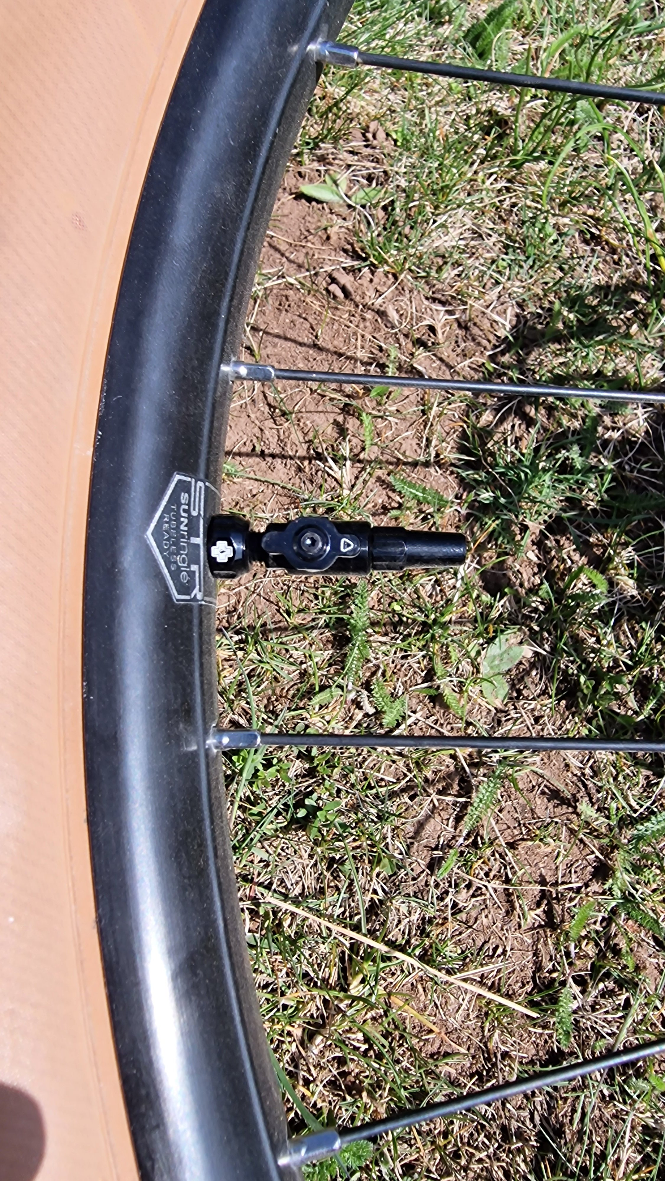

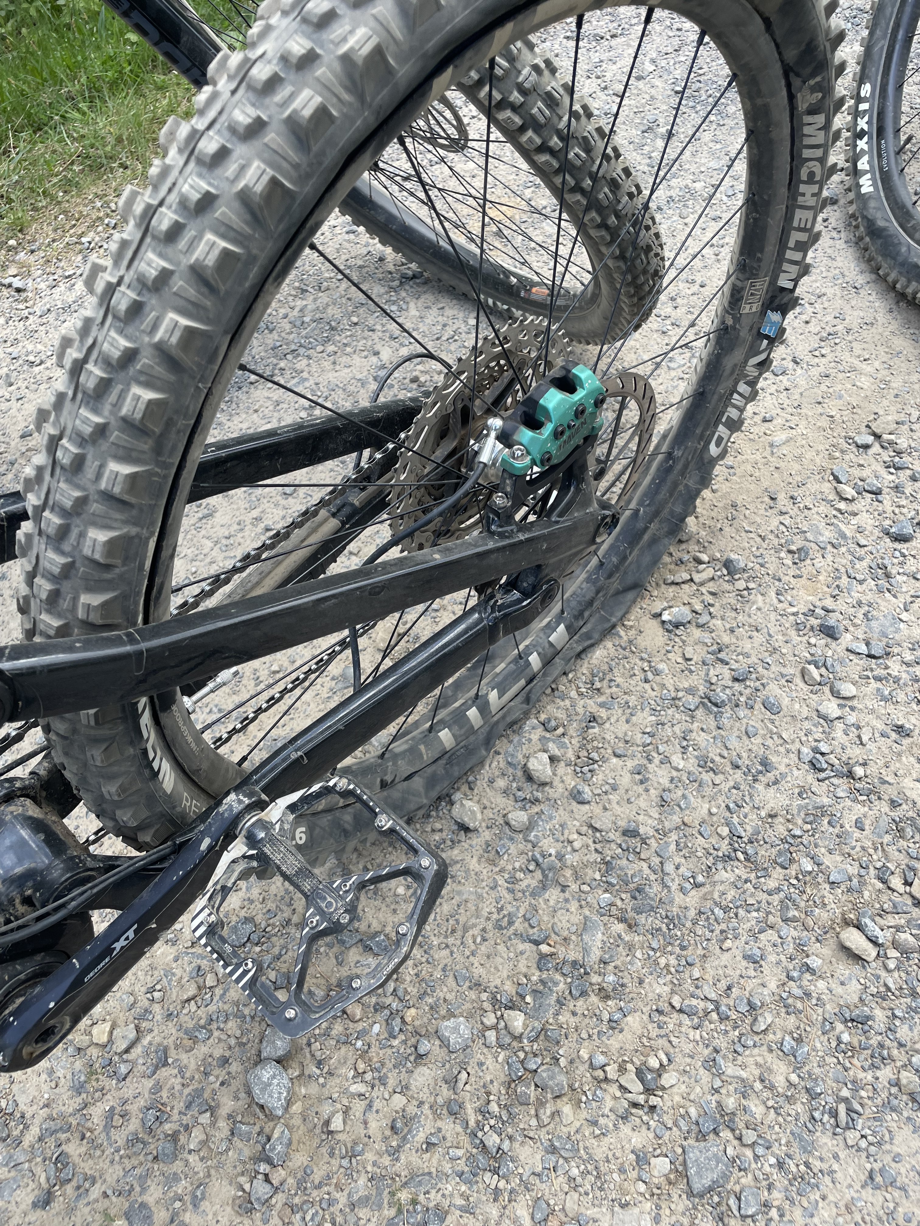

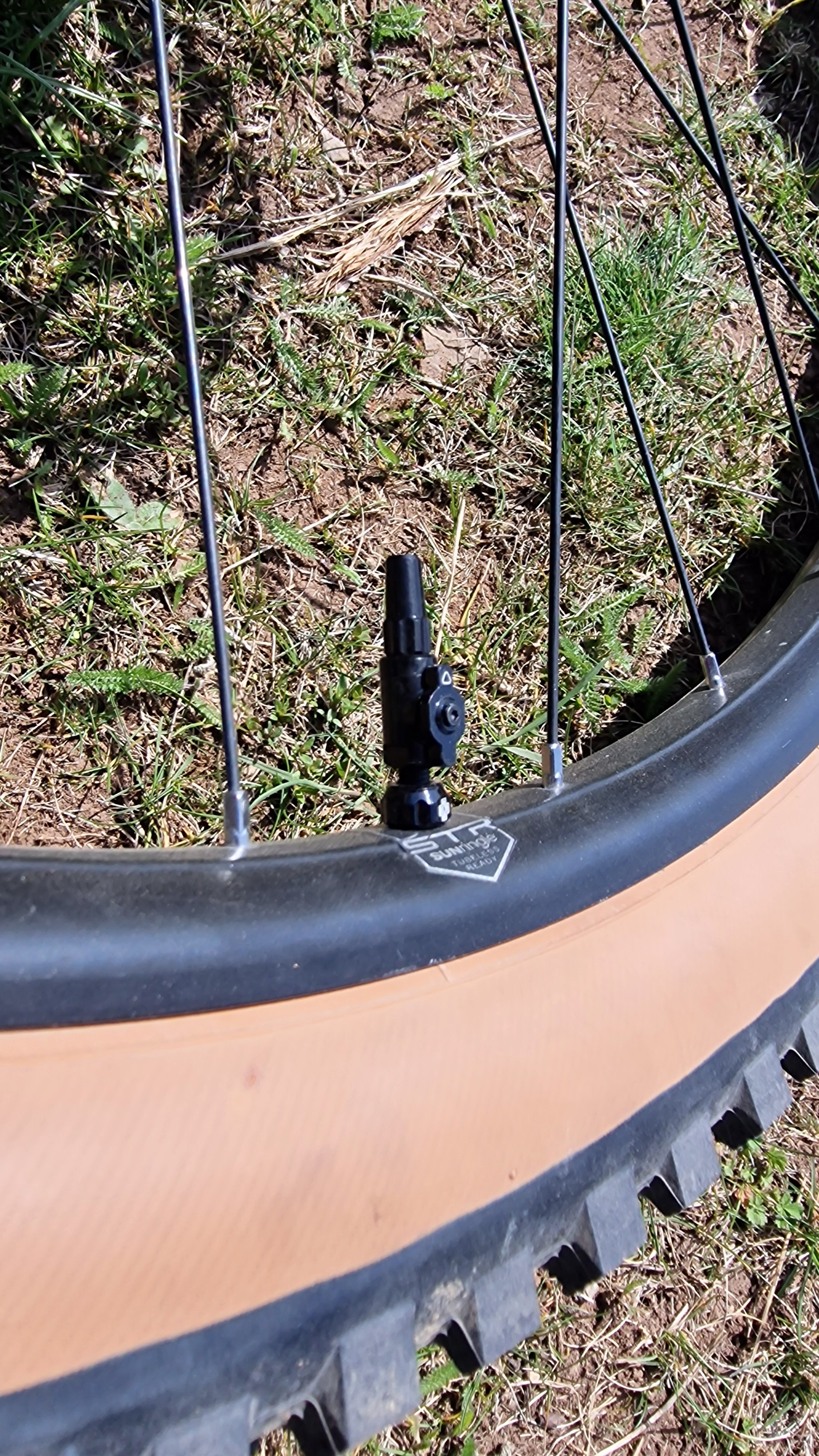

was tubeless, had sealer in BUT didn't work :rolleyes:
I'm not going to mention the brand name but won't be using it again as have has several non-sealing episodes with small punctures🤬
Rich.
That is unamusing for sure 😕
Hope the rim's OK.
Out of curiosity, what sealant were you using and how much, and roughly what size were the unsealed holes?
ps - says "Michelin E-Wild" on the tyre.
Hope the rim's OK.
was an unfortunate end to a good day (was at park closing time so not a wasted day 😶 )
the rim suvived with a minor dink although possibly from a previous incident;) Nukeproof Horizon Pro wheels are a favourite of mine and seem quite resiliant(y)
as to sealant, begins with a p.......
and, yes, E-wild tyre. I like them and have worn out a few riding Bpw and this is the first one I've punctured!

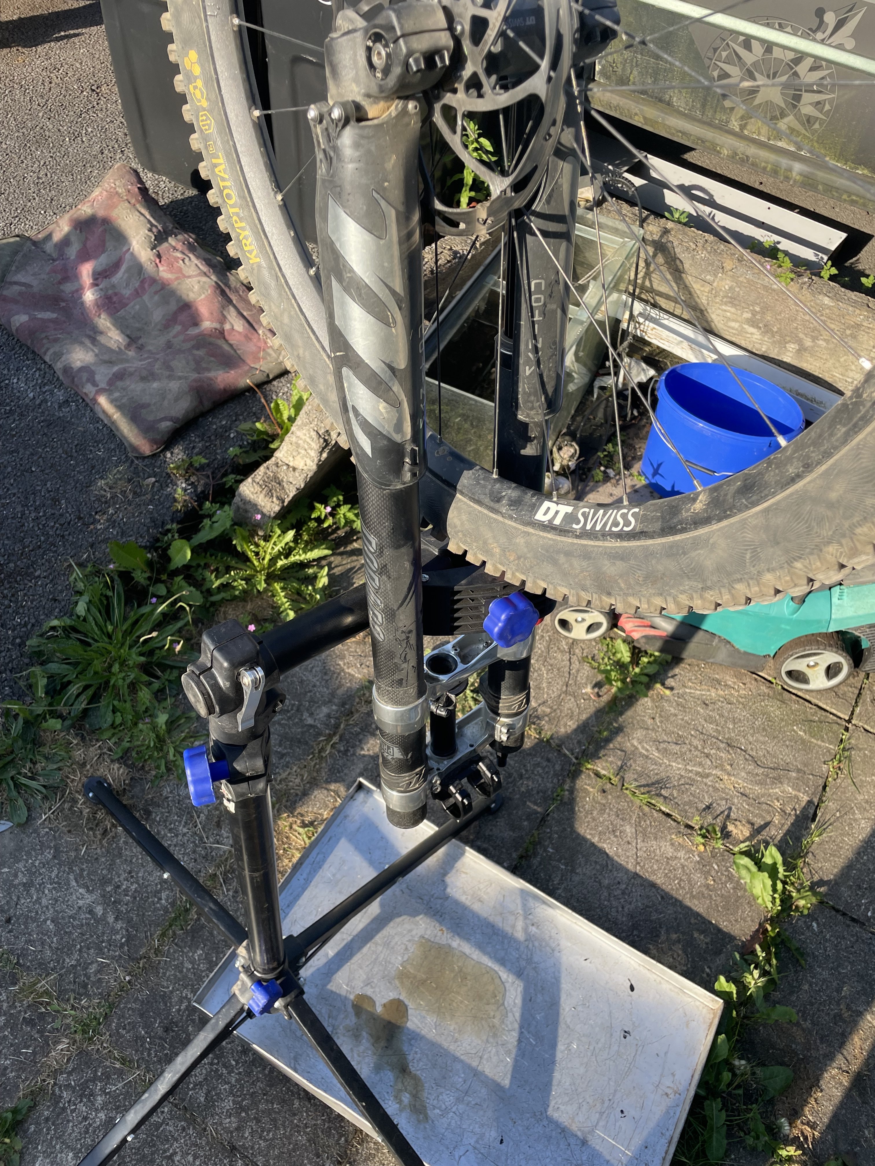

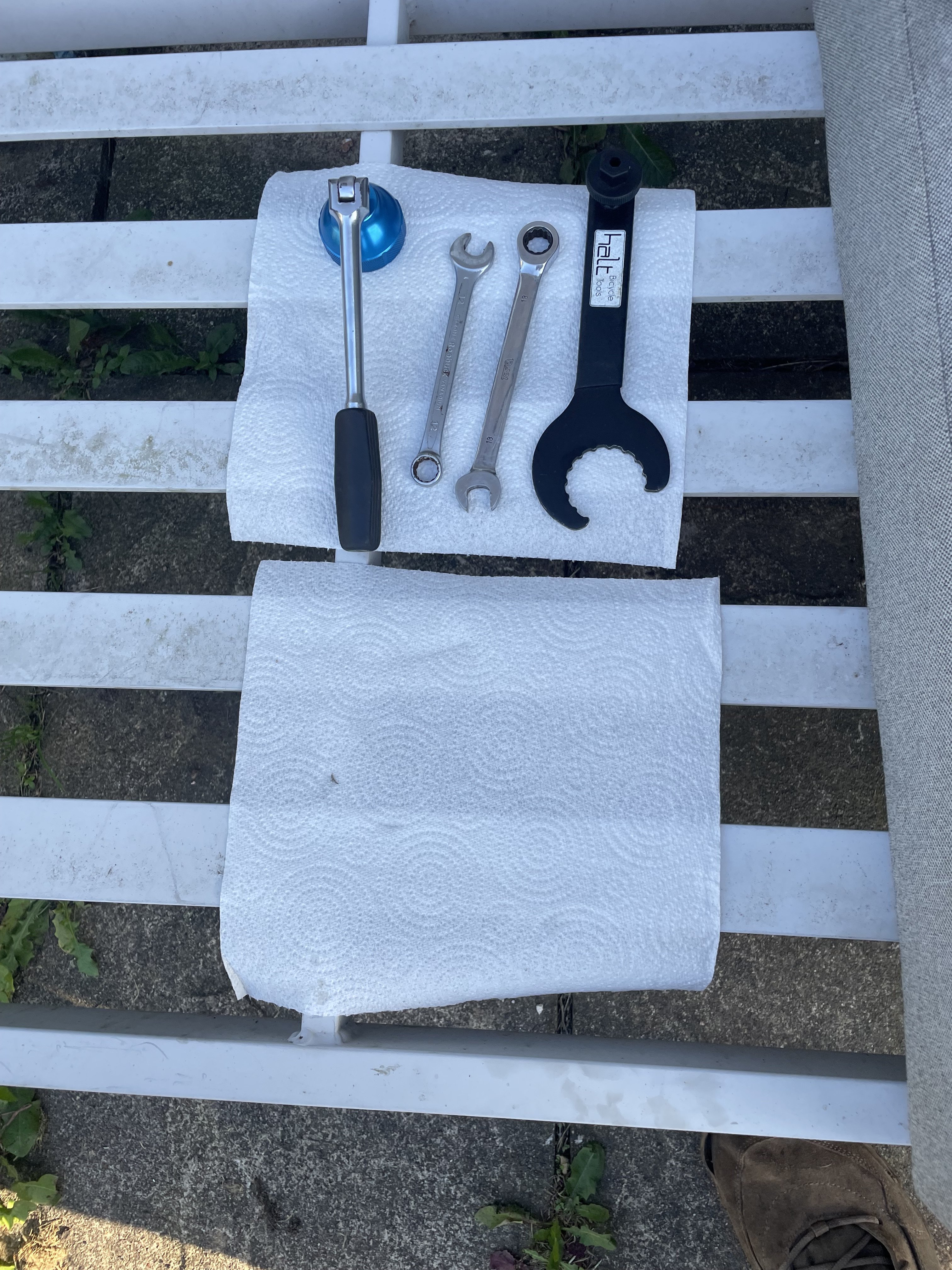

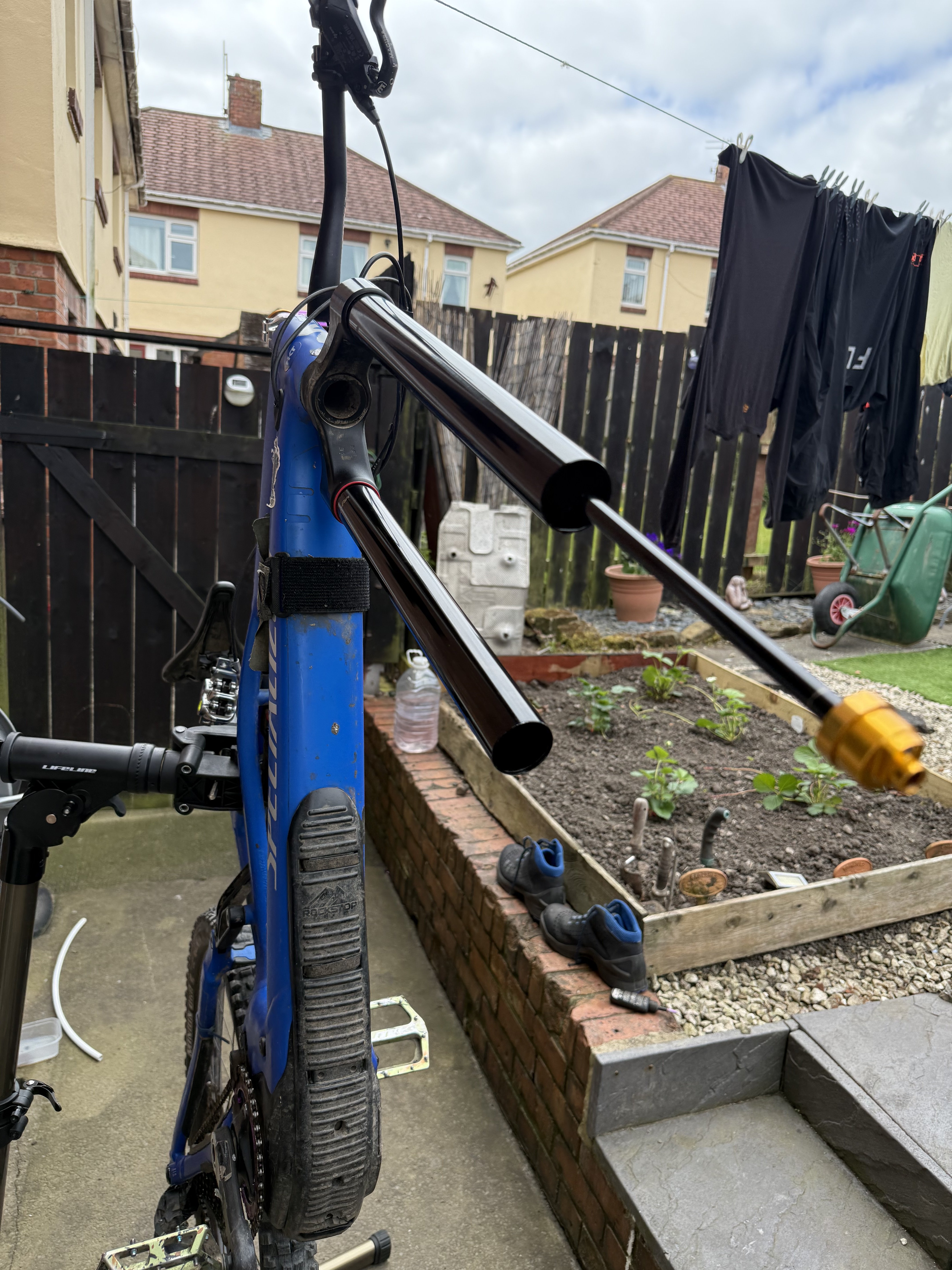

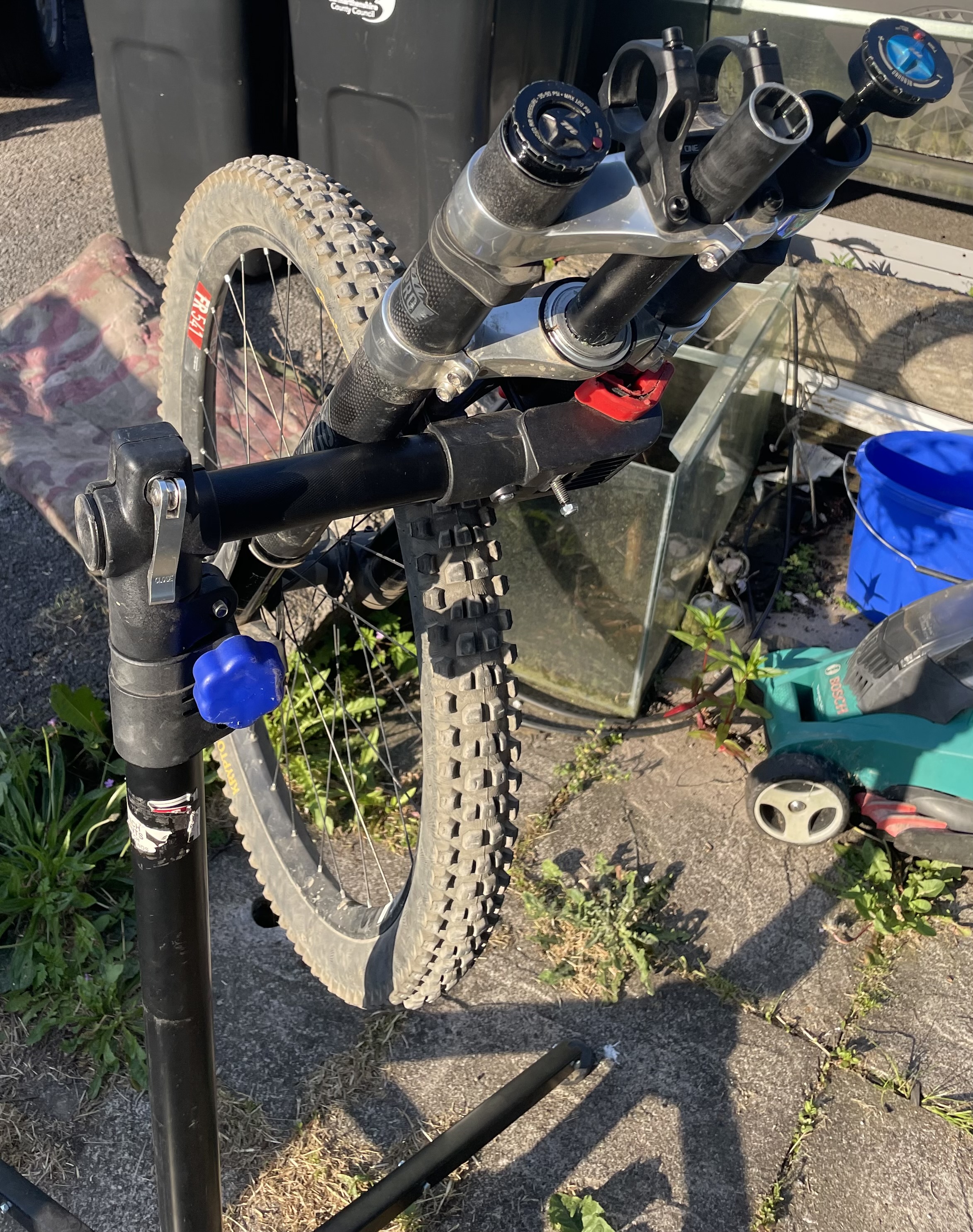

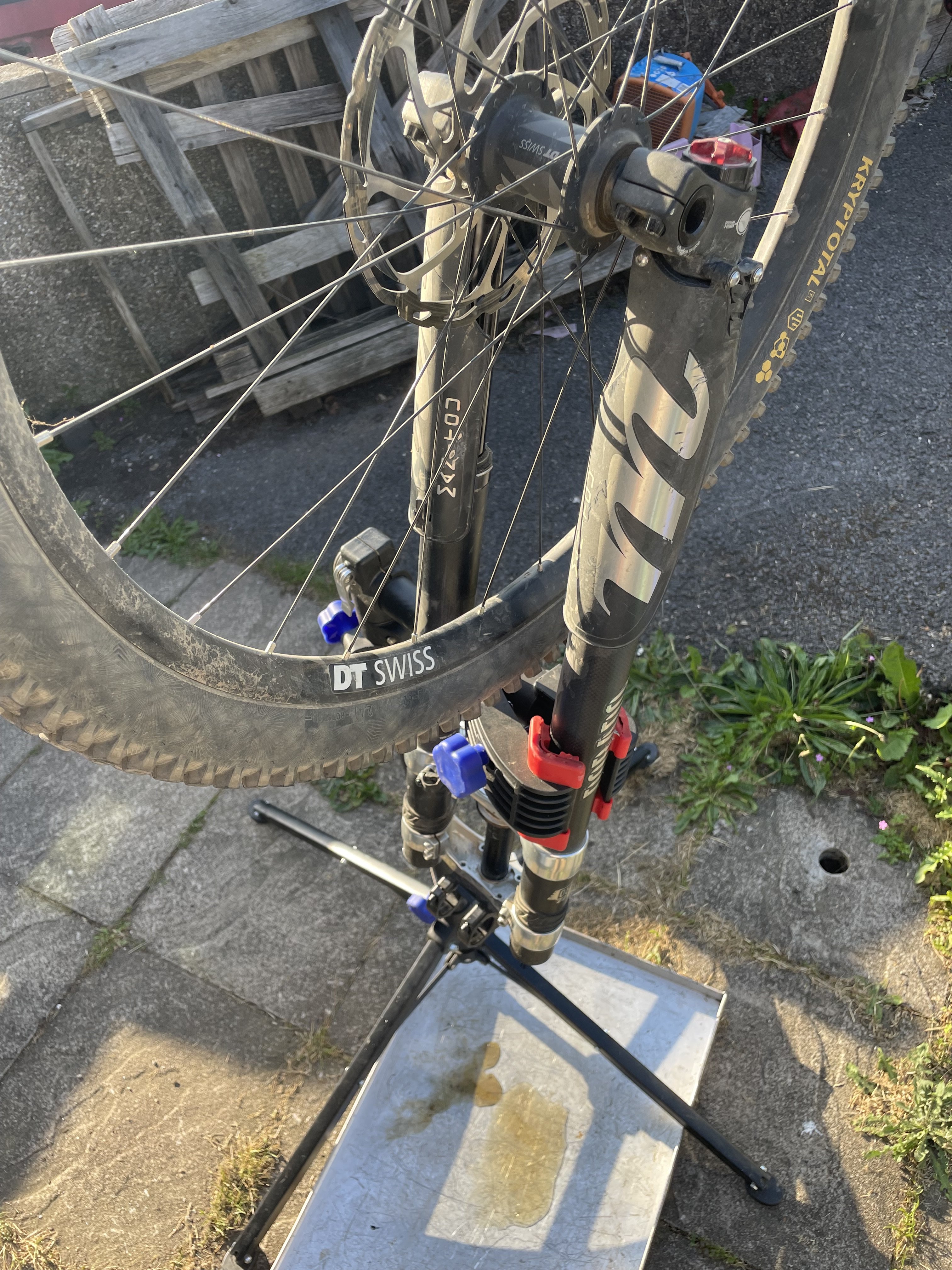

So, what did I do to my bike today? Nowt BUT what am I doing to my mrs’s bike?

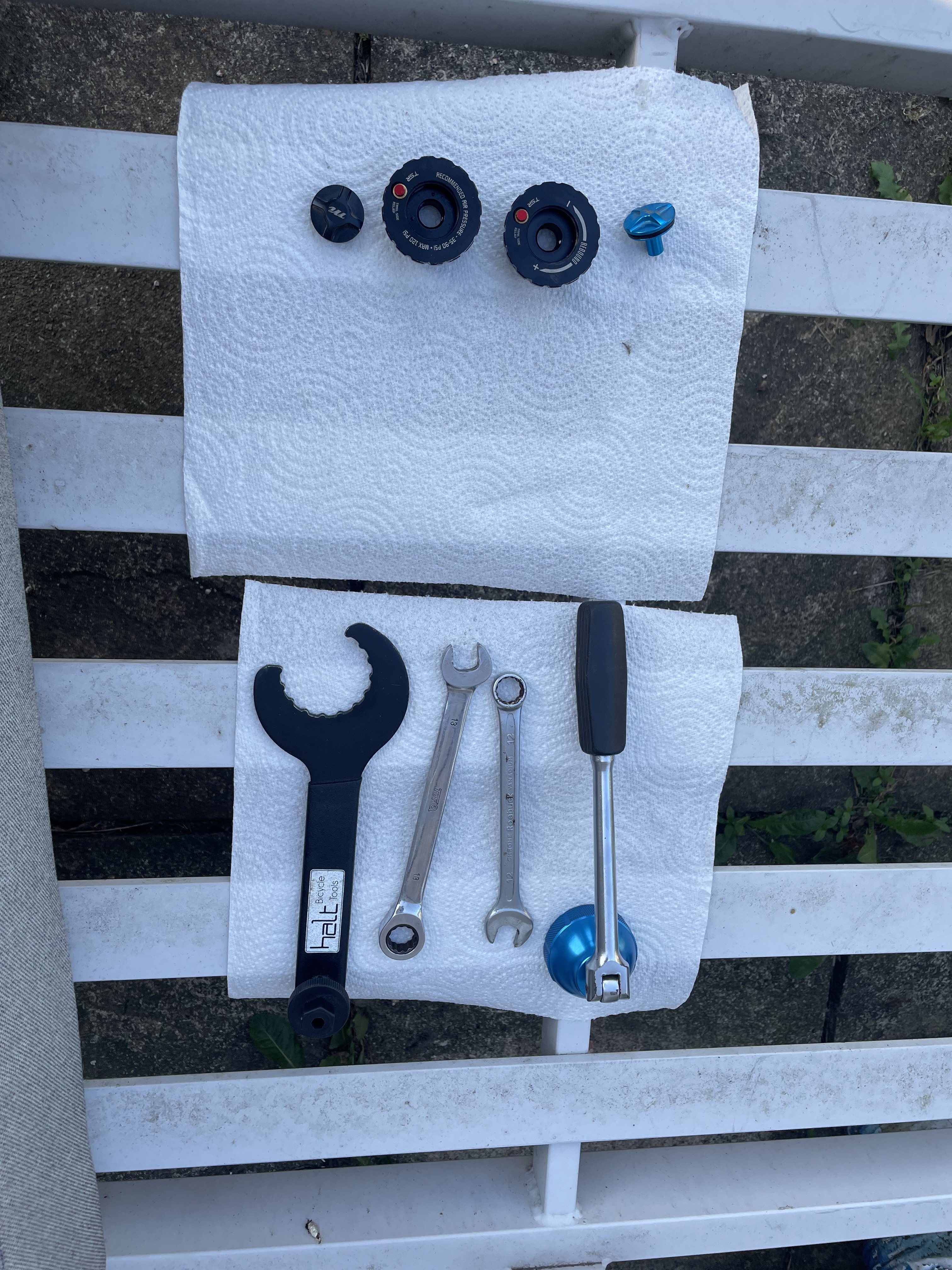

Suspension fork service, what’s normally called a ‘lower’ but in the case of usd forks like Manitou’s Dorado then it actually refers to ‘upper’ service 😜
Tools ready…
Tools used (& top caps / rebound adjuster and air spring valve cap as removed)
Oil drainage in action 😮
While they’re drained I’ll strip the airside to inspect and re-grease but there’s no reason to touch the damper 😎
Now to decide what lube to apply 🤷‍♂️
Then my pair are about due an inspection / lube, and my Mezzer forks, and……

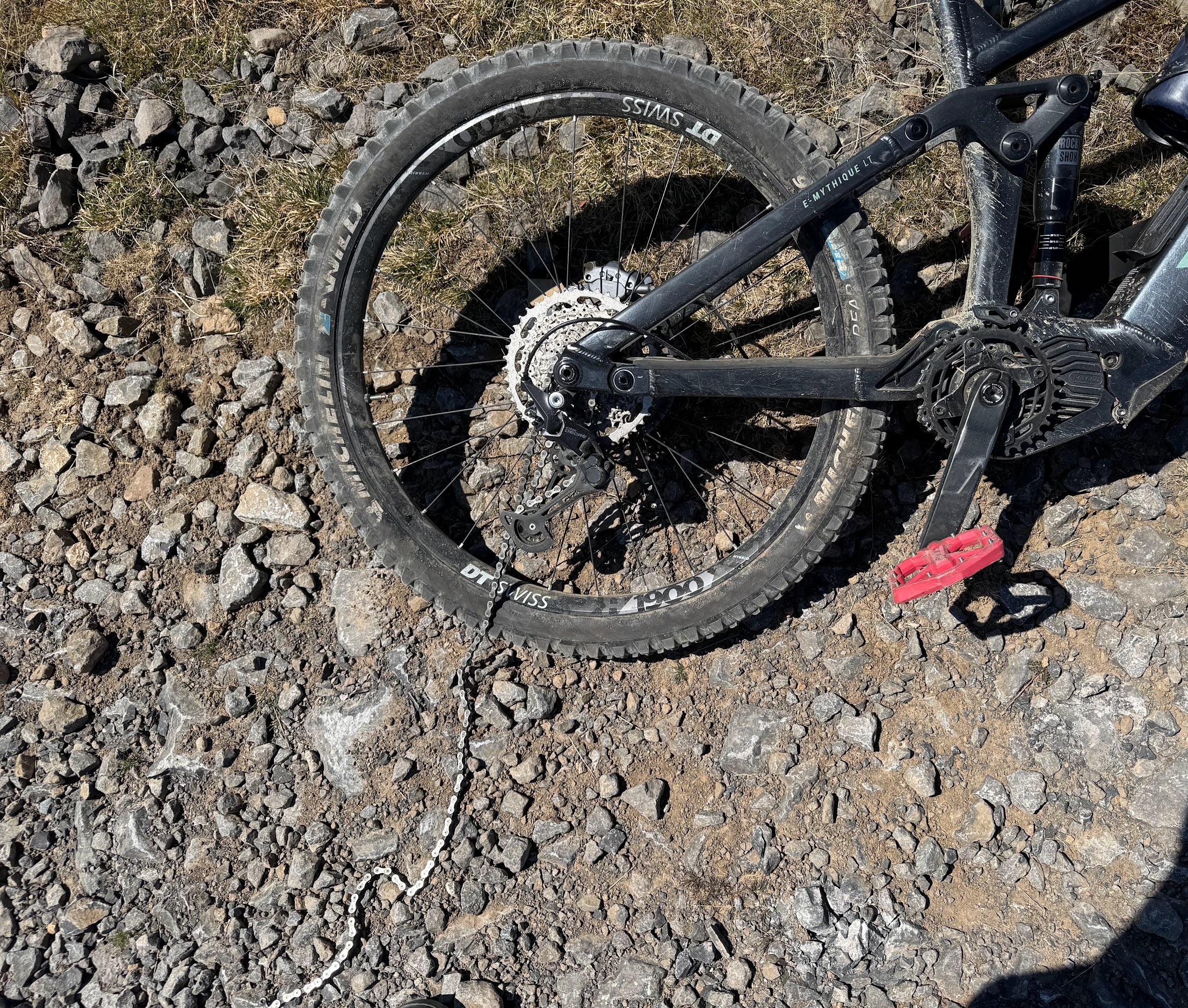

Snapped the chain, accidently shifted up twice and went on power too soon.
Lucked out as it snapped near the quick link and in such a way I could just reconnect use the quicklink and ride with a much shorter chain and avoid the big cog. Will add a spare quick link and chain breaker to what I carry.

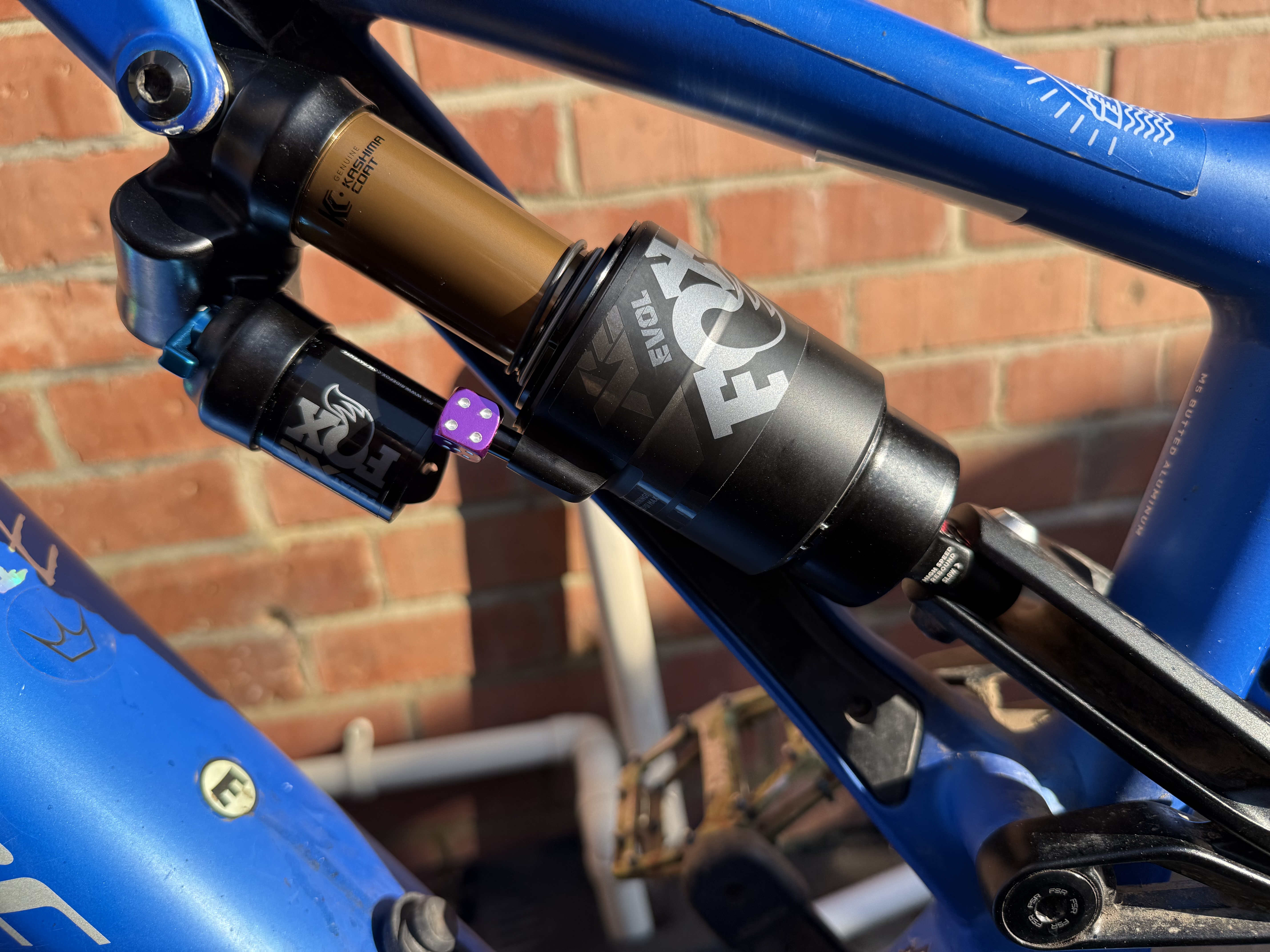

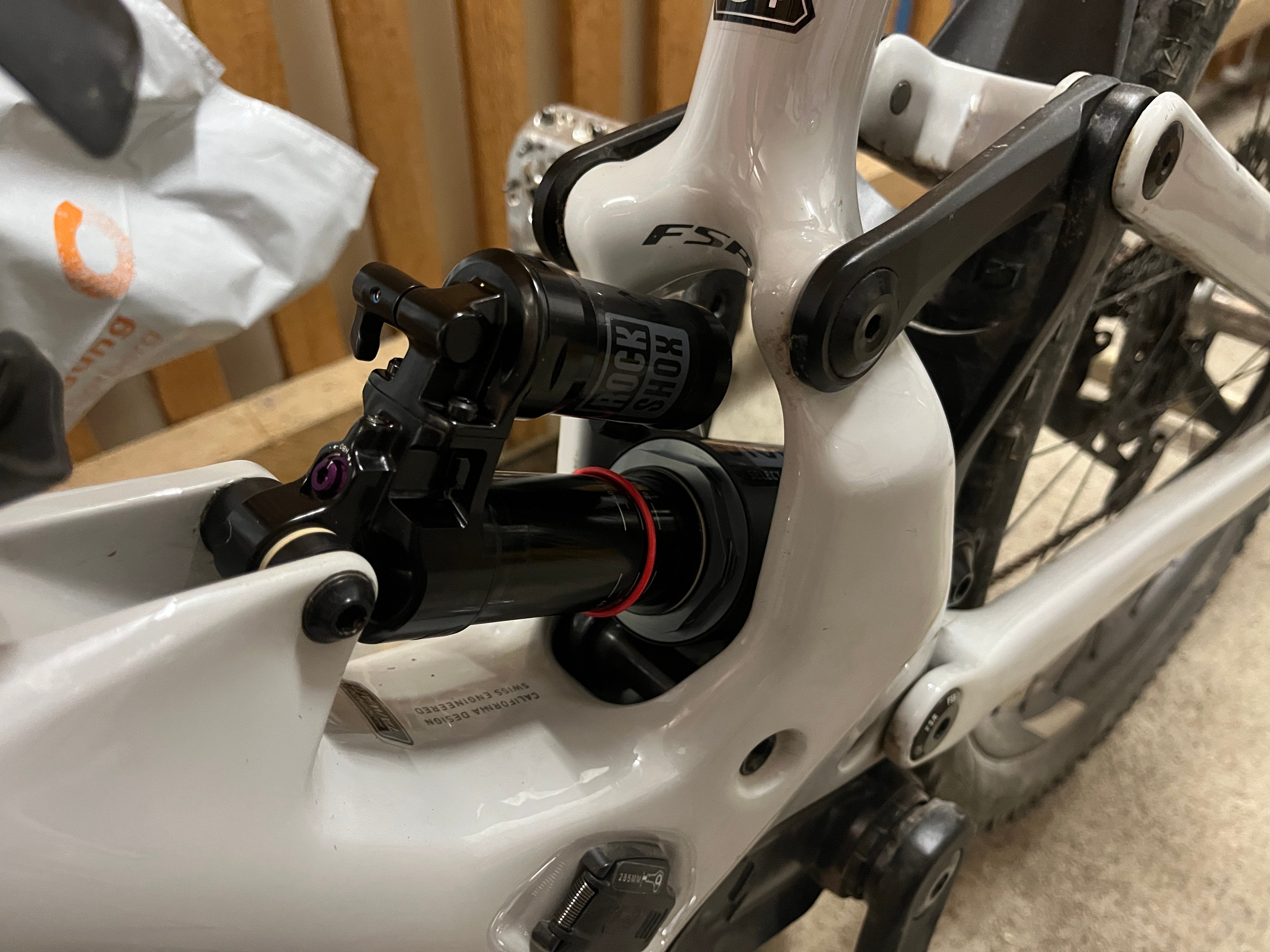

Fitted a heavier spring (550) to my Decoy MX in the never ending task of finding the perfect set up for my style.
Much as I love coils shocks, I wish the wife and I had air shocks as it makes it much easier (and cheaper) to set them up.
Also fitted a low friction WPS spacer to the wife’s coil to reduce binding when it compresses and ordered some Rev grips.

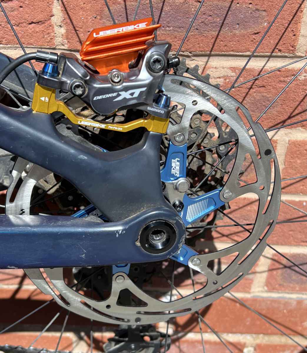

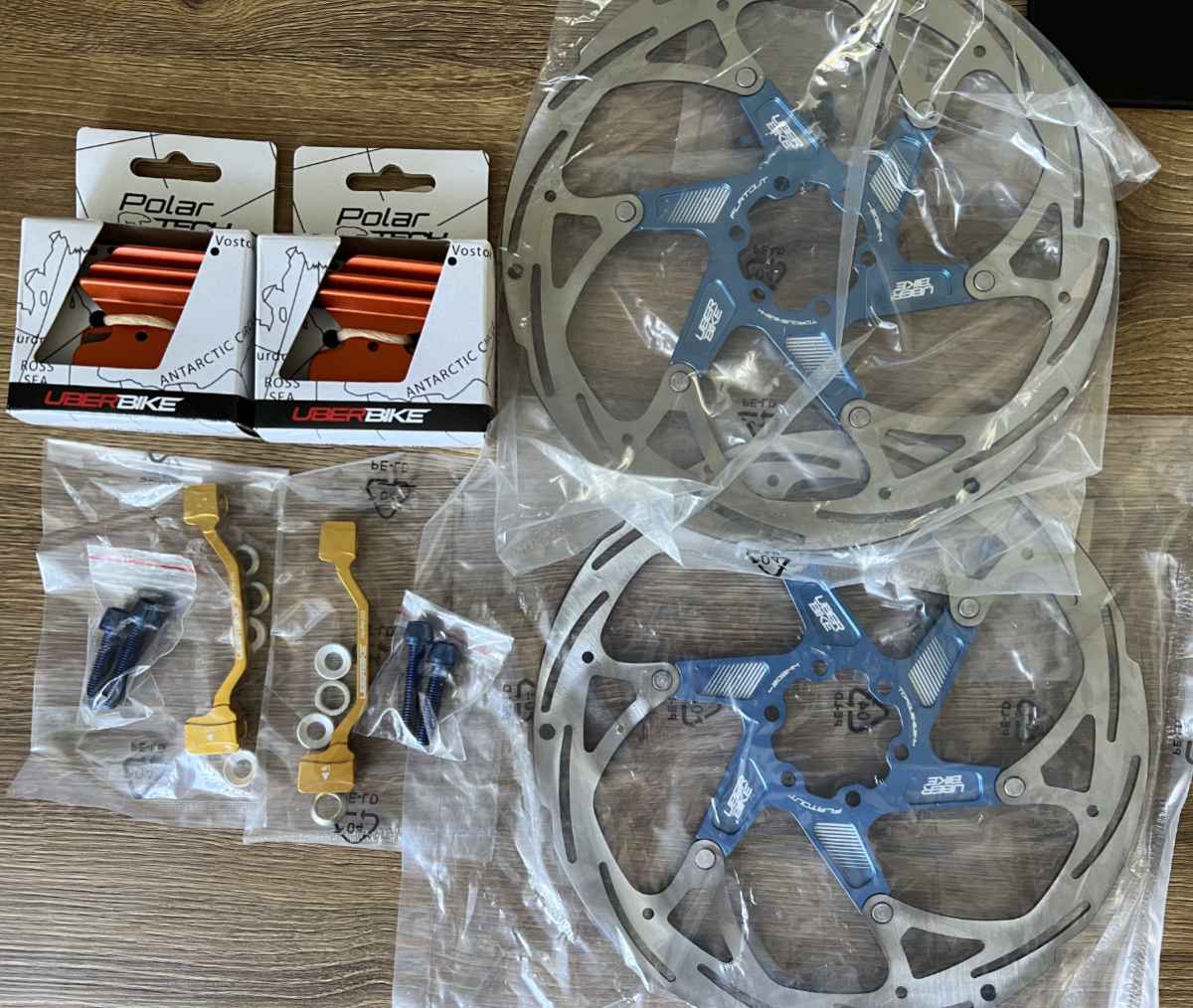

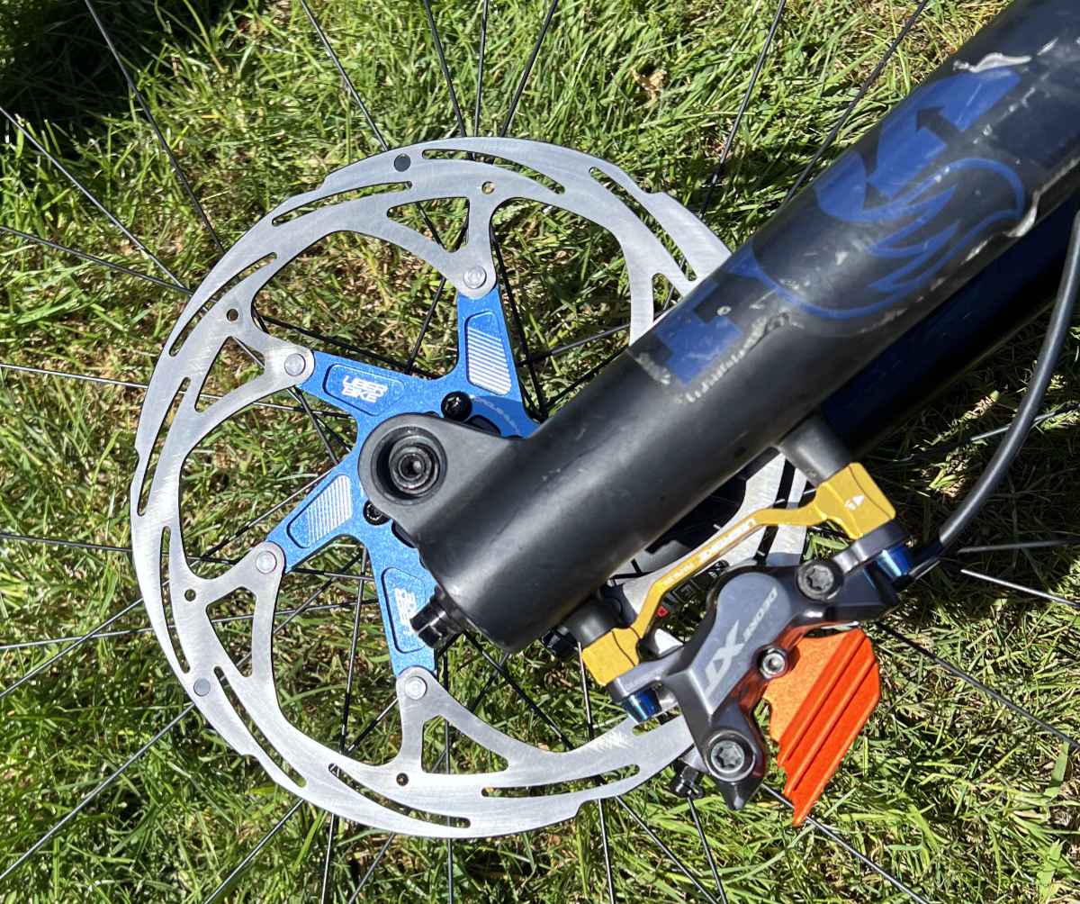

After 4 years and squealing brakes on the Ballater trip scaring everything and everyone on/near the trails, it was time for new discs and pads for the Rise...
Uber Bike in Rotherham were the chosen vendor as I've had numerous pads from them over the years. So whilst I was changing I might as well up the rotor size from 180 (F+R) to 203 (F+R). I also put a bit of bling in there with light blue rotors, gold adapters and blue bolts with orange finned pads! :D
Before: -
After: -

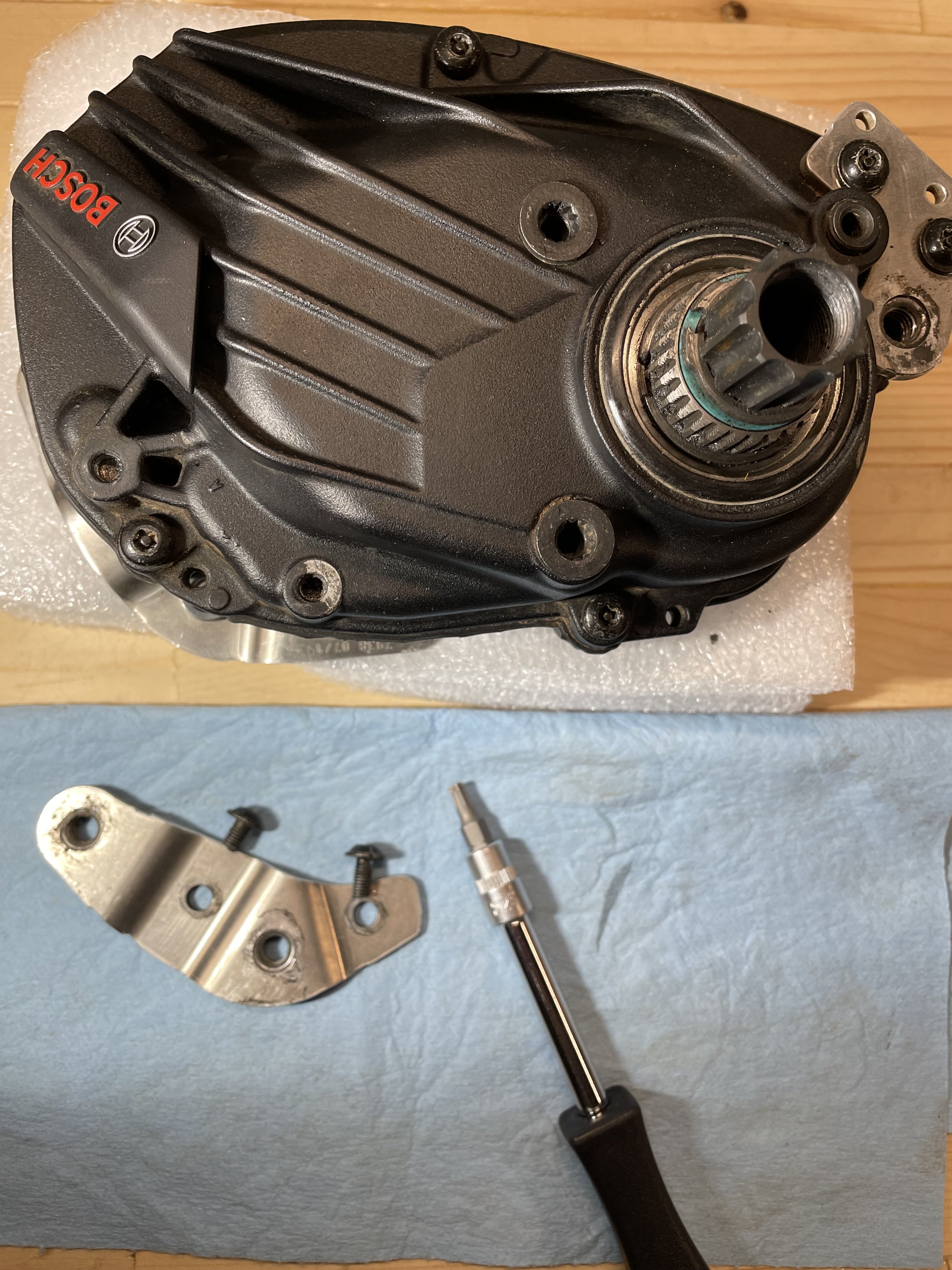

A worthy investigation when you hear a creak like that. Any type of weird noise while peddling triggers my search for the source. Glad you caught it before anymore damage occurred.
Sometimes it’s not the cost of parts but rather the downtime …which could take months. Those brackets are notorious for coming loose and ignoring that noise or sound can be costly.
Sheared bracket bolts are almost impossible to remove from a magnesium casing. Thanks to the Motor Repair Centre a replacement cost my buddy $110. His downtime on the bike can’t be measured though.
I had same creaking issue when peddling hard. Replaced all 14 suspension bearings - still creaked. Found reviews like this on motor mount creaks so tried that next. I found that all of the bolts were still tight and properly torqued up. I did notice, however that the frame was rubbing against the motor housing (see pic). Looks like the original build had the motor a bit too far to the back causing this rub (and creak) between the housing and the frame under load. Since there is a bit of play on the bracket holes , I shifted the front mounts with these brackets adjusting the motor a tiny bit further forward. When re-mounted, the back plate screws are accessible so after bolting the front to the frame, I simply adjusted the back plates to line up with the frame holes. Note - in an abundance of caution, I also added some anti-seize between all metal to metal surfaces. No more creaks. So even if your bolts are still tight, look for this problem.
