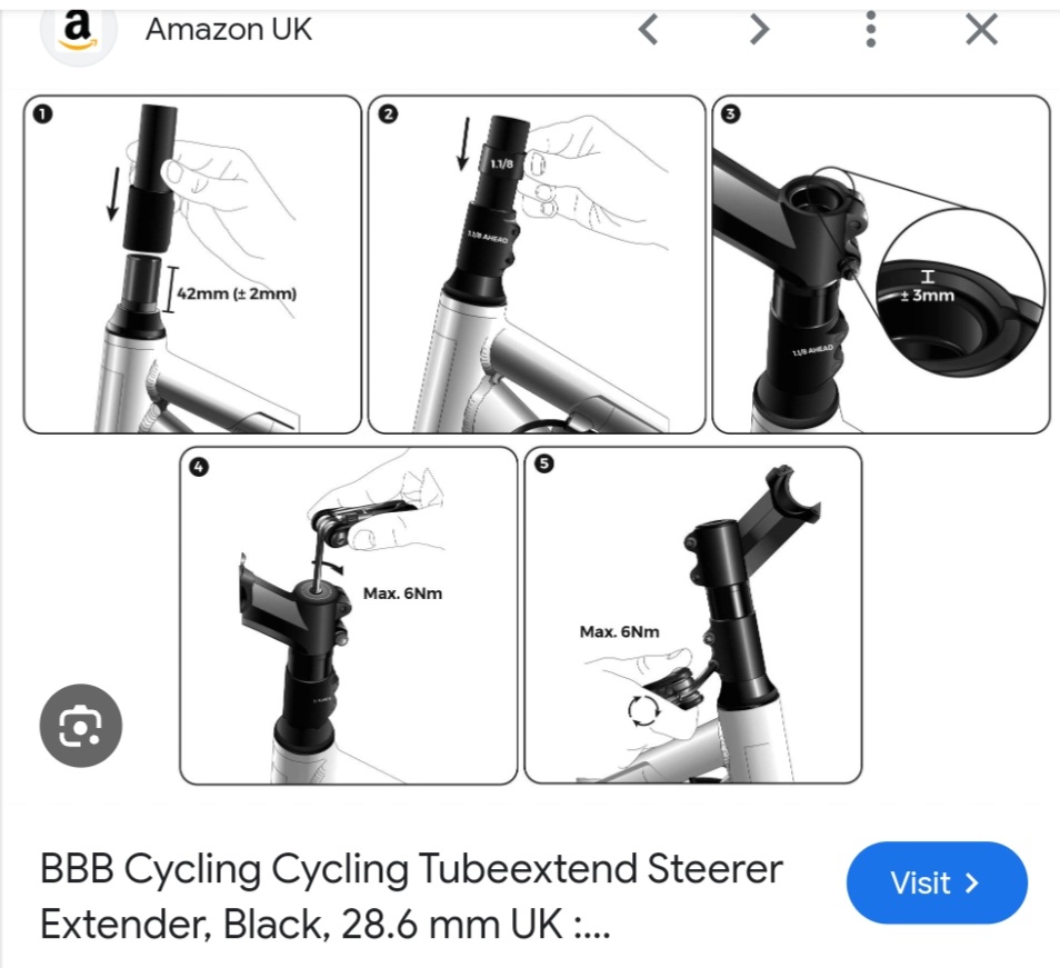

Raised the bars on my wife's 2022 Trek Rail and her arm pump disappeared. The fork steerer was of course cut silly short to enhance show room appeal.
Used a BBB TubeExtend BHP-22. As long as the extender is at least as strong as the fork steerer (which the BBB part is) then there are no safety issue. IIRC it is eMTB rated, whatever that means (probably just that it's fjcking strong).
Cheers, the bike has 170mm forks so the bars are actually quite high anyway. She’s not ridden it in anything hard enough (yesterday was she maiden voyage, but with small kids it was just a few short flow laps. We’re just looking at possible options once we start hitting bigger stuff sans urchins.
Fork length might be 170mm but the steerer is probably cut very short. A TubeExtend raises bar height but has no effect on fork length (as below).
Thank’s but the A2C combined with stem, spacers and bars has brought the stack height up to what she needs. That steerer extender would make it too high. I’ve also had bad experiences with cheap extenders (and bars/stems) in the past.

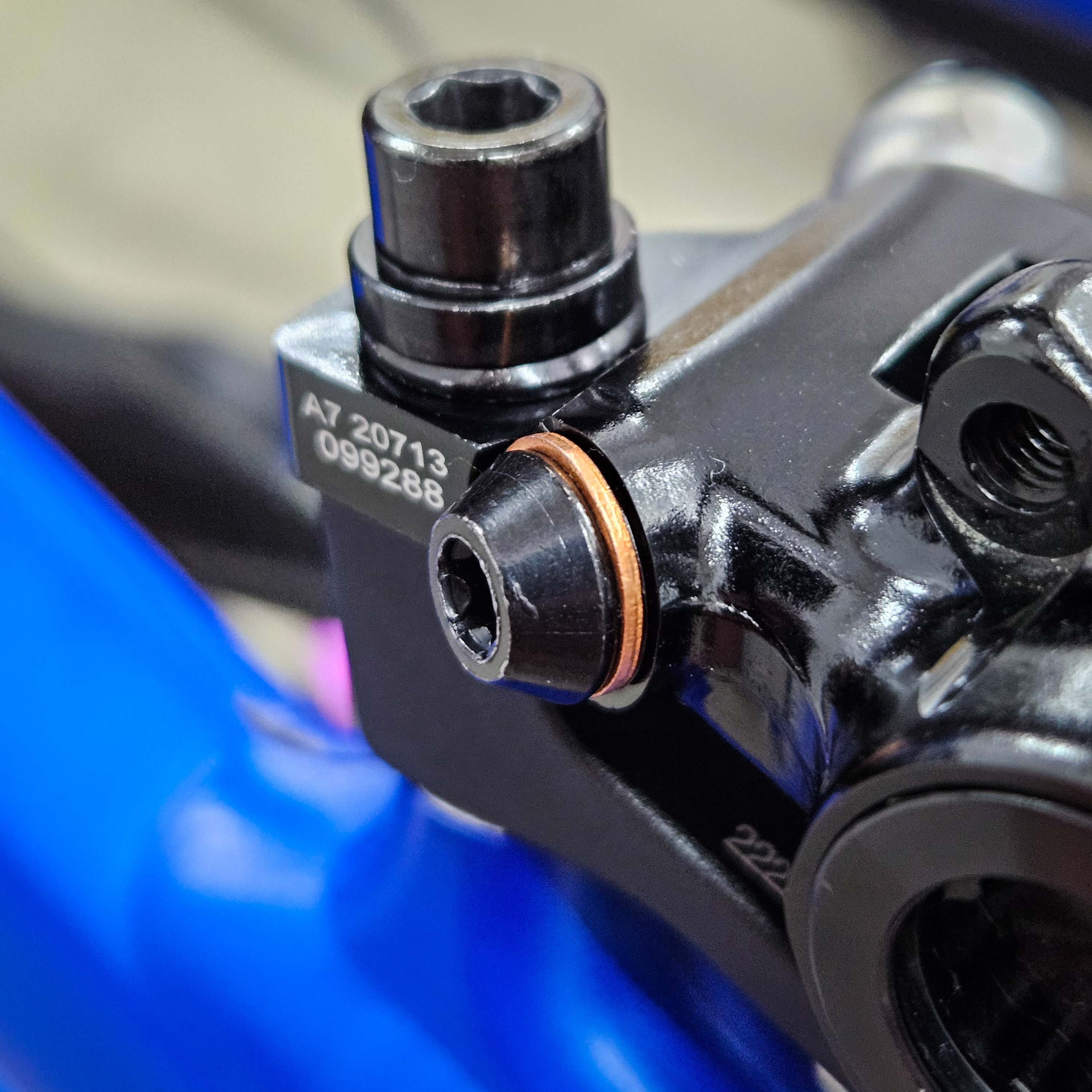

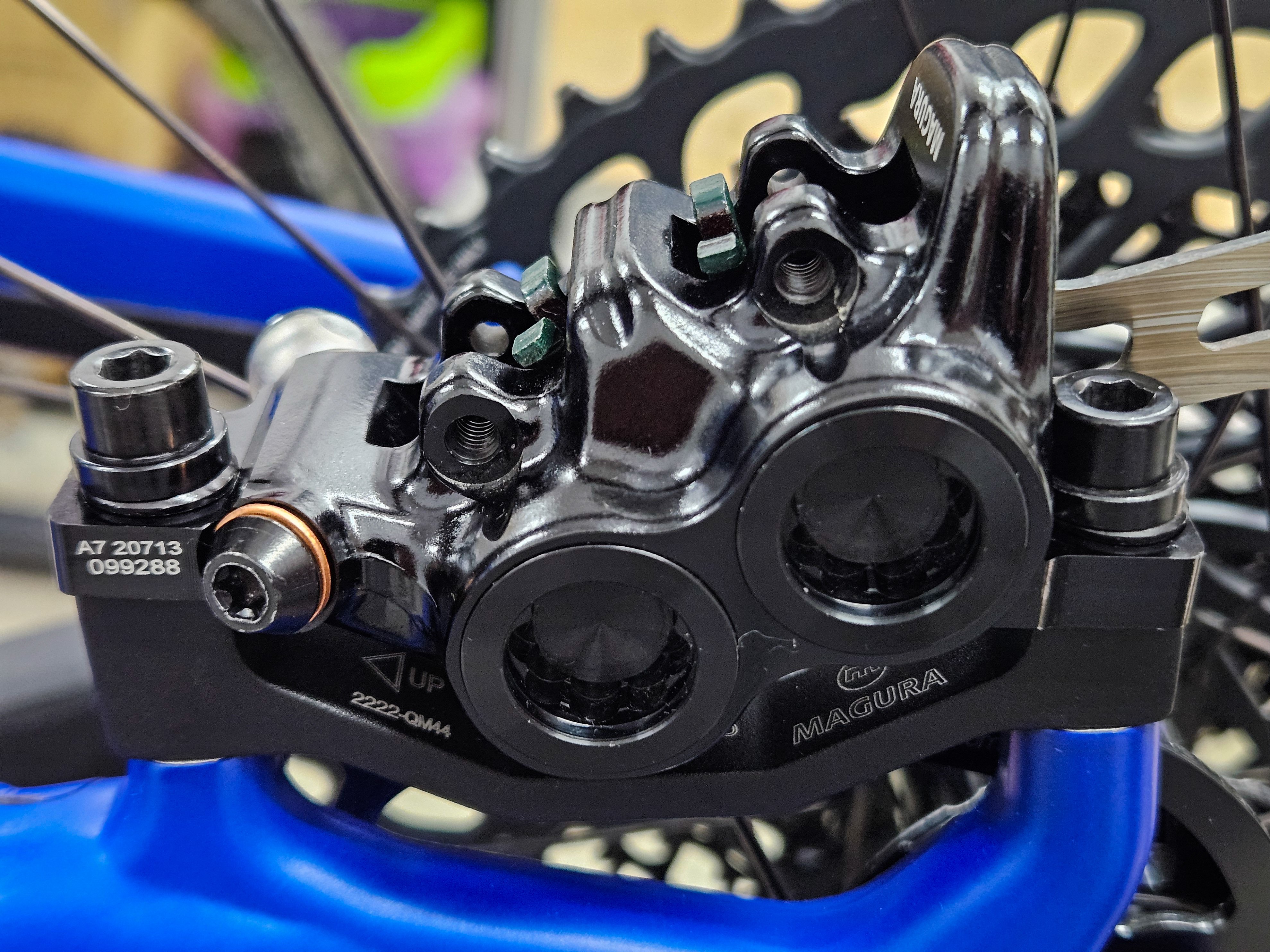

Bled the brakes on my wife's Levo (running Shigura setup: Saint levers + MT5 calipers) and noticed the rear caliper started leaking from the bleed port a couple weeks later. The bike hadn’t even been ridden yet this season. Pulled the bleed screw, checked everything (looked fine), reinstalled it, applied pressure, seemed OK at first. But a week later, it was wet again.
Contacted Magura and, of course, they recommended buying a new caliper. With nothing to lose, I tried a small copper washer under the bleed screw. Problem solved. Bone dry now, even under pressure.
Cheap and simple fix that saved a caliper.

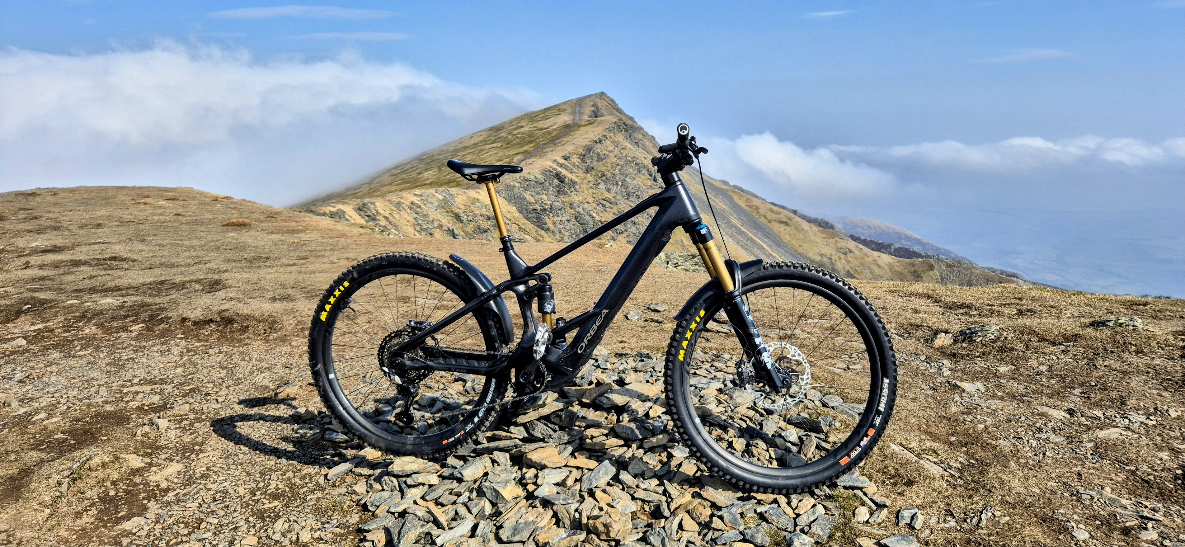

Finally, I have my Levo SL back from the dealer after a shock and fork maintenance. I took the chance to add 10 mm to the Lyrik, so the bike is now 160/150 mm. I’m excited to get on the trails as soon as possible.
I also replaced the axles and bushings on my DMR V12 pedals and the rear Guide RE with Code R, which I already have on the front. According to my LBS, the Guide’s lever is broken beyond repair.
So, after all, the new season can start!

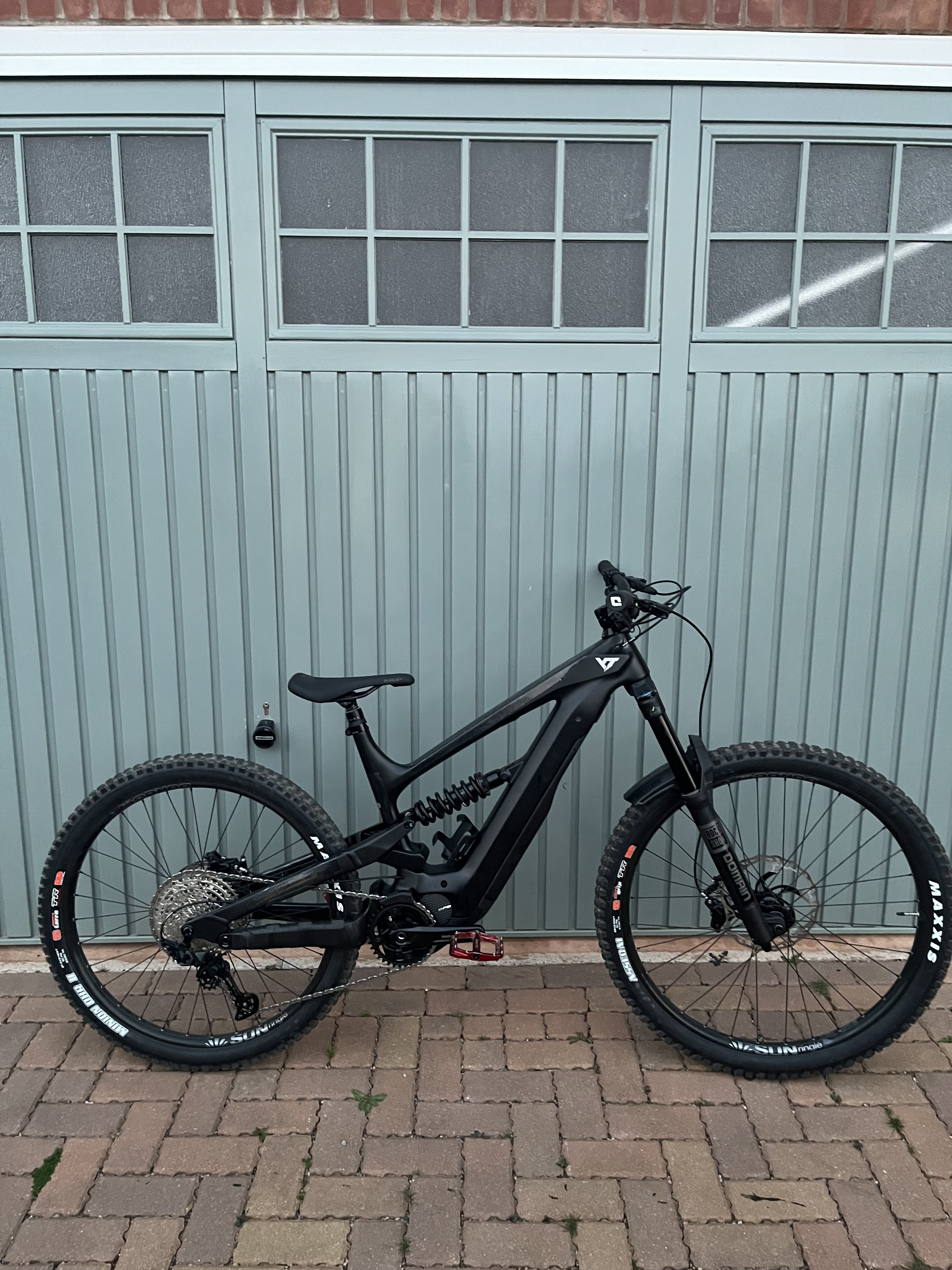

Built up, set up, firmware updated, helitaped, fully charged
and ready for its maiden voyage once the kids are dropped off at school. Hopefully I should be able to iron out any teething niggles on some local secret tracks.
It’s nothing fancy, but it’s all basic stuff that works and is reliable (it’s a Core 3 but my wife nicked the Fox suspension for her Core 1).

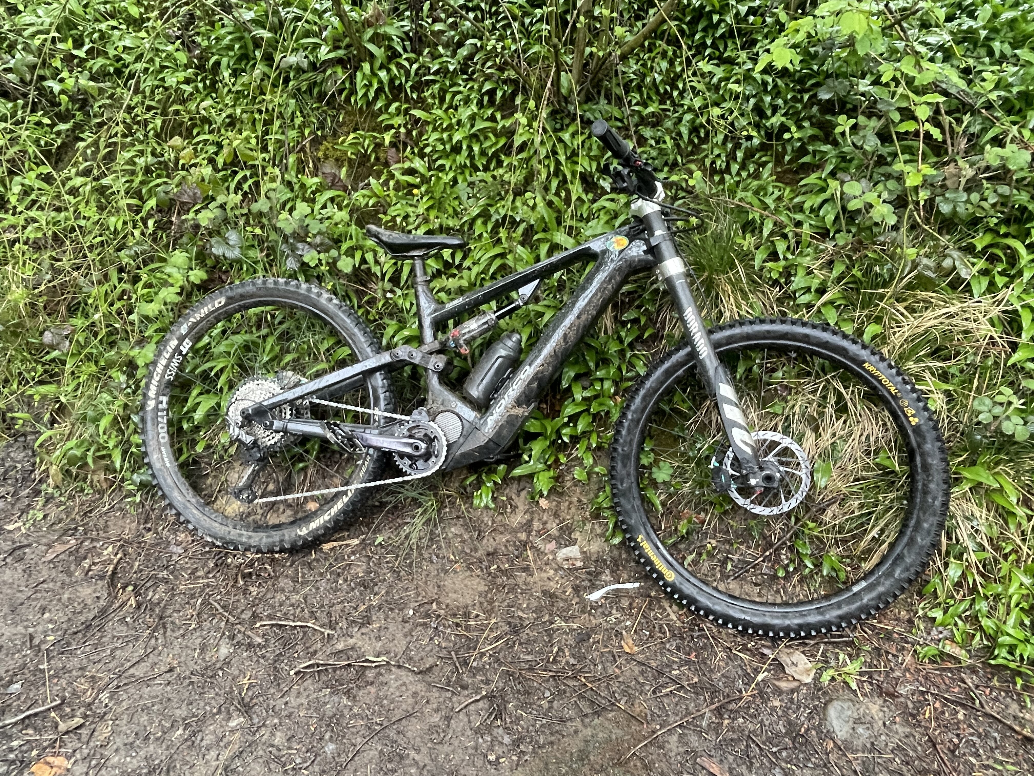

Okay, yesterday we fitted & bled the new Maven ultimate brakes so today was testing and bedding-in joy 🤨
And the weather was horrible so Bpw at its finest 😎
Managed to use all of the travel 😎
And most of the rear travel 🙄
Maybe a few psi mort for tomorrows ride…
As usual, managed to heat the brakes even with this weather!

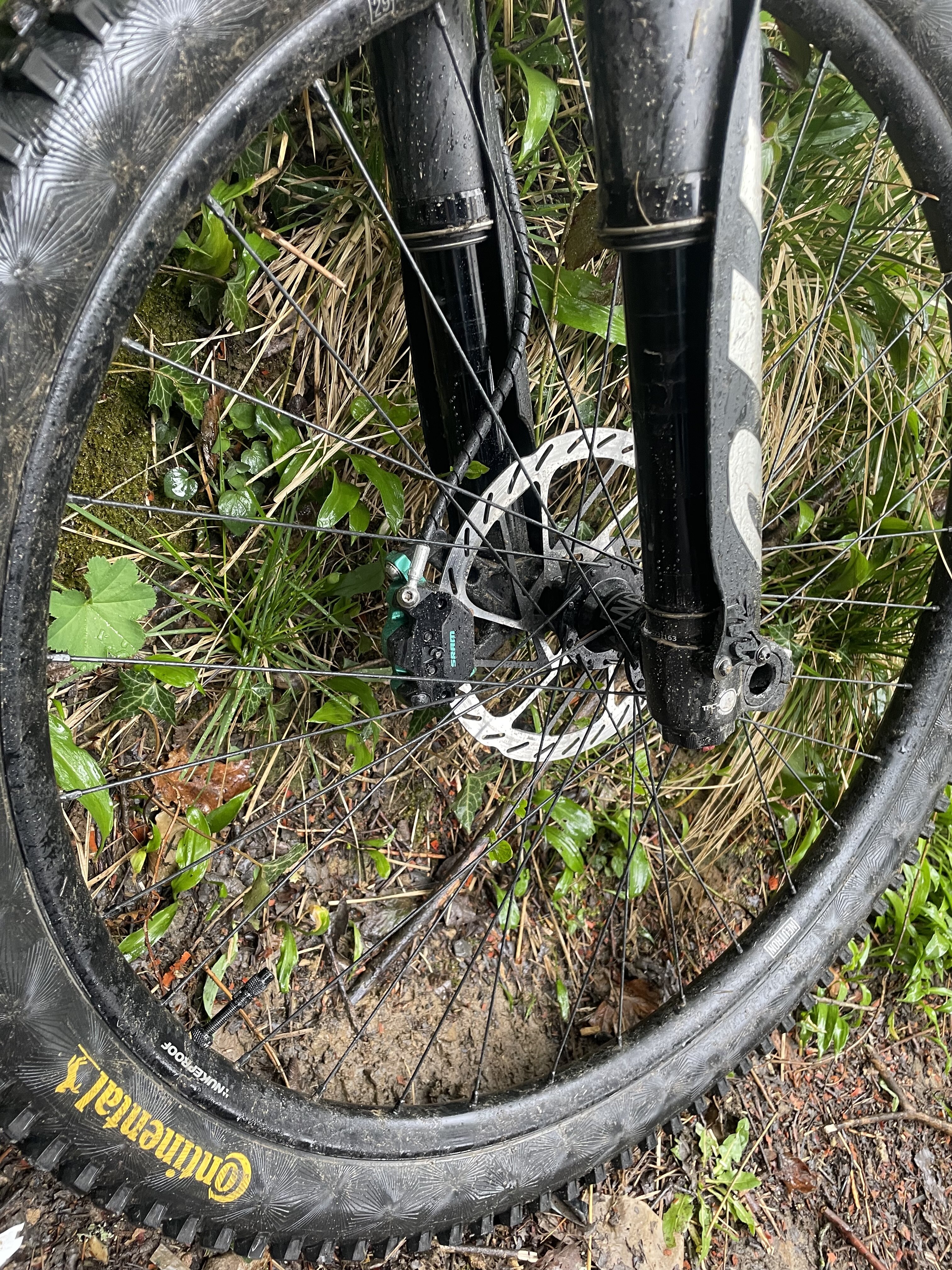

Your rear brake looks odd, have you noticed? Looks like pads are not contacting whole disc? And it`s bleeding also 😀

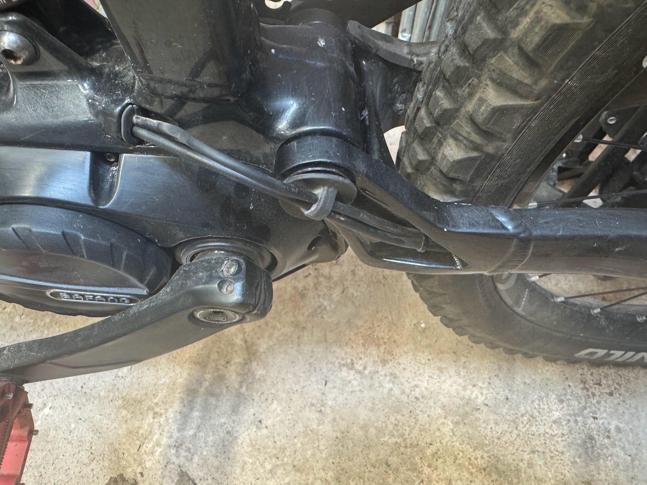

I had a creak I thought was coming from the headset/fork.
Went round with an allen key and tightened everything I saw on the bike and the creak was still there so decided to do a lowers service on the fork and clean out the headset. Upper headset bearing was a bit rough so changed that and ... creak still there
In hindsight it's obvious but the main pivot is behind this cover, tightned that and no more creak. Will see if it loosens itself again, I've never changed any frame bearings before, not sure if I'd attempt myself or take it a bike shop.

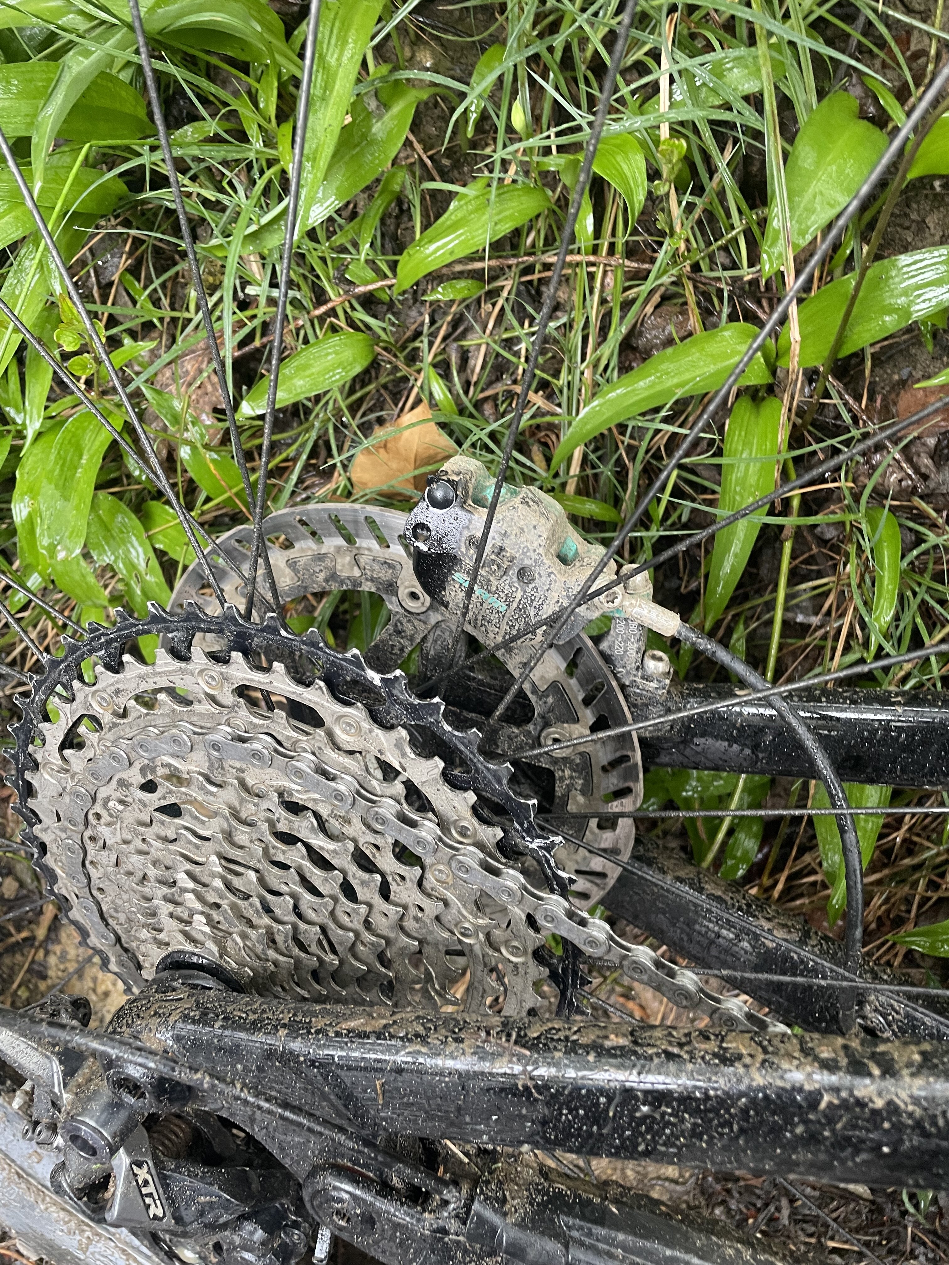

thats the dögshit magura discs - used as they were the only 203mm diameter discs i had that also were centrelock compatable AND had provision to take a magnet to signal the motor's speed-sensor :cautious:
a little bit of 'it'll fit so I'll use it for a ride (or two / three / four) before relenting and swapping the DT Swiss wheel (centrelock) for a Nukeproof Horizon Pro wheel (6-bolt):p
