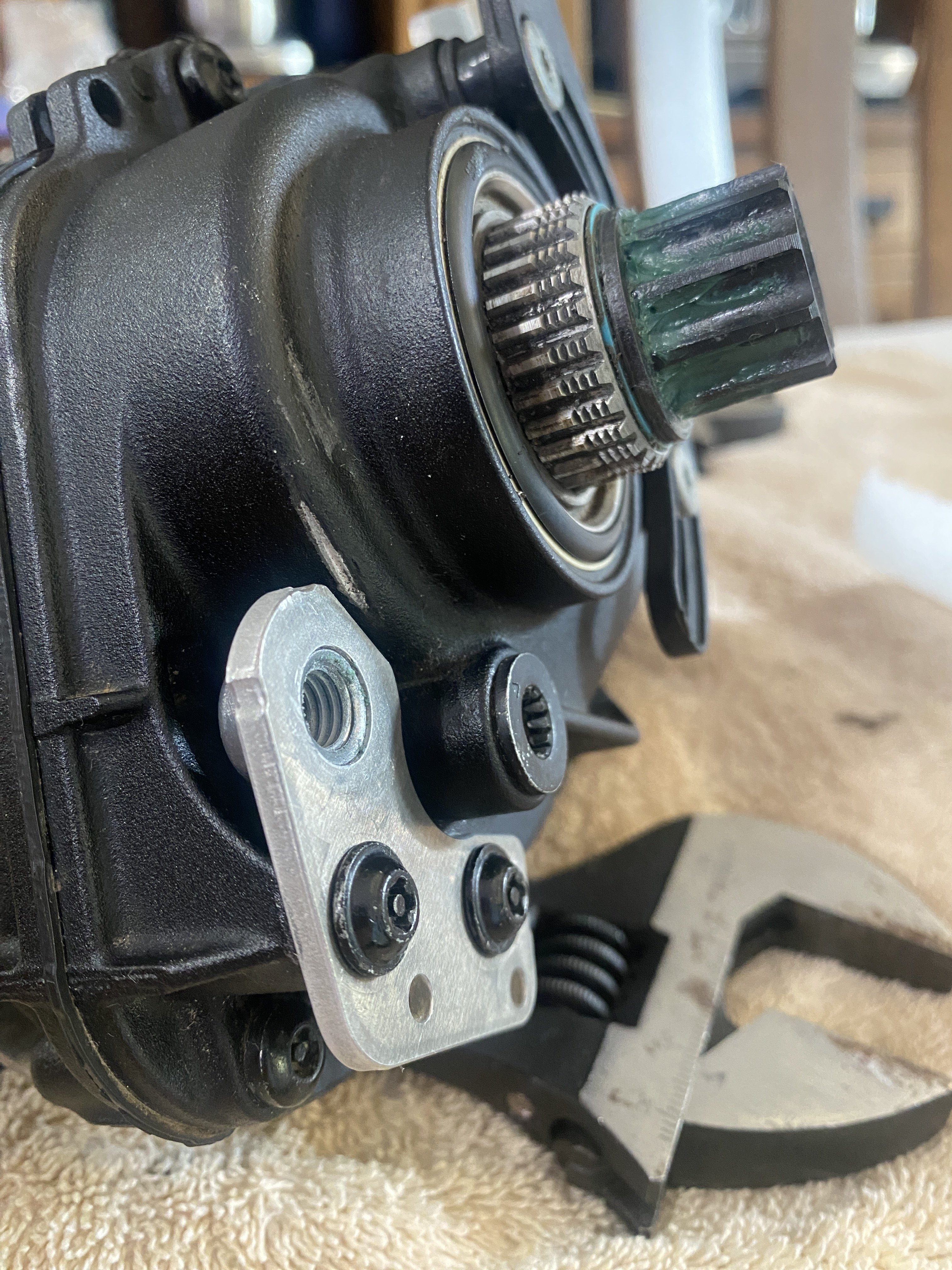

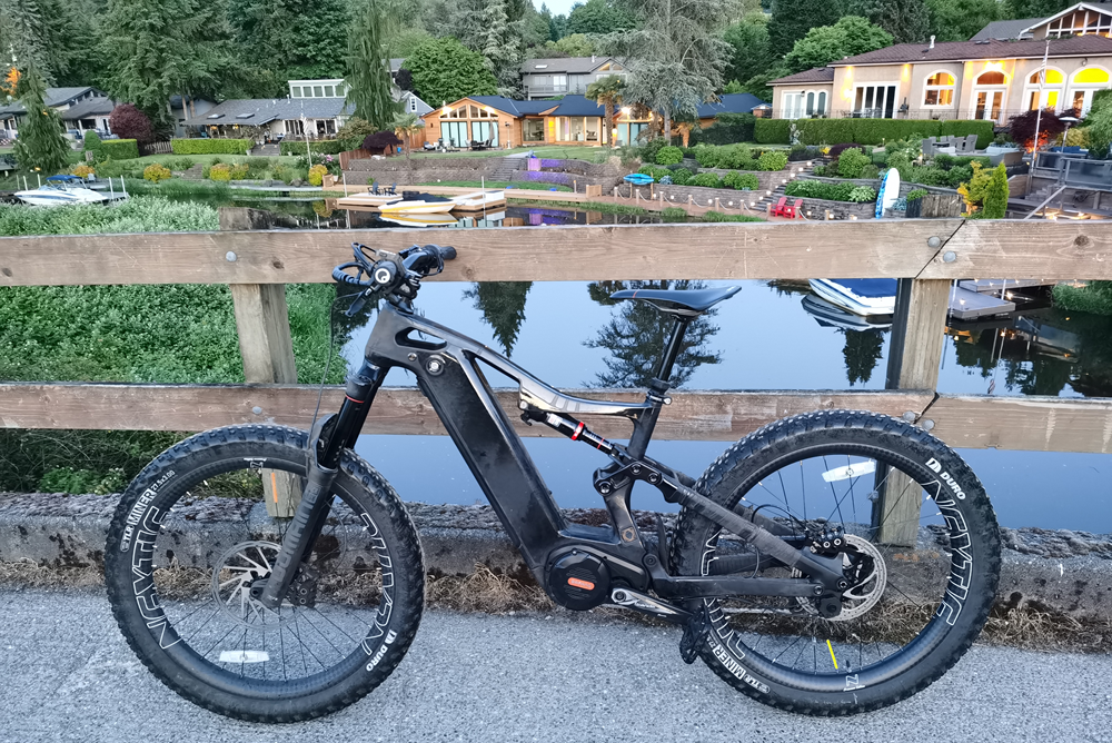

I had same creaking issue when peddling hard. Replaced all 14 suspension bearings - still creaked. Found reviews like this on motor mount creaks so tried that next. I found that all of the bolts were still tight and properly torqued up. I did notice, however that the frame was rubbing against the motor housing (see pic). Looks like the original build had the motor a bit too far to the back causing this rub (and creak) between the housing and the frame under load. Since there is a bit of play on the bracket holes , I shifted the front mounts with these brackets adjusting the motor a tiny bit further forward. When re-mounted, the back plate screws are accessible so after bolting the front to the frame, I simply adjusted the back plates to line up with the frame holes. Note - in an abundance of caution, I also added some anti-seize between all metal to metal surfaces. No more creaks. So even if your bolts are still tight, look for this problem.
Good info and solution. Slightly adjusting the bracket position is possible for proper mounting alignment.
Bracket bolts becoming loose or shearing off seems to be a problem on some older Trek bikes. On a recent Trek bike I discovered a very small crack around the motor mount insert. This allowed small movement of the motor which eventually led to the bracket bolts shearing off. The crack is barely visible but there is some very slight flexing which leads to motor movement.
IMO this led to the shearing of the bracket bolts. The frame is at fault. We will see if Trek will honour their Lifetime warranty on frames. They could easily explain this away as “operator abuse “ or “extreme abuse “. This could cost him a frame and motor.
I know the owner is not an aggressive rider. No extreme jumps , some drops, …average riding imo. He has less than a 1/4 of the mileage that I have (exact same bike and year , Rail 9.7).

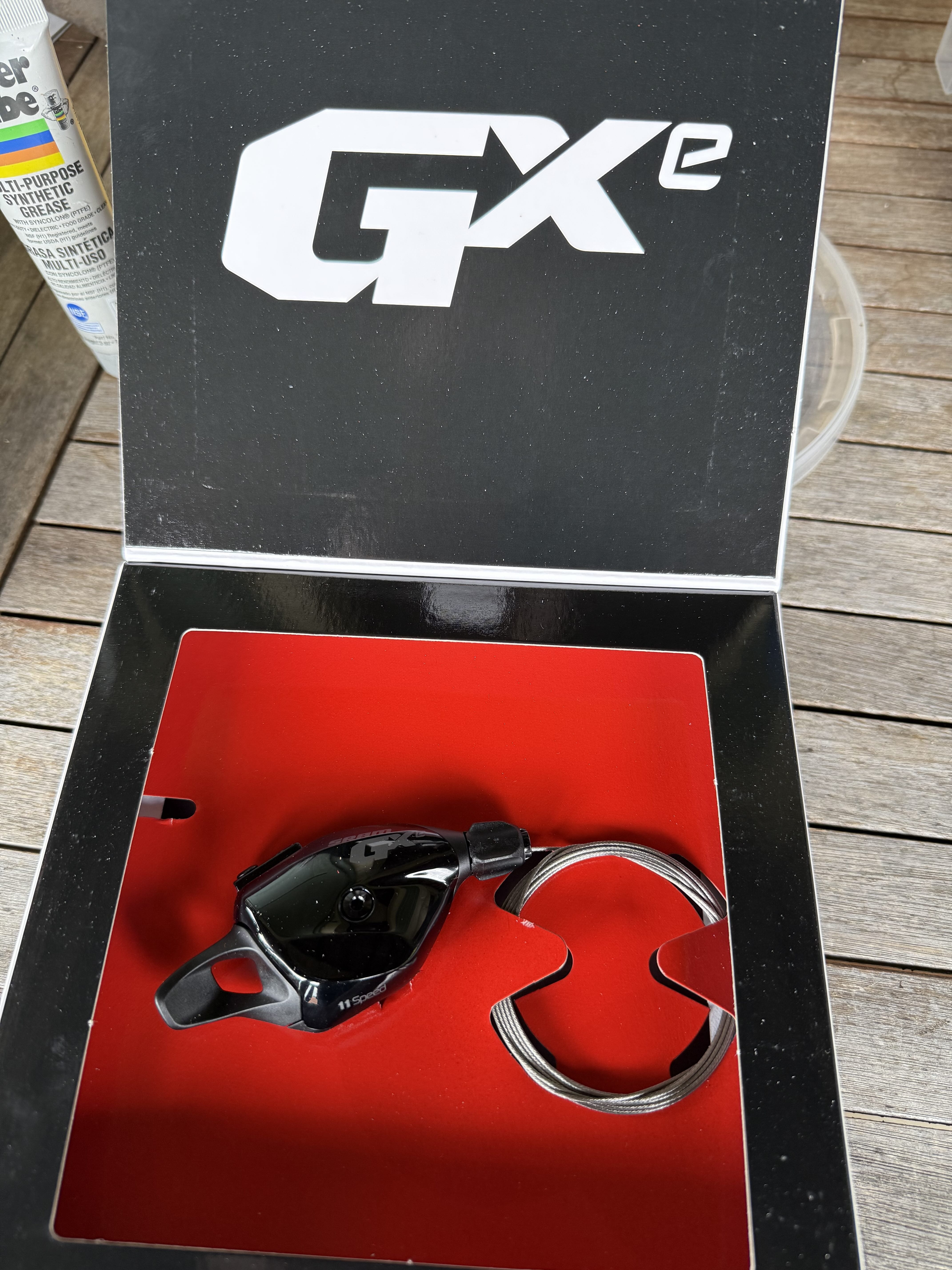

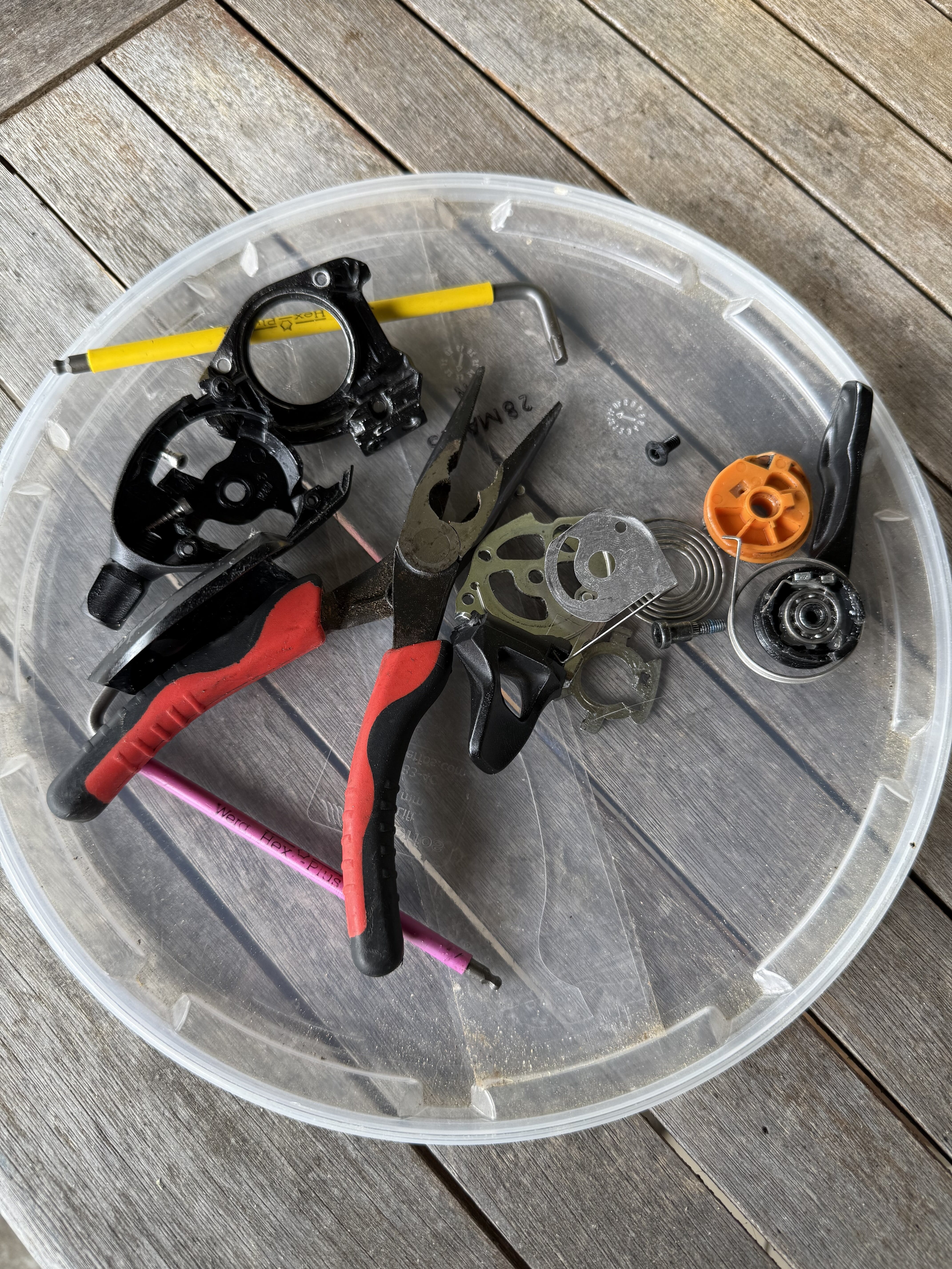

I noticed that the end of the deraillor cable had been ripped off so decided to fit a new one, I`d done it before, took five minutes.
So without checking how to do it I removed the shifter and promptly undid the wrong screws:
This is the result:
And this is the result of not being clever enough to reassemble it despite spending an afternoon following youtube videos

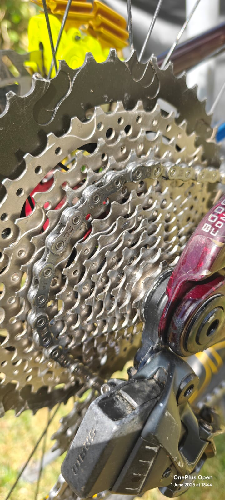

So I fitted it this afternoon only to find the outer cable was chafed through and the gears wouldn't shift:
So fitted a new outer which meant dropping the motor.....

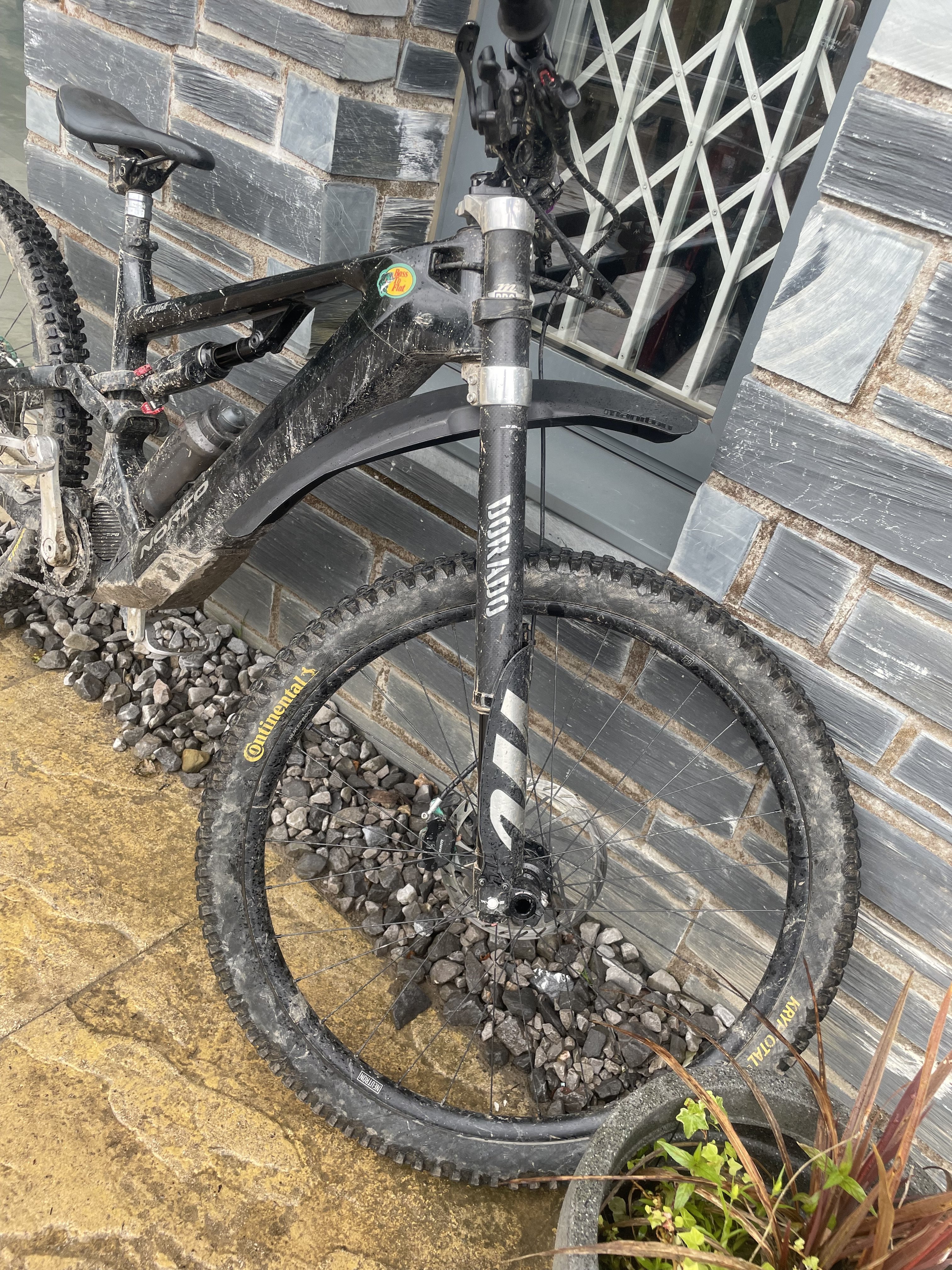

Today I fitted the mudguard to my Manitou Dorado forks, this is a Manitou supplied item and as the forks are of a ‘twincrown’ design there’s no low-mounting position like on conventional forks lowers…
Manitou decided on mounting below the lower crown so this ends up looking like a motocross motorcycle 🤭
Bit of a ‘marmite’ style🫣
But it bloody works well - I’m tempted to shorten the length of the front section as the riders view is sorta odd BUT laziness runs rife and it’ll never get altered 👍

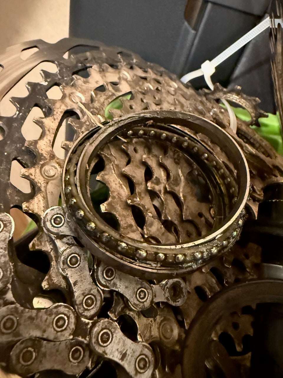

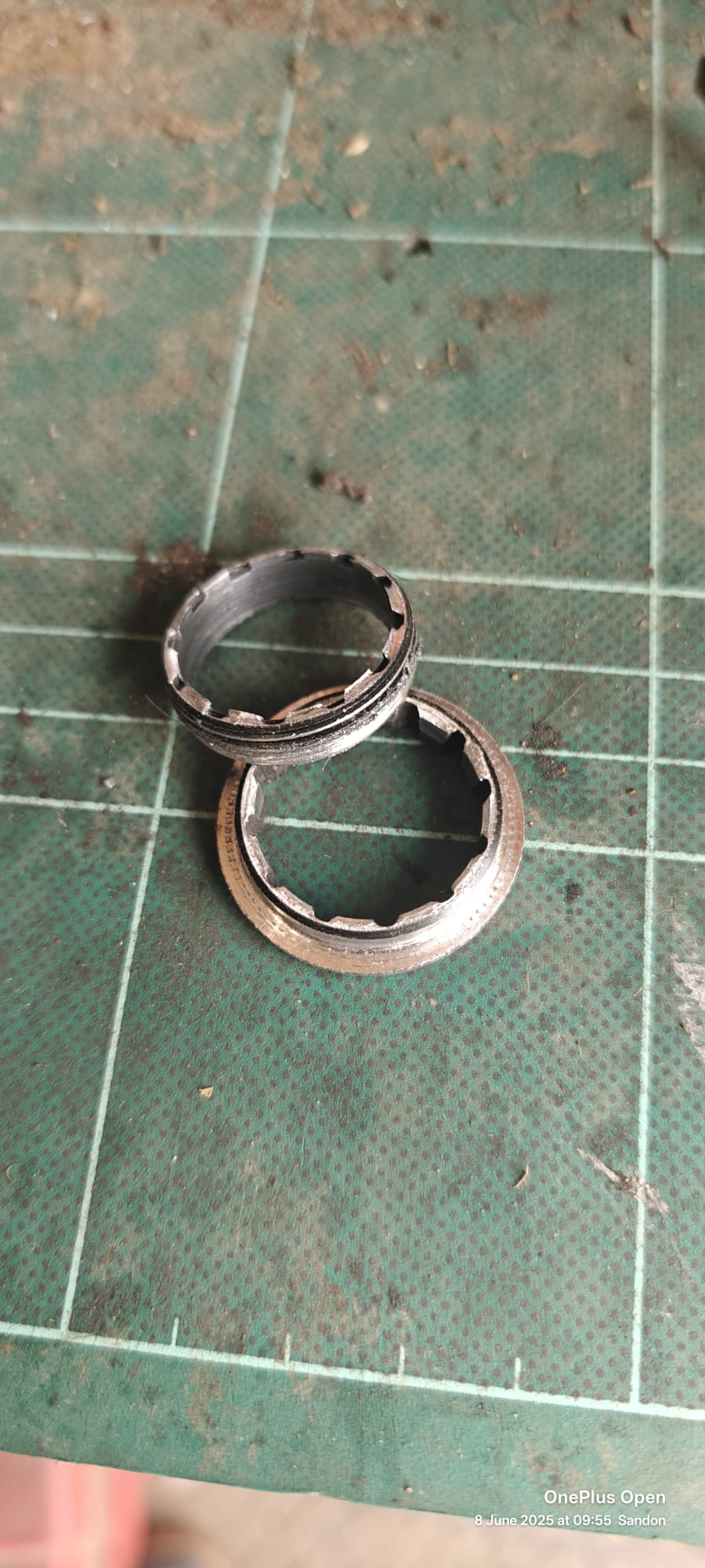

I thought i'd finally look at the ghost shifting issue, Wednesday night it was making some weird noises too.
Dropped the rear wheel out, saw something shiney drop on the floor.
Ooh look that's the cassette lockring?
So i then got the other half out. took the cassette off. That was loose as hell too on the bolts.
Then i looked at the free hub and there was a lot of movement.
The outer bearing on the Hope Pro 5 was completely shot. Lots of tiny little balls to get out, then trying to get the outer shell out of the drive body. Fun Fun Fun.
Now waiting on replacement bearings as I've not got spares of those really wide bearings.

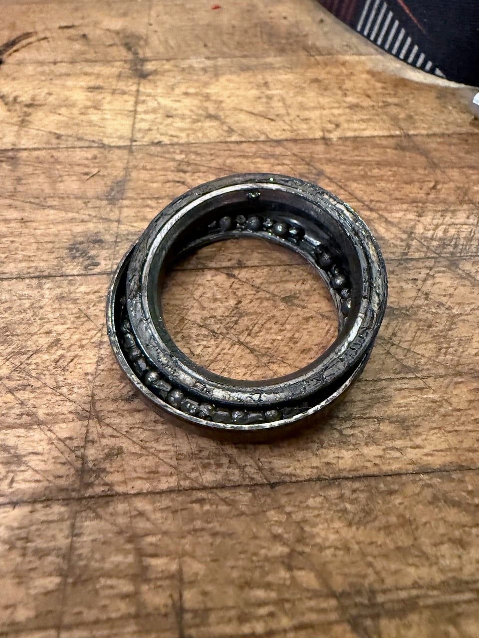

I was experiencing a little bit of a click click click under certain movements from my headset, and they felt pretty gritty. I had already replaced the lower bearing not that long ago, but never the top. They were in terrible condition, and fell apart once the forks were out. Oops!
Replaced both. Quiet, smooth and reliable movement now :)
