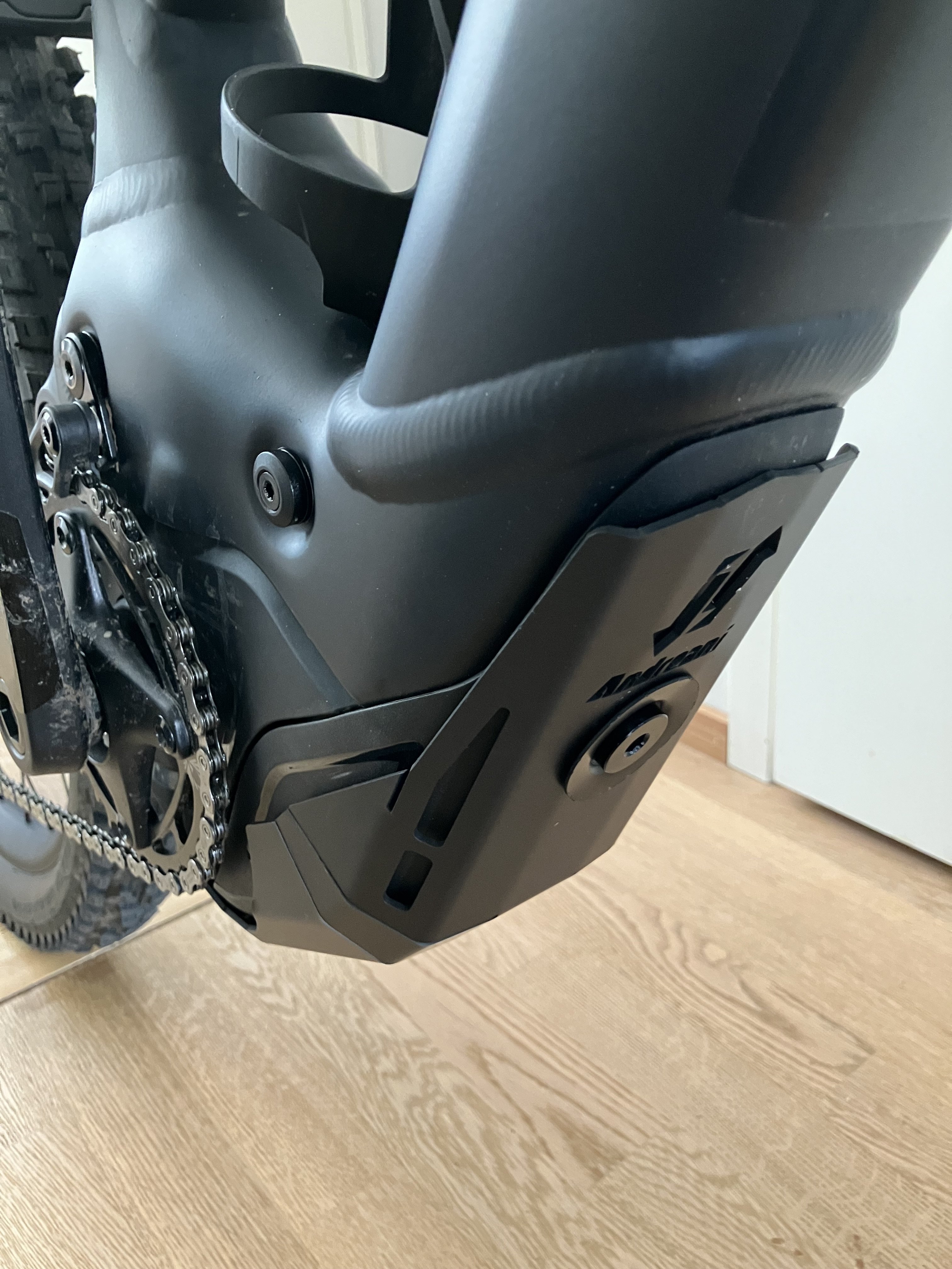

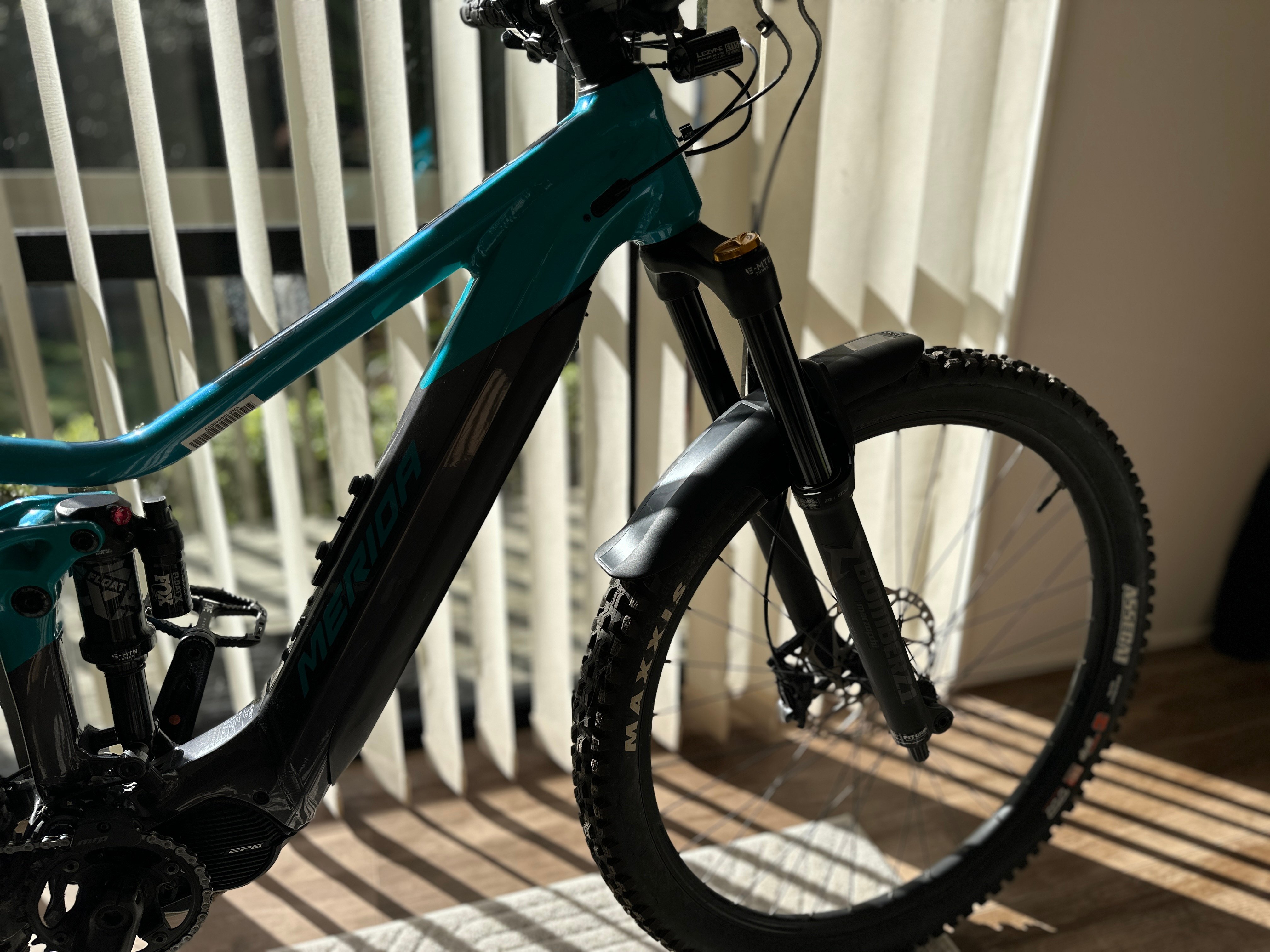

Added my new RRP mini bolt on fender

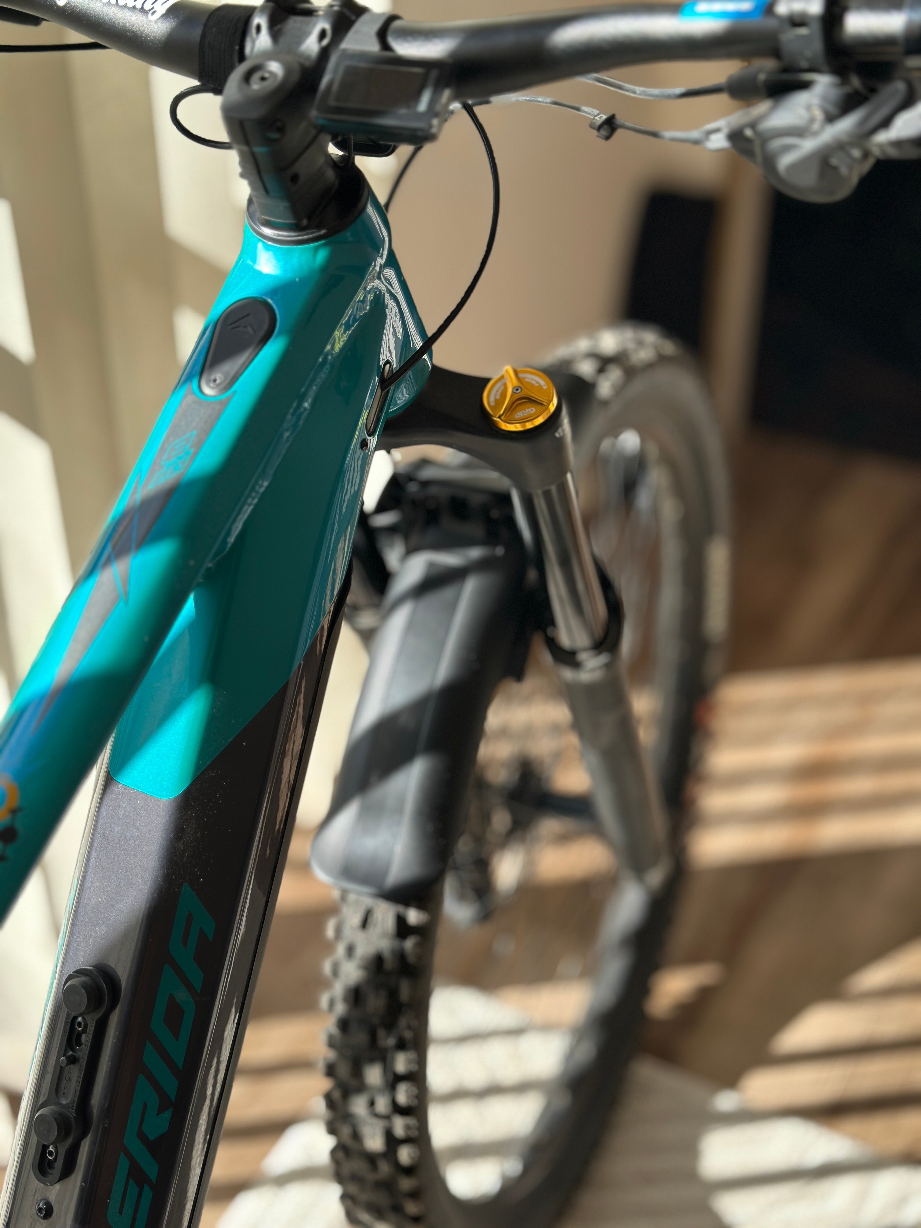

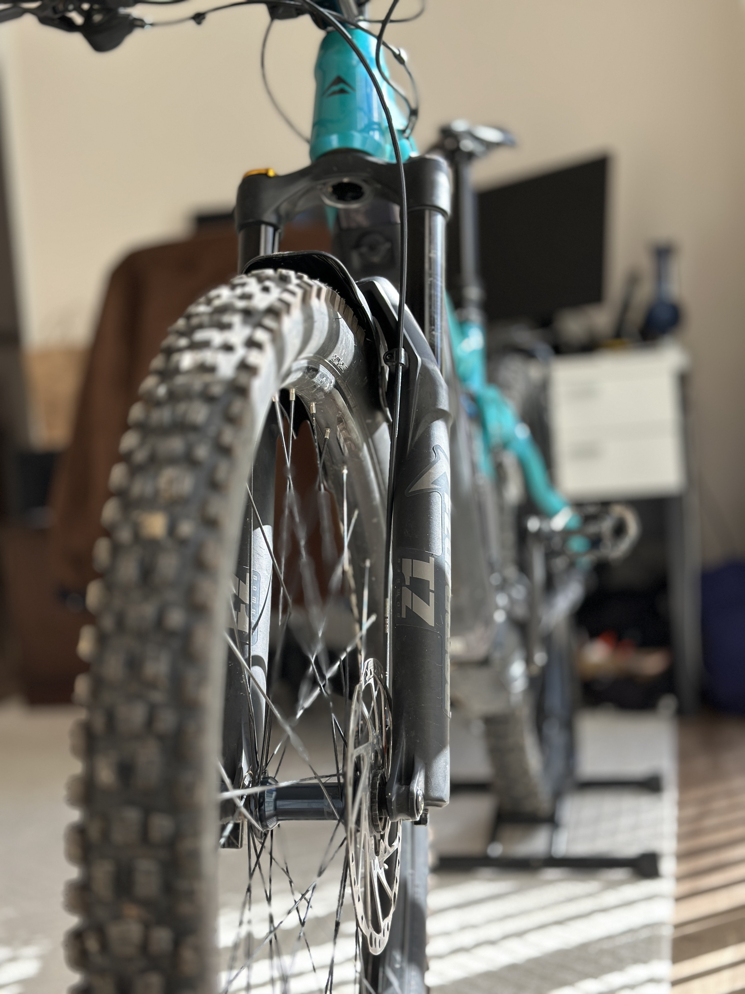

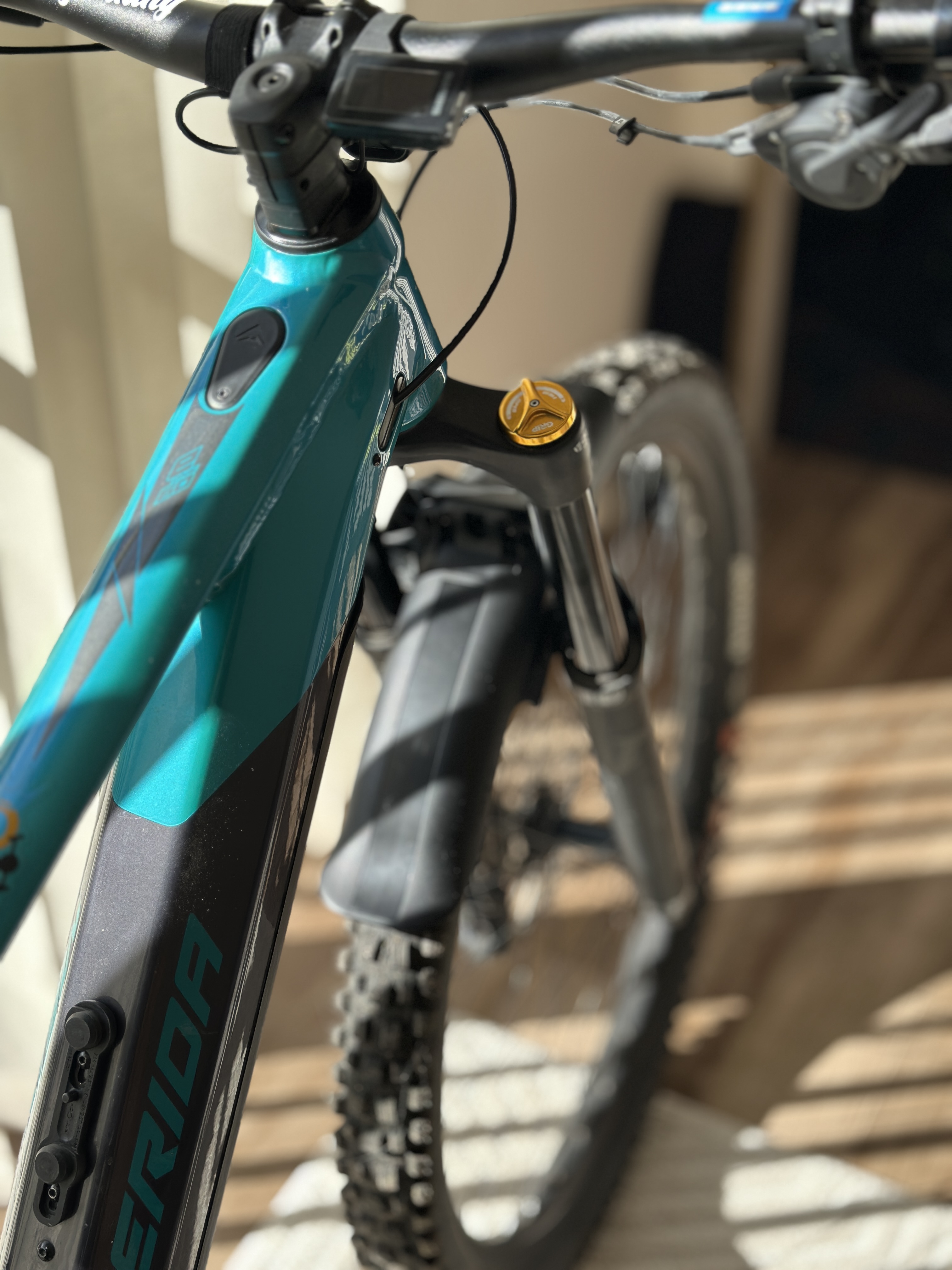

After two weeks off the bike with a calf strain, I finally took it out with the new mini fender installed and then fitted a new saddle to take some of the pressure off my old ass.

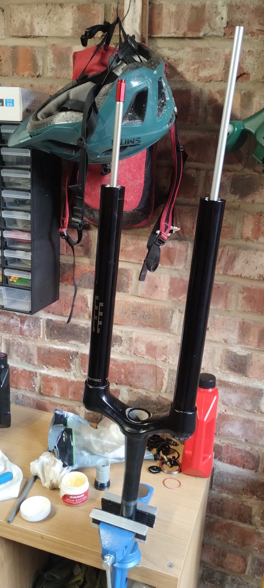

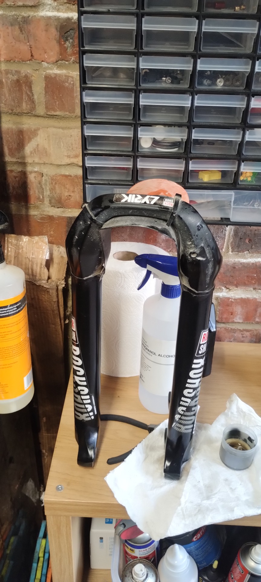

IME, the fifty hour thing is arbitrary. I service on condition, more in winter, less in summer. These were last done in March & once I opened them up, I could see they didn't really need it. Mate of mine hasn't bothered in three years & felt like he was going otb every time he used the fron brake. Checked the pressure & it was down to 20psi :ROFLMAO:
I hate to think how many hours I leave it between services...how many hours are there in three years?
I only got last levos suspension serviced once after about 4 years. Just got away with having to get new rear shock. Mate serviced legs on forks maybe twice as well. 10,000 miles when I sold it. 300 pounds for service would not do that every year. I didn't feel much difference to be honest.
I withdraw my £50 offer for that bike 😂
Forks & shocks on mountain bikes are generally badly designed as a weight compromise. By design they take in dirt & dust, so most of it is just cleaning & relubing. I find the suspension runs like butter after a service for about a fortninght until the grease & lube starts to ebb away. On the upside I've worked out that changing seals which is the spendy part is unnecessary when you stick to the manufacturer's schedule. I generally change them once a year & haven't found any problems from doing it that way whereas cleaning & greasing really does improve things.
I maybe think the forks are smoother after oil change but i dont notice it for long . I'm easily pleased and don't do much tuning to be honest . Same with tyre pressures if I put gauge on it would be out of curiosity. I noticed the difference getting new levo in April. Bearings well goosed on Expert probably, quite clunky it had a hard life though. I think I pay about £50 for seals and oil change.
