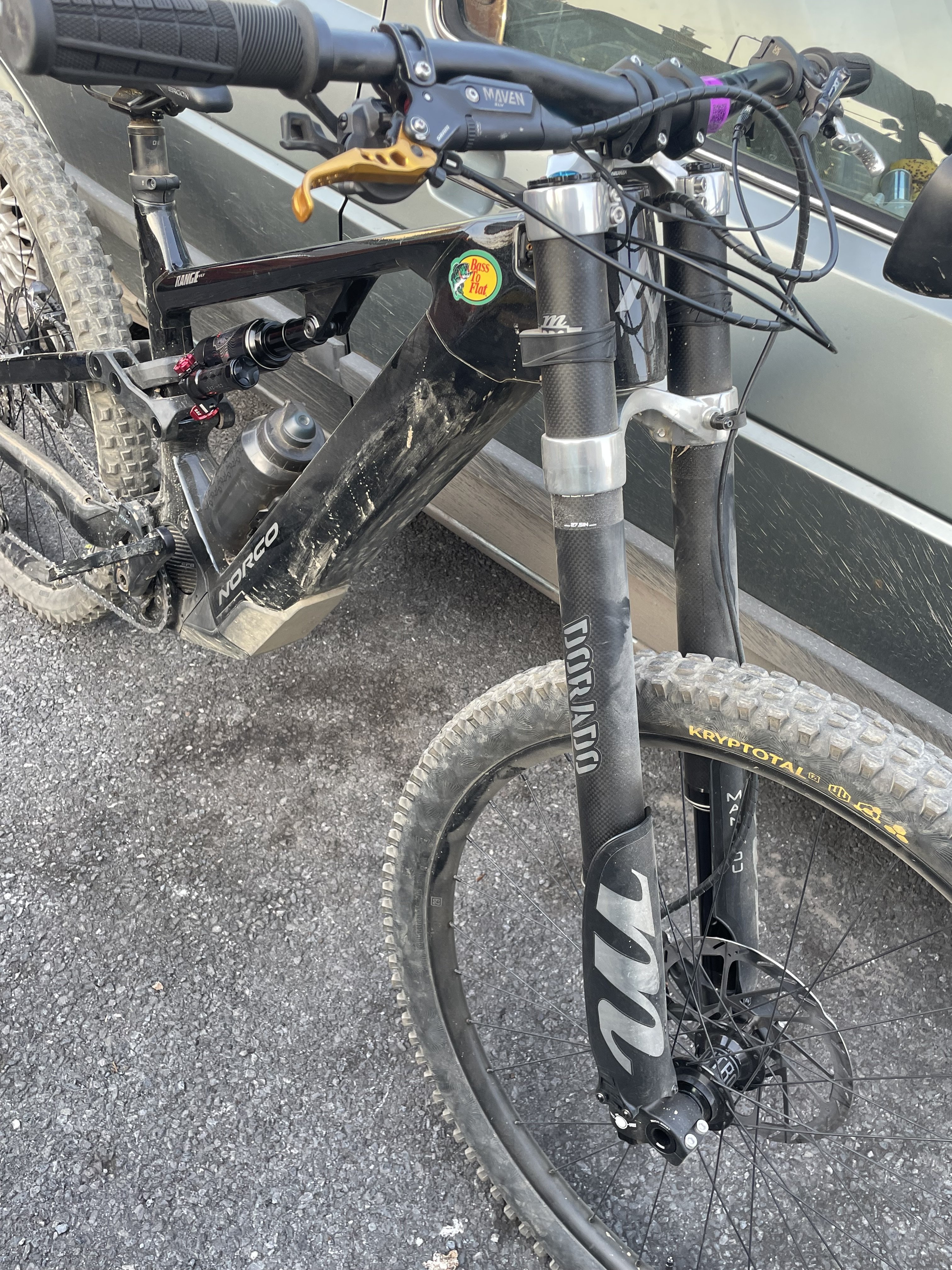

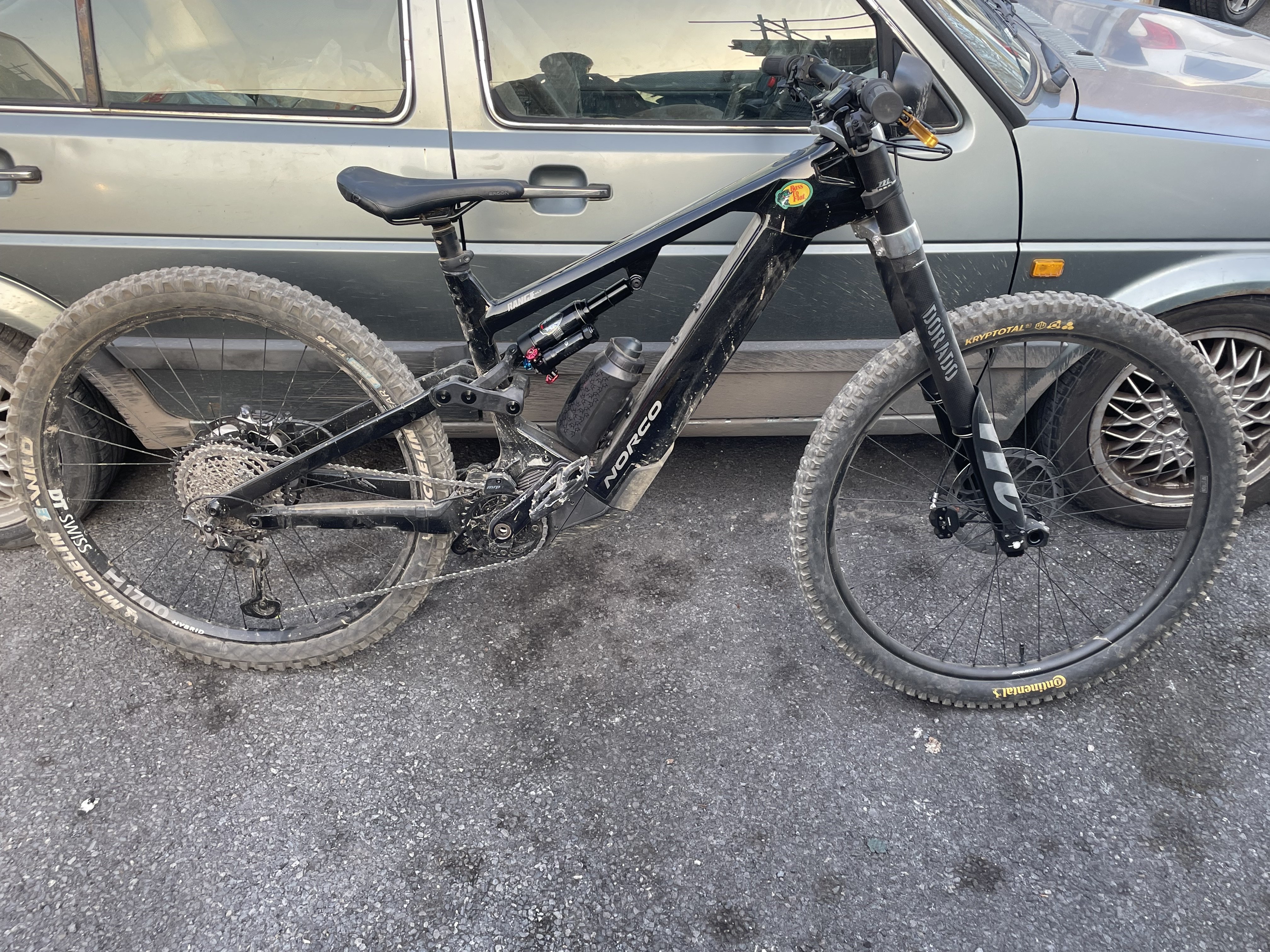

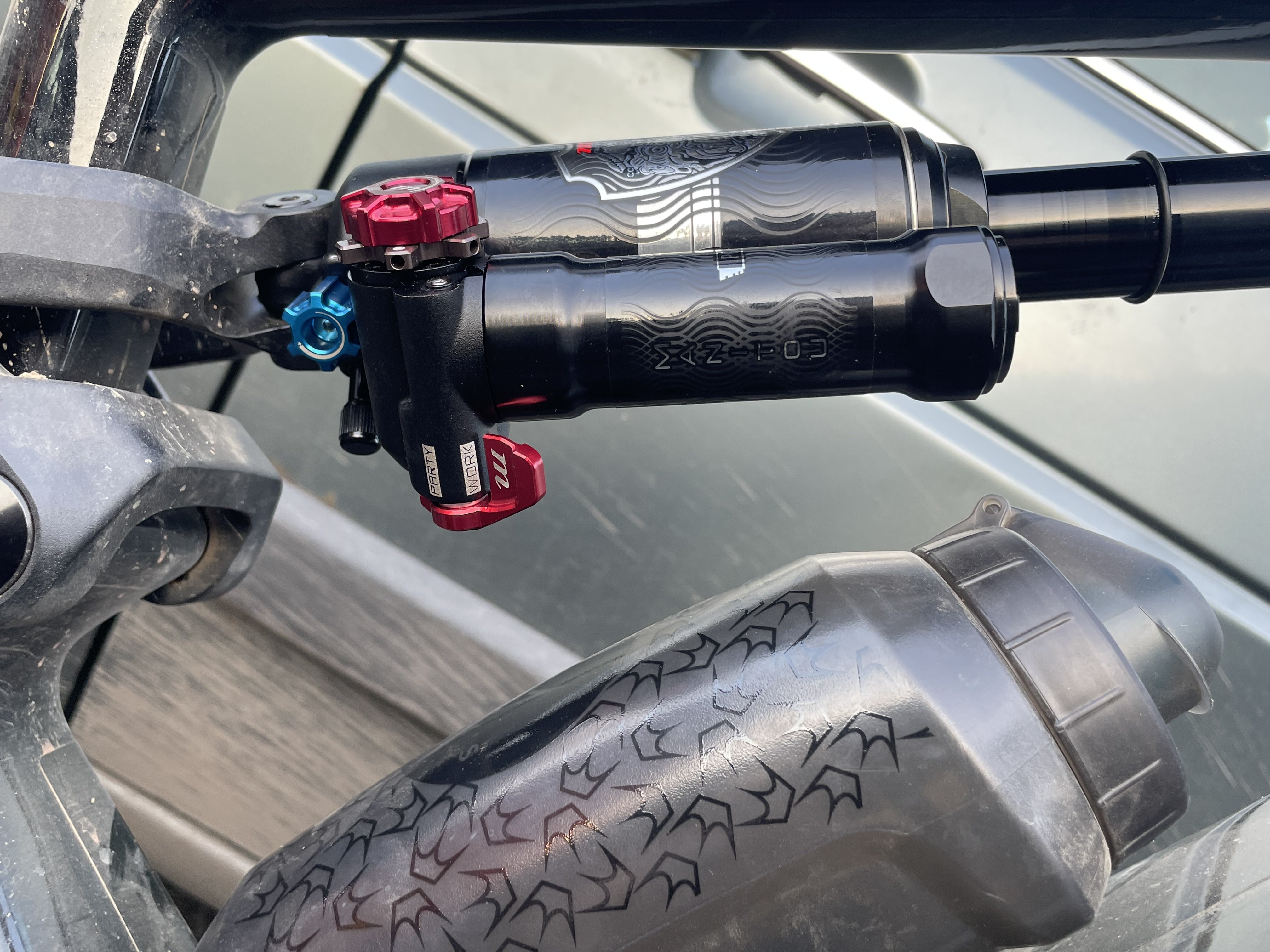

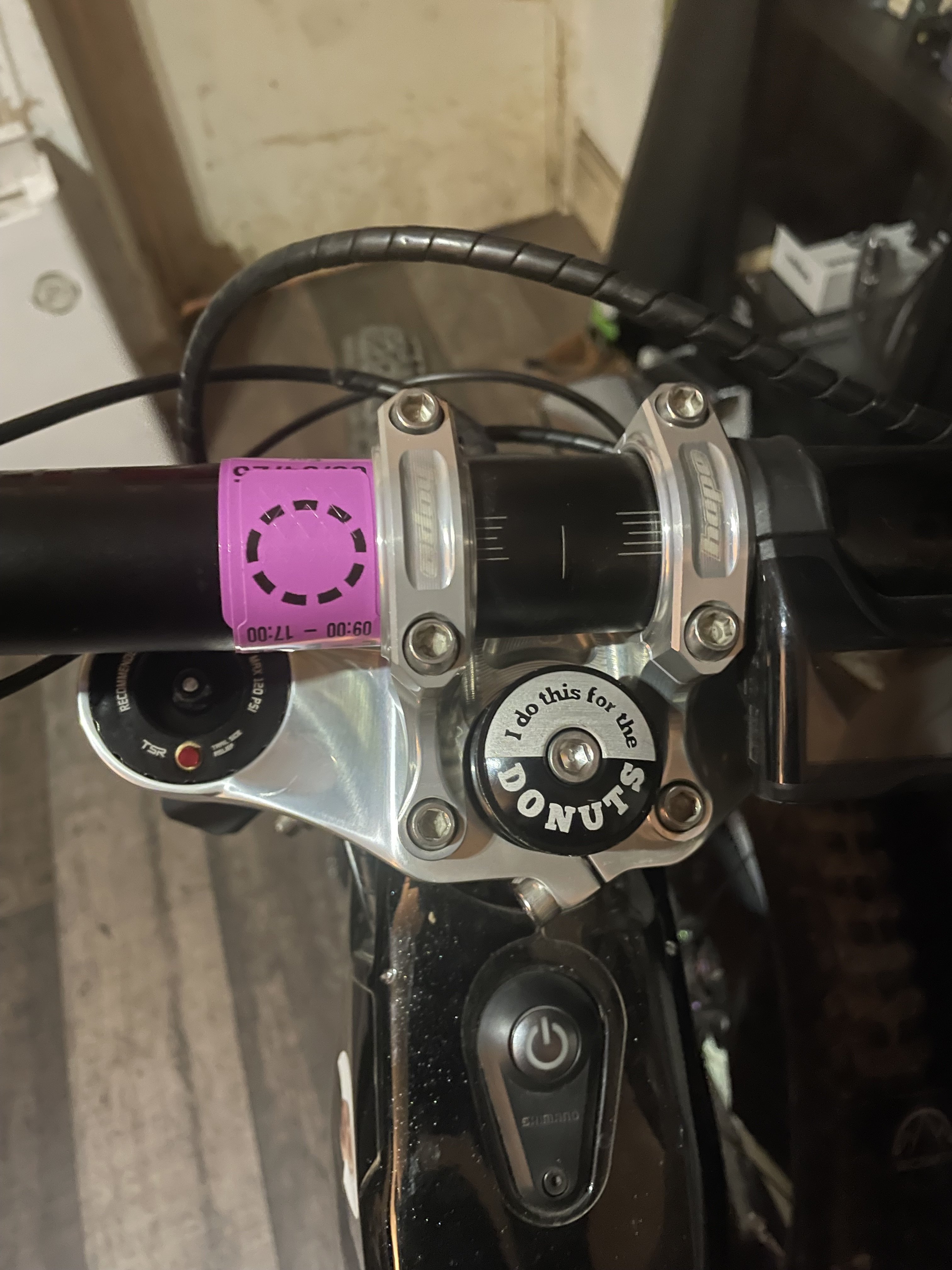

This evening I’ve swapped the oneup dm stem for a hope dm stem (hope is shiney as opposed to one up being satin black)and also raised the top crown on the dorado forks - partly for frame clearance and partly to increase handlebar height🤨

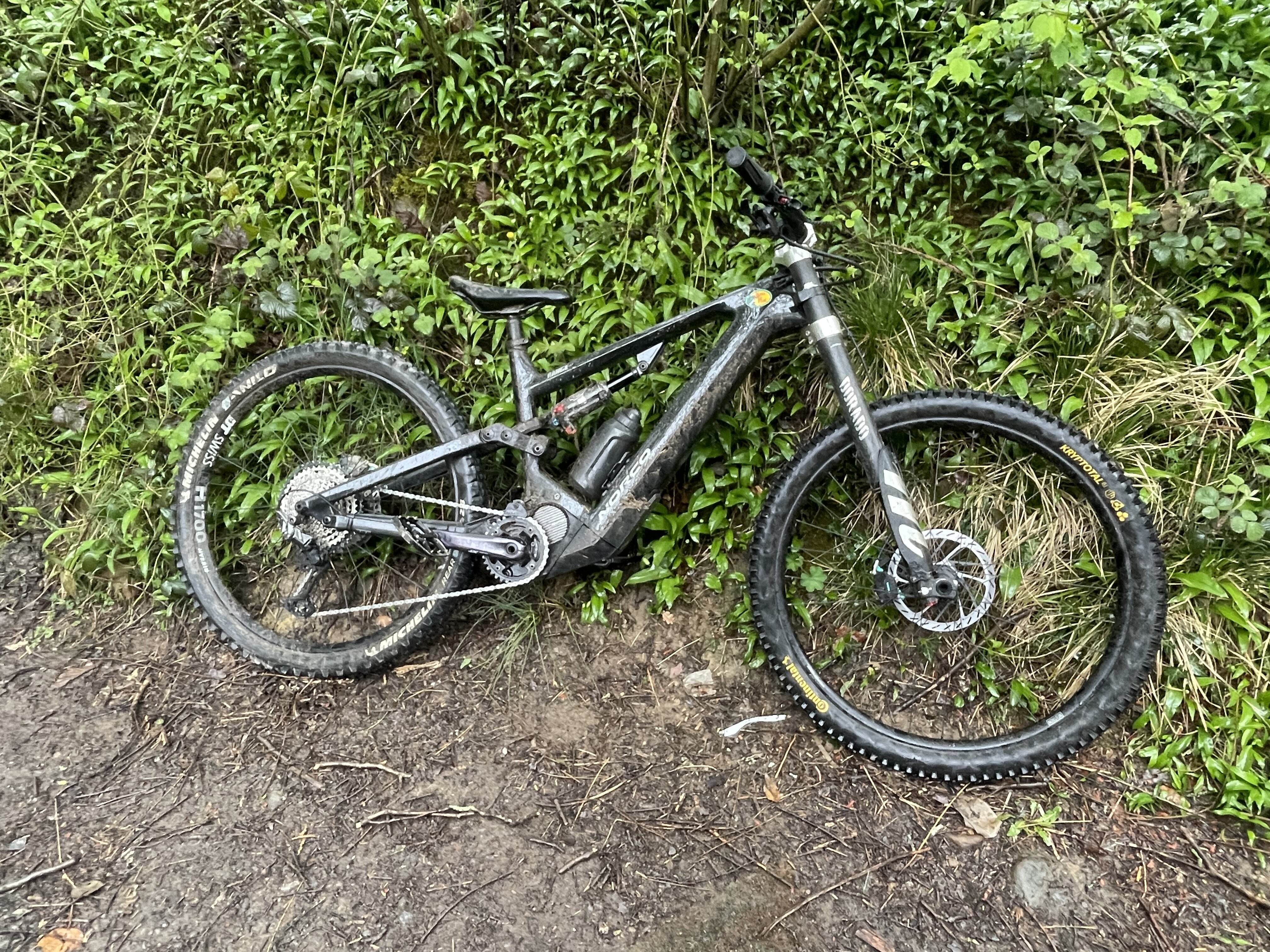

And time for the ‘finished’ (definitely unfinished!) article 😎
With the one up dm stem.
I could have cleaned it after the weekend’s riding 🤣
Mara pro in place.
Work & party switch (climbing lockout)

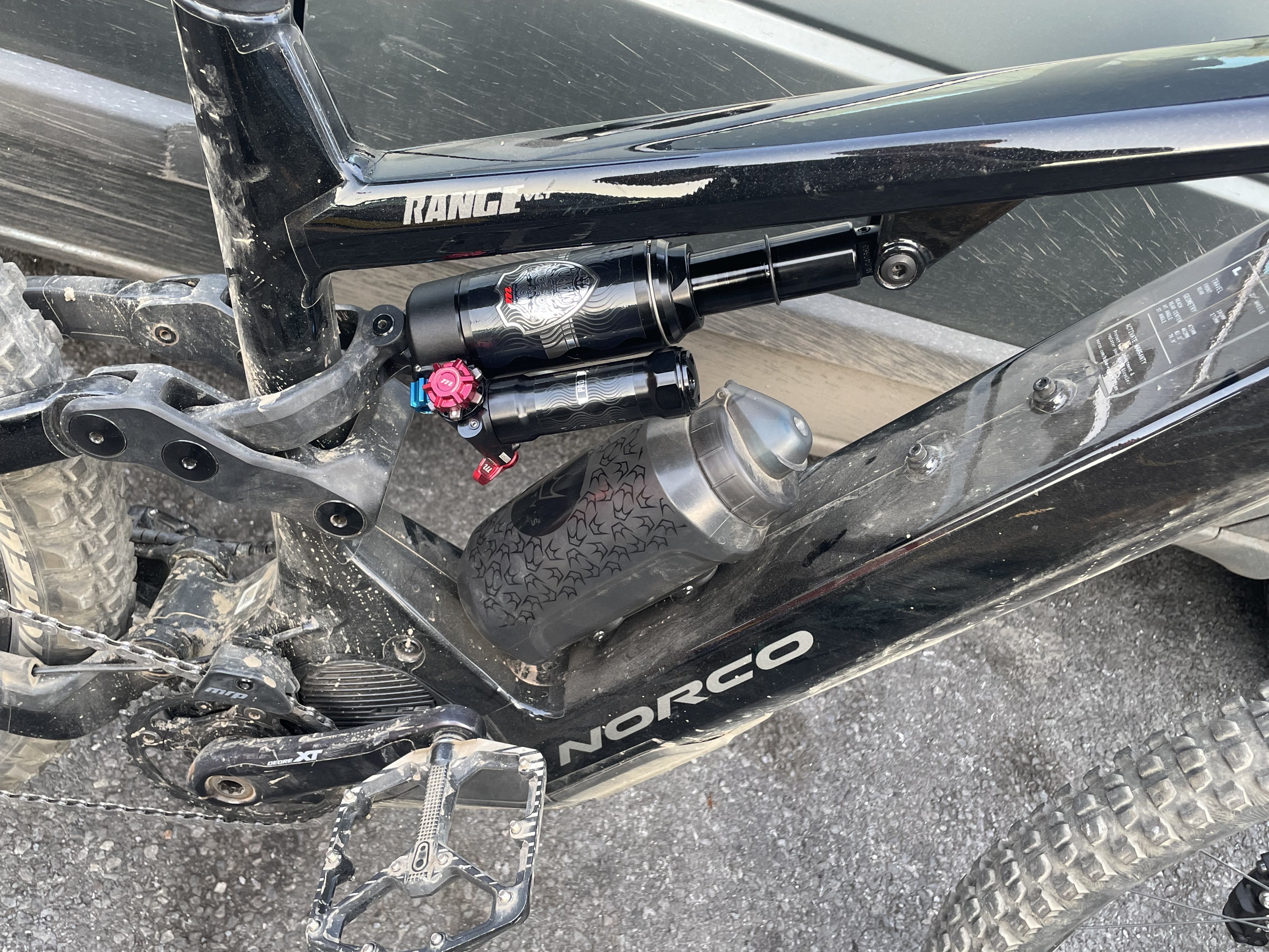

And yes, the damper is mounted on the squiff as this gives frame clearance to carry 2 drinks bottles (also the ‘piggyback’ doesn’t interfere with legs while riding 👍)
Rich.
Best looking and sounding forks on the market, sick ride brother 🤟

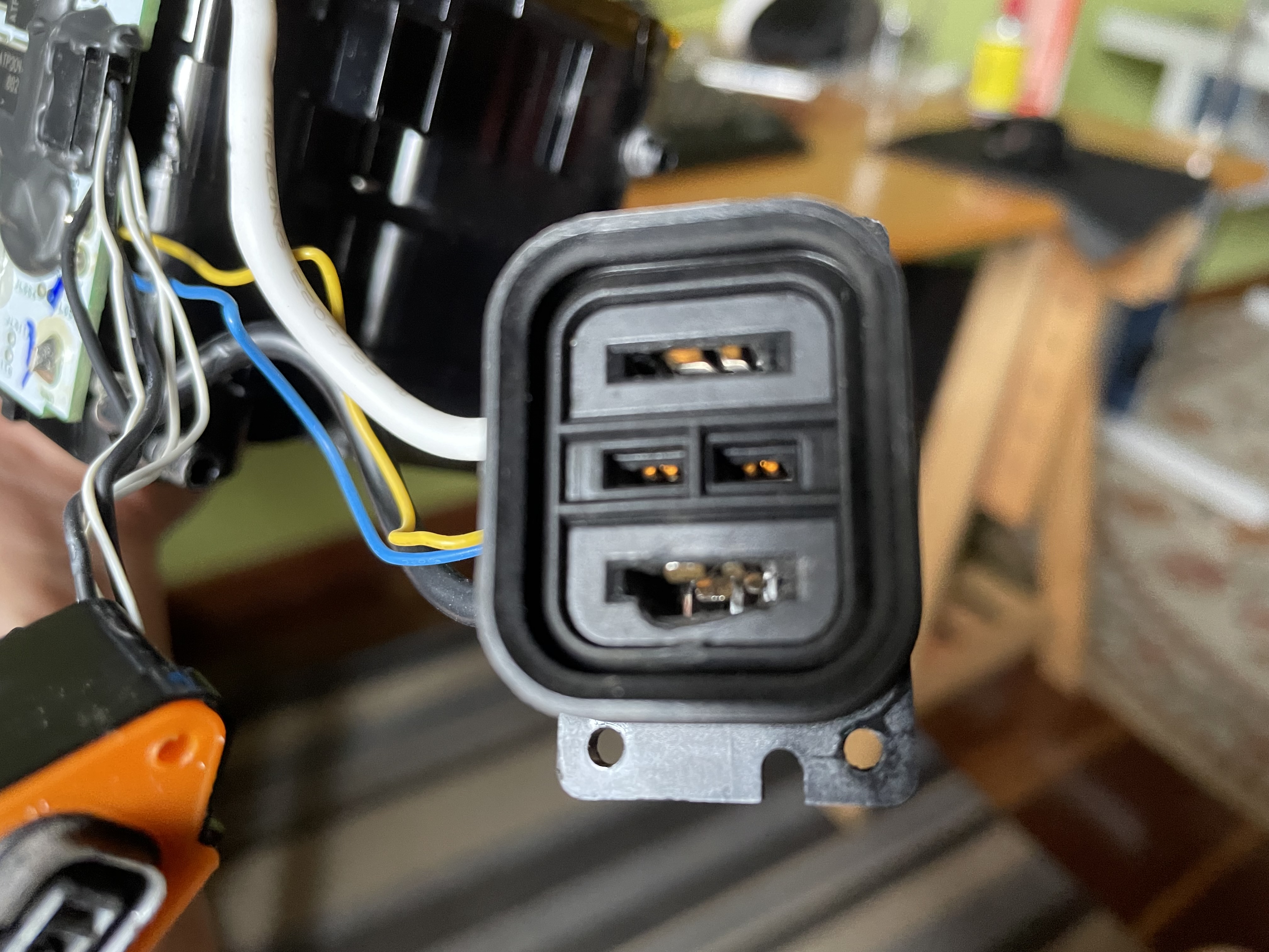

Broke the connector of the old shimano battery bt-e8010. The bike won’t turn on.
The flat plug on the frame was not properly aligned with the slot, so, when I forced it in, it broke the edge of the slot and crushed the cooper tabs into the bottom.
After 5 hours flickering with tools from crochet, dentist and skincare, and a grinded plier, i managed to pull the cooper tabs back to the edge and shape them, now its turning on!

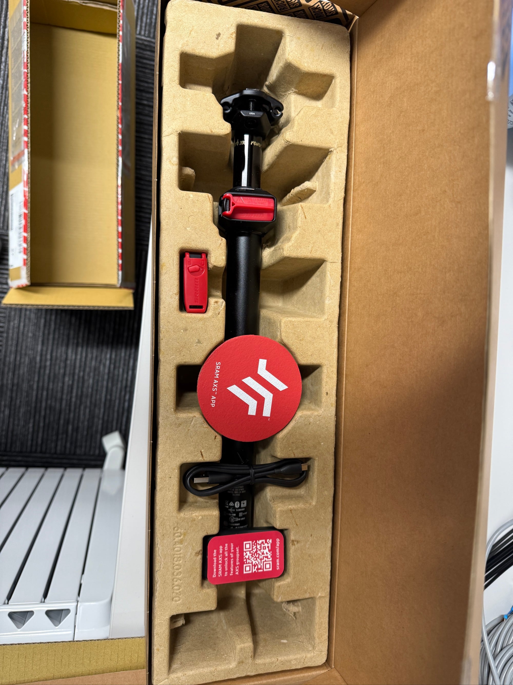

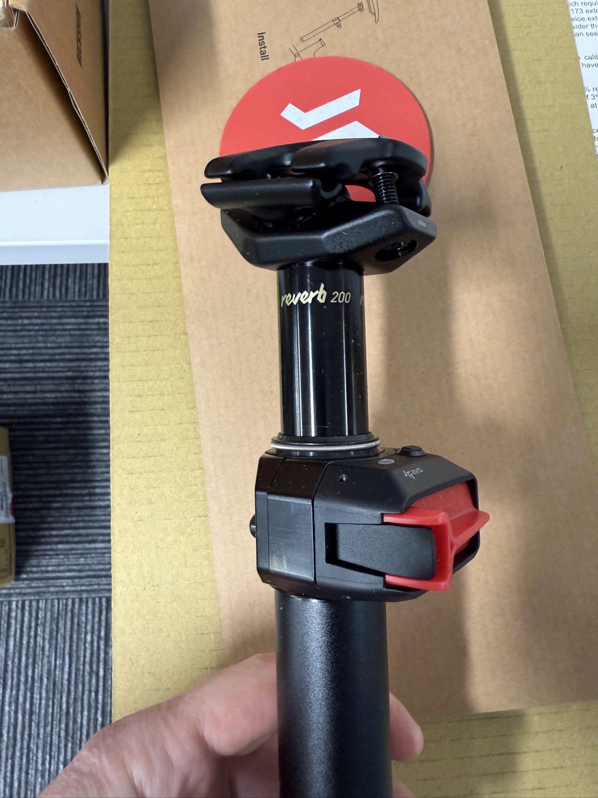

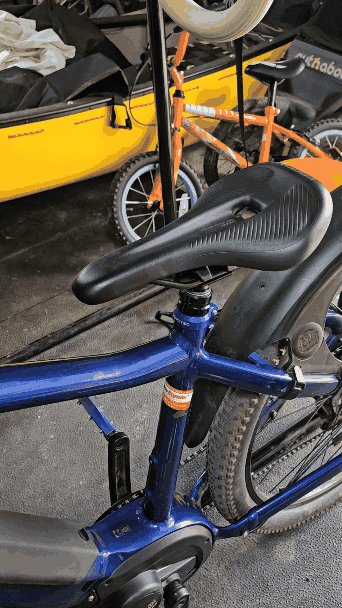

New 2026 Rockshox Reverb AXS B1 dropper arrived today... with the new style 'bulge'. Not as bonny as the original, but now up to 250mm drop (I've gone with 200mm).
Will get it on the bike tonight, and hopefully get a wee ride in tomorrow to test it out.

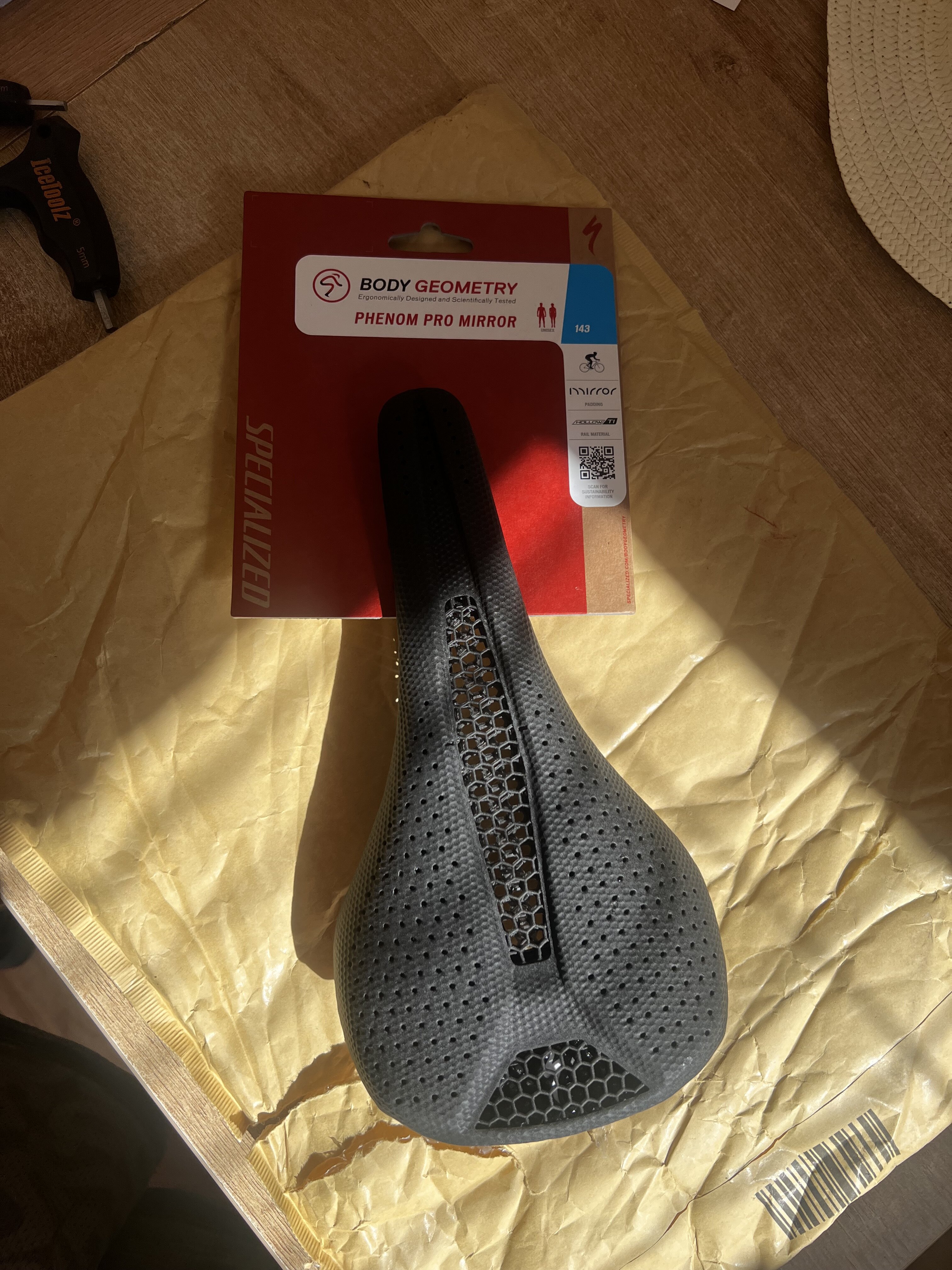

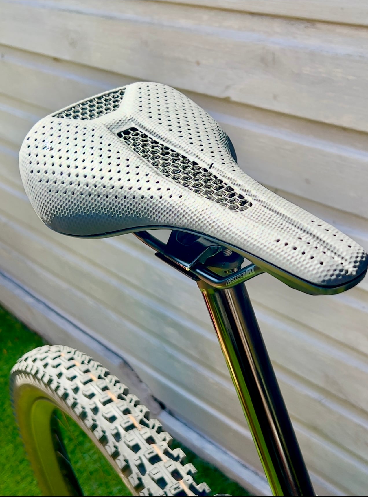

Nice... I had the Phenom S-Works one for a while. Very comfy, and extremely lightweight.
The carbon rails cracked after a while, then it was replaced under warranty. Happened again, and Spesh said no to a second warranty. They claimed a saddle was a consumable, and it had lasted about the time they expected 🤷‍♂️
I’ve heard that a few time with the carbon rails. So saved £100 + and got the pro with the Ti rails.

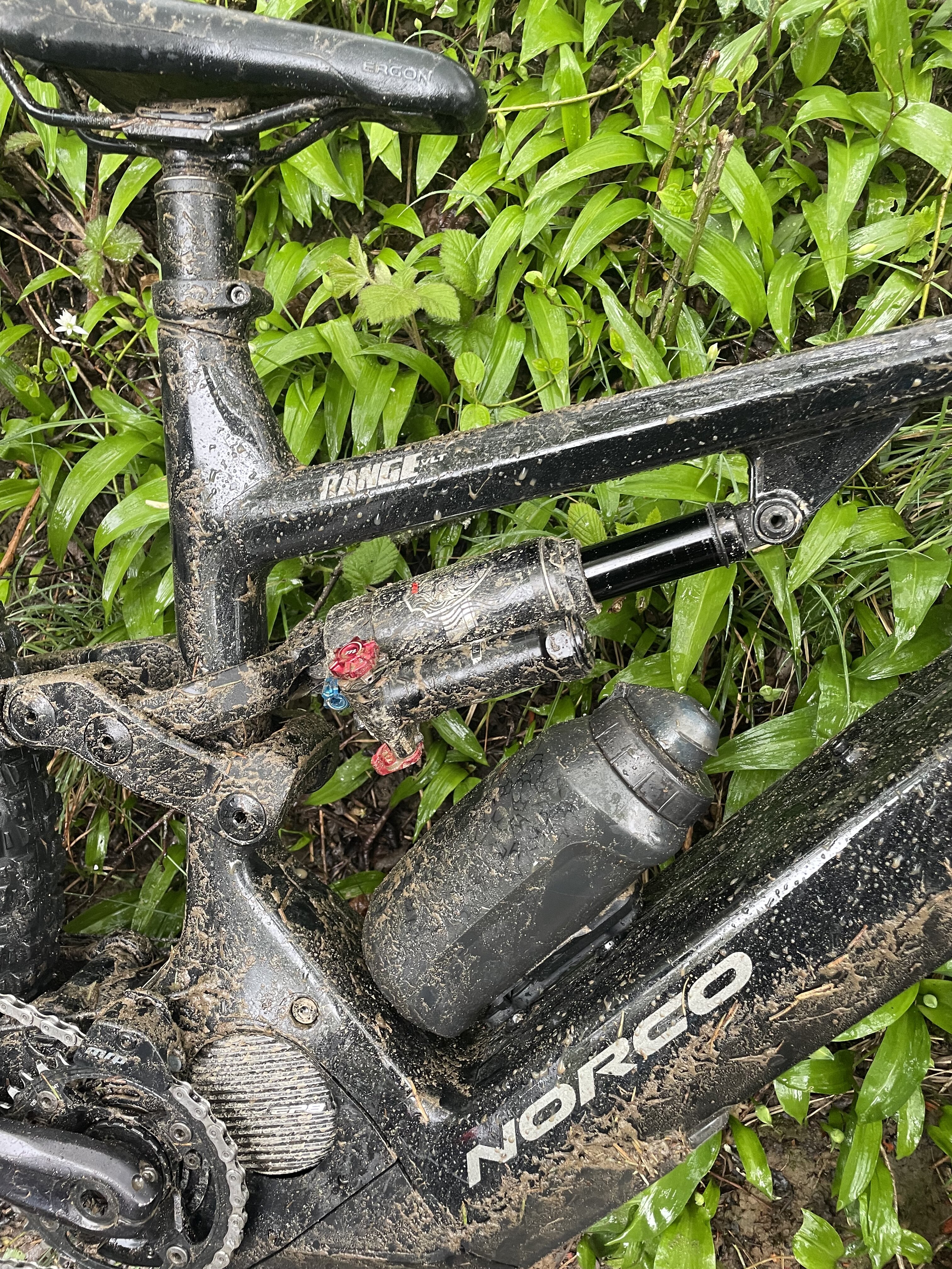

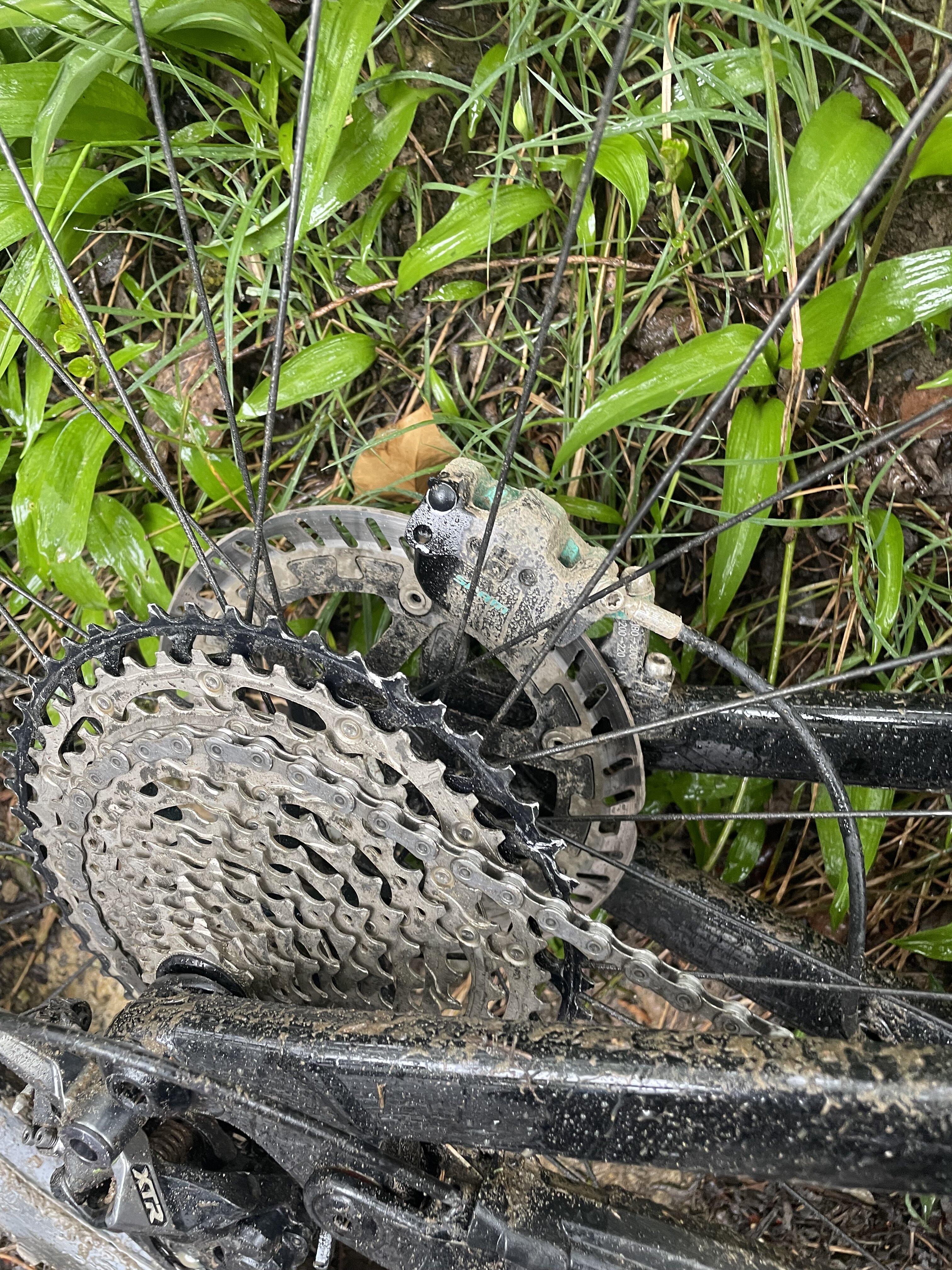

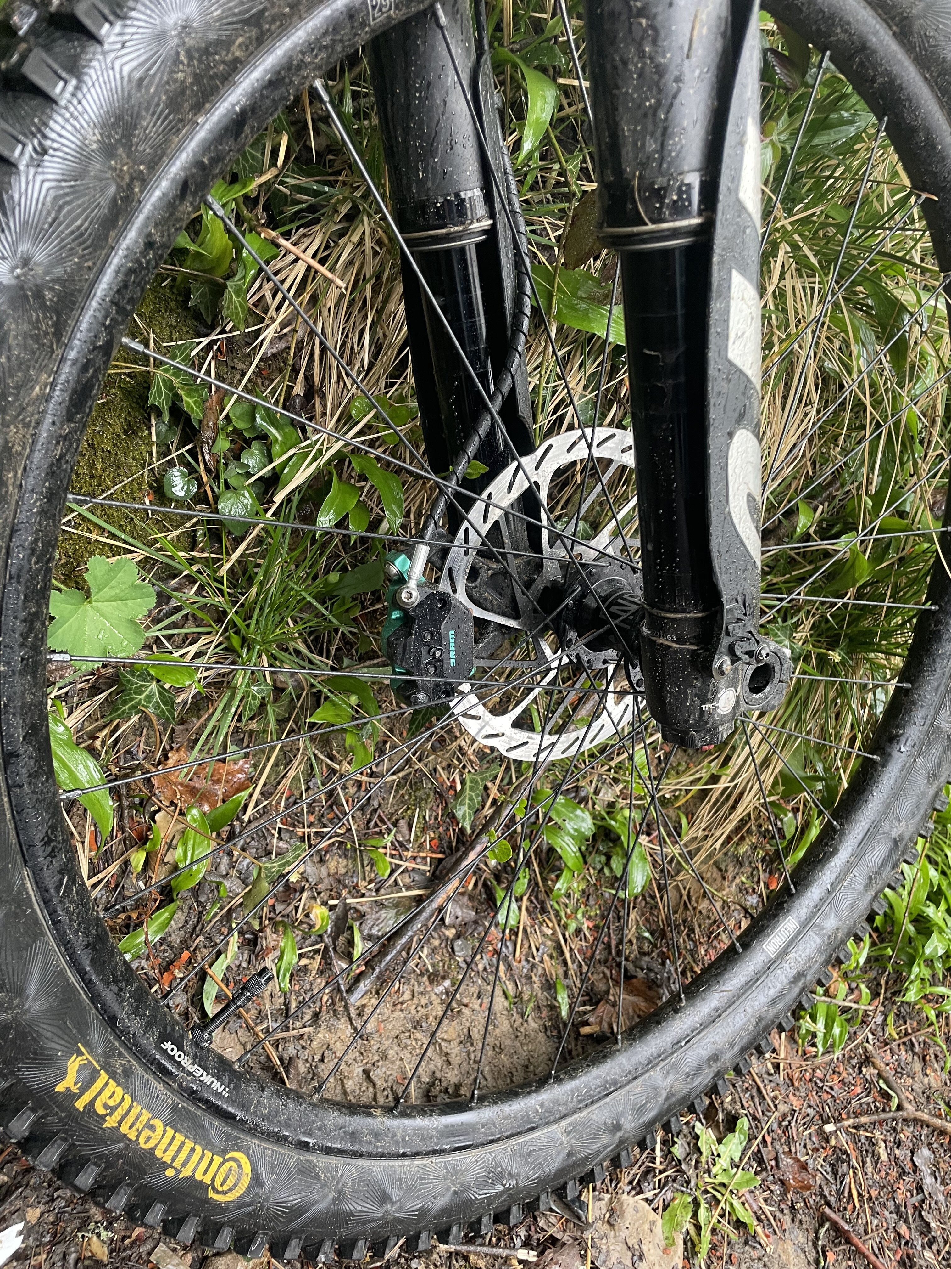

Okay, yesterday we fitted & bled the new Maven ultimate brakes so today was testing and bedding-in joy 🤨
And the weather was horrible so Bpw at its finest 😎
Managed to use all of the travel 😎
And most of the rear travel 🙄
Maybe a few psi mort for tomorrows ride…
As usual, managed to heat the brakes even with this weather!
Rich.
Nice, I want to get one for my gen 3 Levo. I can’t decide which length will be the best to go for. I want to slam it as much as possible for asthetics. My bike is an S5 with 280mm max insertion
