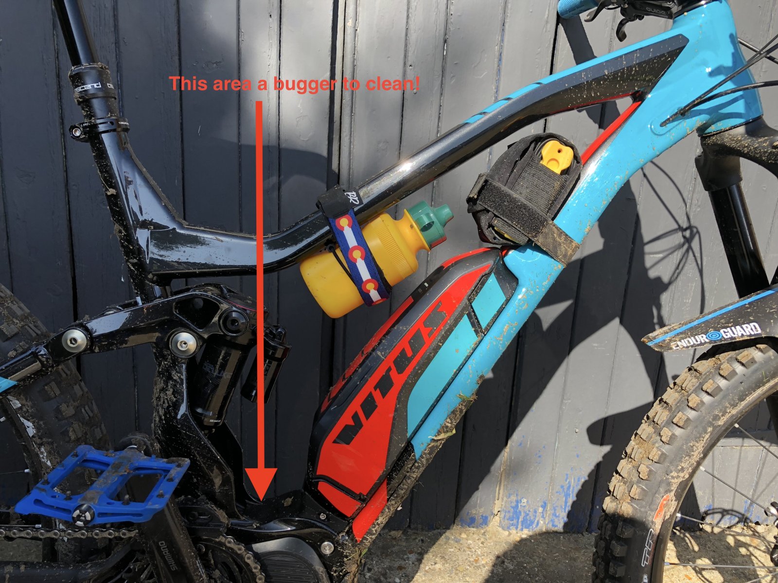

For me there are 3 negatives with the bike to date:
  1. No bottle cage bosses, this is a personal thing as i like to ride packless if possible, so i have a water bottle strapped to the frame instead.
  2. Dropper post insertion, this is discussed in depth in this thread, i actually like the brand x post, and it works great, but for my dimensions i wish i could shove it down a bit further into the seat tube.
  3. Area above motor/below shock in frame, this area is difficult to clean out due to the design, its a minor gripe and i have bike dryer which i use to get dirt out of there, but if you come back from a muddy ride you end up scooping the crap out of the area as its not somewhere you want to be putting any sort of pressured water into.

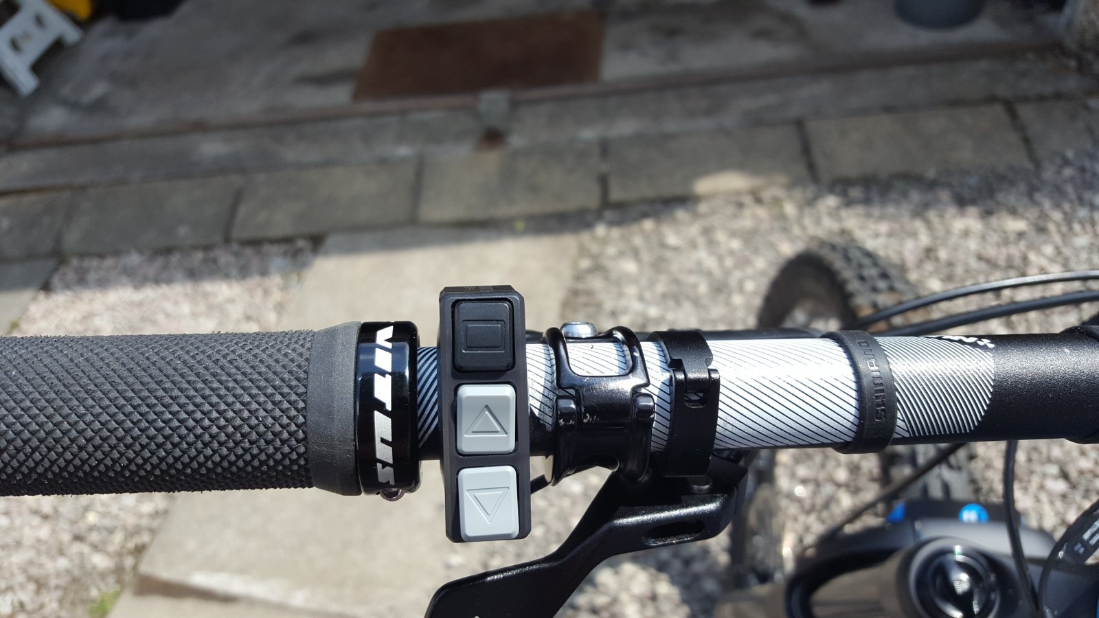

One other thing, but i think this can be applied to all Shimano E8000 bikes, is that whilst the E8000 controller is great, i think the E6000 works a lot better in the real world, as it frees up handle bar space so as not to compromise dropper lever placement, its more robust and out the way, and also has button on it to scroll through menu meaning you don't have to take hands off bars to cycle through the menus when riding. I also think its easier to use, but that might just be me. I would always swap out the controller for an E6000 on any shimano steppes bike i owned.

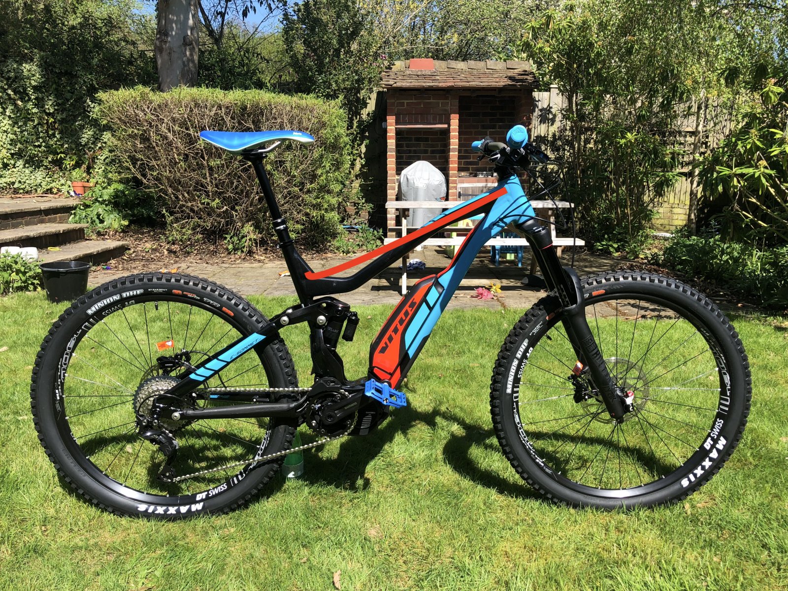

The only real thing i would change on the bike is to have the top tube run like the line in this pic, and Vitus put some bottle bosses on the under side of it, as the extra space in the triangle would allow a cage and bottle to be easily fitted - i think the only reason it is like this at the moment is to allow standover height for people sizing up, but for me at least its got a low standover so i don't think would cause any issue. I might even suggest it to them!
Wouldn't it be possible to add bosses even as it is now? Looking at your picture with the bottle strapped on the top tube it doesn't look like there is a whole lot of clearance for just any cage, but they could use it as an opportunity to sell a cage and bottle that fitted those dimensions, just like YT who charges a horrid price for their cage and bottle just because noone else makes one that fits the tiny hole under the shock.

9,185
Also, I like your tool placement on the bike. I think i'll copy that!
I have played around with a load of options and the cage, interferes with the battery, the bottle strap solution actually works really well

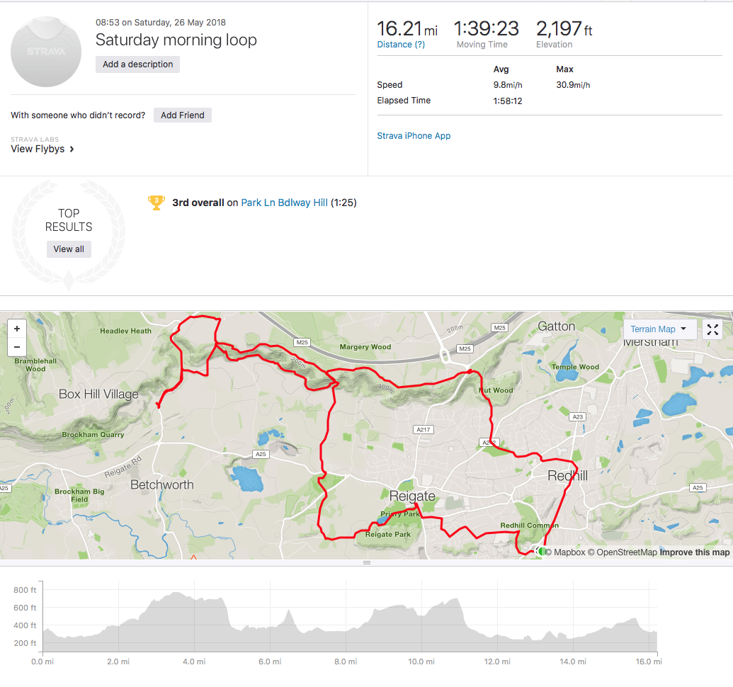

Interesting, i double checked everything when my arrived, and the PDI was really good from CRC, much better than my BMC i got from Evans which hadn't had brakes bled properly, badly working dropper and a bent rim!
Went out on my usual morning blast today on North Downs, which is never exactly the same route, but always pretty similar, and downloaded strava as was interested in hwhat the ride actually comprised of in relation to battery use. The ride below left me with 2 bars of battery, 3 miles of it road, and mostly in Trail except for some silly steep bits, so would estimate no more than 1 mile spent in Boost. As an FYI i am at about 14 stone including all kit etc, and averagely fit, about to hit 40, (don't go to gym but lots of walking and of course time on the bike). My skills are about average, in that i can ride any trail, but you wont find me hucking or whipping of any jumps!
Thought this might be useful for anyone looking at range, the ride does include about 10 mins of stopping for coffee, but not sure if the auto pause feature on strava factored that. Its mostly quite technical single track, a a lot of exposed roots, slippery clay, and heavily rutted tracks from the horses.

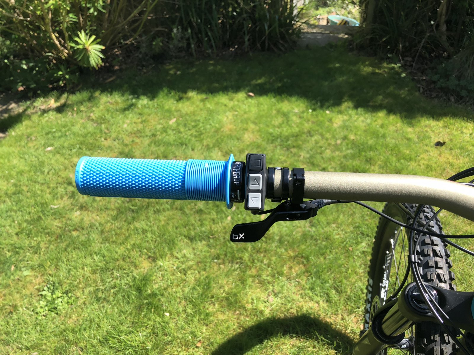

Only real continuing niggle for me with this bike has been the interference between the E8000 controller and the dropper. I have my dropper lever on my other bikes under the LHS bar and am completely used to it. Tried a lot of configurations but in the end bought an E6000 controller.
This completely solves my issues. The only problem might be the sturdiness of the E6000 unit in crashes. It's a pretty light weight build compared to the paddle unit.
