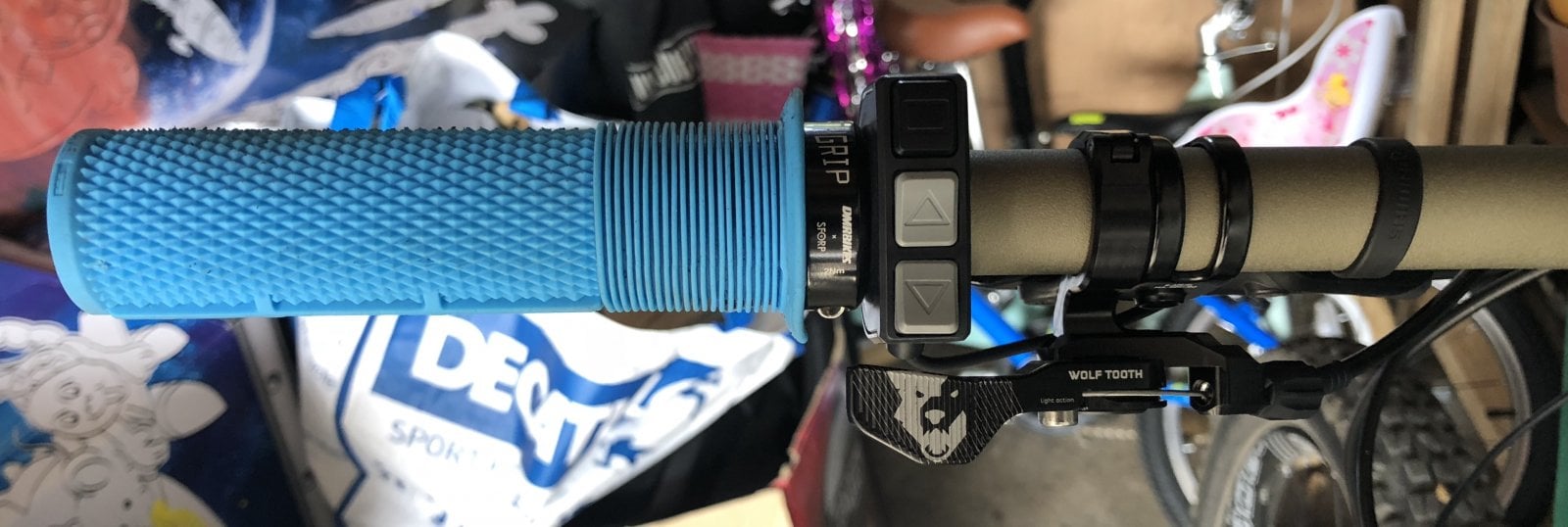

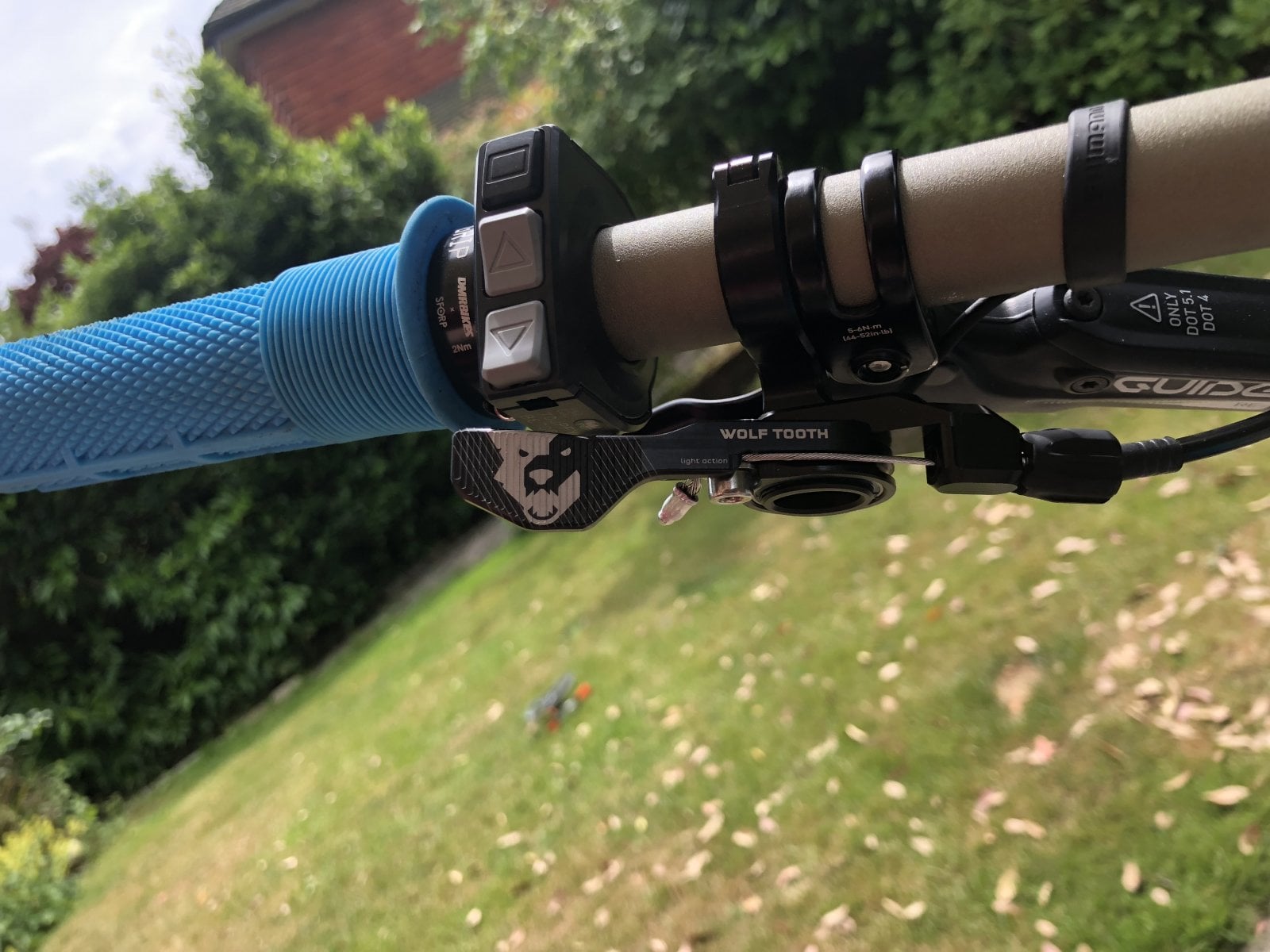

Swapped out the standard dropper remote for a Wolf Toth a couple of weeks back, massive improvement over the stock remote, much lighter action and you can really easily modulate the rate of ascent. Definitely a worth while upgrade. Its clamped at the bar end, so you need a new gear cable, but i re used the existing outer, so installing was an easy job, and now all adjustment is at the lever rather than the post.
Any links?
Especially for the grips (they look the mutz)

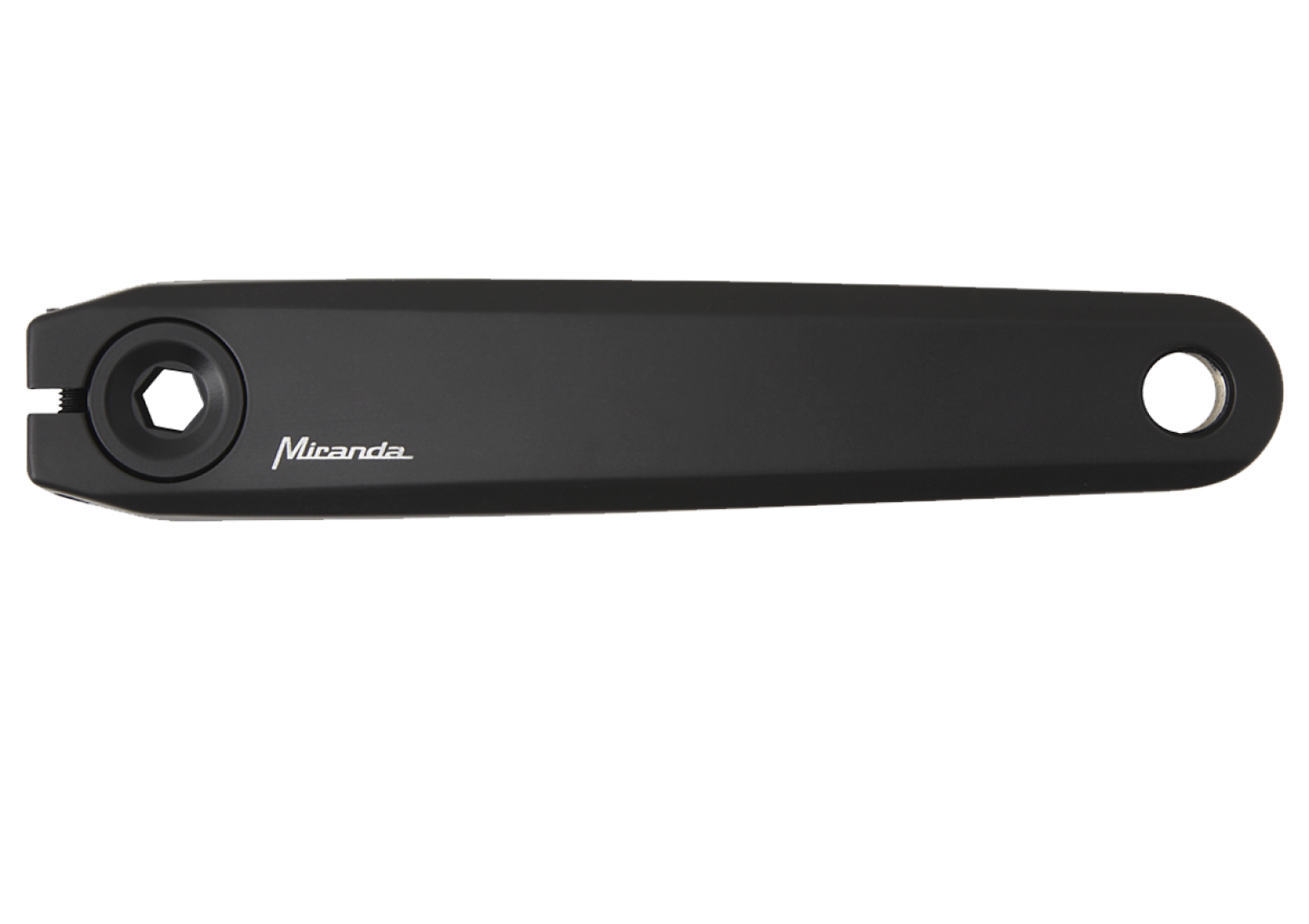

I have just picked up some 160mm cranks, was tempted by 150mm but didn't want to reduce the peddling platform significantly for going downhill, or muck around with the gearing.

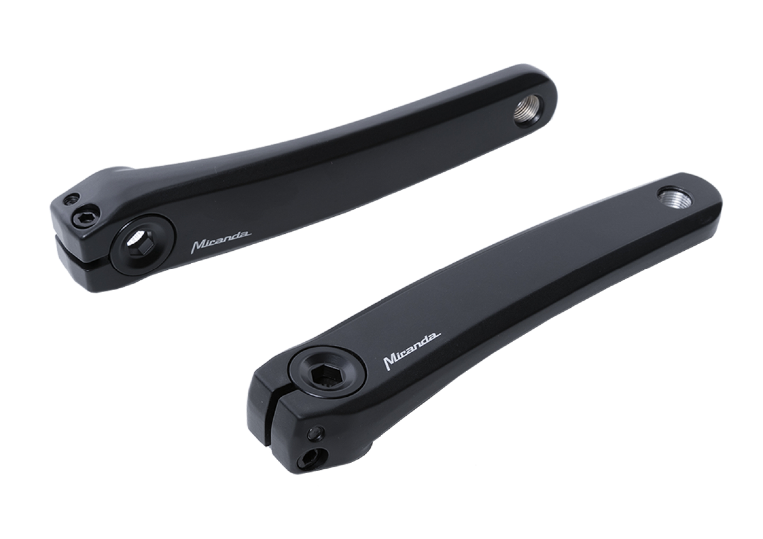

Is that for a shimano motor ? Miranda cranks ? Where did you find them
Delta SH - Miranda Bike Parts
Come in 150,155,160,165,170
Got them direct from Dilgrove who are the distibutor for Miranda, spoke to a chap called Bryan who was super helpful.
Dillglove Limited
Tel: 0121 354 4127

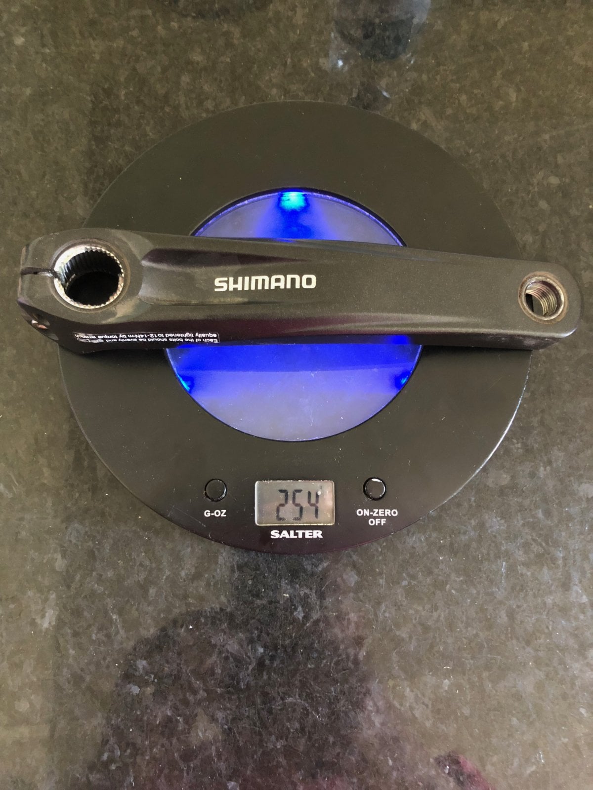

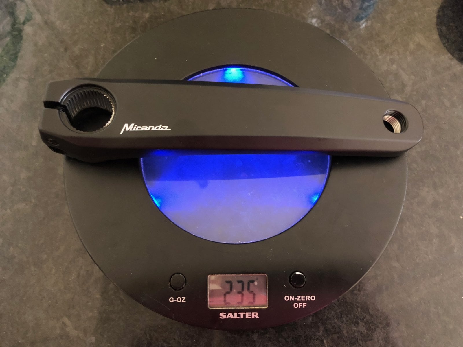

Interesting, how much lighter are they?
no idea, and not something that i really care about, but will measure them and the OEM ones when i do the swap this afternoon

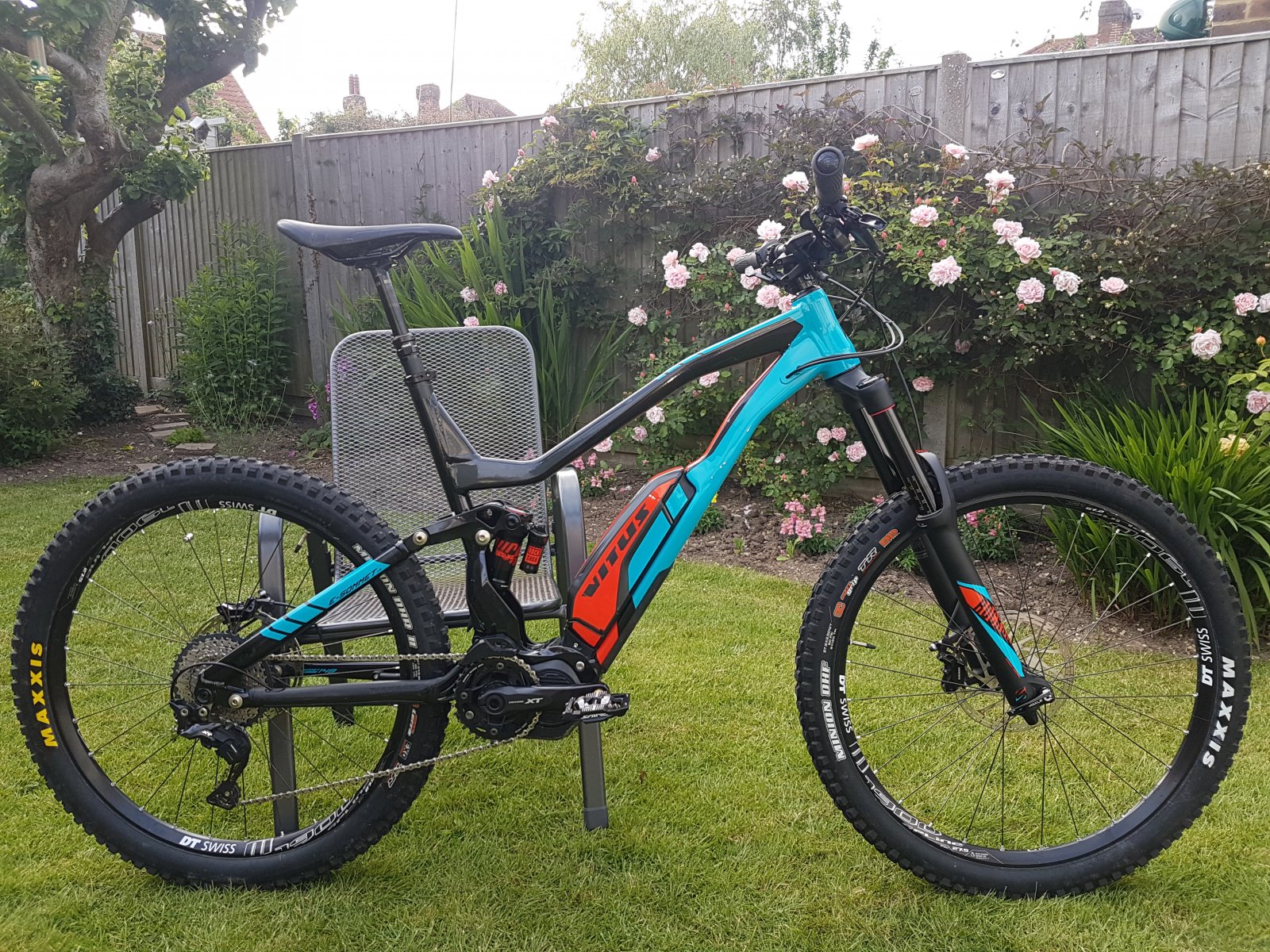

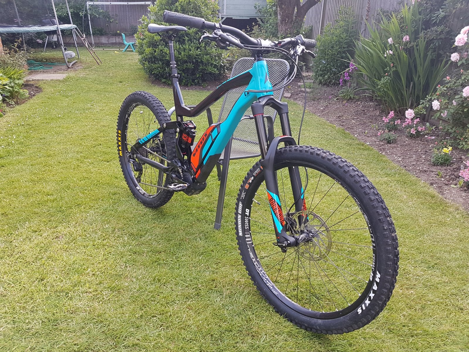

I've been busy tinkering whilst laid up, here's a couple of garden photos
View attachment 2222View attachment 2223
List of mods so far;
170mm Reverb with paddle remote
SC6000 mode selector
SQ labs 45mm rise 12 degree sweep bars
XT shifter (just because I had it)
Ergon GA2 grips
165mm XT cranks
Shimano Saint pedals
Maxxis Minion DHR 2.8 rear tyre (thinking of changing it though as it is a bit vague)
And the all important custom Slik fork and shock graphics!
Also got a 2019 debonair air spring on order, thinking of changing the order to a 180mm version though. Thoughts?

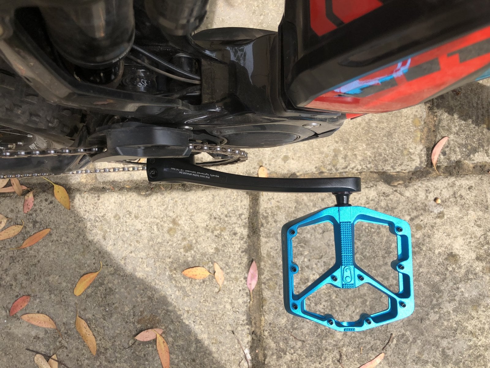

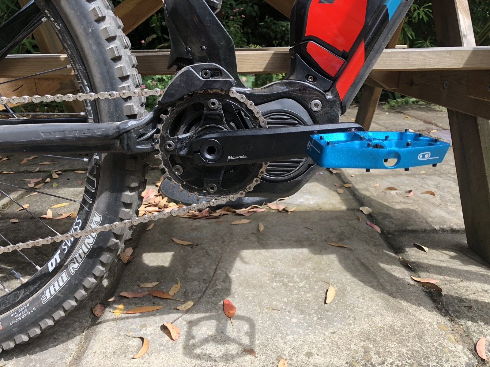

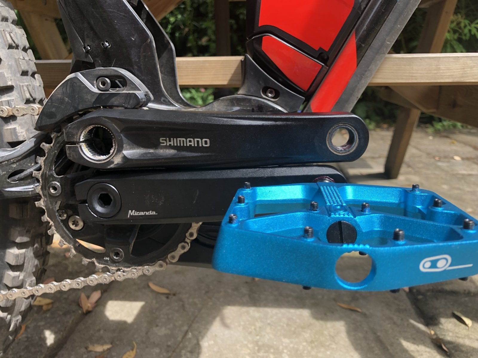

Ok, so just put 15 miles on them this morning.
First thing is my usual ride involves 2 miles or so of road to get to the off road so to speak, and from the moment i set off i noticed the difference in cadence, its not massive but noticeable. Because of this i would be reluctant to go shorter than the 160mm. If you purely ride off road you may not be bothered by this.
However the moment i hit the off road, it was no longer noticeable, mostly because on the road i am usually just under or just over the cut off for the motor, and spinning a constant cadence, whereas off road i only hold a constant cadence for shorter amount of time, and if i am holding a constant cadence its on a steep uphill at speeds well under the cut off.
Once off road these make a big difference, i deliberately rode down and up the roughest parts of single track which are very rooty, with lots of run off channels cut into the clay by the water that makes up most of the tracks round here, and i didnt have a single pedal strike today. I would say that since getting the bike i have modified my riding style to minimise pedal strikes, but by about half way round my loop i had a new level of confidence in the bike, and was charging everything.

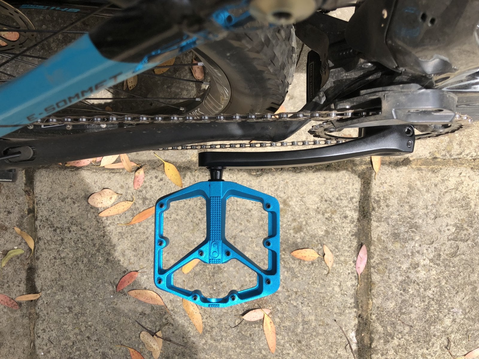

Also loved the crank brothers stamps, big improvement over my Nukeproofs. I went for these because i figured the large pedal platform would help off set the reduced overall peddling platform from the shorter cranks.
I have no technical data to back this up, but the Mirandas felt stiffer than the stock cranks too, and felt more efficient. They are less hollowed out than the OEM cranks.
All in all i would have no hesitation in recommending these cranks to anyone suffering from pedal strike! Bare in mind you will need to raise your saddle height to offset the drop in crank length.

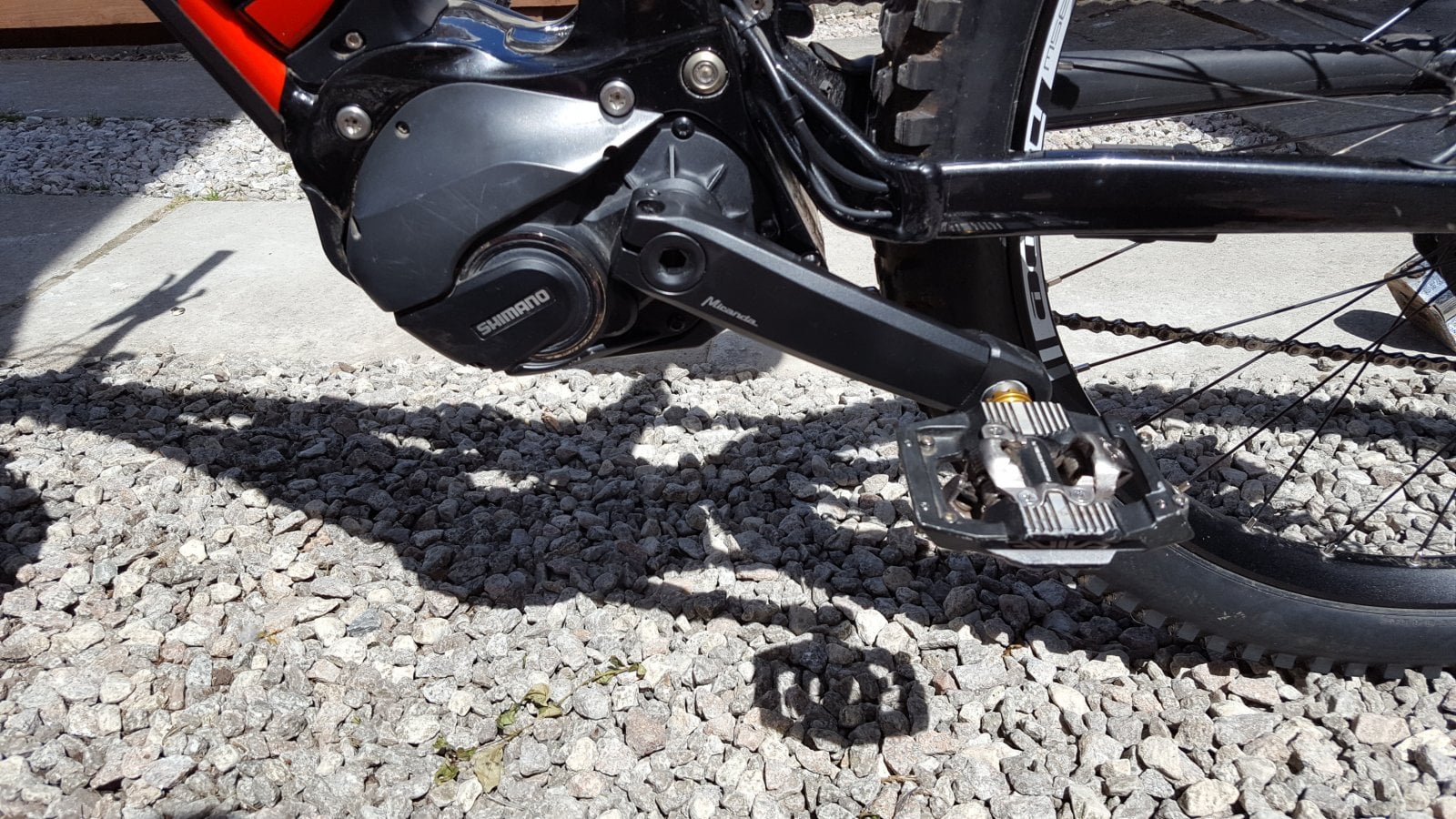

Received and fit my Miranda cranks today. I went for the 150's..
Just back from a two hour ride thro' my local trails. As mentioned above you immediately feel a difference in cadence and that you are putting in more effort for any given situation compared with the 175 Shimano's. However they soon feel natural and (the reason for the change) pedal strikes seem to be a thing from the past :). Recommended.
For the record the Miranda crank reference is Delta SH 150Q and cost including shipping was euro79.

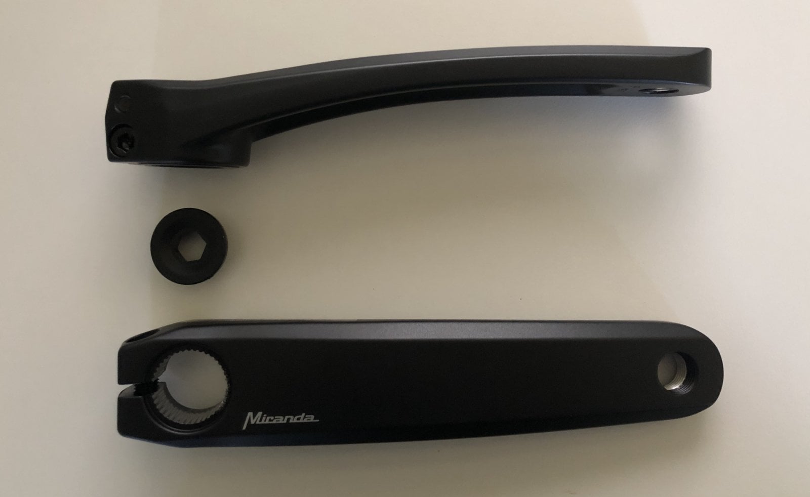

does anybody know if the miranda cranks that Merlin are selling come with fixing bolts
Mine did, from Dillglove Limited - although when i spoke to them on the phone they thought they did not come with bolts.
I couldn't get the locking plate to fit from the shimano cranks, as i think the bolts are set slightly further away from the spindle on those, compared to the Mirandas.
