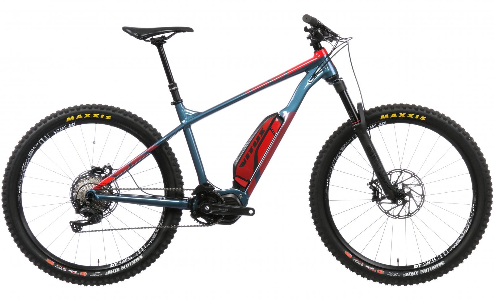

Anyone had a problem with theirs turning itself off on a rough section? my system keeps turning itself off mid ride, usually when the rough stuff arrives. Any ideas how to solve this?
I had this very same problem I thot was the battery connection as would get 010 error so I cleaned the connections and all would be ok for a few rides then happen again, anyway I noticed that there was some play in the battery so I adjusted the battery holder so it's a snug fit and it's been faultless for 400 miles. You have to take the plastic cover off the key lock and there are 2 cap head screws to adjust how tight the battery fits. Easy job.
You have to check the battery mounts from time to time as they can go out of position

Quick report on my E-Sommet.
It''s a little over 3 months old now.
Have now done around 800miles on it and somewhere around 230000ft of descending (and climbing, but who cares about that? ;) ).
Still running the same chain and it's running abslutely fine. Chain measures pretty much exactly the same wear rate as the SRAM chain on my YT Capra which has done 500 miles (in very mixed conditions, The Sommet has seen more dry weather). So as I expected. Chain wear isn't the massive problem so many Ebikers told me it would be.
Still running the Minion 2.4 DHF/ 2.3 SS Exo tyre combo I fitted a week after getting the bike. pretty much zero wear on the front. a tiny bit worn on the centre tread of the rear SS. No punctures. So again there's no extra wear on tyres using an Ebike. and absolutely no need to go over a 2.5 tyre. (My DH times are slightly faster now on this bike than my Capra - mainly because I've been descending so much more on it)
I'm still on the original set of brake pads (about half way worn, and lever feel is still great with hardly any extra throw) . And can't fault the Guide REs. I have Guide RS on two other bikes and the REs are way better. I wished I'd had them out in the Alps on my DH bike a few weeks back. I hadn't realised until speaking with a mechanic over there that the RE is basically an RS lever mated with a Code caliper. Something a lot of DH riders used to do for ultimate stoping power and performance.
So again. Ebikes don't go through brake pads any more quickly than normal bikes.
Issues/non issues worth mentioning:
* During the first few weeks of ownership I'd get the E013 error and have to switch off/on. this was due to the wheel magnet rotating. it prety much always did it if I whiped a jump and landed a little too sideways. The magnet nut was tight. What was actuallt happening was the entire spoke was rotating under compression. (a problem with straight pull spokes. To fix this I removed the spoke, cleaned the eyelets and threadlocked the nipple and the head and re-tensioned the spoke. It seems to have worked fairly well. Still wish I could get hold of a Lapierre spoke magnet though (attaches between two spokes rather than one)
* the seat tube on the E-Somet is not reamed deep enough for me to fit a 170mm dropper. not an issuel for descending in the slightest but I do like my saddle as far out of the way while manualling as possible. (a hang up/old habit from riding BMX/Dirtjump bikes)
* The OEM Brand-X dropper developed a tiny bit of sag. CRC refunded me the cost of it and I fitted the 150mm Brand-X (I'd already bought from them) This one is working fine but has massive amounts of rotational and front to rear bushing play.
* The red paint/decals are hella ugly. so I got rid of it (blacked out) and removed the red battery decals on mine and it looks much nicer.
* Suspension is all running very smoothly. I removed all tokens from the Lyrik to run less sag (personal pref). Stuck with the two tokens in the shock and progressivity is spot on. (85psi f, 205psi r, not that it's going to be relivant to most). One thing about the SuperDeluxe though. It really doesn't have a lot of low range to the rebound damping. If you like your rear rebound on the fast side you're going to be running it wide open.
*All frame pivots are running smoothly and all hardware has stayed tight. No bushing wear yet.
Headset has come loose a couple of times and the bar/stem/steerer have had the odd creak. All good with a re-adjust and tighten though.
The bike has had a couple of fairly epic crashes. an taken them well. only damage has been bent controller levers. which bent back easily and a scratch bar.
*rims are ding free and straight. I never run low pressures so rarely ding a rim but I do land sideways a fair bit.
* BB height is great. for an Emtb I was pleasantly surprised at this. it's not quite as low as my Capra (I'm running 26" wheels in that specifically to lower it) but pretty close. Unlike a lot of folk on here I won't be going to super short cranks though. I'm already really used to low BBs and still ride lots of different normal bikes with either 170 or 65mm cranks a lot so switching crank lengths by any more just doesn't appeal.
Motor problems. This needs a whole paragraph to itself...
* About 3 week ago on one ride the motor kept giving the E010 fault and shutting off. A clean of all the contacts at the battery and under the motor case solved this. I also re-adjusted the top battery mount as there was a little bit of play/free movement there. Thanks for that tip @R120
The Shimano motor hasn't all been plain sailing though...
* A few weeks into ownership I started hearing a creak from the BB/crank area which turned out to be the chainring lockring not being tight enough and allowing the ring to move on the spline. Tightened and all fime again. not long after this my L/H crank loosened (while climbing) and came clean off the axle. I replaced it on the trail and torqued the pinch bolts up nice and tightly and it did it again. When home I replaced the plastic shimano preload bolt (it's threads had been damaged while it ejected) with an Alloy one. Thread locked everything and it's not budged since.
* Somewhere around the 5-600mile mark the BB started to have a little play. (lurking) here I read that a small amount of play is considered normal.
Well since then the play has worsened. and the BB creaks like hell when pedalling. I've stopped riding the bike and contacted CRC so will jut have to wait until they get back to me.
Here's the video I sent CRC showing the play and creaking. it's just a phone video so sound isn't great but you should hear it if you turn it up.
I've had the same thing on a new E8000 bike, made a short video

No major issue with mine apart from the magnet moving down the spoke so the motor turned itself off.
It's a really great bike and is more stable on the rough stuff thanks to the added weight.
Just make sure everything is tightened up correctly on it though.
Martin who has one had his right hand crank arm fall off mid ride, night mare!

My magnet kept on twisting around, I remember reading on here about putting some thread lock on the spoke so I need to do that, also my bars did end up been slightly off centre half way around but I only tightened them up with the included multi tool which fell apart while doing it :D so that reminds me to do that.
That would have been me.
It's not a fool proof fix.The hub is straight pull so the spoke can rotate under compression at the rim eyelets and the hub flange independently of the spoke threads.
I put threadlock on the spoke threads, inside the nipple, on the base of the nipple AND around the head of the spoke inside the hub spoke hole.
something stronger than loctite 242 would be better, but it's all I had to hand at the time.
Hi @inwoods It's now been over 2 weeks since I contacted CRC about the problem and my bike is still here boxed awaiting collection.
I waited in yesterday for the courier arranged by email with CRC only to be told late in the afternoon that because of the Lithium ion battery they are now using a specialist courier to collect it on Monday. I still have no confirmation from the courier of this.
What's really annoying is that they shouldn't need the battery and this should have been realised from the start.I offered to remove the motor and just send that but CRC insist they need the whole bike. to "test" *sigh*
I've spoken to 2 local Shimano service centres in Edinburgh and a mechanic from CRC and we all agree the main BB bearing is most likely to be the problem. Unfortunately this means the motor unit has to go back to Shimano.
Communication on the whole from CRC has been pretty terrible.Let's hope Shimano are slightly better.
