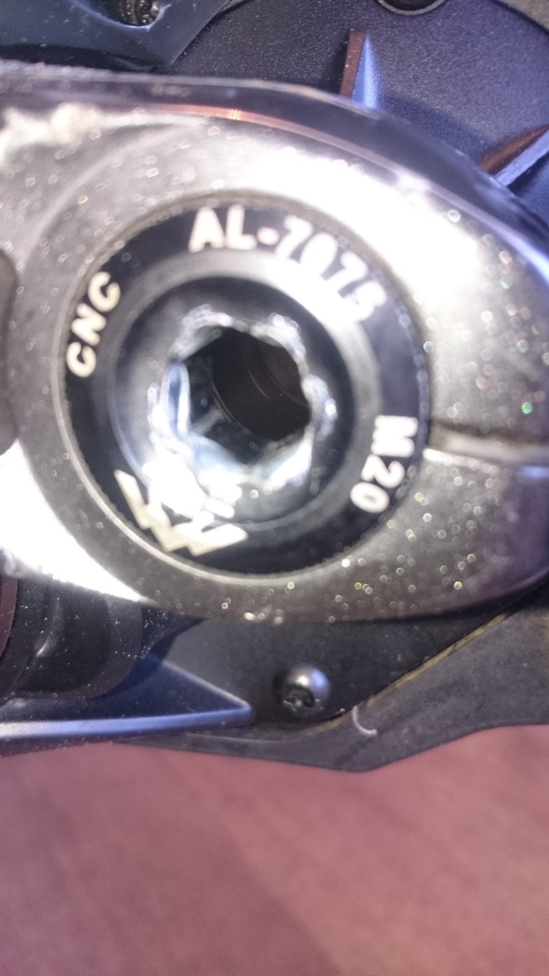

Not all that impressed with CRCs workshop staff's skills though.
HTII pinchbolts not tight enough.
and someone doesn't know how to work a 10mm allen key.

I'd get that replaced asap

That looks more like a ball ended 11mm Allen bit in an impact driver doing up a 10mm Allen bolt. Nasty!!!

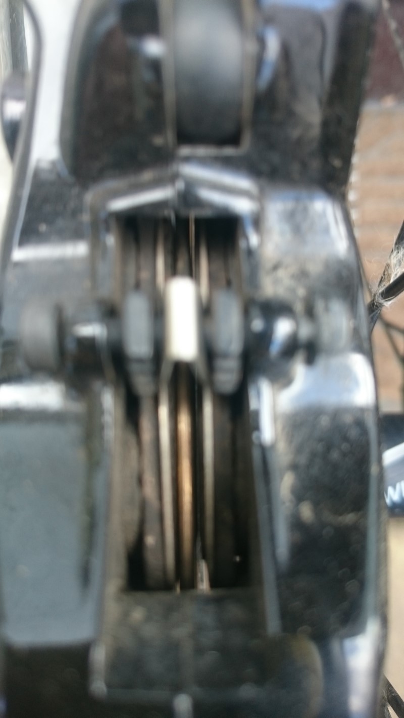

Brakes have been flawless, still on original pads barely half way to worn and excellent firm lever feel. Easily the best brakes I have on any bike.
Here's the rear pad wear if you can cope with my poor photographic skills again

It still functions. I'm more shocked a shop mechanic would fuck it up so badly and not at least send me a note with an explanation/appology. The other one is fine.
