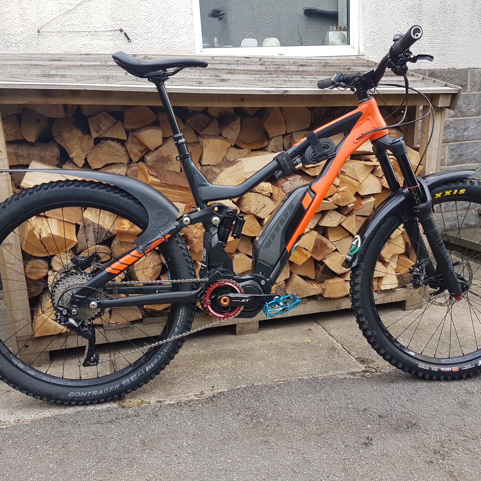

Bike ready for a long weekend in the Lakes
I definitely need those Mudguards and tool straps for mine, they look the biz for winter!
