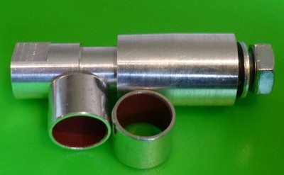

There is some play in the bottom eyelet of the Rockshox SuperDeluxe shock on my E-Sommet VR. Should I replace the bushing, the mounting hardware or both?
