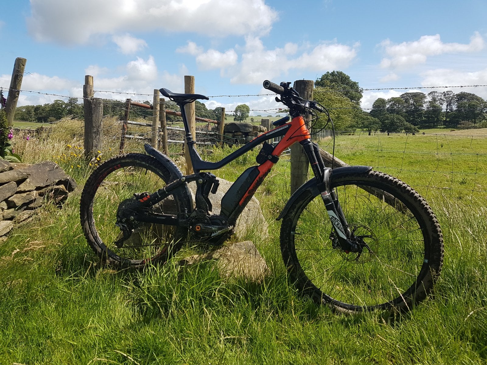

Rear fender is a front RRP max guard,need to do some more rides with the 29er front wheel before I can really say weather it's better or not (only done one ride, I mainly ride unassisted bikes)
