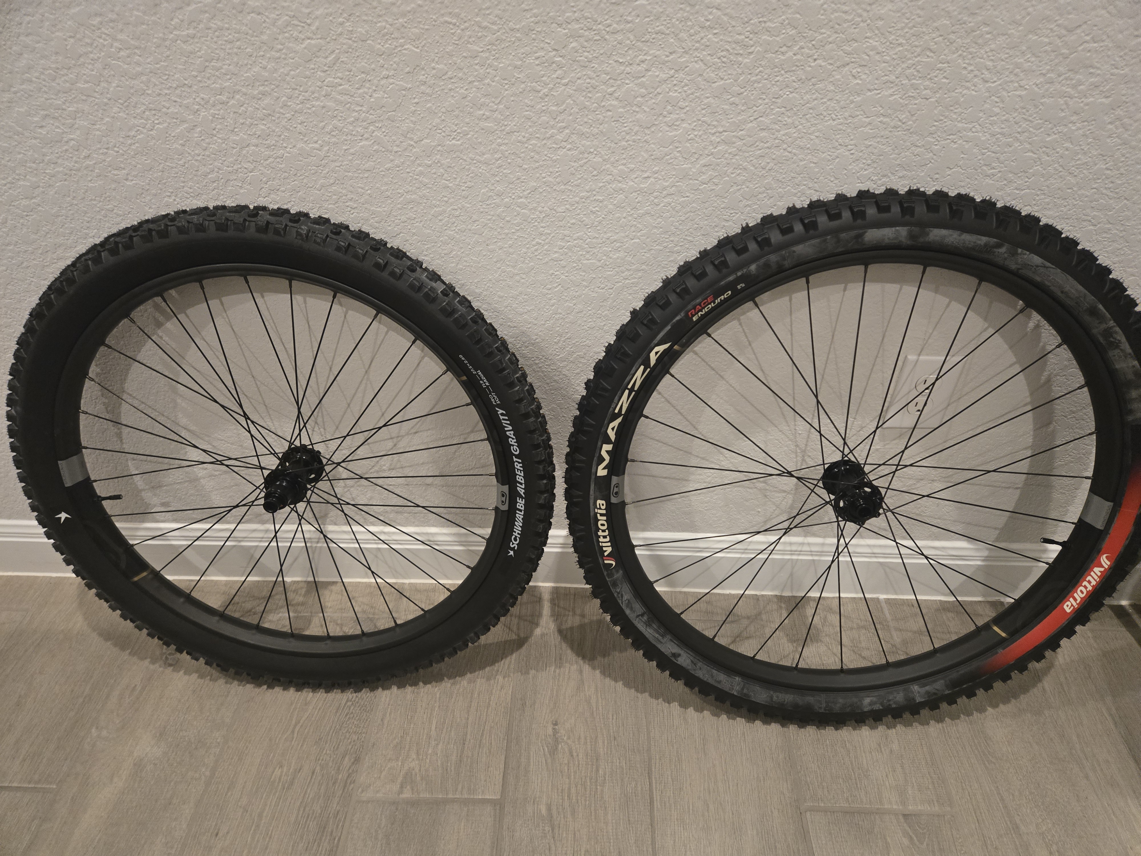

I only run carbon wheels but I keep breaking them, even 2 DH ones. I have a new set of CB Synthesis DH rims here for the new e-bike build. These were built with OneUp hubs and Sapim spokes and came in about 200 grams lighter than the same rims if you get their spokes and hubs.

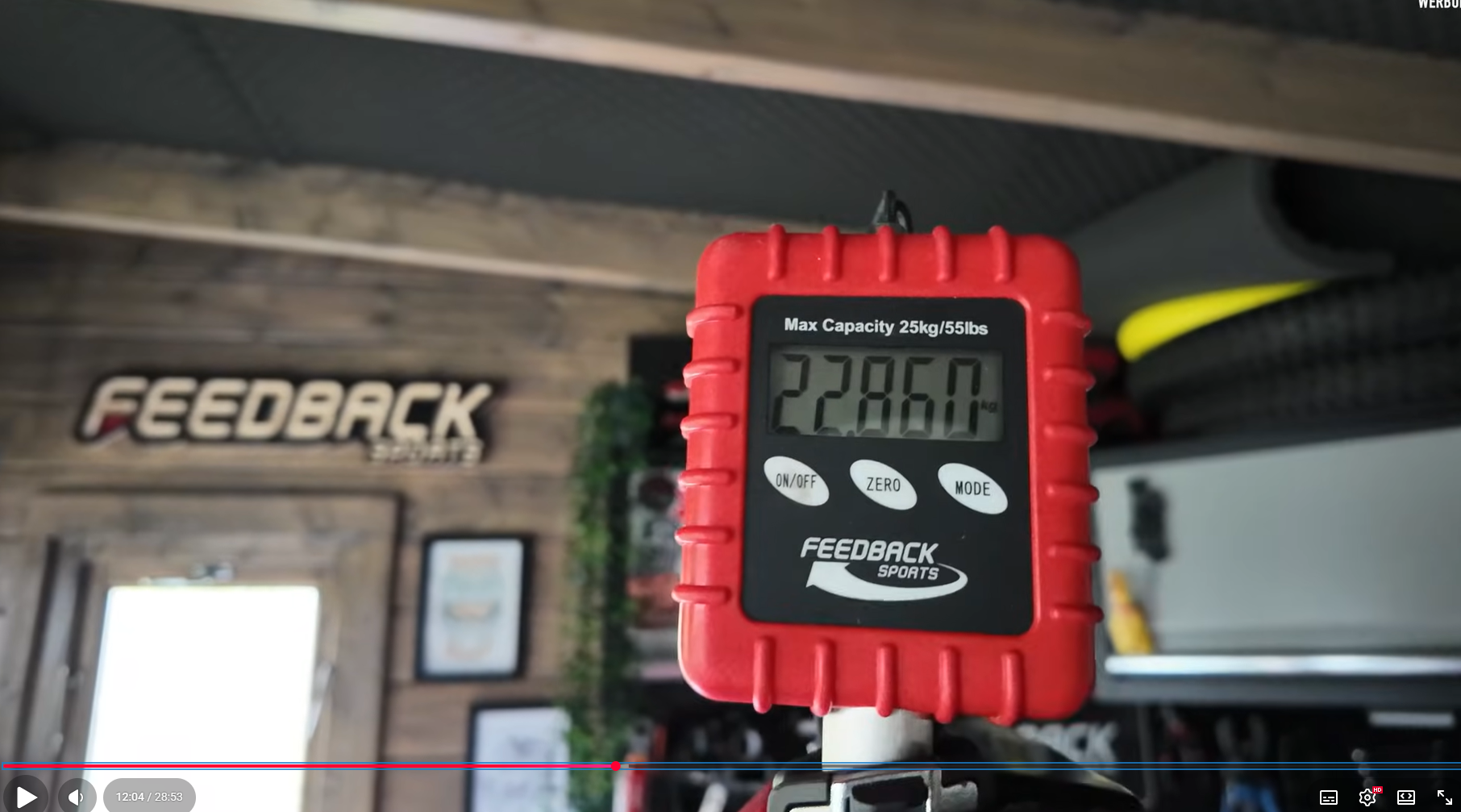

Toffers Bike weights only 22.86kg with Pedals - but EXO Tires
(from min 12:00)
That's what i'm talking about. Take the pedals off and add DD's and ya close pretty much bang on to 1kg lighter than robs build.
That bike is a M isn't? The L frame is going to be more. I'll try to find out the difference next week and share.
