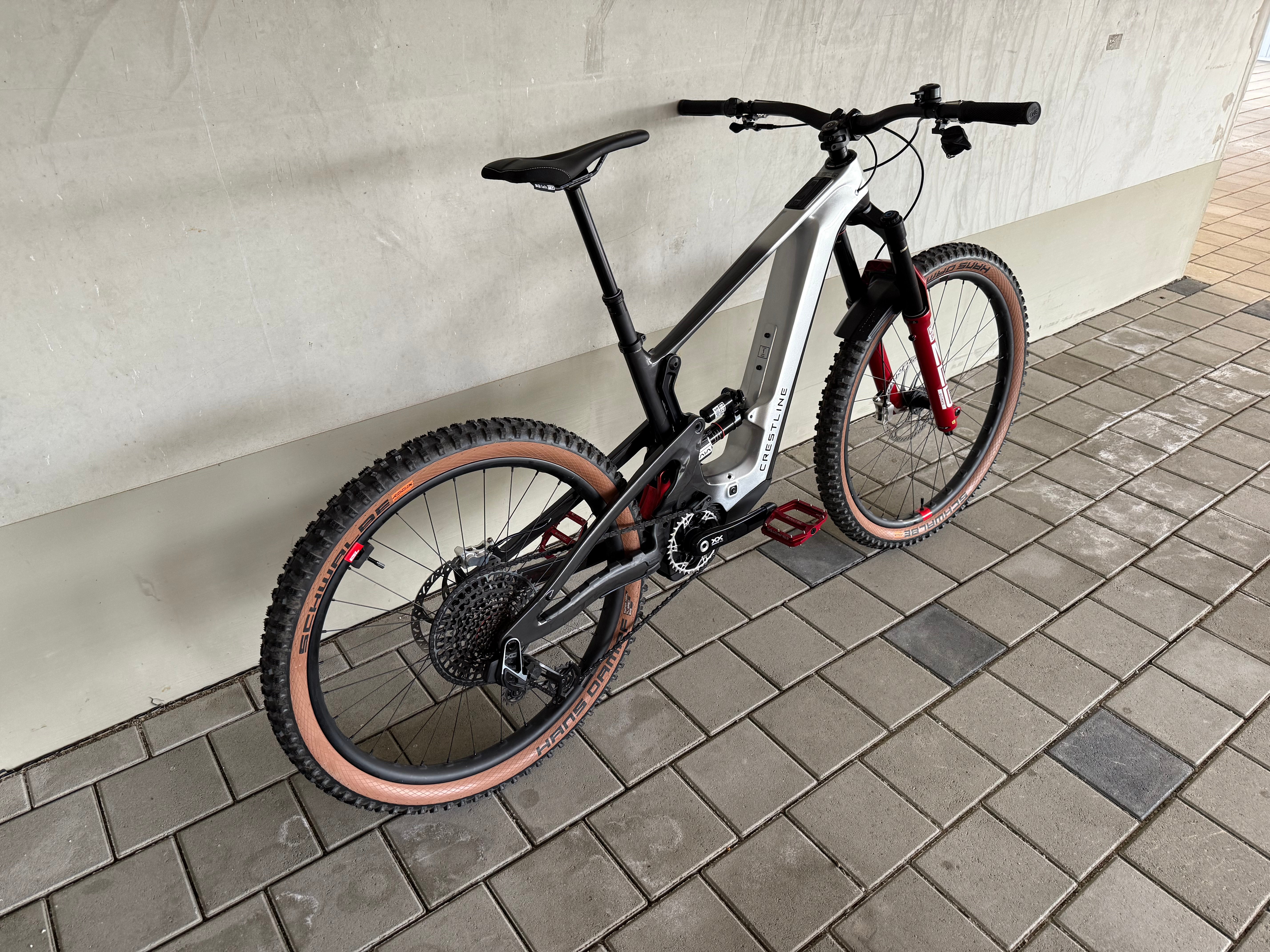

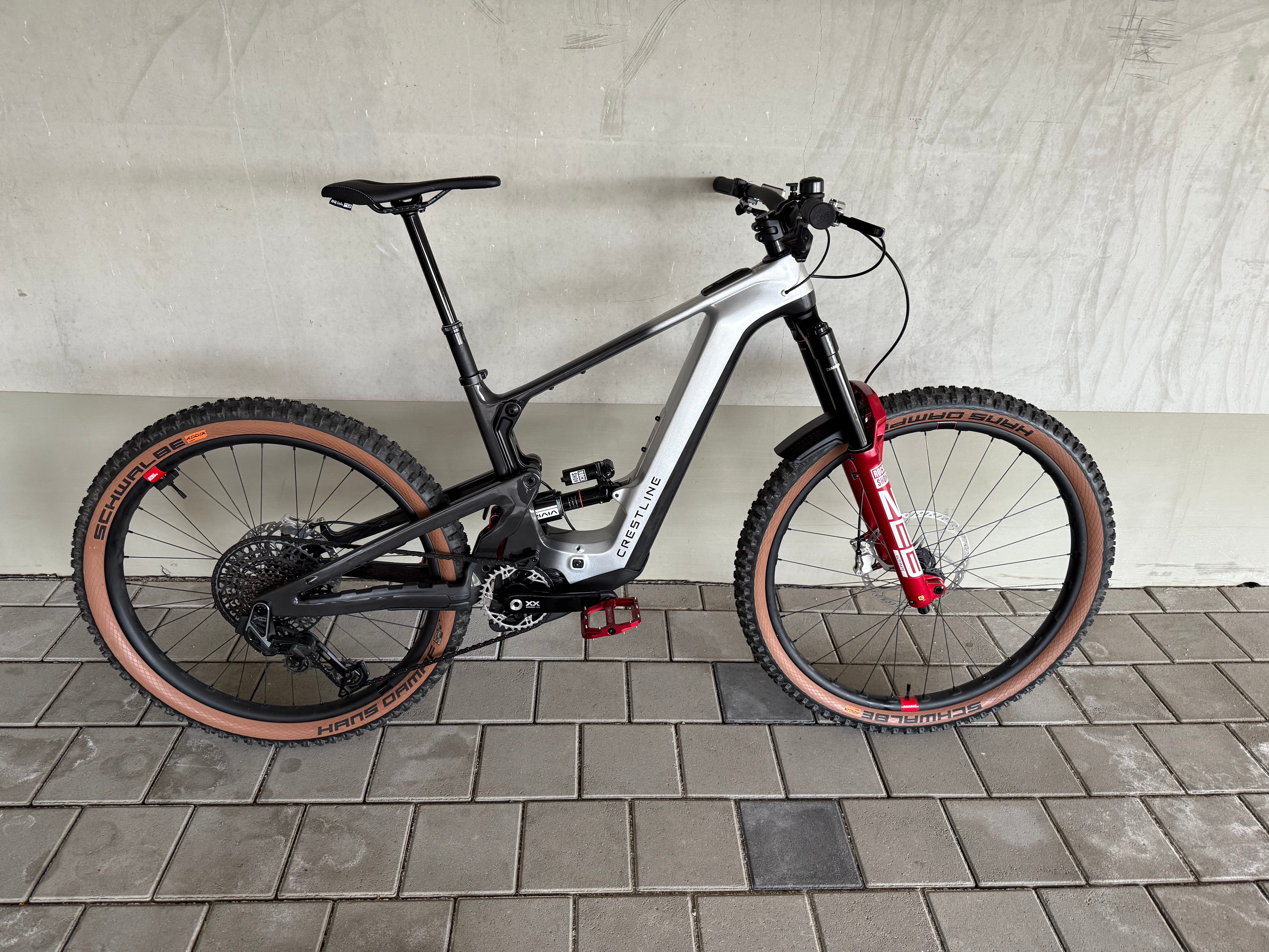

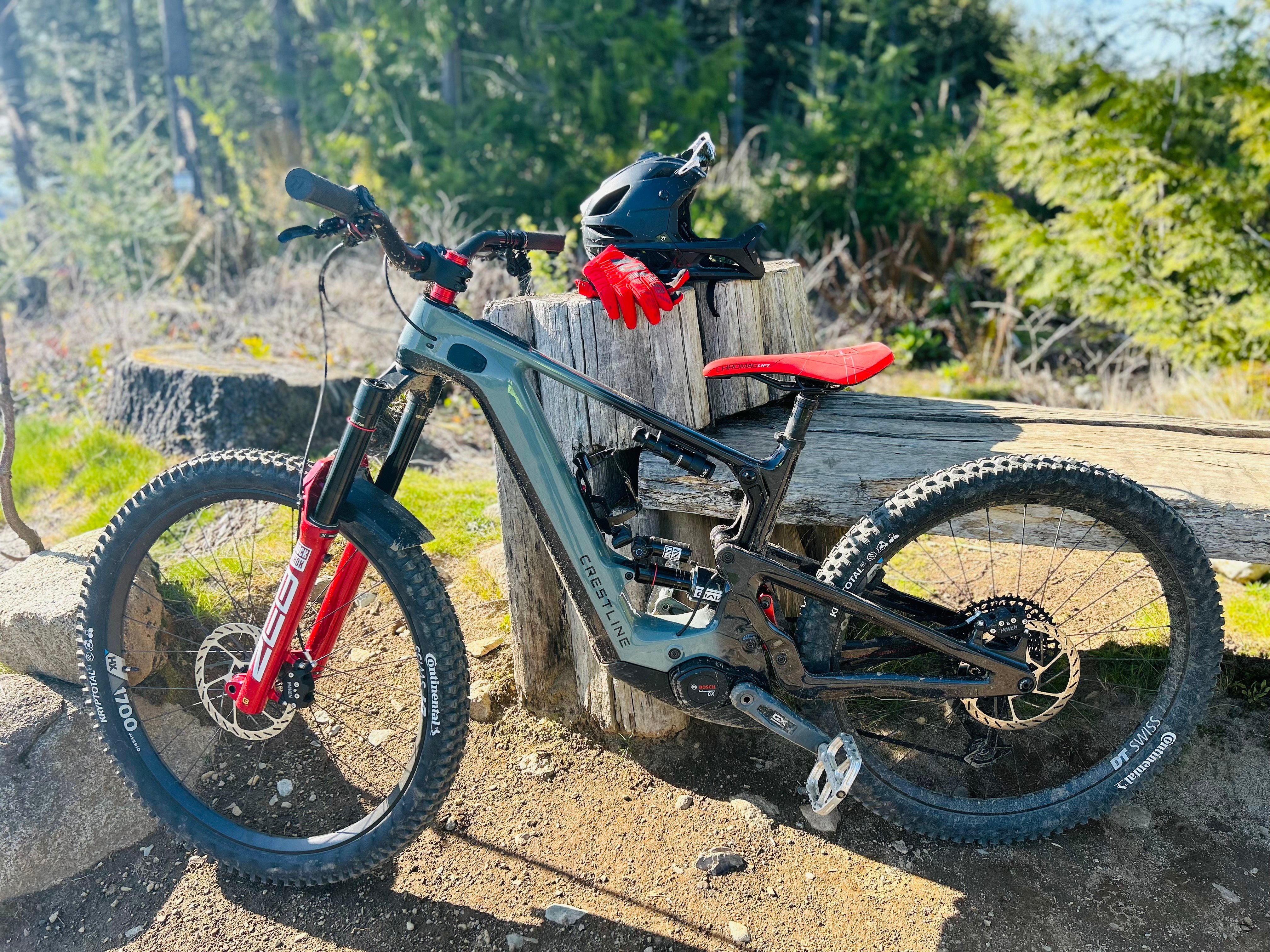

My custom S180
Haven’t riden mine yet. Freshly wrapped. I have to try the 180 mm dropper.
I also was on the Pole then a Wild now this beast. It’s the perfect bike for me 🤩
Is that an ochain? Does it make a difference in an ebike? What size bike and axs dropper are you on?
It is an O-chain, couldn’t find a spider as I run a 32T chainring, I’ve been liking it. Zero pedal kick and don’t notice that it’s there.
Bike is RH-2, running an old 150 dropper. Sram calc says my short butt can only fit a 150 even with the new style.
Pmed you

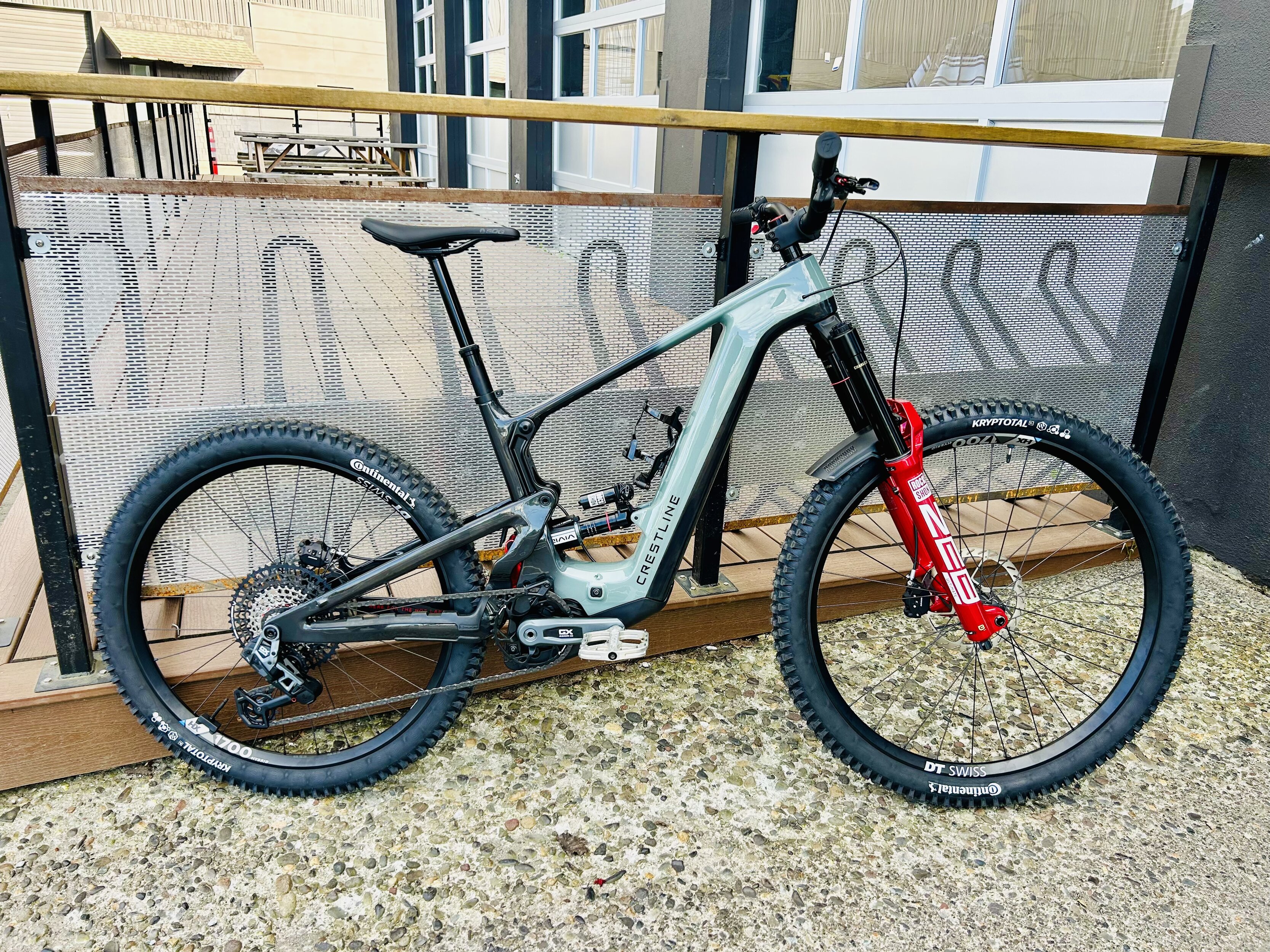

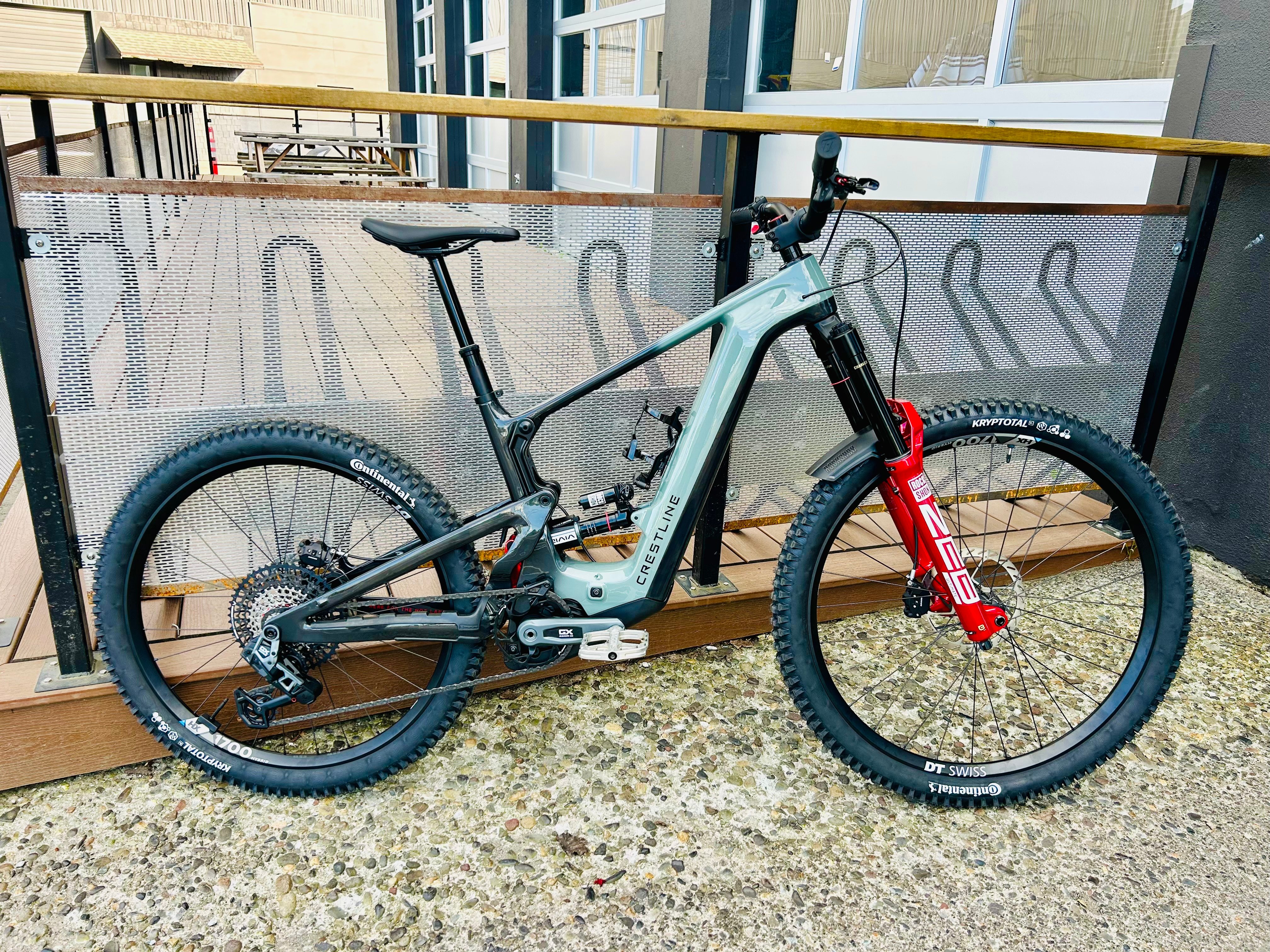

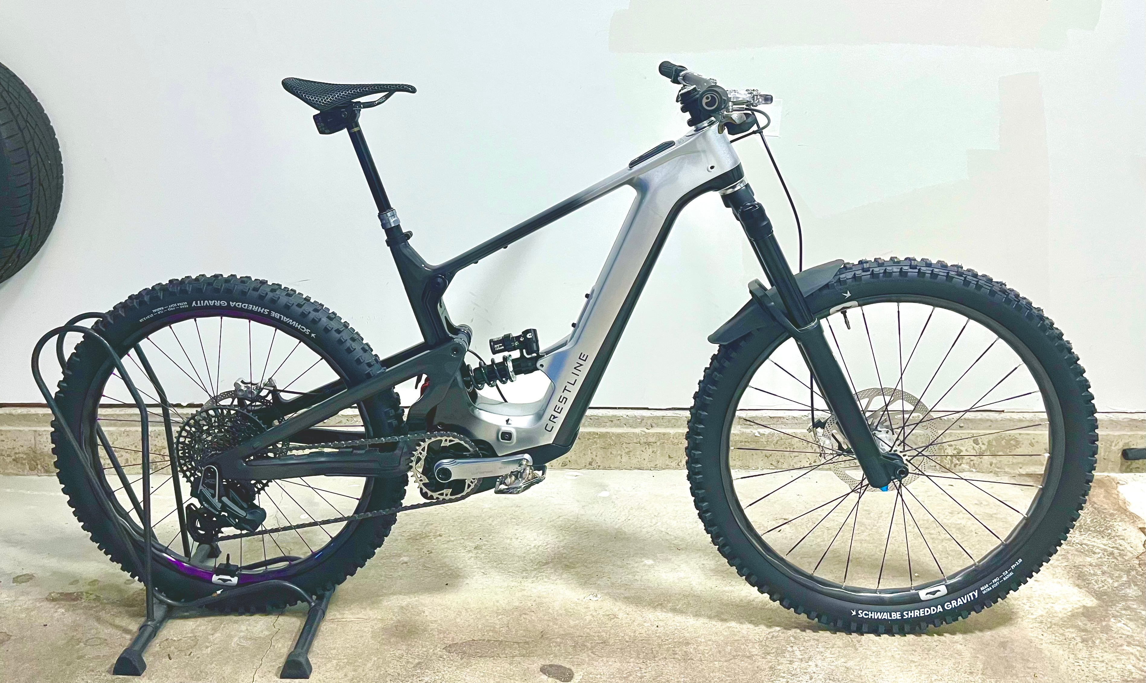

Mine's all built up - still need to bleed the rear brake.
Also made a quick edit with exposure on the photo, so details would show up since my garage had bad lighting.
RH3 Mullet @ 50.6lbs
Parts:
Mezzer 180mm silver works component +5mm reach adjust (yes adds 12mm to axle crown length - so probably 63* head angle now)
Vorsprung Telum shock
Lewis LV4 brakes 220 / 200 rotors
X01 Transmission w/ 34t chainring
155mm e*13 helix race cranks
175mm axs dropper + 3d printed Ryet saddle
TR35 Front wheel w/ Berd on i9 hydra
TR37 Rear Wheel w/ Tannus Insert on Tairin S1 Silent Hub (built in oChain like device :p)
Shredda Rear Gravity Supersoft on Front and back
77Designz stem w/ Koryak eBar 780mm
Parts for later:
Boxxer 38 with Vorsprung Smashpot 190mm (same AC as 180 single crowns)
FSA Gradient Direct Mount Stem
You guys that are running the S180, are you leaving the Works headset in that adds about 10mm of stack? Curious because on the 160 I can see it but if you run a 180 fork, doesn't that make the front end kind of high? Seems like you would wanna not use it with a longer fork to keep the geo in tact. They list the LS160 at 64* HTA and the S180 at 63.5*. 20mm of added fork length should be about a full degree of HTA change. Or does the LT/ST flip chip make a diff in geo?
Mine is running sweet with the works headset. I think it has slackened the bike by .3° maybe.
Note that i went +5mm which also has a slight dropping effect to cancel out some of the increased stack.

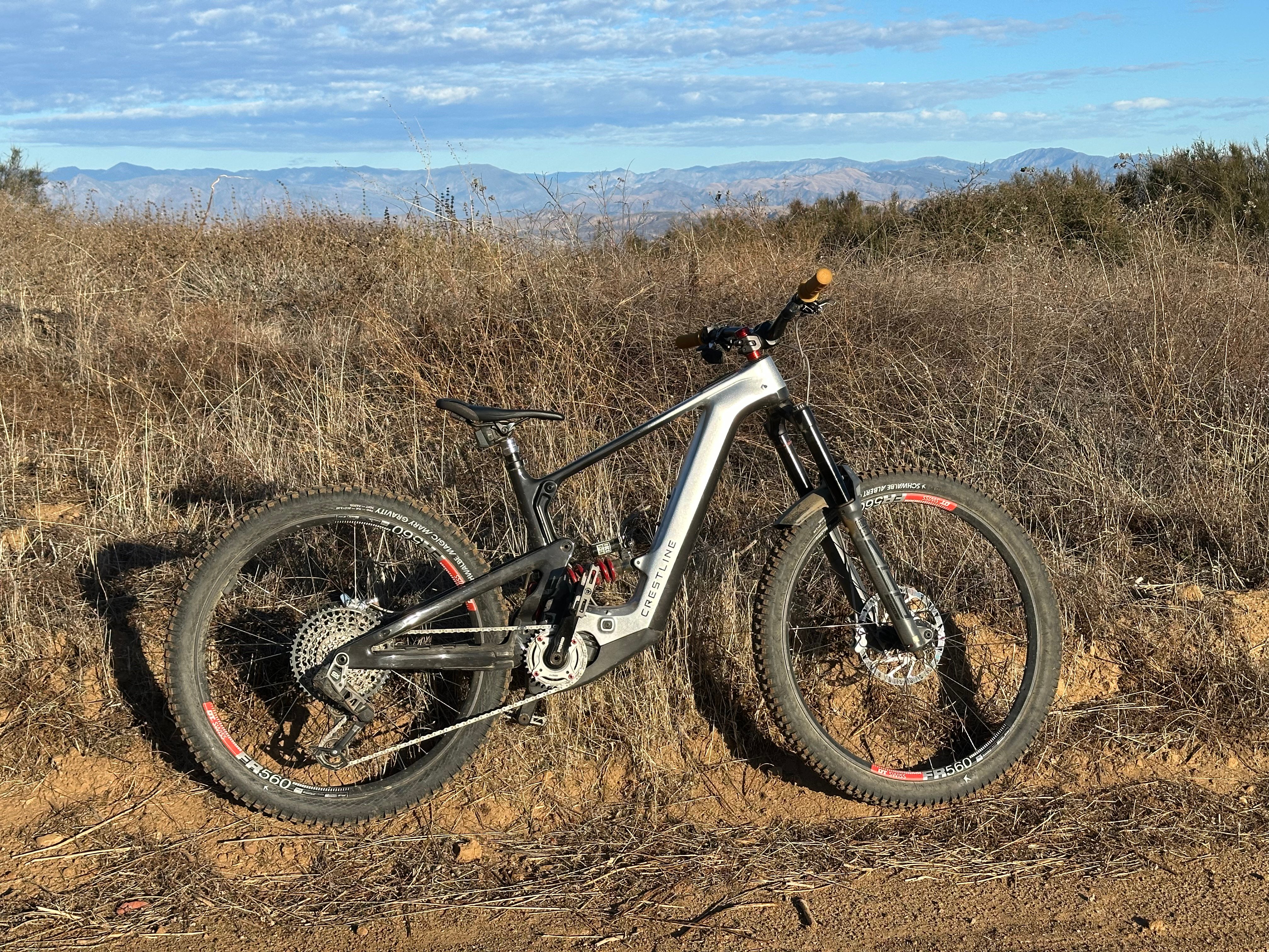

Can you clarify all the differences you noticed?
Are you on Gen5?
I usually just ride in the 12deg setting on my bike (yes a Gen 5 Crestline) I switched it to 0 deg for a race thing I did which was quite flat and I wanted to pump as best I could etc. There was one section that was very high speed and rough, the difference in bike feel was significant. It felt like the shock was locked out lol. Bike was harsh under feet. I would probably pull some Hsc if I run it like that all the time. With ochain at 12deg I'm confident it would've been a magic carpet in comparison.
It actually backs up another section I've race on with and without ochain albeit gen 4 vs 5 and a different shock. Felt the same way 😎
