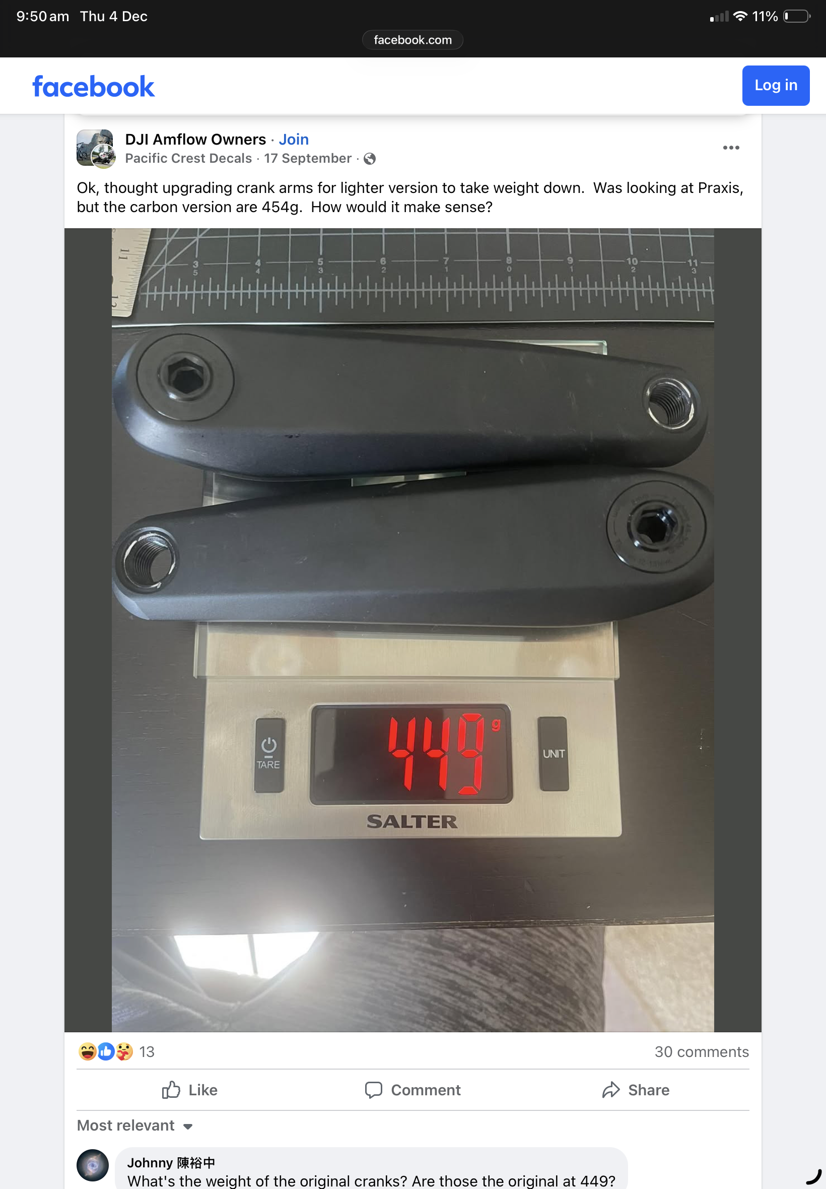

For anyone interested, not my pic but found on the web.

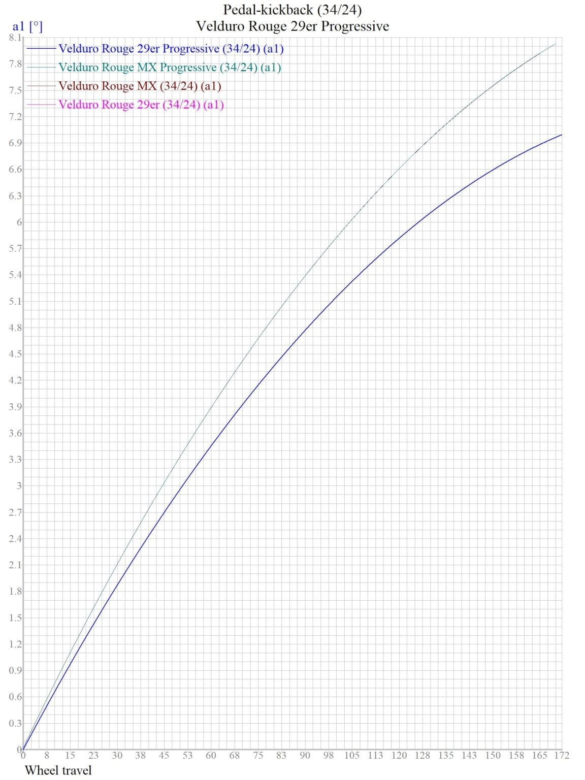

4-7° in the most used travel range is not virtually no kickback
I would argue that in the real world with a fairly standard mullet wheel set on 90% of trails! You are not going to experience kickback.
Rob’s video confirms it’s virtually none exists.
The part of the chart you’re referring to is an Extreme scenario! IF you are running a specific high engagement hub on a full 29er (that 90% of people won’t run) plus you’d be on full send to hit that deep into the suspension.
That animation ISN’T accurate. Check this out
Depends on Robs DT Swiss Hub. If he's running the 18T. It has up to 20 ° of takeup. 36T has 10 ° . Both of which would absorb the entire kickback. That's why I suggest the lower engagement hub. I'm running 72T giving 5 °.
What about a hydra 2 hub 😂😂😂😂😂
That's not how hubs work. With 18T, it has anywhere between 0* and 20* of deadband at any given moment; with 36T, it has anywhere between 0* and 10*, etc. It depends where the pawls/ratchets are in relation to the teeth at that time. On average, I think you'd expect half of the max: so 10* for 18T, 5* for 36T etc. But it will constantly vary and often will be close to zero, giving you unpredictable suspension performance. The benefit of an anti-kickback device over a low-engagement hub is that it keeps the deadband more consistent (and adjustable).
