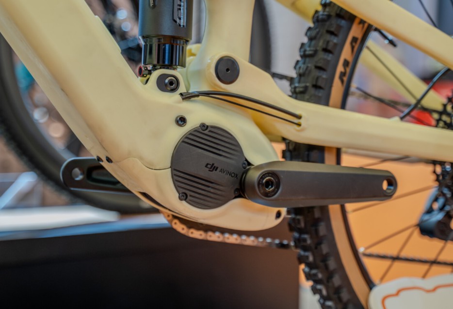

Seems to look more like that on another photo i found. Perhaps a newer variant of the frame.
I can't find a pic of the other side with the port in that place. Assume they would both be the same, but maybe it would put too much of a bend on the gear cable. As long as i can run a cable mech.
Actually this neater brake cable routing may have been an earlier frame model.
The nz guys are getting deliveries with much longer exposed cable as per the website and robs build.
The original printed bike had the short loop, maybe caused to much cable stress.
Not that it really matters, but i do get a bit nervous not knowing exactly what is going to turn up.
Mine begins about abeam the front of the shock mount. I’ve used silicone tape to tie the two cables together, most elegant solution I could come up with. Also used the silicone tape around the speed cable routing on the chain stay to keep it from clapping in the hole.
Hmmm ....... With that colur frame, that really doesn't look good. That speed sensor cable looks well stretched.
