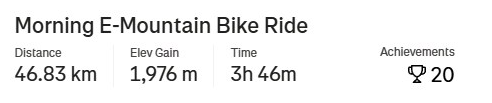

Dont forget about fast charging options too. Here's a ride i did the other day. I swapped my 600wh hour for 400hw (bosch gen 5) mid ride and kept blasting. The my boy on the dji slapped his on fast charge and punted the battery back over a lunch break and we kept on riding.
I'll be honest the fast charge option is a pretty good substitute for a battery swap.
It is worth noting that shimano charges pretty fast too.
