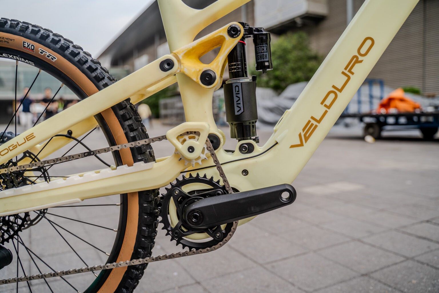

Watched Rob's video. When he was bouncing the rear shock. He did a longer shot where you could see the rear cassette. That cassette was rotating forward, whist the brake rotor on the other side was still .
This means the hub is absorbing any pedal kick with some free play. If it was a high engagement hub. The chain wheel would be rotating back, instead of the hub rotating forward.
I'd be interested in the points of engagement of that hub.

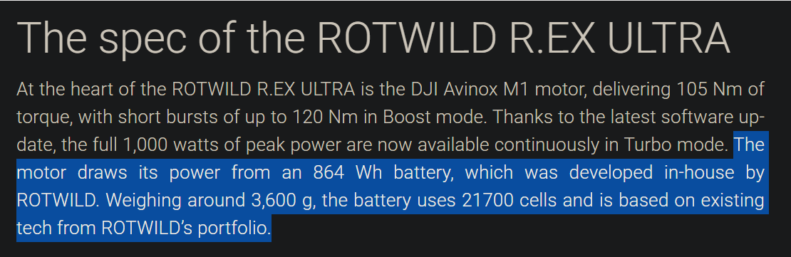

Not sure if that's a response to me, but the Elyte 150 and Elyte EVO use 400wh internal batteries plus a range extender right above the BB. That gives a lower COG than using the longer 600/800wh Bosch batteries. They also rotate the motor to allow the battery to drop as far as possible. Reviews suggest the handling is indeed better as a result. But even 650wh isn't enough for me, unless the internal battery can easily be swapped out (which it can't on these models), and I want more than 142mm rear travel.
As I say, if Bosch, Avinox, etc allowed third party batteries then bike manufacturers could build bikes that actually optimised for performance (or whatever criteria they wanted to optimise). And if they sold motors directly to end-users or small frame builders, we could also get frames custom made to our requirements. But all the major EMTB motor manufacturers (with the exception of Bafang and to some extent Shimano) tie you into their ecosystem of proprietary parts, and won't even let you use those parts unless you're a big company with a big contract.
who says they don’t? rotwild uses a custom battery in theirs
Fair enough. I guess most companies don't have the in-house expertise to develop their own, or they like the aesthetics with the Avinox battery.

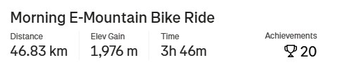

Dont forget about fast charging options too. Here's a ride i did the other day. I swapped my 600wh hour for 400hw (bosch gen 5) mid ride and kept blasting. The my boy on the dji slapped his on fast charge and punted the battery back over a lunch break and we kept on riding.
I'll be honest the fast charge option is a pretty good substitute for a battery swap.

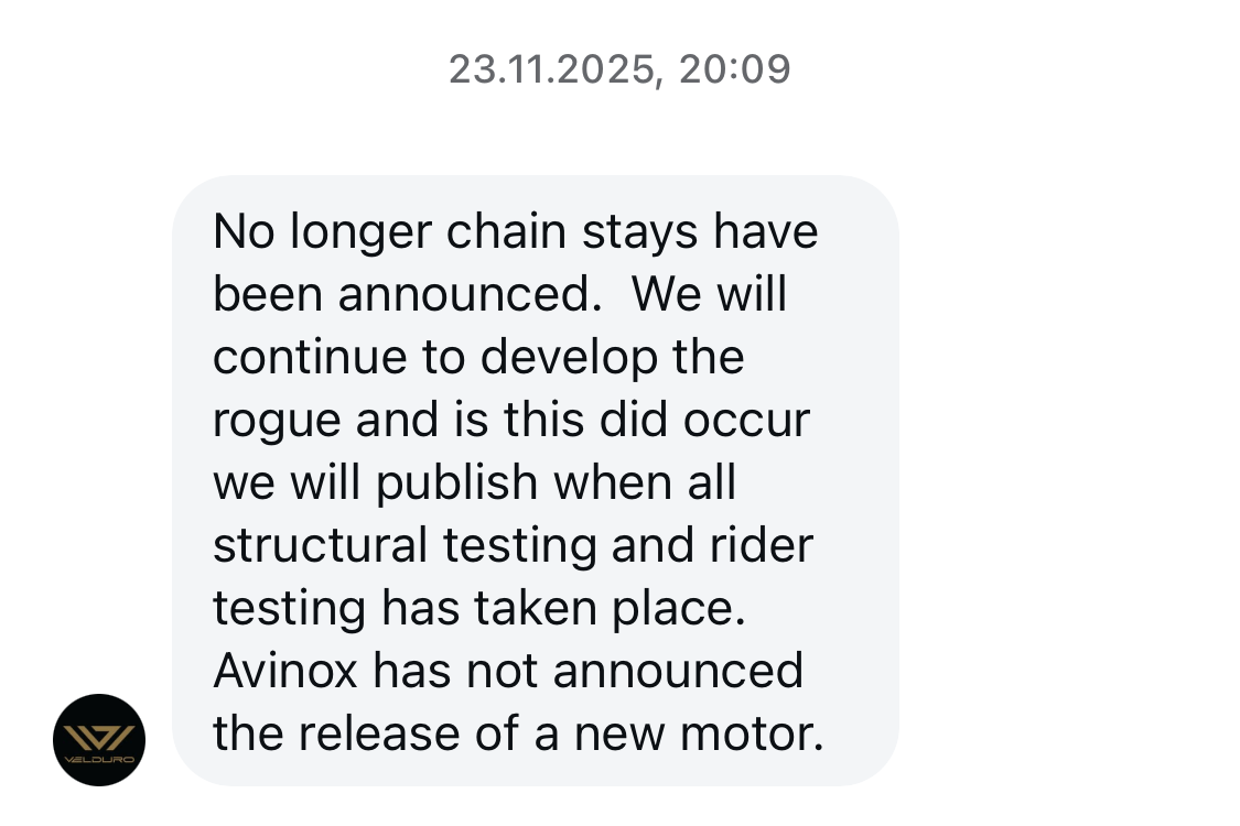

I'm pretty disappointed they didn't do a longer chainstay with the rogue, but in fairness, the bike as is will work really well in NZ, AZ, etc. I'll continue to ride my crafty with what looks like a 4"x4" fence post for a down tube until something better comes along (like an e-dreadnought...). This could have been it though, a pity.
