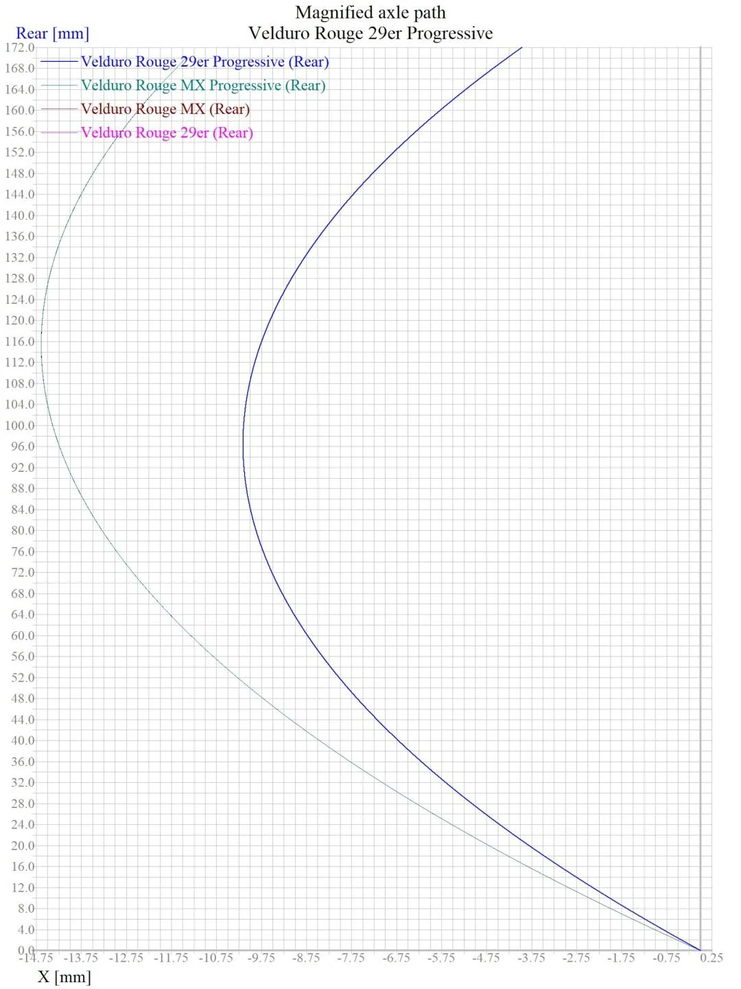

You can also find the detailed wheel axle travel path here (source: THE VELDURO ROGUE)
(yes, this was posted before but it's becoming an FAQ in this thread :)
that’s what confuses me. at 30% sag (51mm of travel) it should be less than 453mm according to this.
Velduro does seem to have some inconsistent geo numbers listed at times and we all have to be sleuths to figure it out and create geo charts that we can trust.
that’s what confuses me. at 30% sag (51mm of travel) it should be less than 453mm according to this chart?
The way I read the graph is that at 51mm travel chainstay *extension* is 7.7cm @29" or 9.7cm @27.5" (Mullet)
