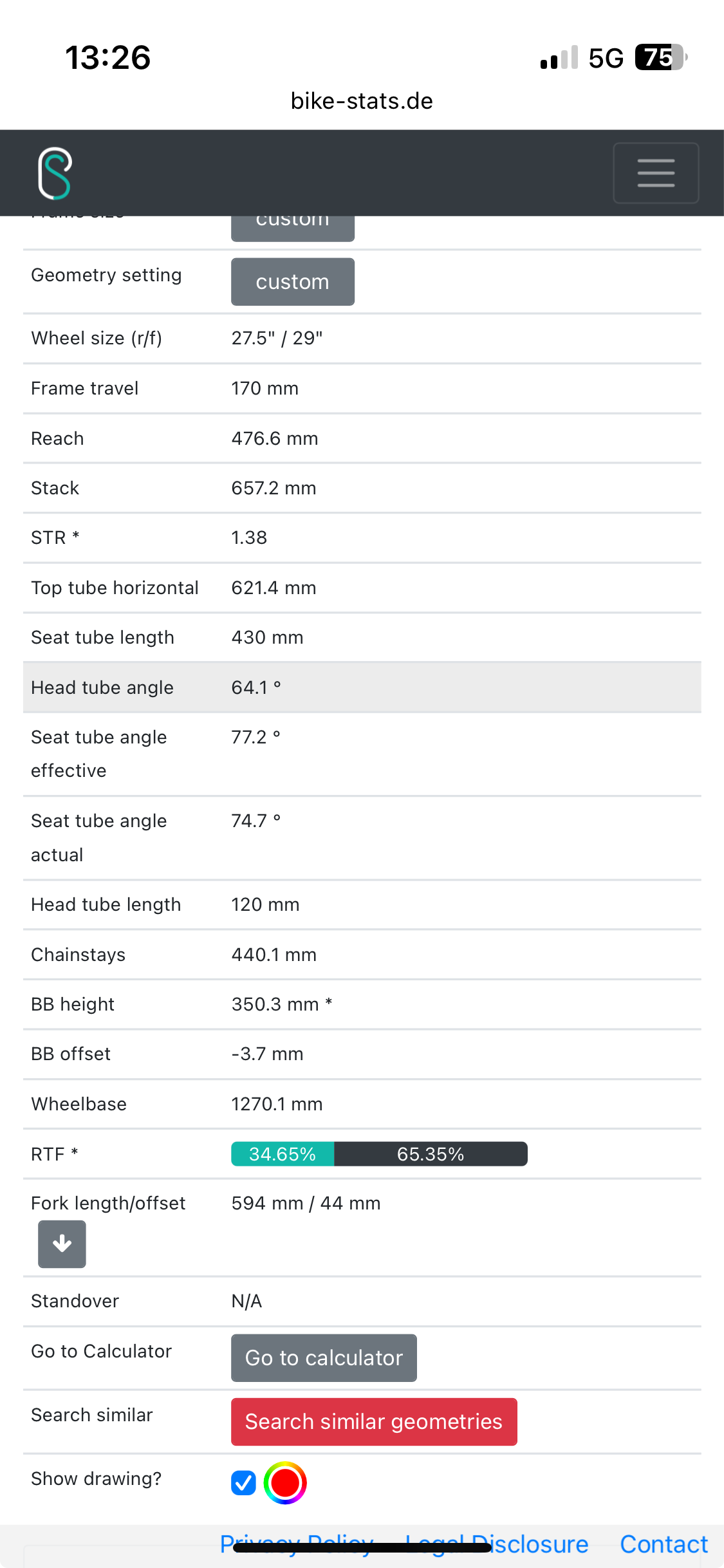

No the chainstays are the same across the board (440), but as you say, at sag they increase. Velduro told me they are looking at increasing L/XL CS’s at a later stage. I personally don’t see the CS as that bad, my bike at the moment has a 435 CS. The front/rear ratio is different though (as the rogue has a larger front centre), so this may change the balance on the trail. It’s so hard buying a bike without trying.
Should the RC:FC ratio be calculated at sag?

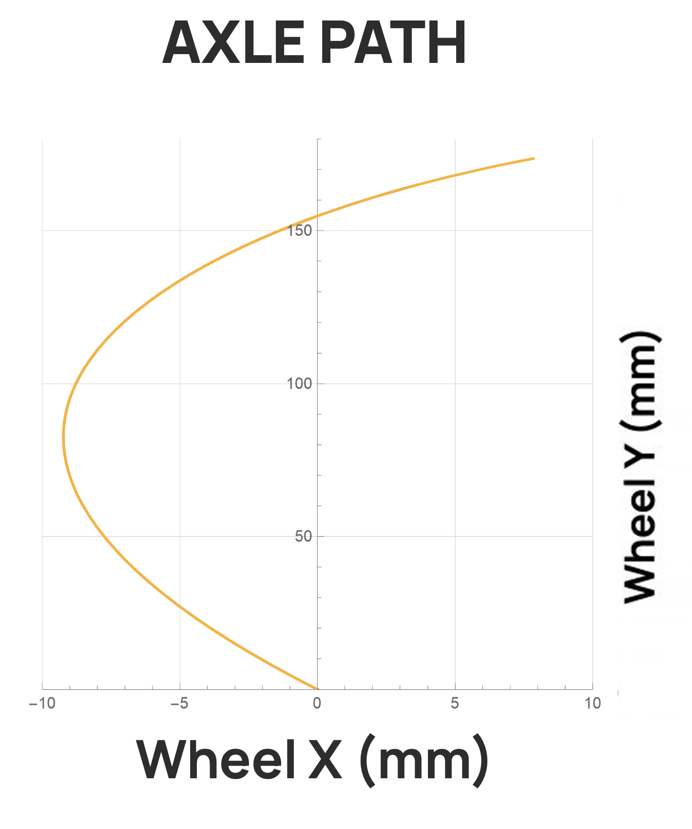

You can also find the detailed wheel axle travel path here (source: THE VELDURO ROGUE)

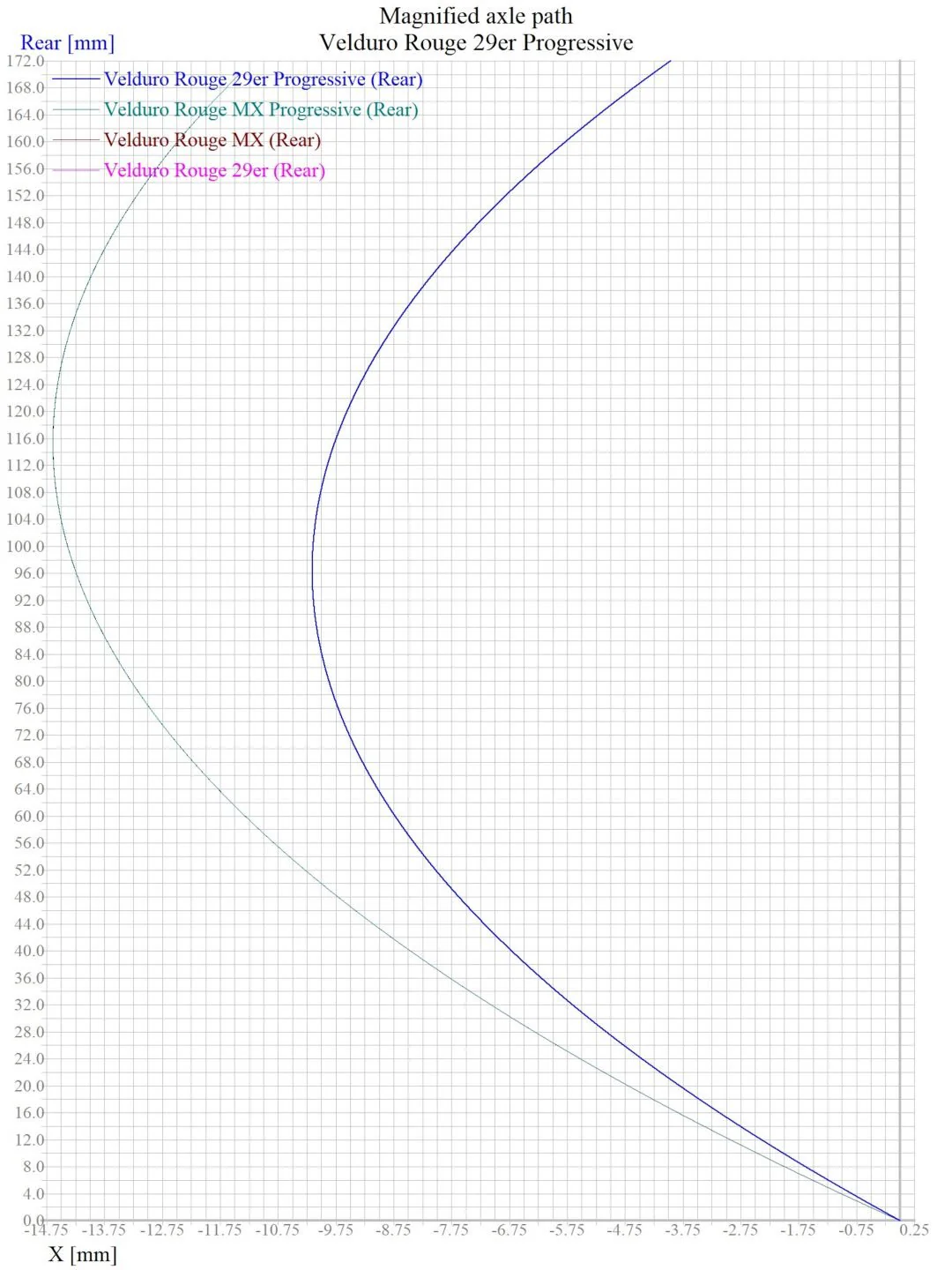

This graph seems to be missing the brown and pink line or am I just color blind?
Also what Rogue flip chip setting are most planning on riding most of the time? For me, without having a bike to test, I would most likely ride standard on the progressive chip and use a mullet set up.
Yes, they are missing because they are (I think) the same (pink=turquoise and purple=blue). The flip chip position at the base of the shock AFAICT does not change the geometry of the rear axle through its movement across the high point pivot, hence the perfect overlap.
i‘d say so, as it is way longer than a low pivot chainstay which usually only grows by a few mm before shortening again deeper in the travel
Should the RC:FC ratio be calculated at sag? - I've been thinking about this too. I'm not so sure it should be. When we ride, of course we moving the suspension a lot, and we will travel at sag and way beyond that on a ton of the ride.
But, we are still in many situations that we are unweighted / less than 30% sag when riding. Popping over roots, jumps, whatever.
When this happens and we are unsagged, our rear lever point (the rear wheel) is still part of the FC:RC ratio, and can touch down further forward than a longer CS, which in turn effects the balance of the bike and the way it behaves.
I see the sagged chainstay measurement as just another data point to guide us on bike geometry. My crestline (not a High Pivot) also has a rearward axle path, not as aggressive as the Velduro, but still has a decent amount of growth at sag point.
If we start measing FC:RC at sag point, then we must also consider the fork is also sagged, further changing the FC:RC ratio.
Finally, bike geo charts are also just a guide. Almost every single one Many are incorrect when the real bike is measured! They are based on CAD, which ideally would be perfect. The closest I've ever found is Nicolai. Their bikes are exactly as the data shows on their chart (well, I measured 2 so far and they are spot on).
...I think we should reason about RC:FC at both points instead of just one.
"At sag" measurement (or beyond - say ~50%) is imho important e.g. when cornering at speed. And the fact that the fork compresses shortens the FC even further while RC is extended... So completely different setup from bike with no sag at all (which is why maybe I often find myself unconsciously moving my CG a little bit backwards in these situations).

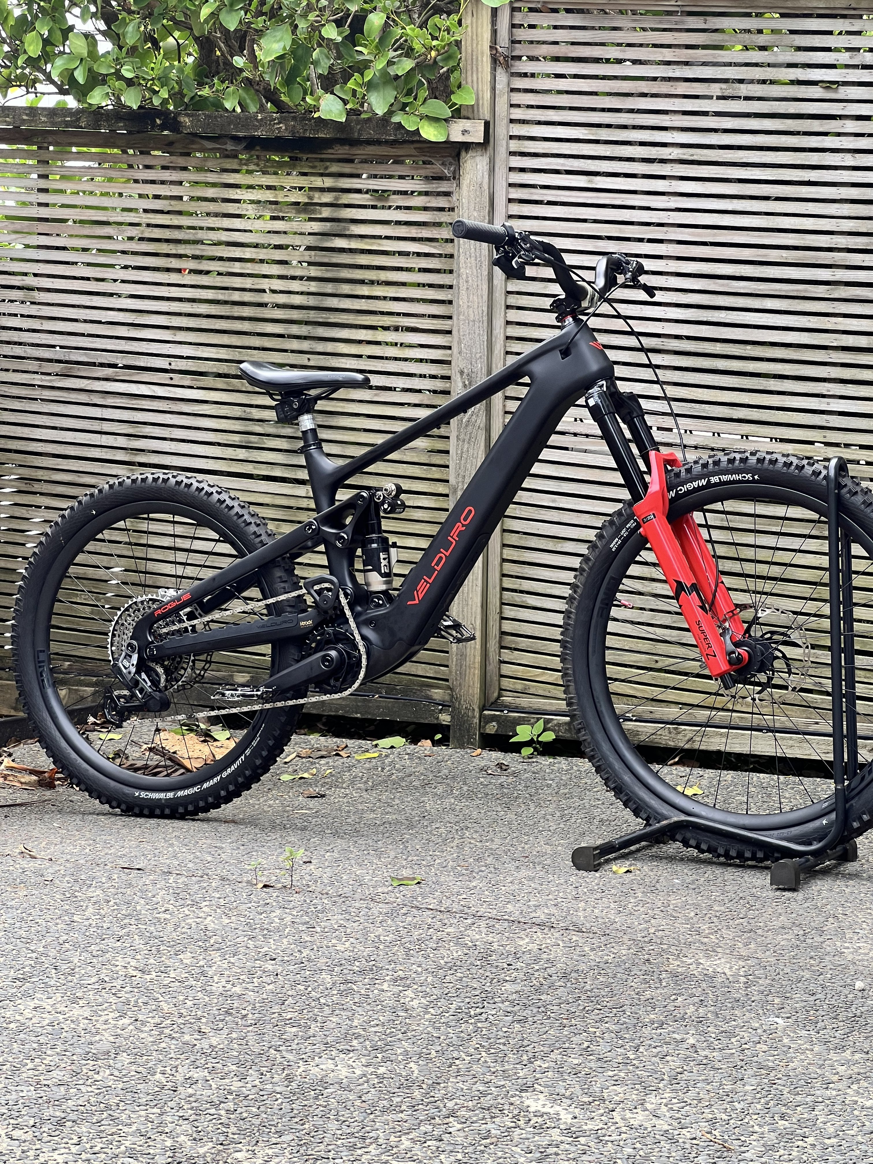

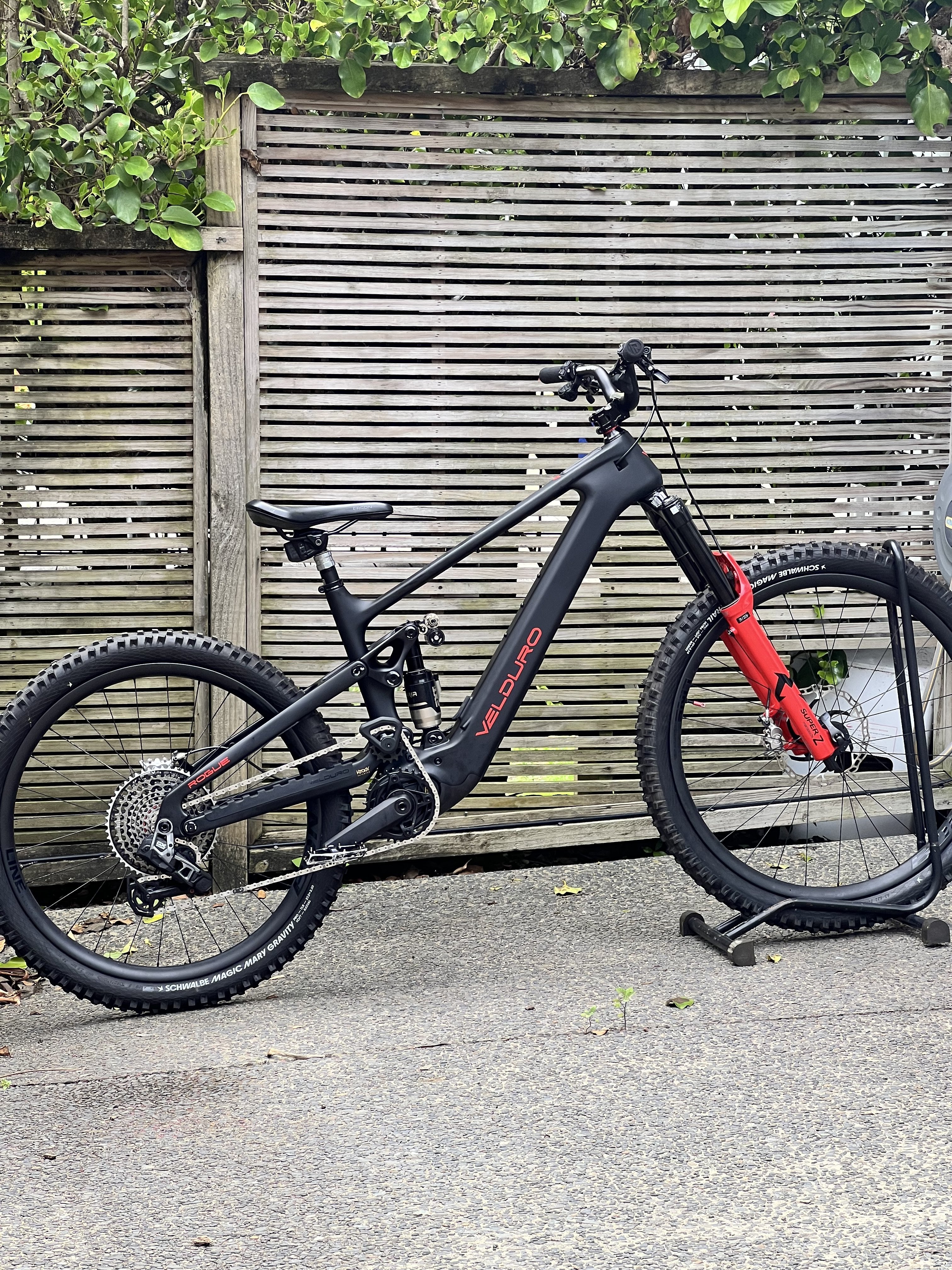

Custom built ‘Red Rogue’ just got it yesterday, Marzocci Super Z 38mm grip x damper, ext Aria, carbon wheels, axs etc. going to do first ride today, size large and I’m 190cm but have 75mm rise bars with short steerer, and also 50mm stem.
View attachment 172858 View attachment 172859
Nice build mate, built to rip.
As your around the same height as me and on a large, can you let me know how you find the handling when you get out on it. Especially the shorter CS in combination with the longer front centre.

Your flip chip is set to 29er but it looks like you have a 27.5 rear wheel?

Thanks :) Seems that Rob was right in his review, I did find the front wanted to wash out in some corners, I’ll mess with what I can to compensate, I like an upright riding position (hence the bars), and it felt nice and confident downhill, playful, jumped super well! However, with corners I was changing what was a normal riding position for me relative to what I’ve had in the past, the only corners I could rip were like carpeted or well packed, anything loose was sketchy and I was very consciously loading the front. Only short ride so will see what happens over time!

I checked the manual, flip chip for 27.5 is screw at the rear, though yeah you’re right the workshop must’ve flipped the sides around when assembling as it says it’s in 29er position on both sides.
