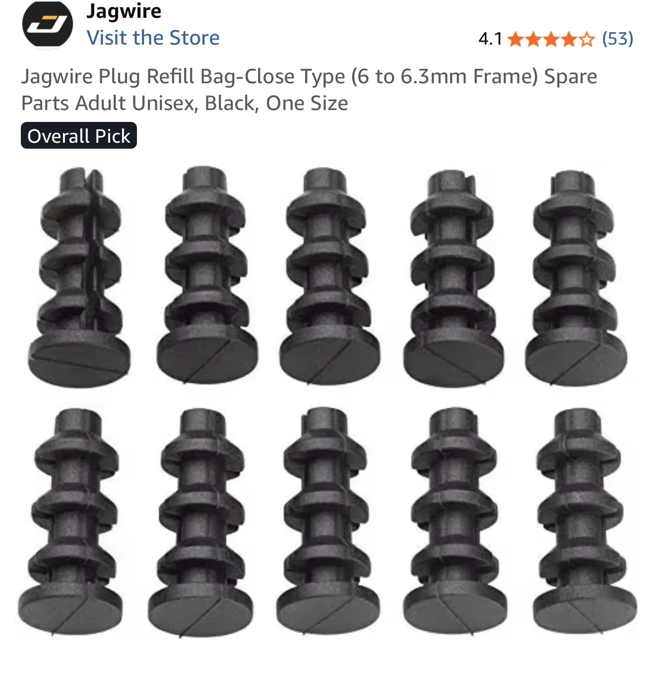

I’ve had to grease my headset a few times now. I’m starting to think dust is getting in from the cable holes on the downtube, I’m ordering plugs right now. 🤷‍♂️
What plugs?
i used those plugs that came with the frame, but there is still space around the cables, it needs proper plugs for those too.
and then the invisiframe on top?
Yes. The normal vinyl is quite thin and would easily get chipped off road.
The invisiframe should be much faster to apply, if it weren't for the fact I need to adapt the L kit to my M frame ;)
Thankfully it seems relatively straight forward everywhere except the steering tube area
