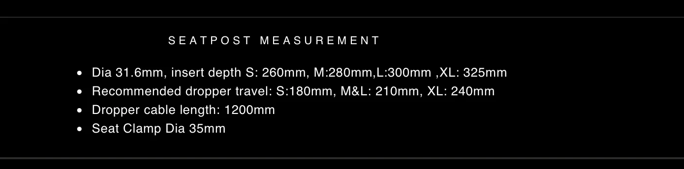

I will keep it simple......I want to know if they slam all the way down, or how much they stick up.
learning how to do it yourself > needing to ask stuff all the time
get your calculator and your measuring tape out and go to work...
Velduro lists max insertion at 280 mm for medium frame. Fox 210 transfer body is 260 mm + 28 mm for the actuator = 288 mm (not counting the housing and how it may interact inside the seat tube). So the top collar should stick up 8 mm from the seat clamp.
When your near edge cases its best to confirm independently or with someone whose done it... so I understand your question, especially if you don't have the frame. I'd like to have the frame in hand and use a traditional seat post or dropper to check insertion myself before dropping $$ on a new dropper.
Thanks. And yes, you describe my situation. I dont have my frame yet and wanted to order a dropper before it arrives. Cheers

Can anyone with a medium or small (preferred) Rogue measure the actual seat tube length (roughly the distance between the BB and seat tube collar) and provide it? Only the "effective" seat tube length is specified on the site and I need the detail to properly calculate max dropper travel.
The max post insertion is on the box, of the top of my head it is 304mm on a Large. I have a 240mm one up v3 and it is about 20mm out, the 210mm can be slammed, I can't say for the medium.
Wouldn’t it have been better for you to get a 210mm v3 dropper which you could then slam

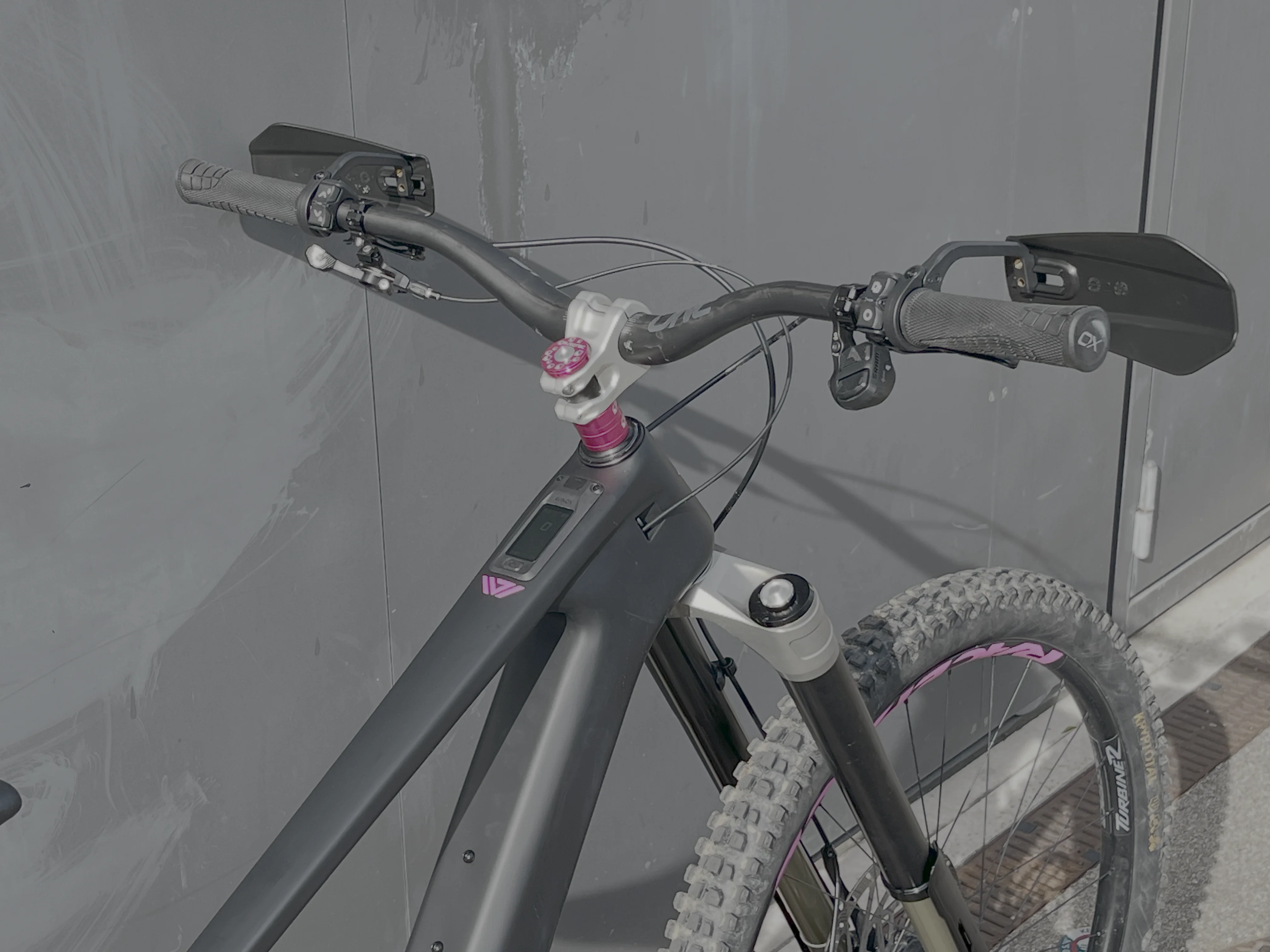

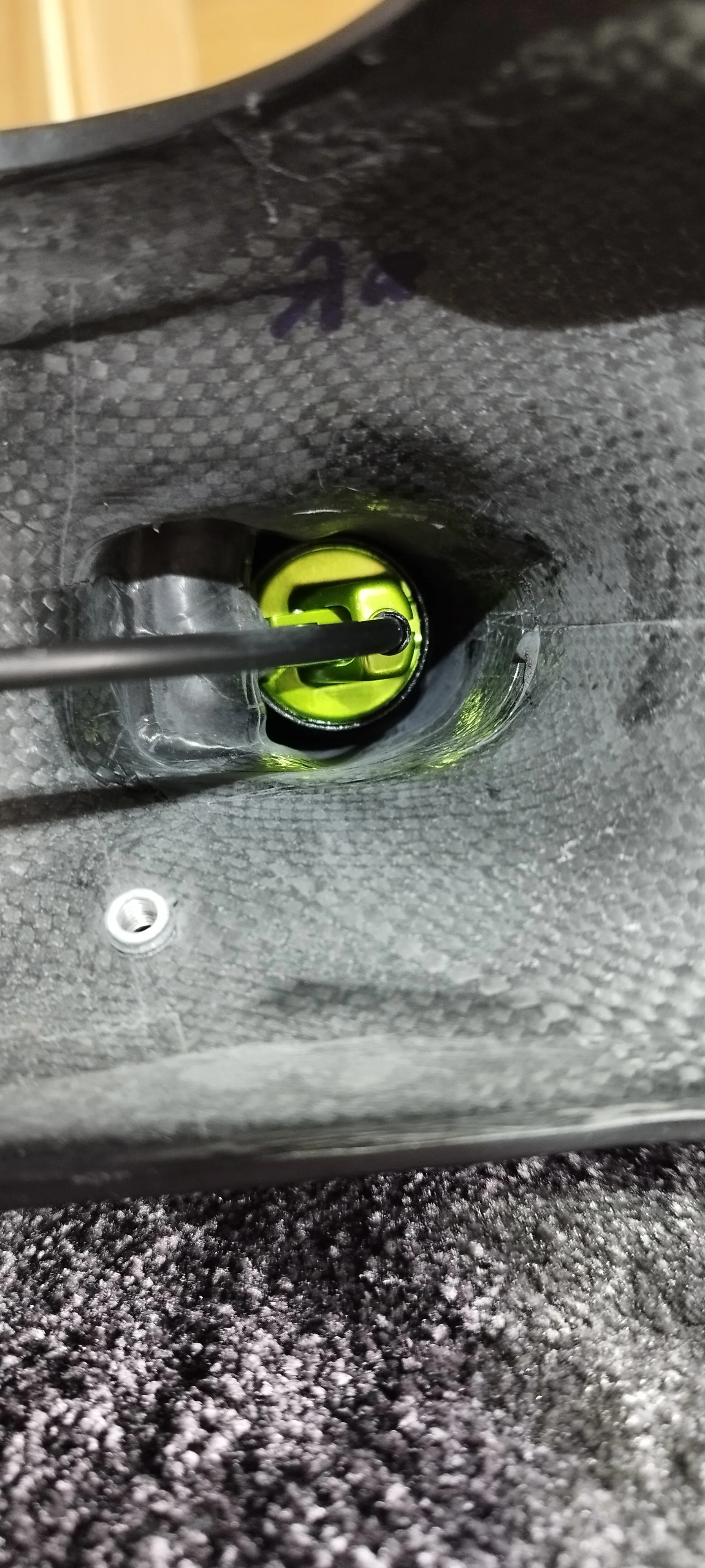

View attachment 185354I have rotated th Controller by 180°
how did you manage to do that? its threaded on.
think that through again
No need, my comment is still valid as you didn’t make it clear if it was sticking out the extra 20mm because you need a bigger dropper or if the max seat insertion depth of the frame is lower than the dropper…hence it was sticking out….
Personal preference aiming for best full hight position. To get the 210mm dropper at the right full height for me it was out the frame the extra 30mm so the low was higher to get the same top height.

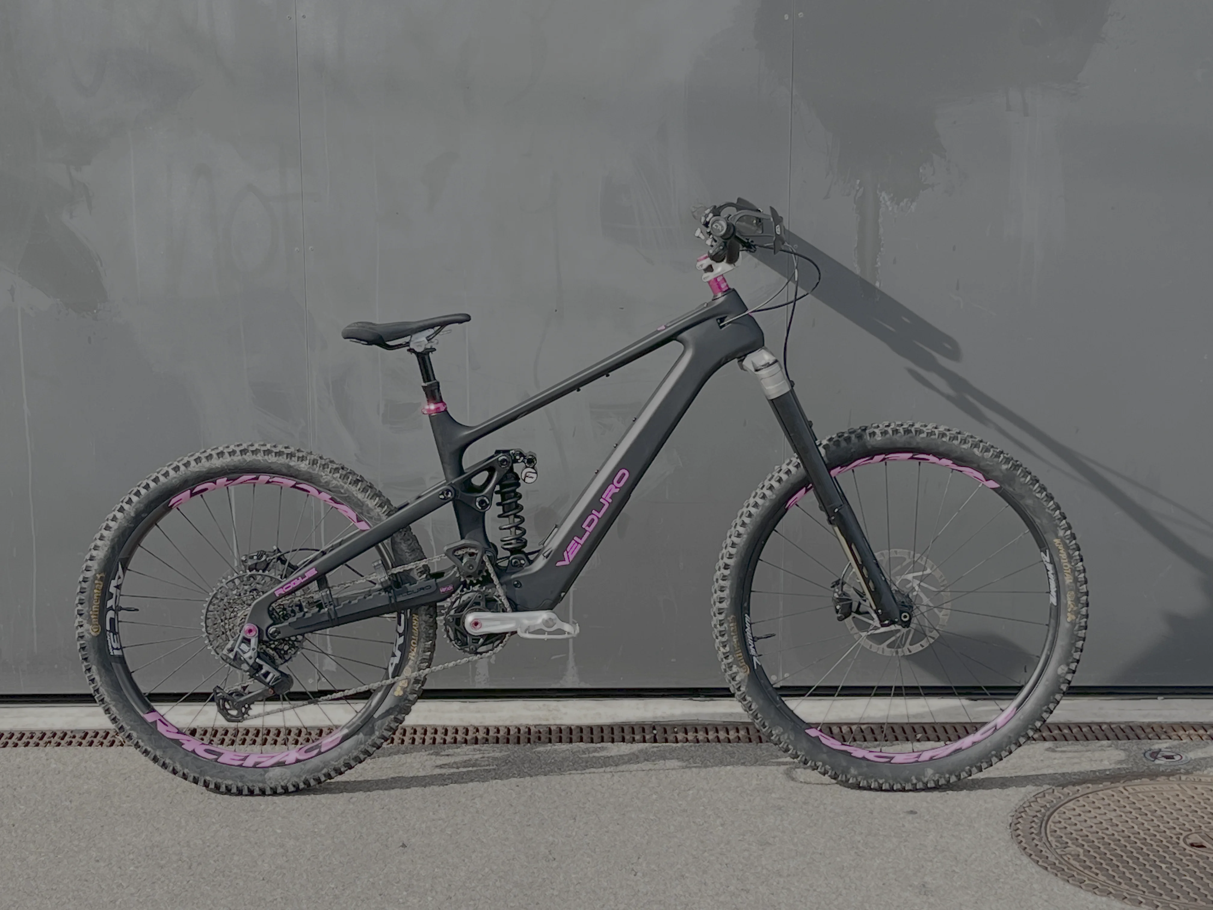

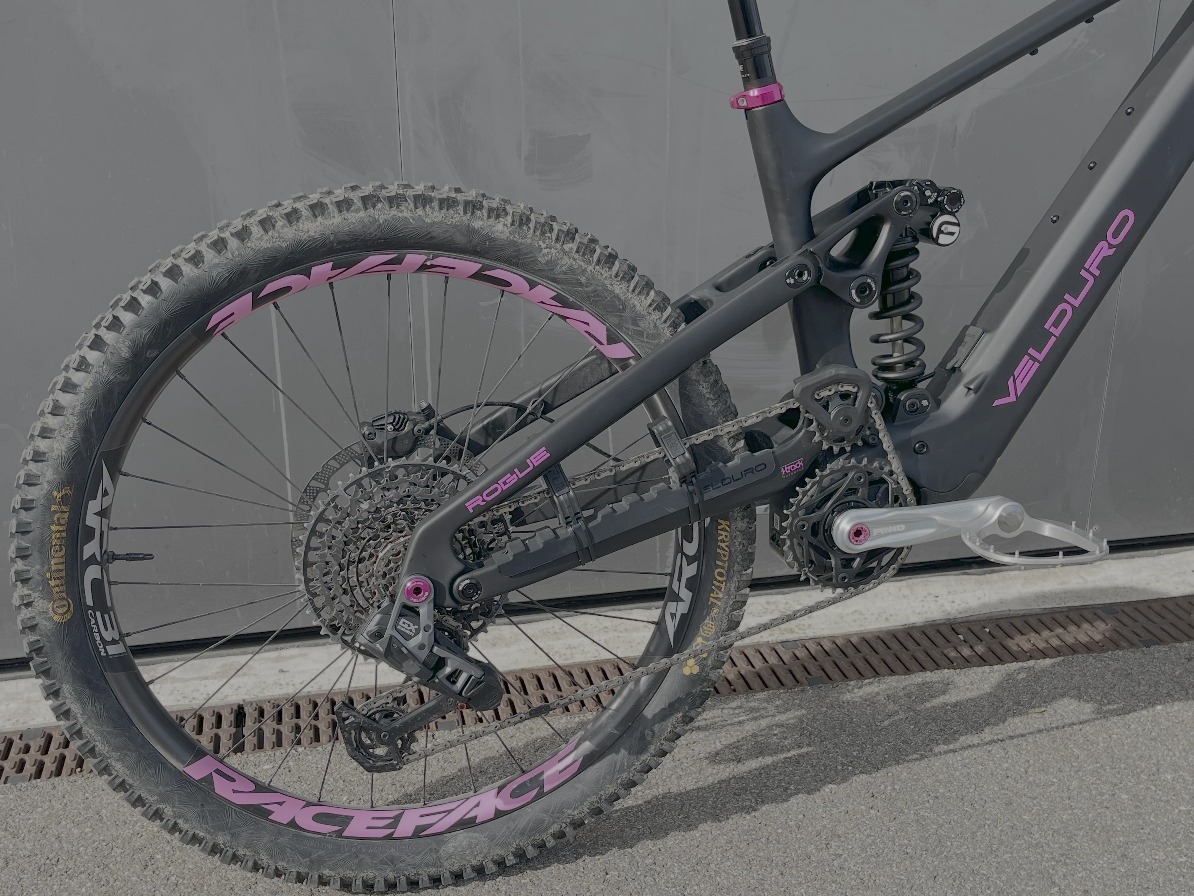

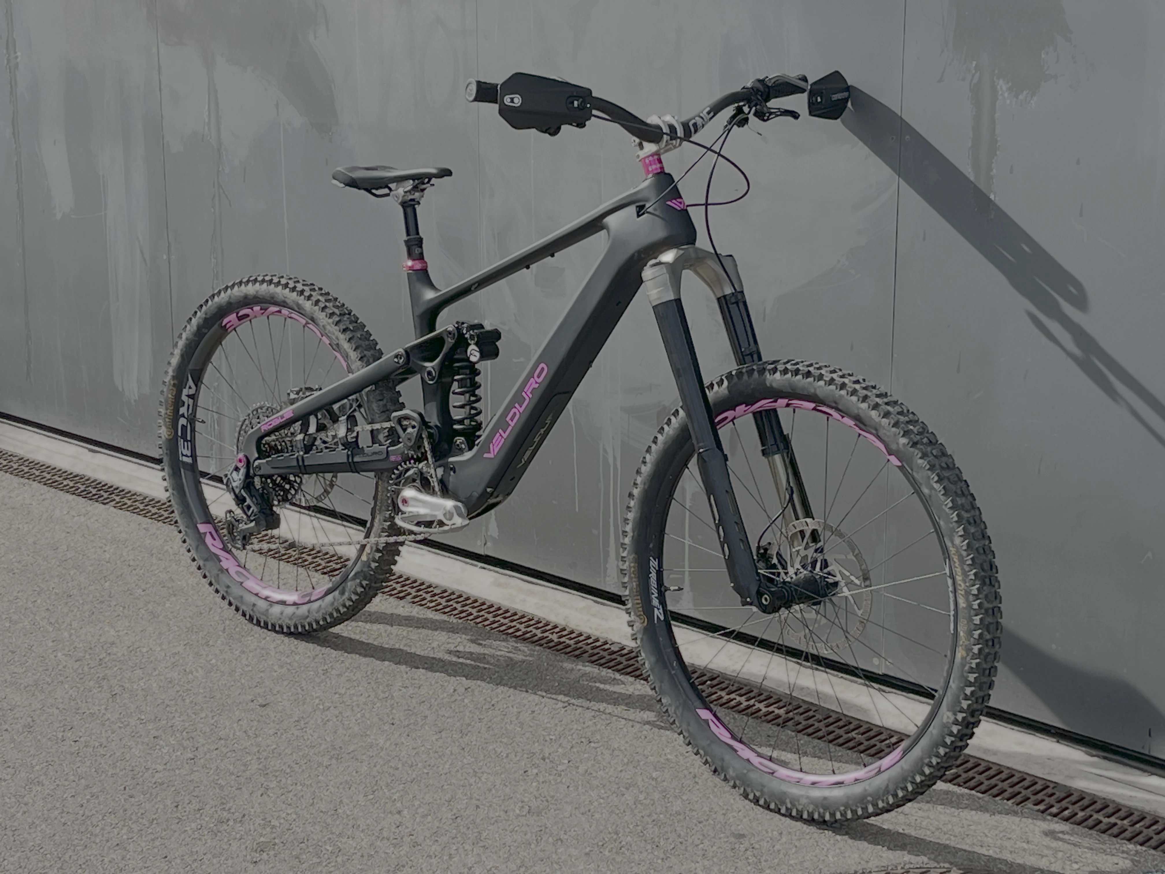

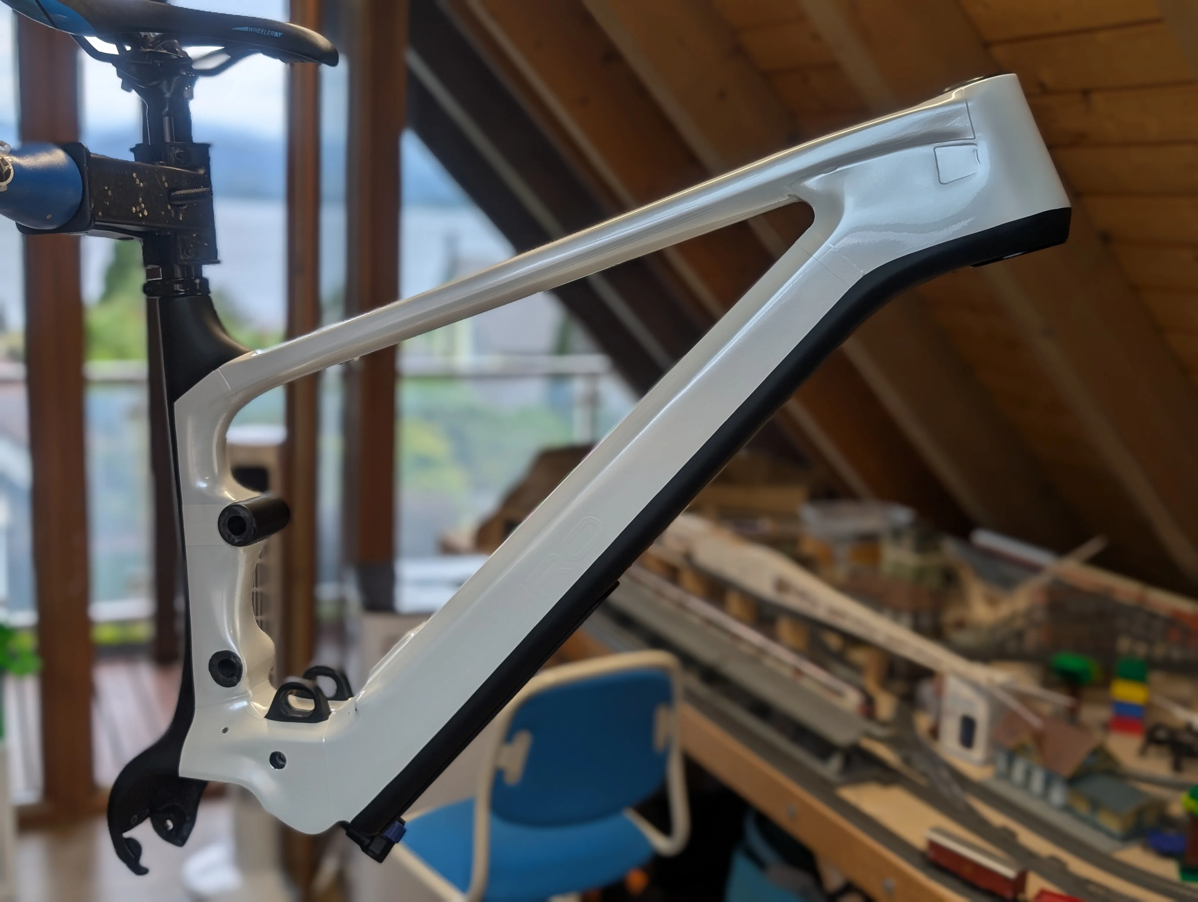

Finished. Took me much longer than I originally estimated (~8 hours) but being the first vinyl wrapping job I made a ton of mistakes at the beginning and had to restart a few times.
Quite pleased with the result, all things considered.
Now I need to cut the new decals, re-assemble the whole thing and go ride :)
