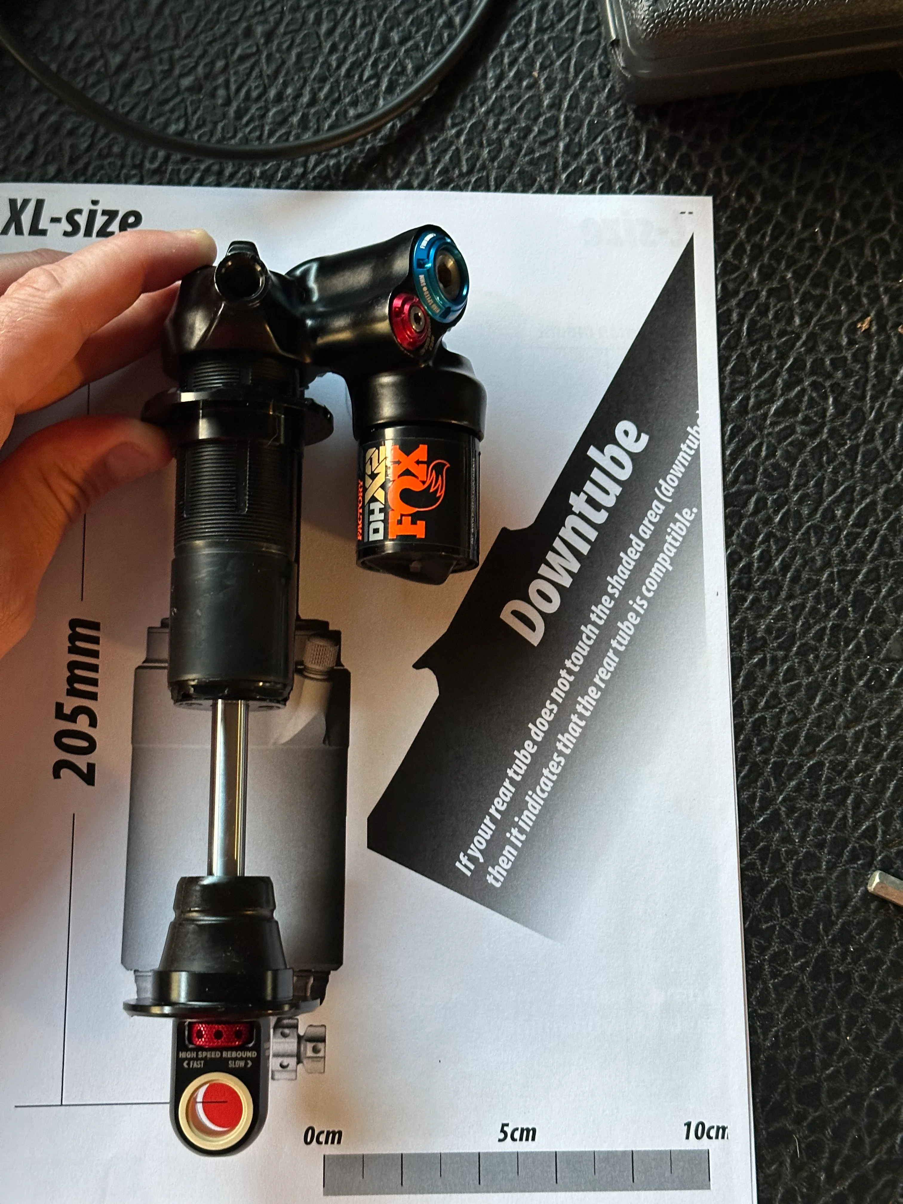

Size Large, Storia V4 205x65mm full Compression. PRO Flip Chip positon

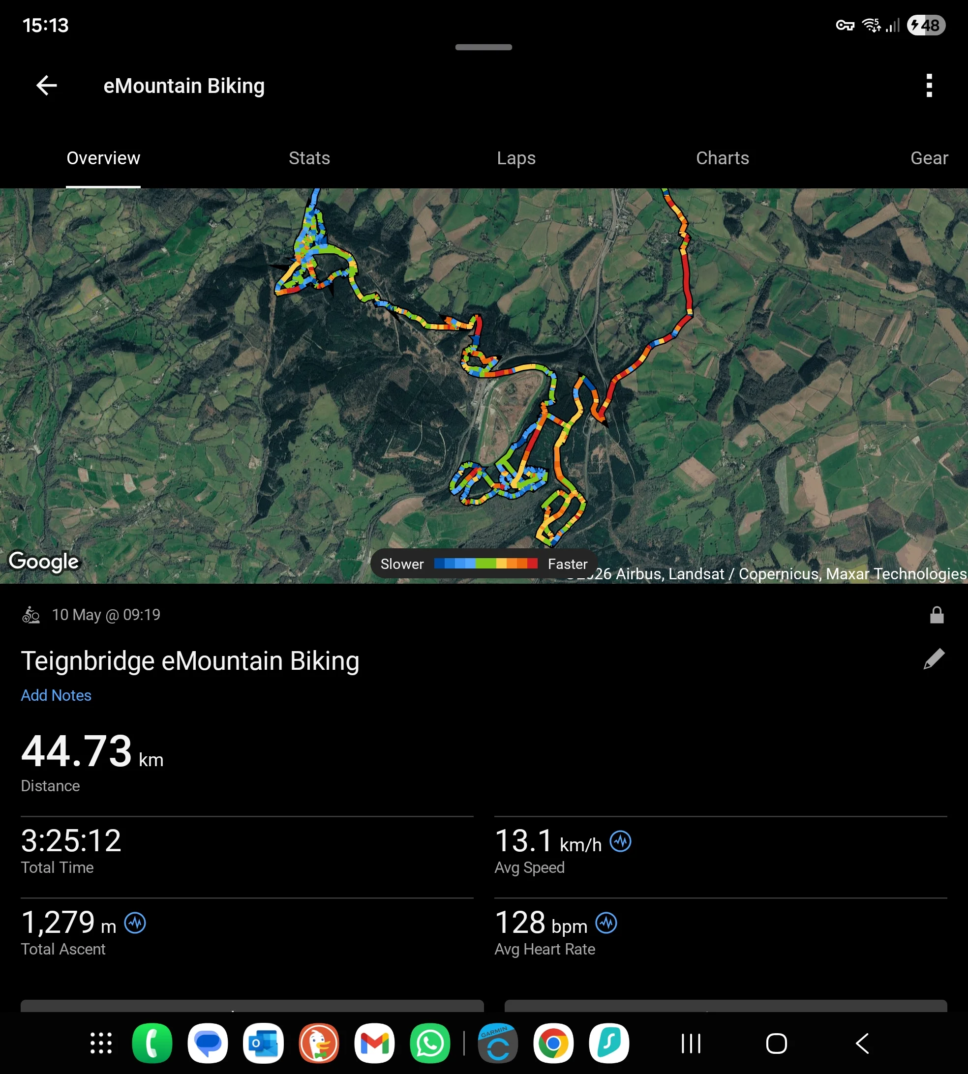

How much battery did this ride use?
I think this is all irrelevant as there are so many factors. I can chew mine in 1150m and 25km or I can get 50km and 2000m. Its all to do with how many times I punch the munter button (boost) and what mode. My auto is tuned to 85nm and 600w with hill start assist (hill start assist makes it more Bosch like low down). If I leave it purely in that its 35km to 40km and 1500m to 1600m on average. Riding temps of 15 to 23 degrees. If its 1200m or 2000m of elevation every meter is better on this bike than any bike I've ridden. Its one hot dog of a rig.
Its not irrelveant at all. I'm asking a simple question and the fact his data also has average speed and HR I'm interested to know how much battery that ride consumed.
What I meant or intended to say is you need to ask, tires, weather, relative effort, surface type and how many boost moments there were and what time you have that set for etc. You can have a relative effort but still hit boost and it can skew everything. Asking a single question like that has little ability to determine anything with accuracy (if thats what you want) Averages are much better or more relevant was the point I was trying to make or help you with in regards to your consideration for this drive system. The bike rocks and there is tons of data on the motor. Nealry every MTB journo will agree with the relevance of the range question. Hope this helps you.
So I had 4% left at the end of the ride.
I rode in auto for 75% of the time the rest was eco,no trail,no turbo,no boost.
Im gradually lowering the assit auto gives me on every ride to find the sweet spot for me & how I ride,I also raised the assist on eco by one increment.
Temperature was about 14°c.
I like to ride fairly aggressively,& i ride mostly with a mate on a Santa Cruz Vala (gen 5 bosch)
When i do a solo ride I'll slam it in trail & go for it,so the battery will obviously be less efficient.
But thats the reason I wanted an Avinox system on my next bike so I have that wide range of choice on how I ride & how far i can go,don't get that as much with any of the other systems,its a very versatile unit.

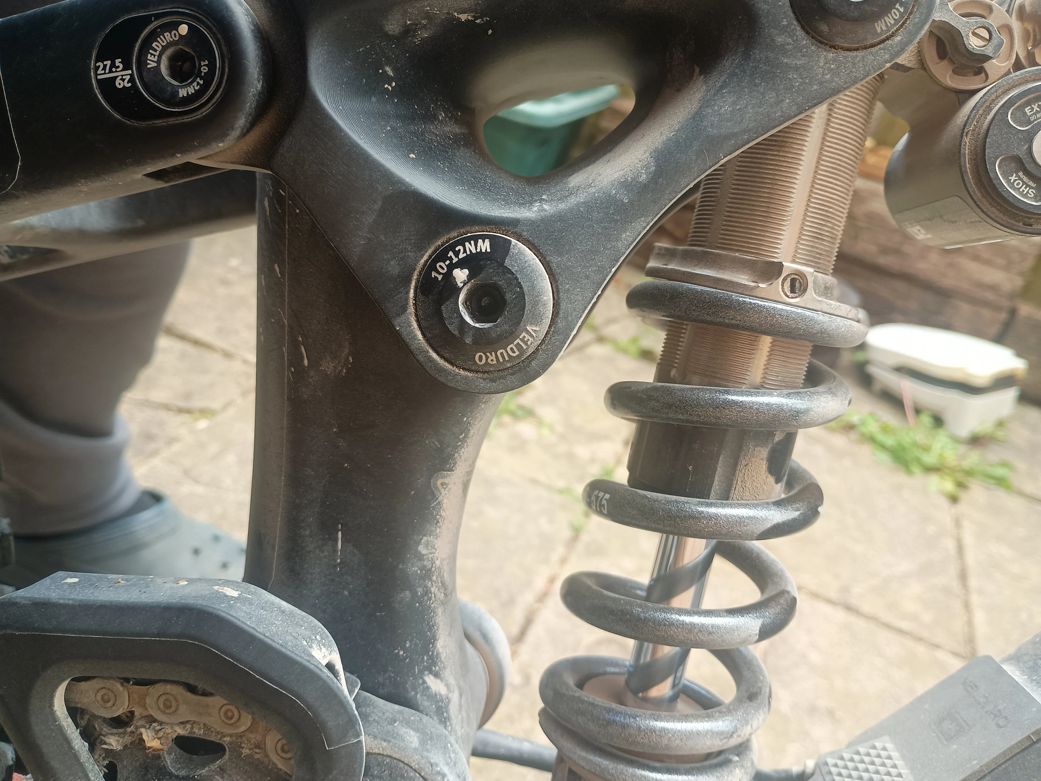

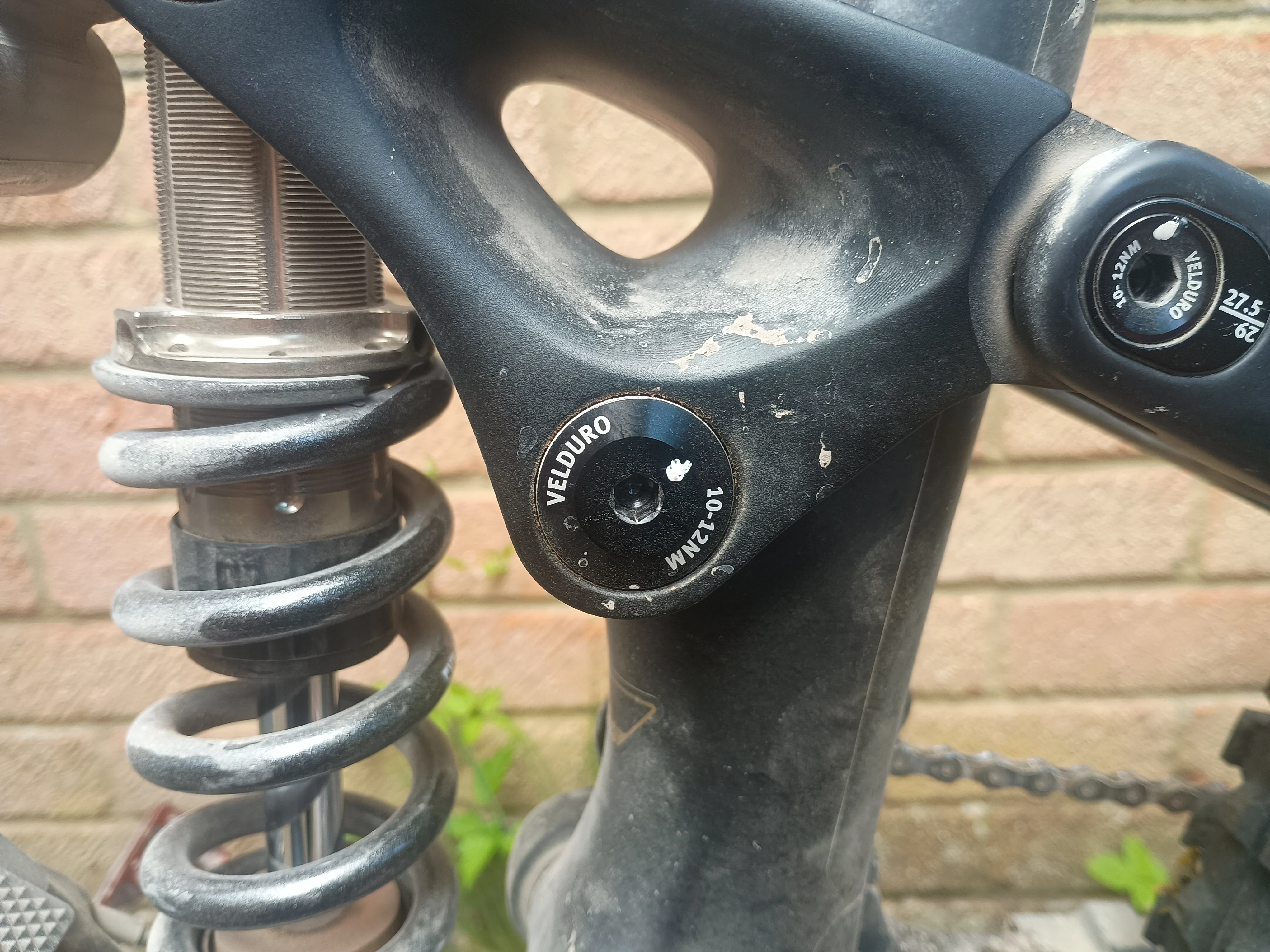

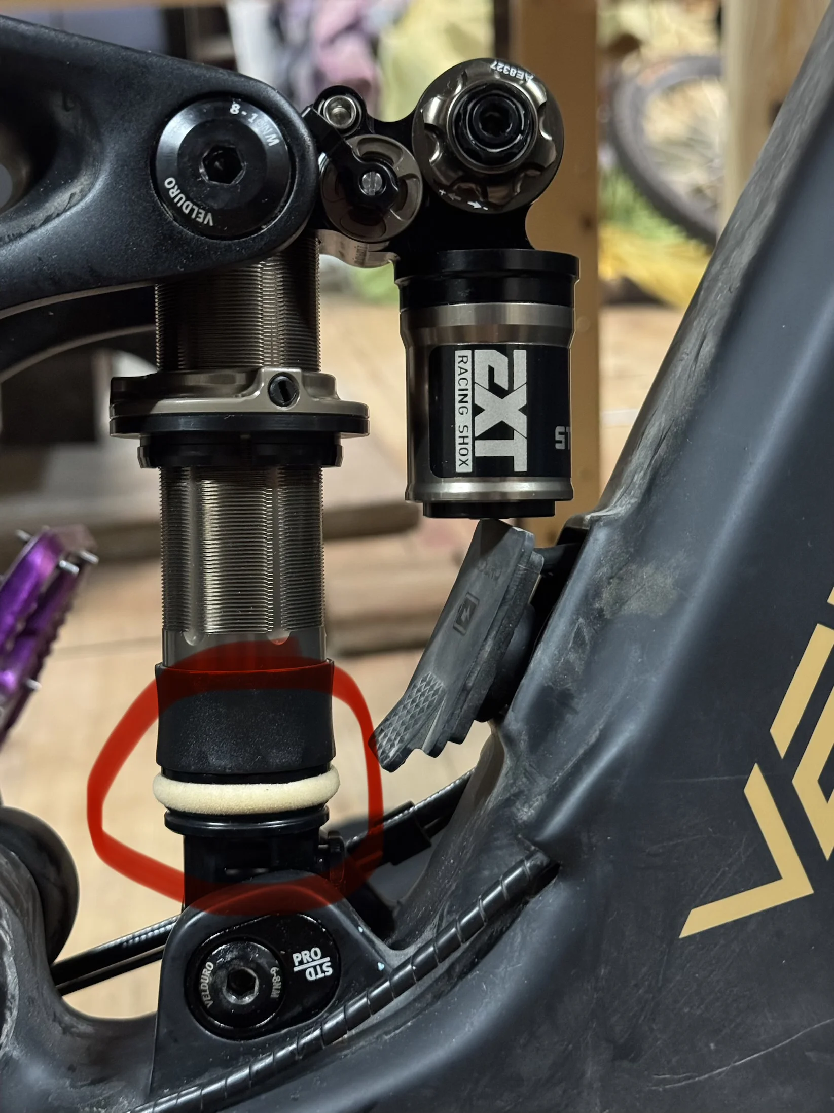

Ive only just noticed..
Why is one side of the rocker bolts 6mm and the other side 8mm 🤔
Edit haha ignore me. I thought it was 2 separate bolts but in fact its a single bolt.
I had wondered why my paint marks had moved from 12 o'clock but the whole bolt must have turned.

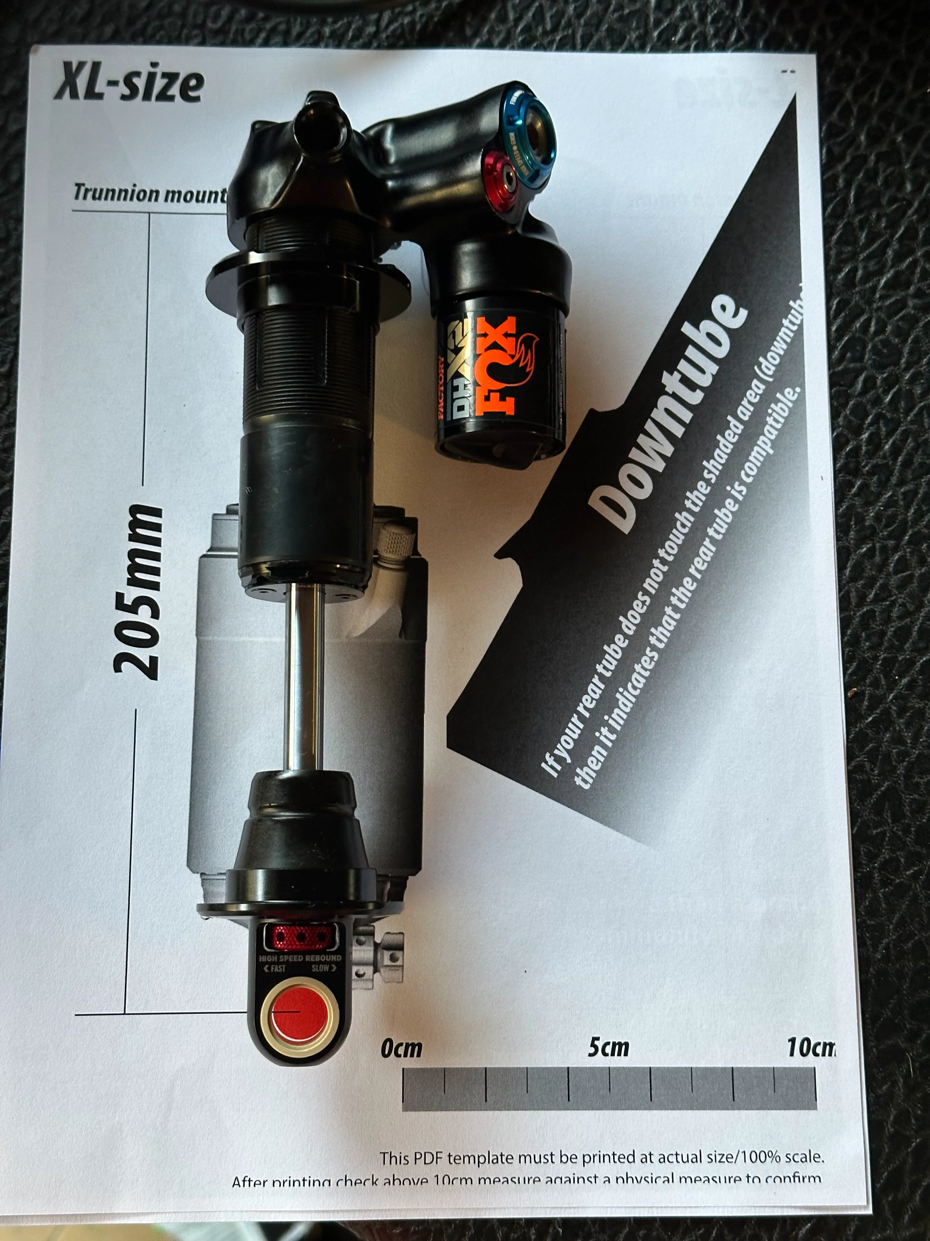

@rabitec (for some reason the forum wont let me reply directly to your question)
The Fox X2 custom tune is:
CL40, RL50, LMM, Rezi B40, Bleed 0.7, VVCM
Its a slightly lighter but linear tune, so more suited to a progressive linkage design.
The Rezi tune and bleed valve have also been adjusted to work better with the lighter tune.

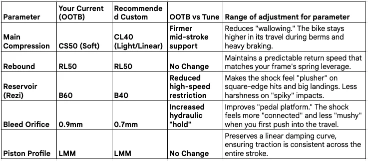

@TheBikeStudio thanks for this, super useful and something I wished @Velduro Global HQ @Velduro UK published on their websites (they didn't mention it to me when I reached out to them in October looking for shock recommendations).
by comparison, my off the shelf Fox X2 (bought directly from Fox) has the following tuning:
CS50, RL50, LMM, Rezi B60, Bleed 0.9, VVCM
It's actually very similar to the custom tune and what I think is the most important part (LMM) for the rogue is already there.
do you happen to know what was the original tuning of the shock before you sent it to be revalved? You said you noticed a big difference - in which department?
According to Gemini, the delta between your custom tune and my (factory?) one is the following and seems to be more related to the support (main compression + Rezi) and HI Speed (something I can tune with the outer dials I think).
I don't see big differences in linearity

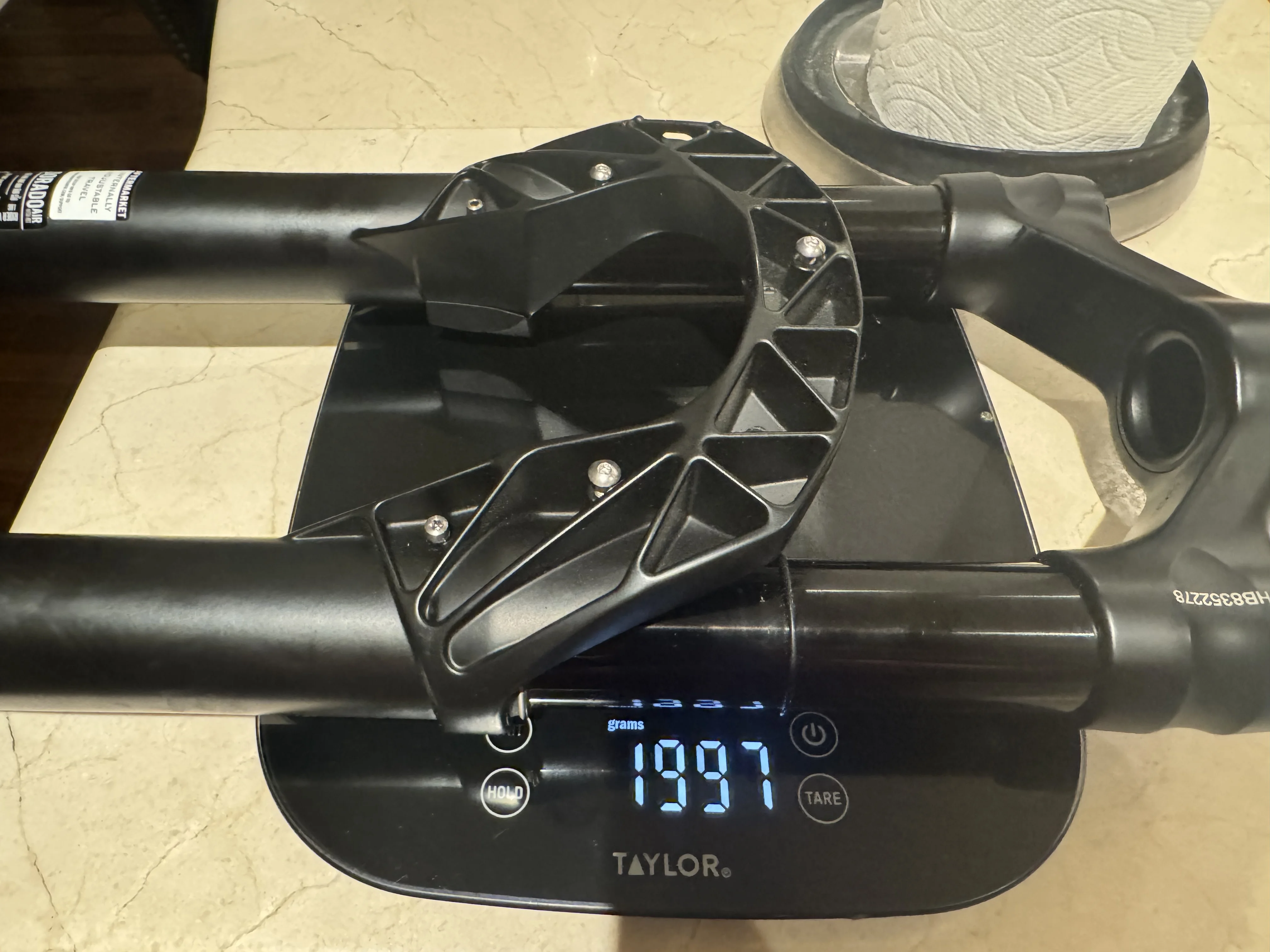

For starters and for those who aren't familiar with Manitou, checkout the weight of this enduro 180mm fork, which will be even lighter than this when I remove 40mm worth of spacers:
That saves over a pound right there.
The Mezzer is a really solid offering that performs very well at an incredible weight.
Somewhere around 2-3 years ago a German mag did some lab measurements and found the Mezzer to be more rigid than both the F36 & the Lyric, by substantial margins as I recall.
The catch is that the negative air volume is fixed and apparently the ratio between negative and positive gets pretty far from ideal in the 180mm travel position as the negative volume was made to be ideal around 160-170mm travel.
I run a Mezzer Avy (Avalanche Downhill Racing) Hybrid and it's been on 2 bikes so far. Basically it operates half on a coil spring and half on the existing air spring that is ran at about 1/3 pressure. This reduces air seal friction and gives a very coil like feel initially while retaining the ability to adjust bottom out resistance using the air side. Also, it's useful to be able to adjust sag/ ride height without having to alter the actual spring rate by adding/ subtracting air. It also uses an open bath damper, great for performance and lubricity, not so great for weight as the fork now weighs 2400 grams. Really this modified fork wasn't as good as a stock fork when first received; the nature of custom suspension is that it can be very good, but if it's off, it's pretty far out. But with some revalving and a change in spring rate, it's now a solid 9 out of 10 and I just had it apart today trying to get it even closer.
Anyways, the stock Mezzer is highly recommended if you want a great fork, at a great weight, at a crazy good price too. You can buy any travel Mezzer and swap the travel at no cost anywhere from 150-180mm FYI. They don't make thay clear online.
Apparently an upgraded one is on the way, but the only real place I could see to make an improvement is to have the front axle clamps added, similar to the newest Fox forks, as this is quite helpful in dealing with small variances in hub width and therefore removing a common source of binding. They are also very tight forks and respond well to burnishing.
The problem with Manitou/Hayes products is the poor quality control. Some items are great and others really bad out of the box, so they often require a lot of work to get functioning well, e.g. the Mezzer often needs bushings burnishing, paint removing from the dropouts, seals changing, etc. Same with Dominion brakes and other Hayes products.
