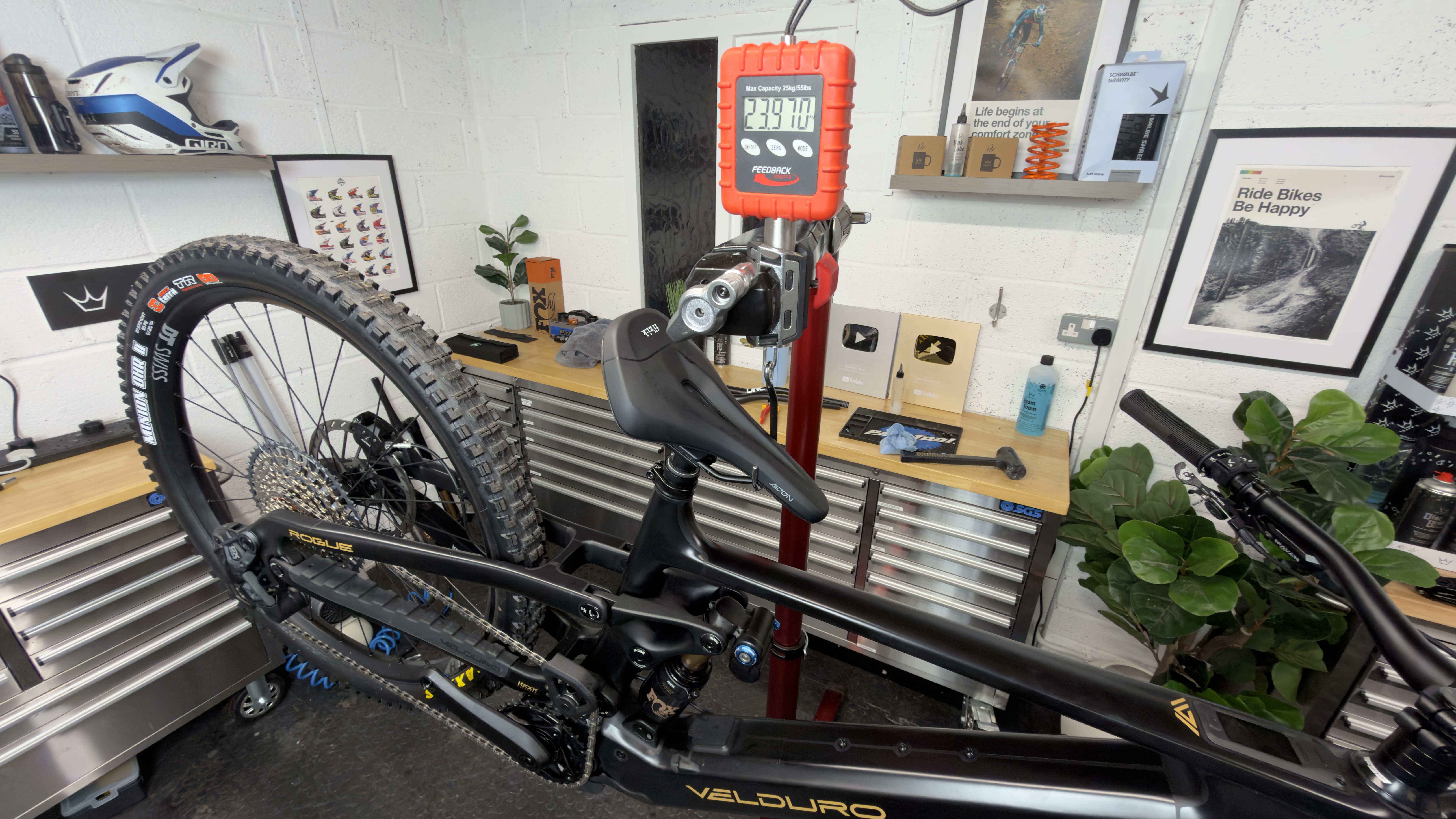

Watch robs latest video on the Nicolai bike.... He weighs the fox 40 and a podium and it's only 50g heavier...,.
look at what rob just build with his nicolai, but that one has 180mm in the rear. i‘d rather go with the intend, weight is less and the travel more balanced with the rear
190mm rear, but close enough! The INtend looks real nice. I looked at that too, but was limited by headtube length (Nicolai has 140mm). The Velduro has a much shorter headtube.
