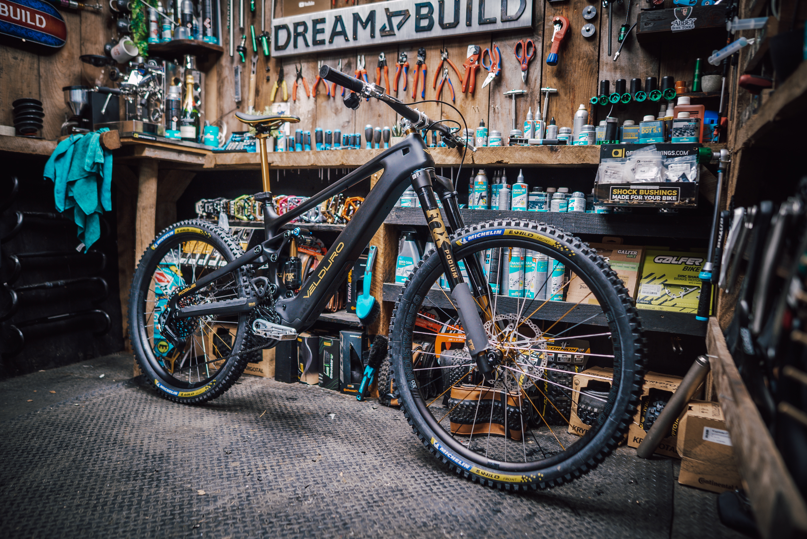

Hi everyone,
We’re incredibly excited to share our first ever Velduro Rogue Dream Build, with the one and only Gee Milner.
A few weeks ago, Gee reached out, he wanted to be the first in the UK to showcase the Rogue at its absolute best.
So we said yes, and we didn’t hold back.
This is the ultimate UK Rogue build, with a splash of British HopeTech machining to help fly the flag 🇬🇧
Build list:
Motor System: DJI Avinox, 120Nm torque, 1000W peak power, 800Wh battery
Fork: FOX Podium Factory, 170mm
Shock: FOX X2, 165mm rear travel
Dropper: FOX Transfer Neo Factory, 200mm
Wheelset: Industry Nine Mixed Custom Alloy, Hydra 2 hub, GR300 rim, anodised alloy spokes
Tyres: Michelin E-Wild
Valves: Peaty’s Copper Valves
Grips: RaceFace
Derailleur: SRAM XO T-Type
Cassette: SRAM XO 12-speed
Chain: SRAM XO
OSPW: CeramicSpeed X-Alpha
Saddle: SDG Bel Air V3 Lux Alloy Black/Gold
Seatpost Angle Adjust: Aenomaly SwitchGrade 2.0 EVO
Brakes: HopeTech Evo GR4, 220mm front / 200mm rear
Bars: HopeTech Carbon, 35mm clamp, 780mm width
Stem: HopeTech TR, 40mm
Headset: HopeTech 44mm top / 56mm bottom
Crankset: HopeTech e-Bike Cranks, 155mm
Hope you enjoy!
Velduro UK ✌️

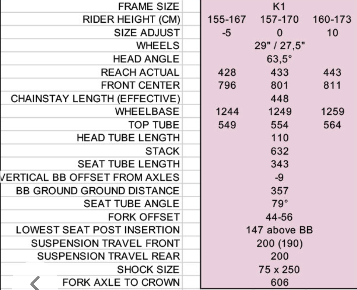

I'm 167cm and I ordered the small awhile back. I'm coming from a K1 Pole Sonni with mixed wheels and really like the geometry for my person (markedly more so than the K1 Voima which I had earlier). In comparison, the Rogue Small is longer in reach but shorter in wheelbase, same stack, and probably similar in rear center at sag. But the Medium Rogue is even longer in WB and with even a more stretched out reach. A medium would have had me more stretched out. And Pole EMTBs are known to have long wheelbases to begin with, and so I'm already used to longer WBs, but the medium is pushing beyond even that for me with my K1. I feel the 450 rear-center is just right for the hi-pivot small, but a 445 would better suit a medium if it was available.

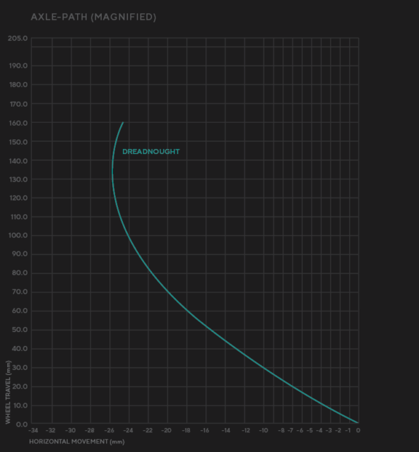

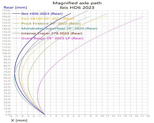

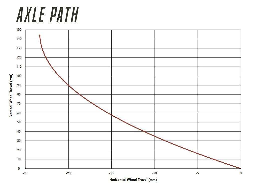

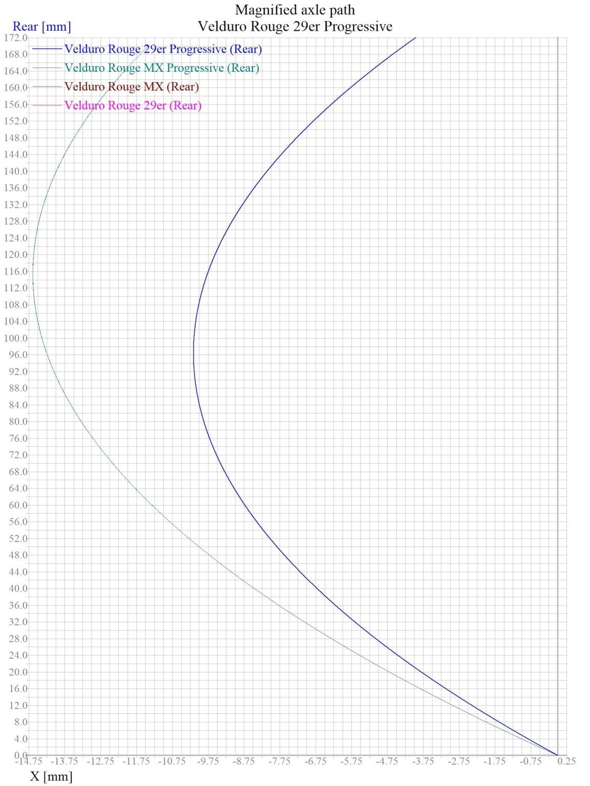

Back at you. Other Enduro long-travel high pivots:
Also, would be nice to see Rogue's non-progressive setting axle path graphs.
back at me what? you claimed something untrue, i showed you the correct graph…
re: progressive axle path: should be the same, the shock gets driven differently through the shock link as the bottom of the shock mount is at a different position, but it doesn’t change the position of the chainstay/seatstay pivots, unlike when you put the flipchip on the other position when switching to a mullet setup, which results in a different axle path
Dude, read the room before you call BS, and not just with my post. Clearly, I was saying that Rogue WB growth is not as pronounced as with other HP bikes comparatively; not in absolute terms - it's got an idler after all. At sag the Rogue 29 is like only 2.5mm more than a Mondraker Superfoxy at sag, and that's not even an HP bike. And the Rogue at twice sag is still under a centimeter.
This tells me this bike will be more forgiving for those transitioning from non-HP rigs, and may not be as critical to factor into sizing choices, which is what the thrust of my reply was about to mart-e. But hey, this is just speculation on my part and if I recall, you did test ride a Rogue, so you are in a better position to assess this anecdotally. Did you find the Rogue approachable ride-wise compared to other HPs you've tested? Did you clearly feel WB lengthening when compressing into hard turns where you had to compensate COG or steerage when exiting? If you had a dial with max setting at monster HP at one end and min setting at subtle zero growth Horst Link rigs, where would you set the dial based on your ride?
Regarding non-progressive axle path, agree with you for this bike. Most likely those curves completely overlap the progressive ones, hence only 2 curves can be seen.

Agreed. At sag, the rear-center is closer to 450mm if you are going with MX and that's going to work with the more longish WB of the bike. The forward IC of the Horst Link will keep things more conventional under smaller undulations. Then the HP aspects starts to break out as it goes deeper stroke.
What interesting though, is 5mm path difference between MX and 29, which means the MX will have a more HP personality when the dynamics kick in. When more reviews start coming with the bike, folks should take heed of the bike's configuration on test, or preferrably, if both were tested. I think this bike is too interesting not to test both, which is my eventual intention.
The MX would be how l were to roll, l am interested to what your findings say to MX the closer wheel path in having positioned in effect towards a HP in personality.... l could find this appealing and for what its worth in saying it be great to demo a few options and sizes....Thanks slickrock.....
