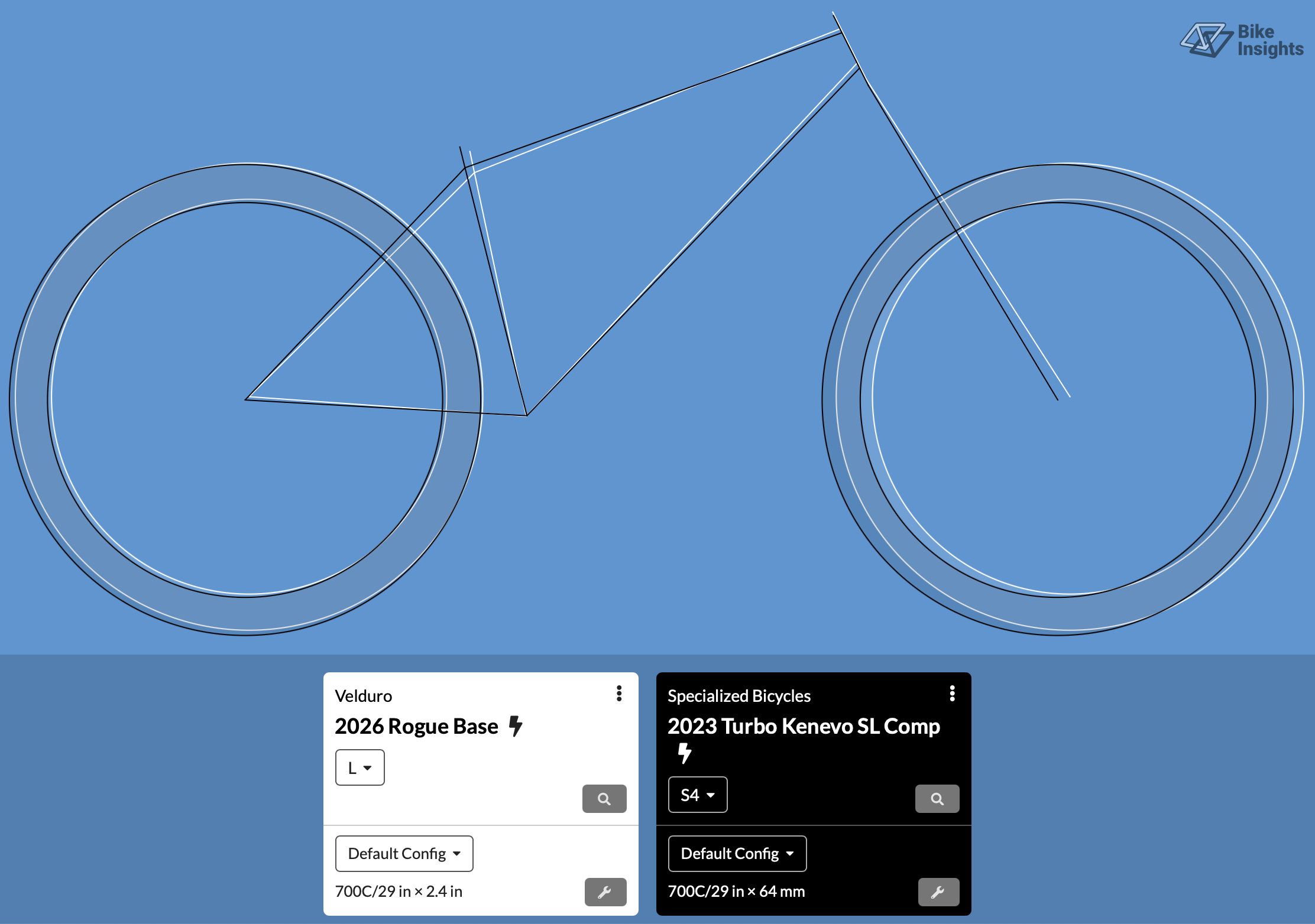

Because i'm a numbers nerd & if the numbers are wrong in my head it will be the reason i'm riding so badly 😆
I whacked the geo numbers into this calculator.
As a reference I used the kenevo sl s4 & it calculated the wheelbase to within 1.8mm of what specialized quote.
The med rogue wheelbase came out at 1255mm vs the quoted 1265mm
The large rogue wheelbase came out at 1278mm vs the quoted 1300mm
So now Im scratching my head as to the discrepancy. Hopefully be able to run a tape-measure over one in the near future.
The only way I can make the numbers work is if they are measured at sag where chainstay grows 10mm & the supposedly 450mm chainstay has already been factored in for the large despite the chart saying 440mm still.

interesting real world info. If I increase the a2c to 594mm of a typical 180mm fork the wheelbase calculates as 1260mm (+5mm)

All im saying is the calculator cant make the quoted wheelbase add up based on the other supplied geo numbers. Maybe im making an input error.
My s4 ksl and large rogue are very similar geo wise, same ha, reach, similar a2c fork. The rogue has a 7mm shorter chainstay yet a 13mm longer wheelbase? Doesn't make sense.
The long 1300+ wheelbase is what's putting me off possible upsizing.
different head angle. for what did i have just posted the overlay from bikeinsights?
