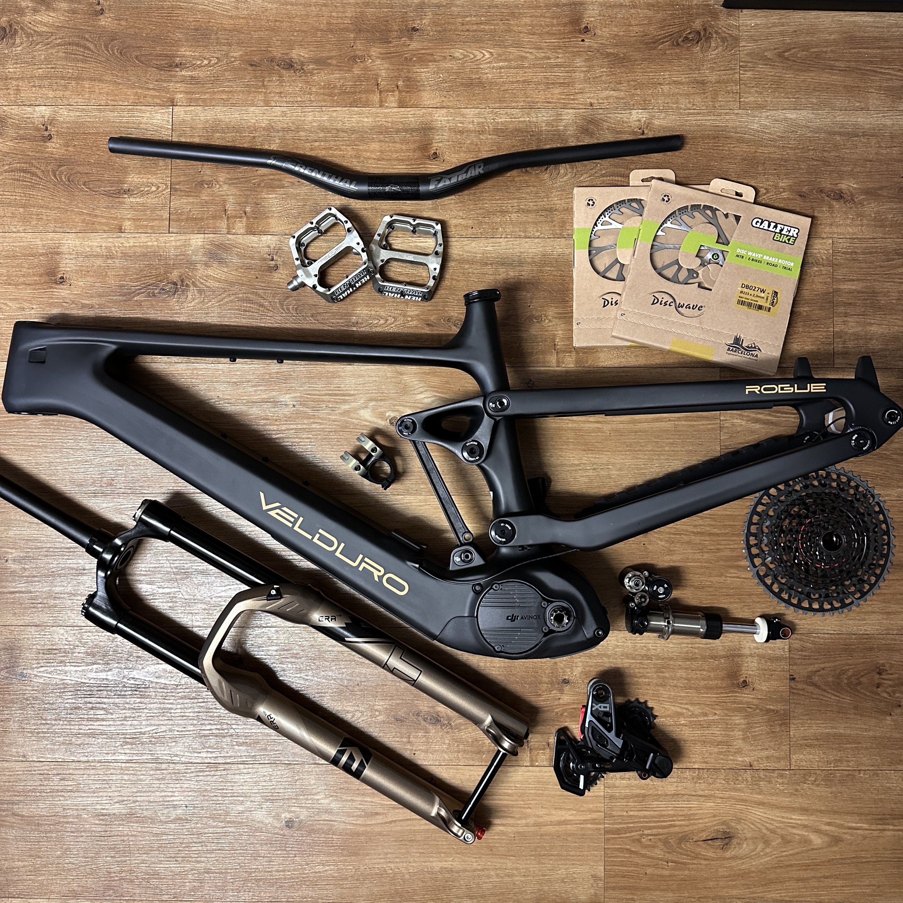

We’ve slowly started putting together our dream build! We decided on a super enduro setup with the EXT Era V2 LT 180 mm up front and the 205×65 mm E-Storia in the rear. Braking will be handled by the Hope GR4 in the Smoke color, and the wheelset will be in the same combo. I think this is going to be an absolute rocket-ship!

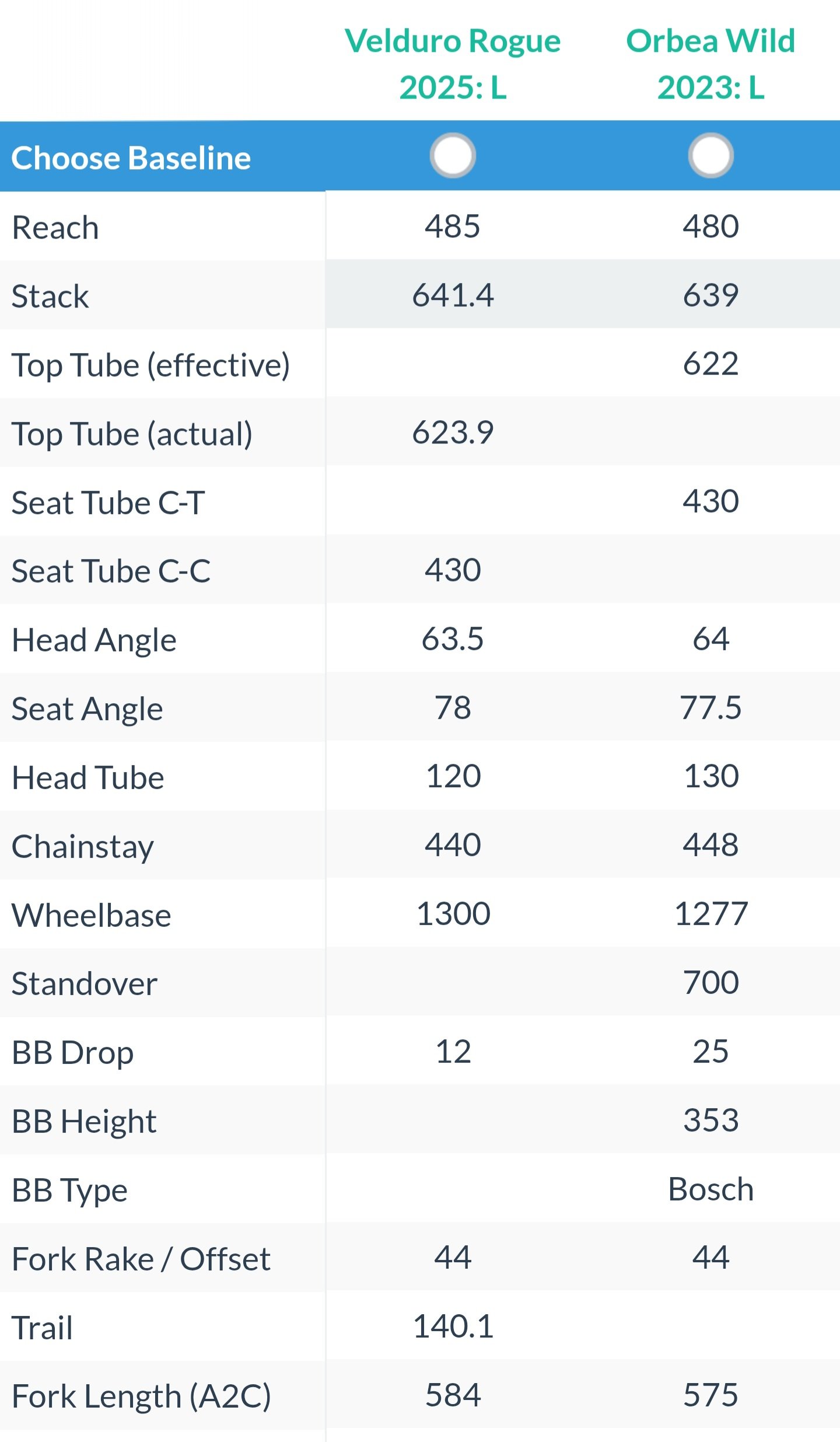

Its the enormous wheelbase im wary of the large. 450mm chainstay (supposedly) +15mm at sag. +8mm additional offset if i use my fox40 will add another 33mm to the already long 1300mm.
Im prepared to give their sizing recommendations a try, but yes would very much like to try both.
Using the Atherton sizing calculator brings me much nearer to the med though.
Edit its actually about 10mm at sag.
I've just checked the geo numbers against my current orbea wild size large
The reach on the rogue is +5mm and wheelbase is only +23mm. The chainstay is rumoured to be 450mm on the production frames so that's only +2mm over the wild but then the wheelbase will increase another 10mm to make it +33mm. Does this make sense or am I getting my numbers wrong?
If I am correct then i personally think I will be sound on the large as it will feel pretty similar to wild and then I just have to get used to the I-track system and characteristics
yes, you will sit and stand more centrally „in“ the bike, i‘d experiment with a slightly shorter stem. riding up and standing will also require less leaning forward
Sounds like its the right size I've gone for then, the stem I'm running is already 35mm so not much options to go shorter but I'm sure il get used to it.

Rogue size med frame (I'm 5'10") and still not entirely sure coming off specialized s4 sizing.
Protection - strategically placed helitape
Fork - fox40 @190mm (may buy a single crown)
Shock - ext e-storia (only part i need to buy)
Drivetrain - Shimano 10 speed linkglide
Cranks - whatever it comes with
Pedals - crank bros stamp7
Wheels - santa cruz reserve mullet
Tyres - conti krypto
Brakes - m820 saints
Rotors - Magura 220 floating
Bars - spank vibrocore 50mm rise
Grips - Revgrips
Stem - spank dm 40mm
Dropper - oneup 210mm
Saddle - Ergon sm enduro
Plus the 12A fast charger.

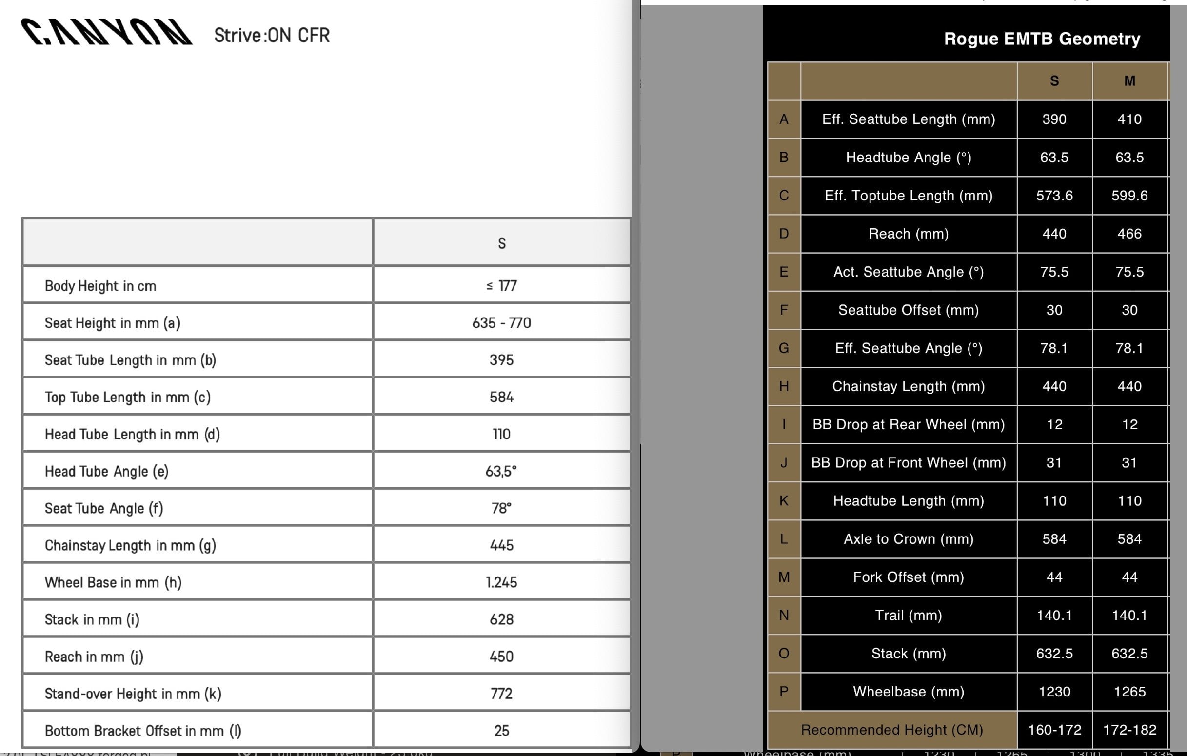

Hi I'm same size as you and wondering if I should bo small or medium.
I'm very happy from my Canyon Strive-on Small. It look to be in between Rogue S and M,
My Strive-On has 450 reach and I use it with Burgtec 35mm stem
So maybe Velduro S frame with 42.5mm Burgtec stem will feel very similar
Thanks for chiming in Mars 2, l have a Norco Range with same reach numbers as your Strive and l use a 40.0 stem. CS is 440.... what l have been wondering on with the Small Rogue is the effect on cs growth possibly to 450mm....
My preferred body position is back then close to centre and l am wondering on the size small with the CS growth.... this may shift me towards the front of the bike..... l do run the bergtec 50mm riser bars that could still sit me up and back....
Thoughts of going to a medium Rogue may hinder partly for agility a bit too much bike amongst other betterments for bike handling....
Rogue, size Large Frame
Fork - fox38 with Smashpot and Fast SC5 Damper @180mm.
Shock - Fast Ride E coil shock @65mm stroke
Drivetrain - Shimano 12 speed HG+
Pedals - Giant DH with long pins
Wheels - EX511 and DT 350 hubs
Tyres - High roller 3 or Butcher front, Specialized Cannibal or DHF on the rear dependant on weather.
Brakes - XT 4 pot with "Sinter" pads
Rotors - Galfer 220mm
Bars - Spank Spike 60mm rise, with DIY vibracore, 780mm wide
Grips - Lizardskin Northshore
Stem - Unknown, 55mm
Saddle - WTB Volt
I've got all the parts ready, just waiting for a frame now.
Sorry I'm not English what is CS? When it's your mother tong language abreviation seams obvious but when not you have no idea
I also run Burgtec 50m rise
Got it CS is Chain stay 🤣 My Canyon E-Strive is 445 so between V1 rogue 440 and V2 450mm I think 5 mm one way or the other will not change much for me. I use 145mm Pinnd crank that put me more centered.
