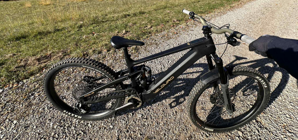

Built this thing with old parts that have come off many bikes, most recently a Crestline S180.
I’ve only had one real ride on it so far, and a “atmospheric river” is going to keep me from riding for a bit 👎
But my early takeaways;
-Build quality is great, lots of attention to detail. All bearings were well greased. Torque numbers on all hardware is always appreciated.
-Building this was quite easy and straightforward. Running brake cable in the down tube was the hardest part, and it was quite easy compared to many others I’ve built.
-The packaging was incredible with no plastic to be seen anywhere. All parts were clearly labeled. Even the frame was wrapped in a cloth bag.
Riding it!
-my current setup is Zeb at 180mm, ‘26 Fox X2 (205x65), Radic brakes, WAO wheels Mx setup, sram GX transmission, AXS 170mm dropper.
-this thing is fast and fun up hill, thanks to the Avinox motor.
-the idler pulley makes a little bit of a “growl” when under a heavy load. Not a bad noise, just a new one for me. But shifting has been flawless.
-Downhill this thing is in a league of its own! The mid high pivot seems to turn chatter and small bumps into speed. It feels like your “pumping”’ speed on the way down. I thought my Crestline was the best rear suspension ever, until I rode this. This bike is supple, nimble, poppy and fast. I don’t have much if any motor noise on the way down. The rear suspension is so good, it’s got me looking at new fork options to match.
Gripes
-the limited number of shocks that fit this frame is my only current gripe. I have an EXT Arma and a Vivid Air I was planning on using, and neither will fit. Having to buy a new shock to fit this frame was disappointing. On the bright side the new X2 seems to perform as well as the either of my other shocks, hopefully it will be a reliable shock.
More to follow when the sun shines again 🤙
