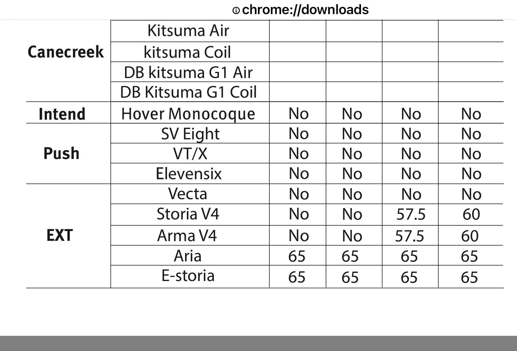

Heard that not all shocks will work with this frame as there may be some interference between reservoirs and the charge port. X2 is good to go but may want to wait to purchase anything else until details come out.
which shock exactly?
Not sure what you mean 🤔
Yes, thats the word. A list is due at some stage but the shocks that are expected to fit are the new 26 Fox's with horizontal reservoir, EXT, Suspension Tech Int A Kit Rouge spec, and maybe the DVO.
Looks like only horizontally mounted reservoirs, ext e-storia but not arma, don’t think Vivid will fit either.
a) list those „some shocks“
b) what’s your source?
Ive spoken with both Velduro NZ and Suspension Tech International here in NZ. I was going to put a RS Super Deluxe Coil on but was told it would not fit by Suspension Tech International. Ive therefore chosen to go with their A Kit which has been specifically built for the Rouge. The first shipment of frames are due here on November 27 last time I checked so good solid data should start to flow through in the 1 to 2 weeks after that. I'll aim to add some pictures of my RS on the bike for the group. My frame is Large and both my shocks are 65mm in stroke. Can't wait!

Shame it doesnt mention DVO or Formula shocks. And no verdict on Cane Creek. My original intent was to use my 24 Factory X2 but seems like that's a definite no. Next choice DVO Jade which seems like it might fit.
Just talked to my tuner, Fast Fenix 2 is too long also, but there is an option with a horizontal reservoir

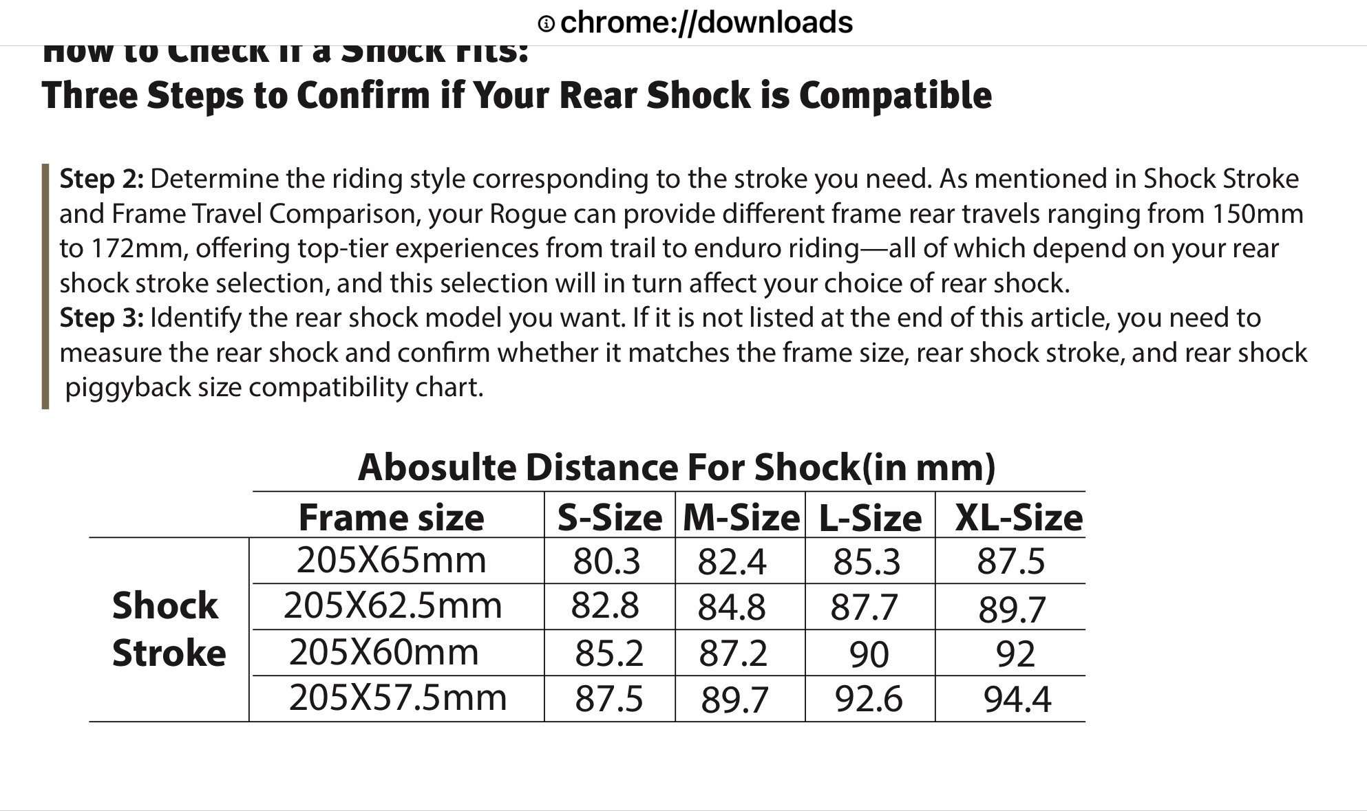

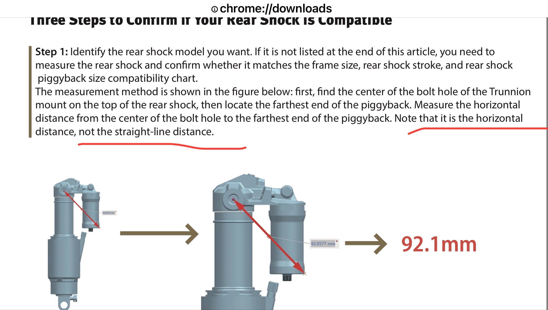

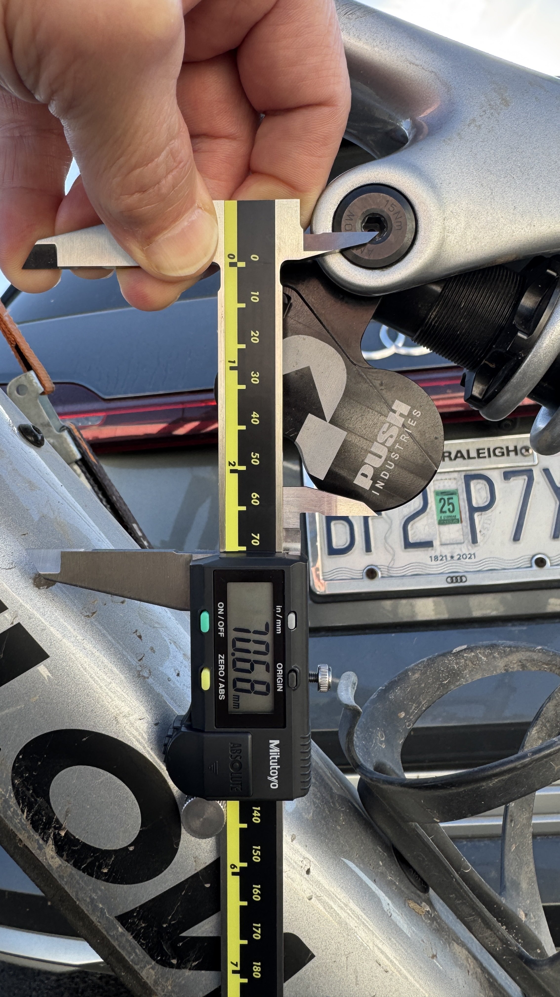

Hi,
It might be just me, but the measurement instructions are confusing to me, horizontal vs straight-line. Picture (and logic) indicating straight-line limitations.
Additionally, 2025 trunnion Push VTX on my Amflow measures ~70mm, which should be well below the 85.3mm required distance for size L 205x65. Not clear why it's listed as non compliant shock. Can we get a better clarification?
Thanks!
