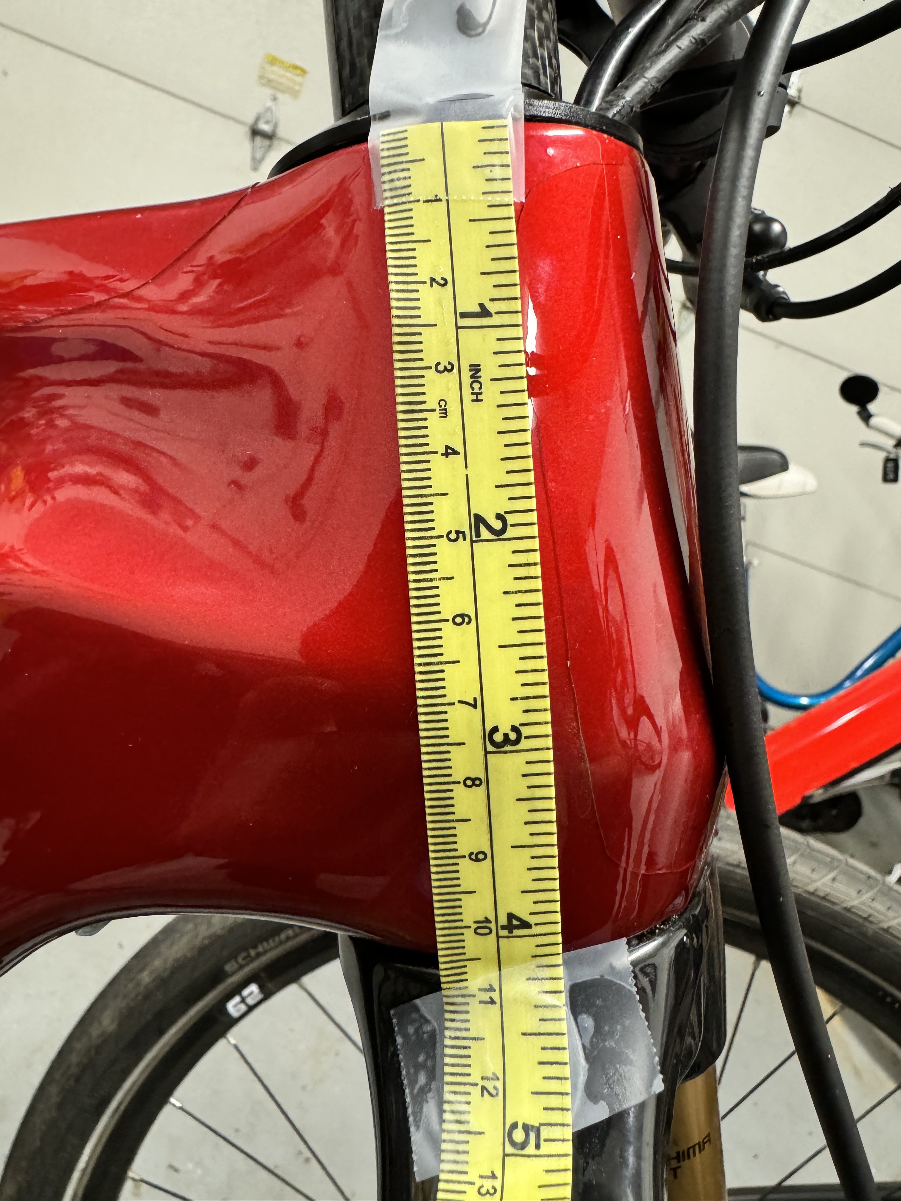

hey guys can anyone tell me the stack height of the headset? I have a fork but i’m unsure if the steerer will be long enough. I don’t have frame yet
Here's from my frame in case it helps (it's a size S)

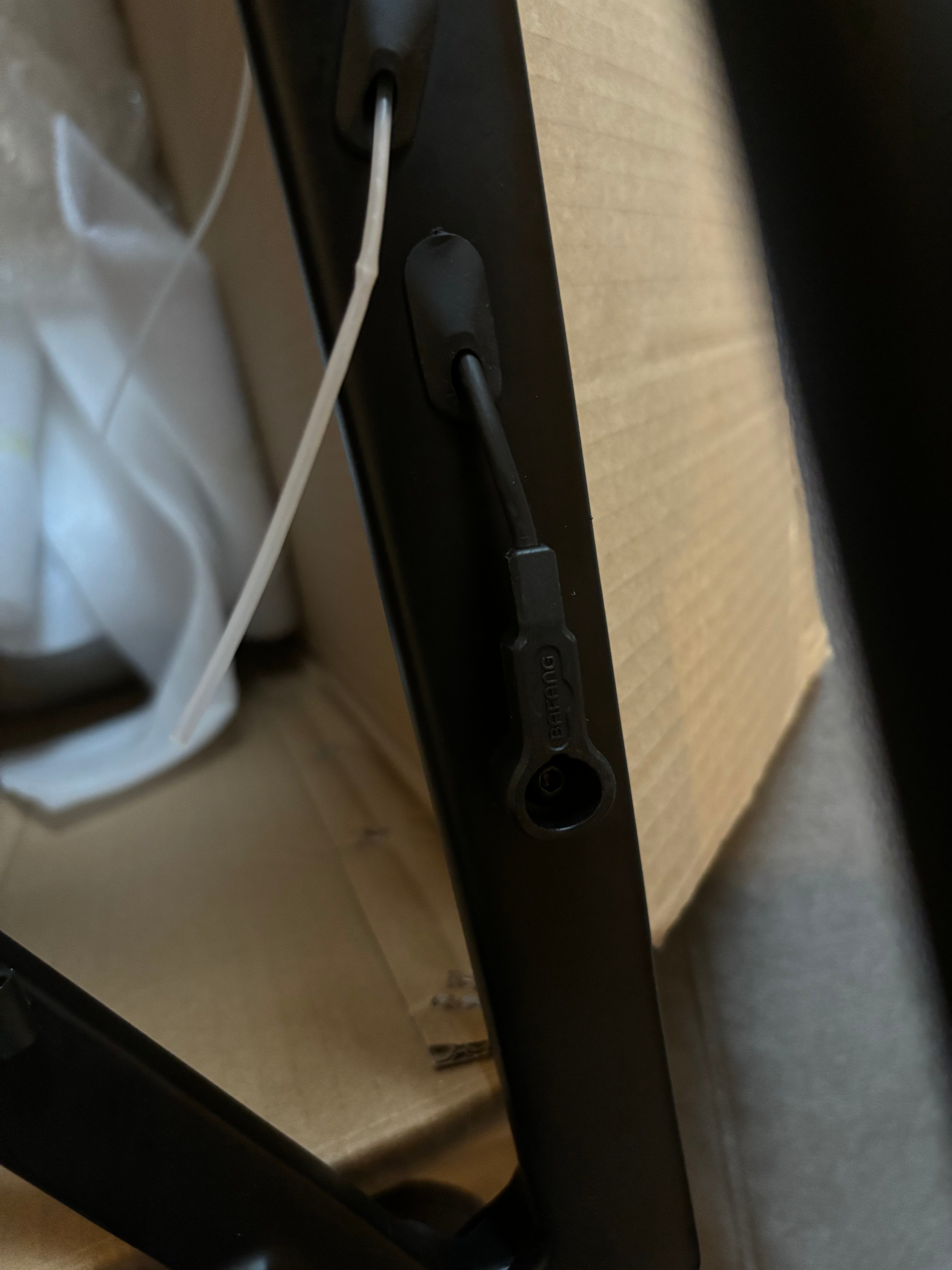

Any tips on the best way to clear the cables out the way when fitting motor? it’s crowded in there

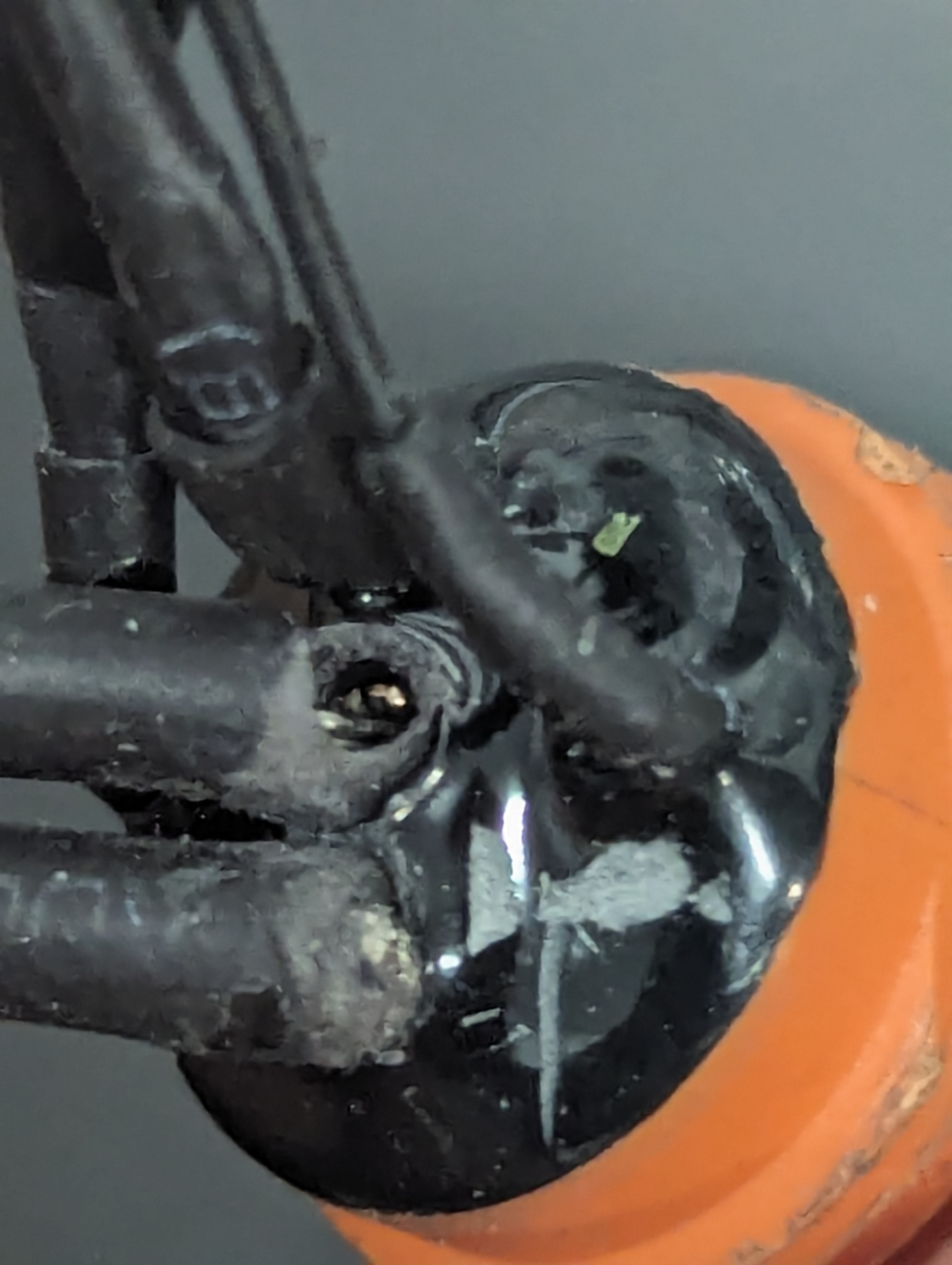

Don't put too much force on the charging cable or the leads will break off like mine did.
I had to do some grinding and soldering to fix them. Also, run the dropper cable on the non-drive side of the motor rather than under it. Finally, get an assistant or find some way to hold the front motor spacers in while you lift the motor into position. That's all the advice I have.
I also found having your bike upside-down helps. You can fiddle with the cables without the risk of motor dropping out, before you insert the motor bolts.
True. But be careful, not to drop one of the spacers from the most front motor bolt. It will fall inside of the frame, and the only way to get it out, is than to rotate the bike again..
