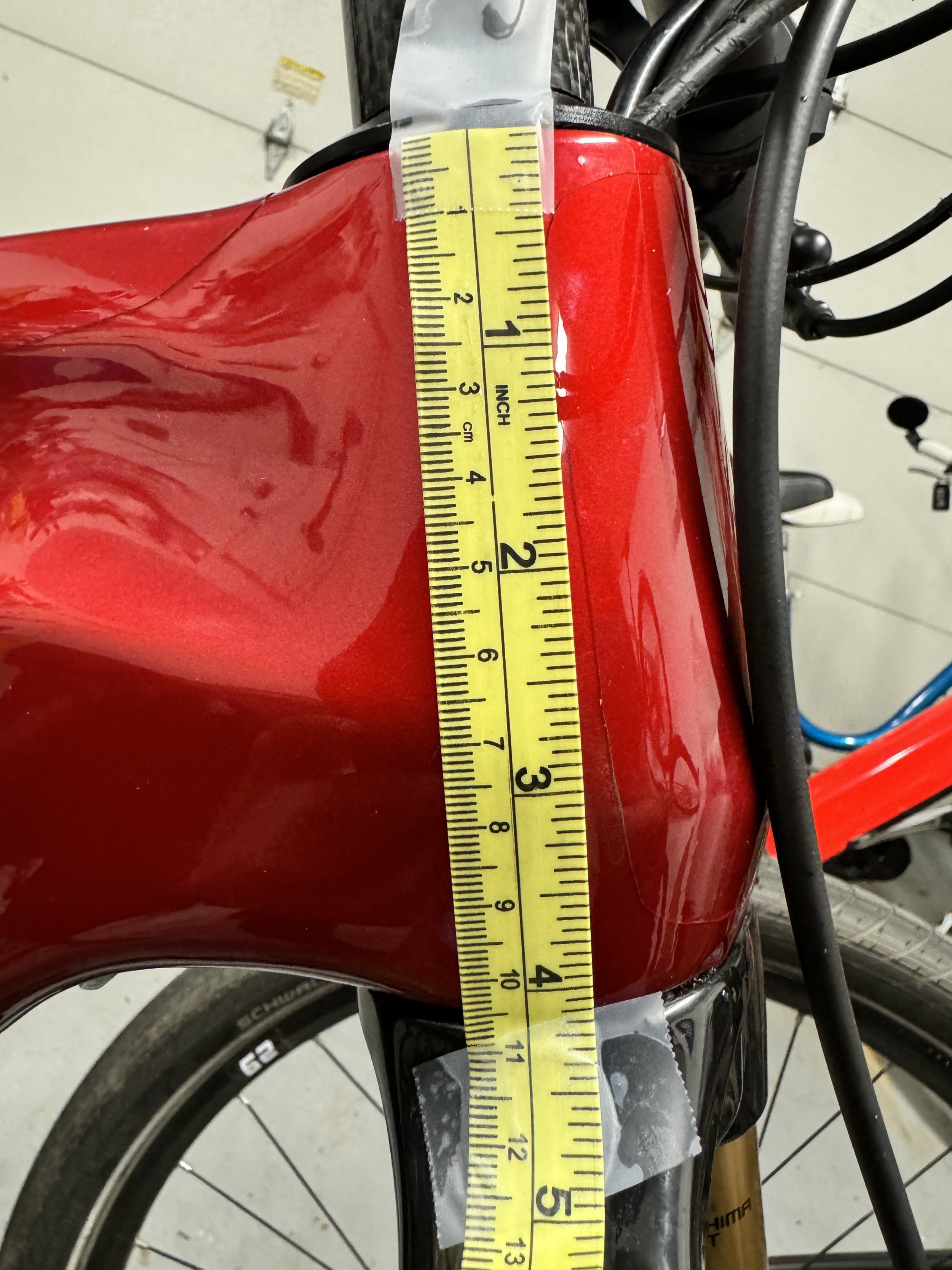

hey guys can anyone tell me the stack height of the headset? I have a fork but i’m unsure if the steerer will be long enough. I don’t have frame yet
Steerer should be a minimum of roughly 124mm + your steering stem height. More with spacers of course.

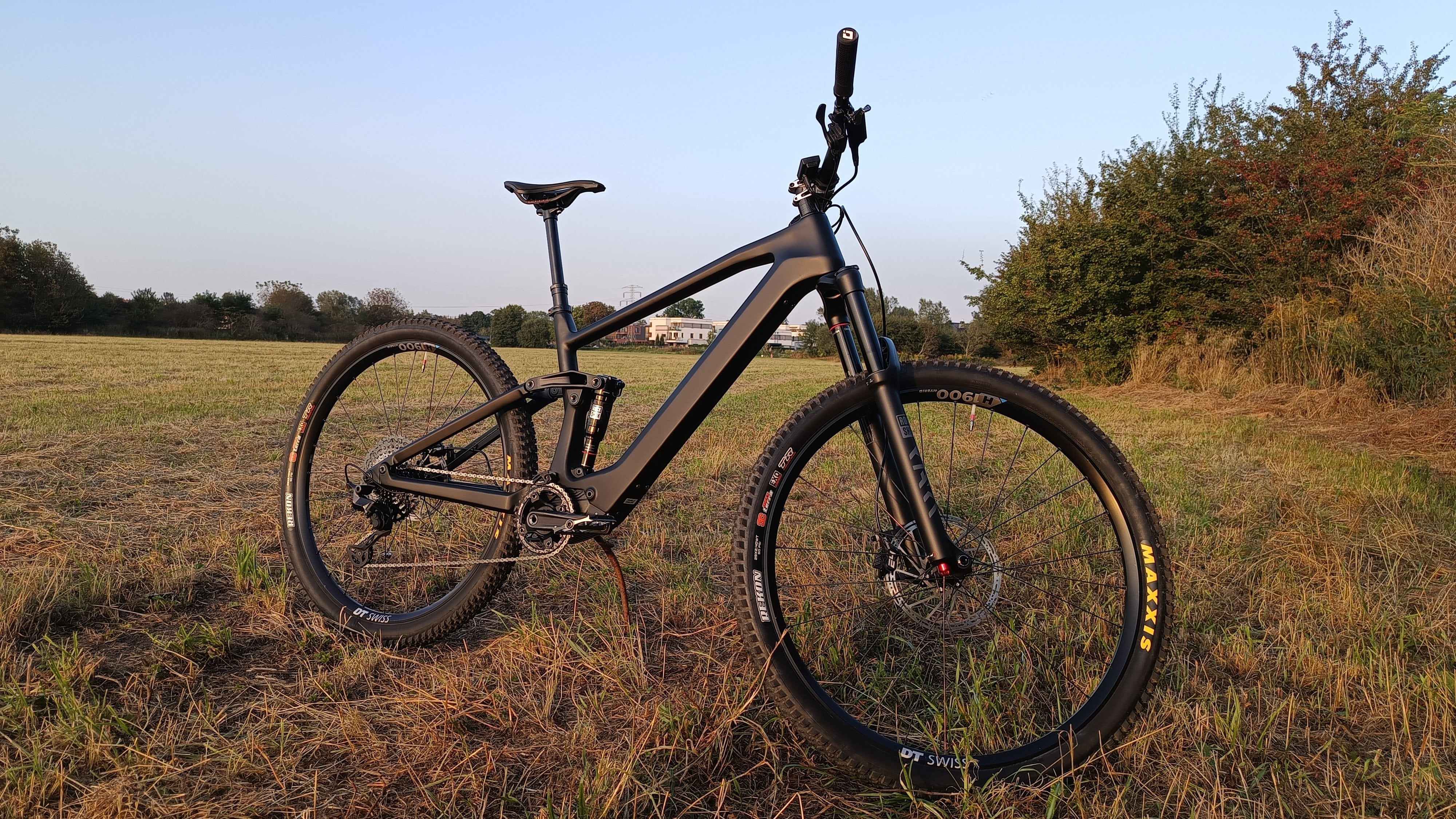

Sharing my LCE930 build, had a blast with this bike on the trail. Big shout out to Sandnap for the sharing his build up videos, avoided alot of pitfalls during setup especially with the wiring and motor installation.

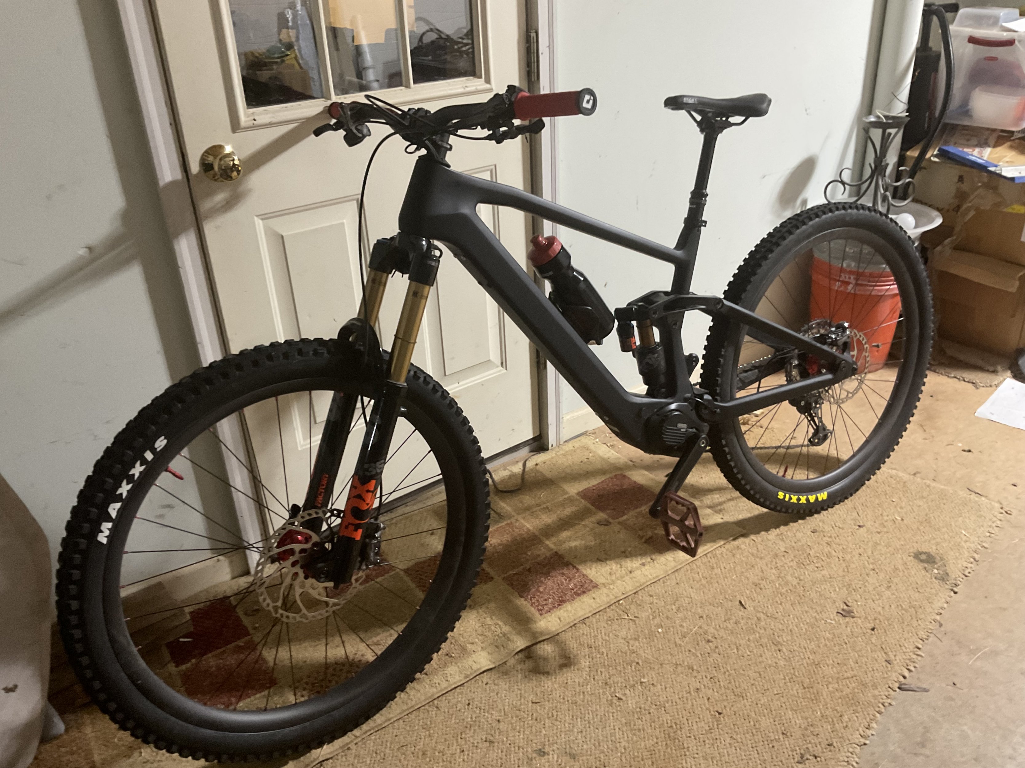

My spouse tried my Red LCE930 while on the trail. Then told me it was "like riding on a cloud" compared to her bike. Then told me I couldn't have it back.
Well I got it back! But I had to build another one for her (blue/orange per her paint spec)
