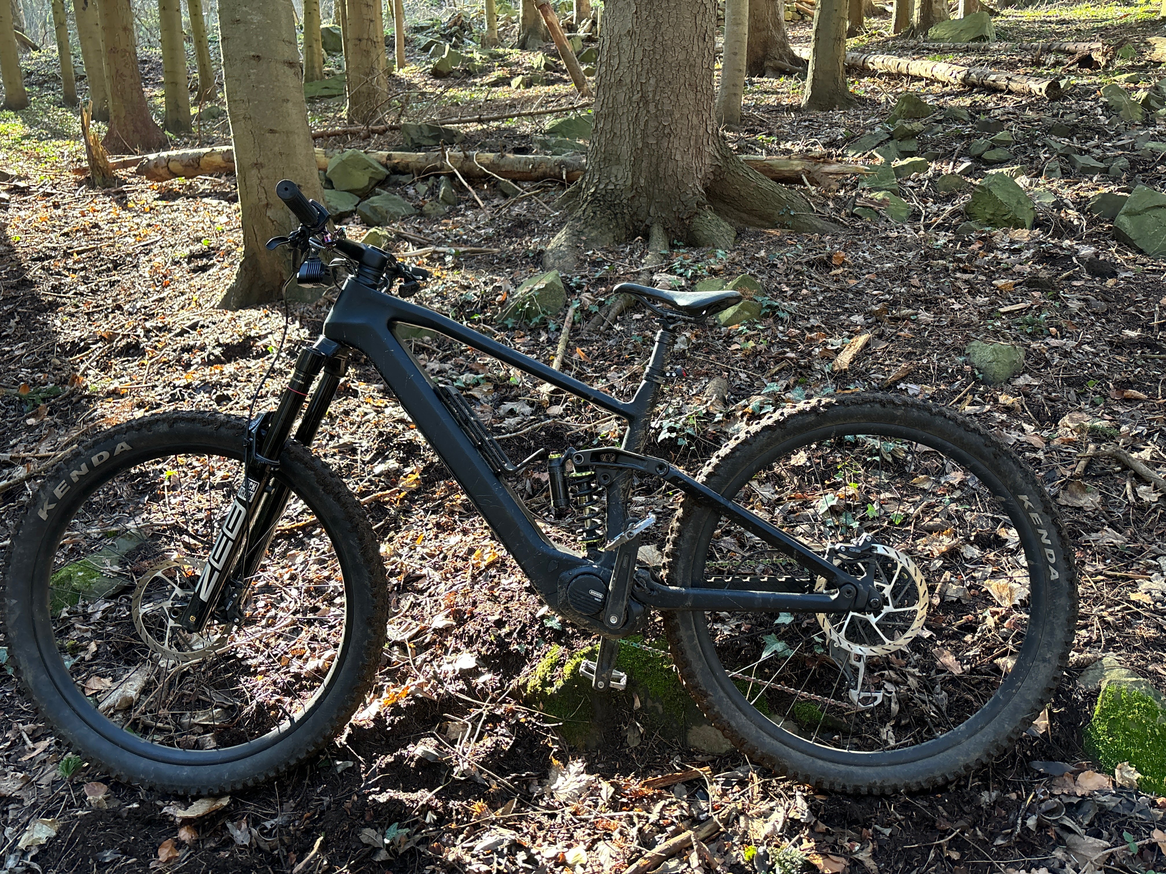

No problem I am happy to answer questions. I just covered them with blue tape.

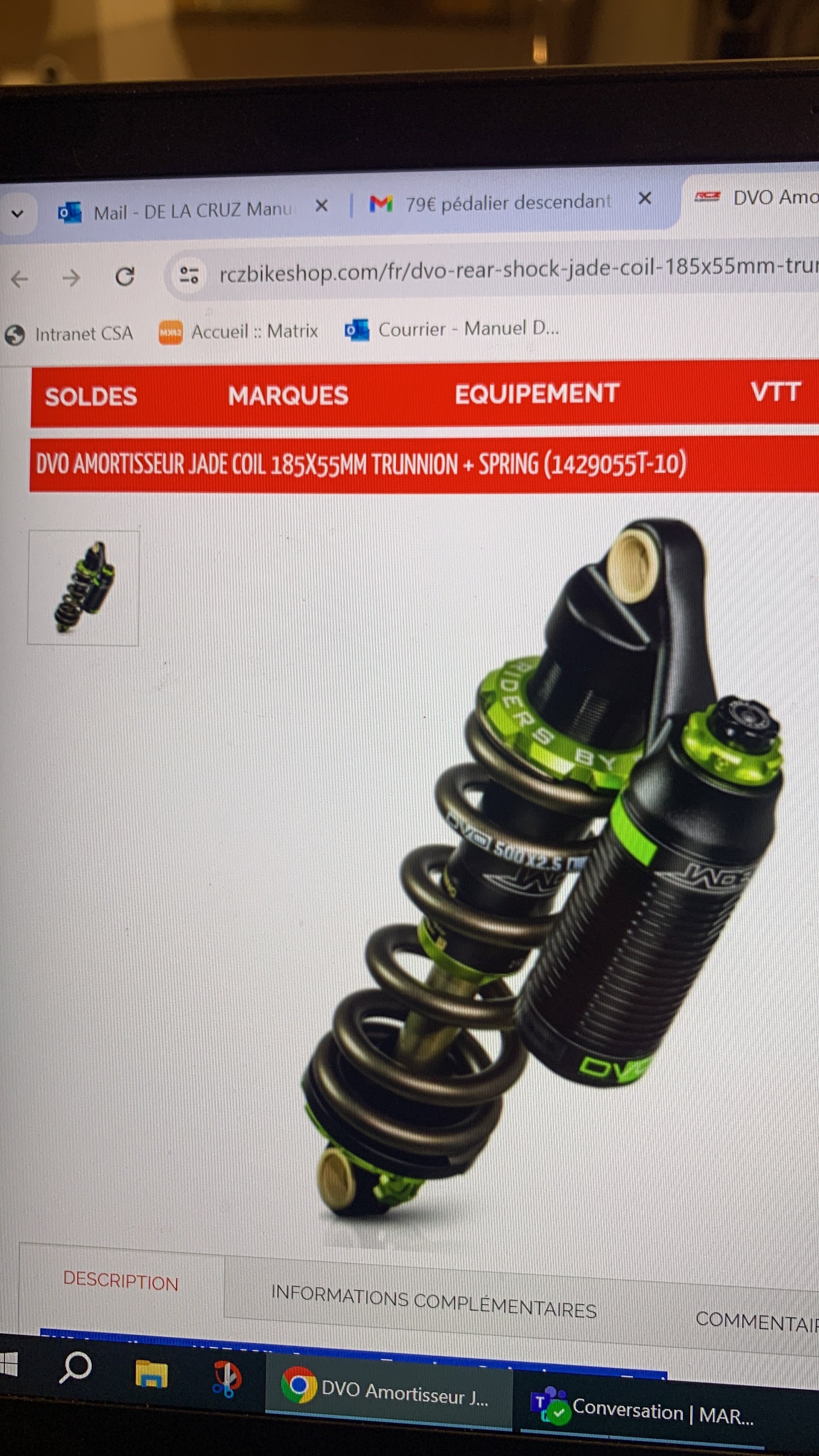

I got a question... i know the shock size should be 185x55, but in seems that the shock is to short for the upper anchor... so my question is, if i get the shock size 185x55 should i need some kind of adaptator, or i can assum thanh eventhough it seems more thiny is going to fit?

You will need the lower bushings (M8 x 22.2mm) if your shock doesn't come with them but everything else is included. A 185x55 trunnion shock the correct length, no adapters required.

Thanks.. i already have the frame, motor and battery... the shock is the only missing, i just wanted to be sure i am taking the correct one.. thanks a lot for your comments

Check on rcz bikeshop, you have amazing deals on shocks. It can be long to be delivered tho, that’s the only issue.
Ans check the private codes or rcz bikeshop on this forum: RCZ Angebote [Achtung, unsicherer Shop]

This is the one I got it!

The picture shows a regilar shock, not a trunnion, I have exactle the same. On this size normally it’s just trunnion, no problem
Not yet, yes for the size is only trunnion… so, non an extra component needed for the upper hardware? Cause for the frame I just got two screws for the upper and another long one for the lower… is anything missing?

You should be good, you only need the lower hardware.

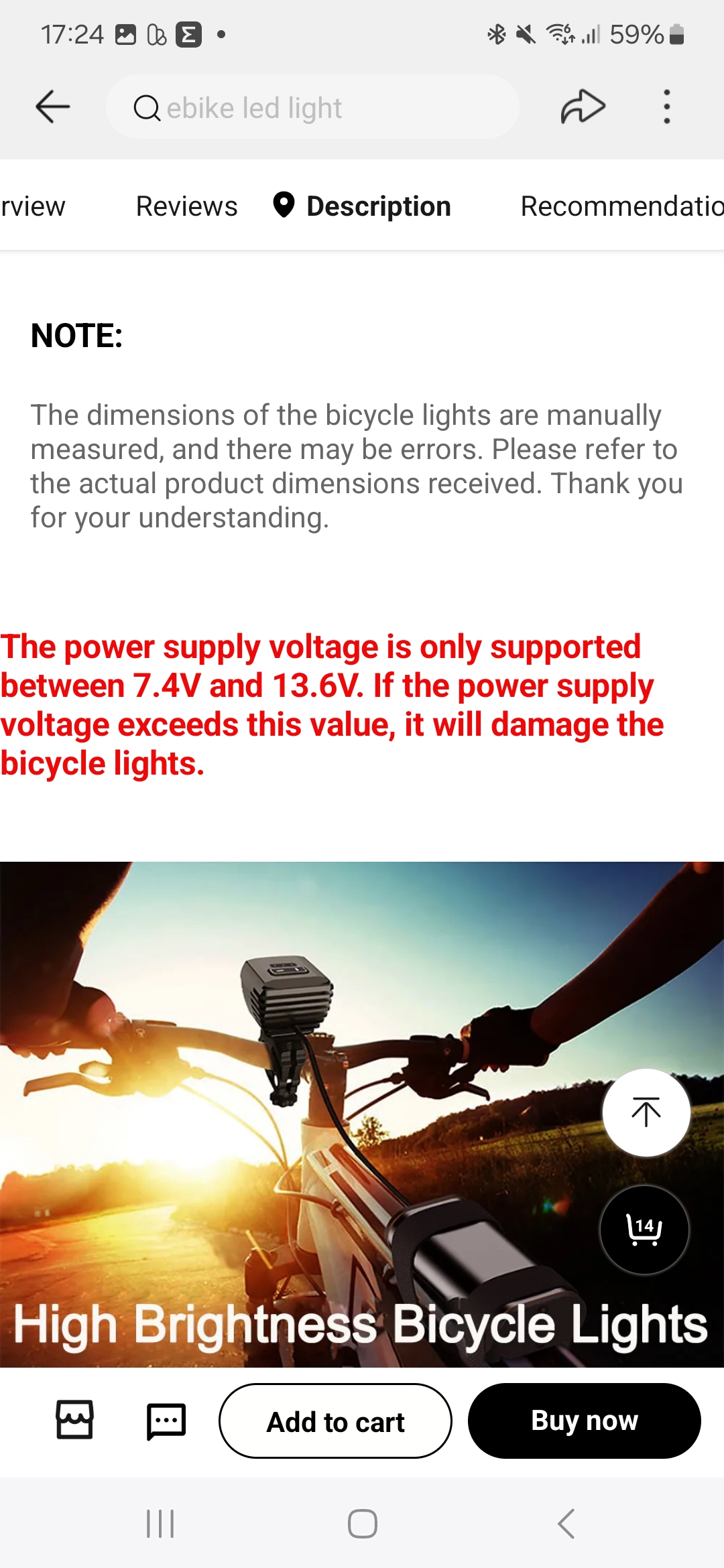

I was quite happy with the small one but this one has some issues, at full power, it's overheating and cutting.
This is this light : 16.1£ 35% de réduction|Enquêter avant LED 5000 lumens pour vélo, aste par USB, en alliage d'aluminium, éclairage de sauna, étanche, pour VTT, accessoires de cyclisme | AliExpress
The M5 version.
I also have a smaller one on my helmet for night riding with an home made lipo pack and it's working great.

I'm finally using LightCarbon handlebar (LightCarbon New Integrated Flat MTB Handlebar Suppliers,Manufacturers,Factories) which has an integrated mount for Garmin/Gopro and my light is from Aliexpress.
The M5 version.

What battery are you using for the light? Sounds like it is not getting enough amps maybe!?

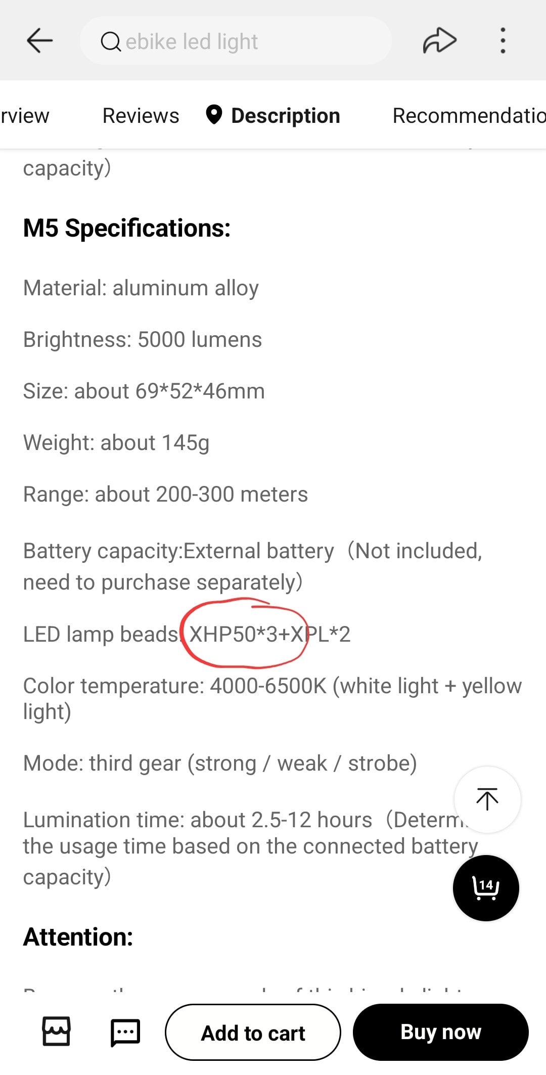

greeting. I bought an M5 lamp. she worked for about 20 minutes. then the 3 upper led stopped working. I took it in for repair, the electronics burned out, the led burned out. not really a quality.
So I might have the same issue, I never had a feedback from Aliexpress seller ...
To be honest I'm not sure all the leds are working right now, after 2 complicated night rides, I've suspended my rides in the woods in dark night for now :D
I'm looking for a remplacement lamp, maybe the monteer 5000, which is sold at a decent price, light only
I'm using the bike internal battery, with a DC DC 12v converter, I think it's a 3A.
But it's really hard to find technical details about the M5 lamp, so maybe you're right it's not enough

I think I am using the same 3A converter, but my light is a 24W 12V work light.
Those leds in the M5 are 1,5A each so might be the problem. I was thinking about getting the same light but now I am not so sure!
I need to change this converter, not now for sure, but I will do it, for a more powerful one.

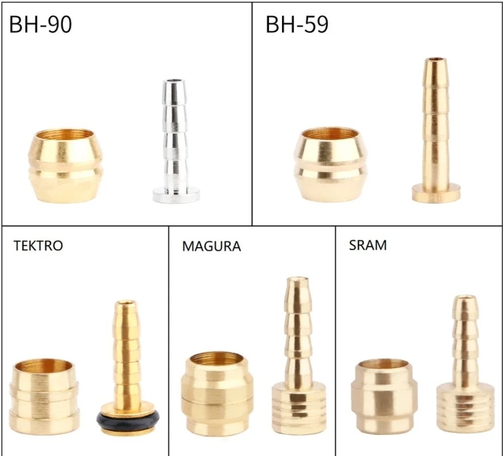

I am not entirely sure which olive/needle is required but from what I could see it looks like BH-59. I didn't have to cut either brake line so I could only see the olive and the end of the needle.
