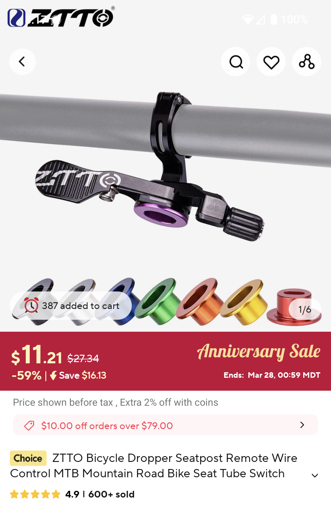

You're welcome I hope the videos are helpful. The dropper post is great but the lever it came with was cheap so I replaced it with the lever below and now it works very well.

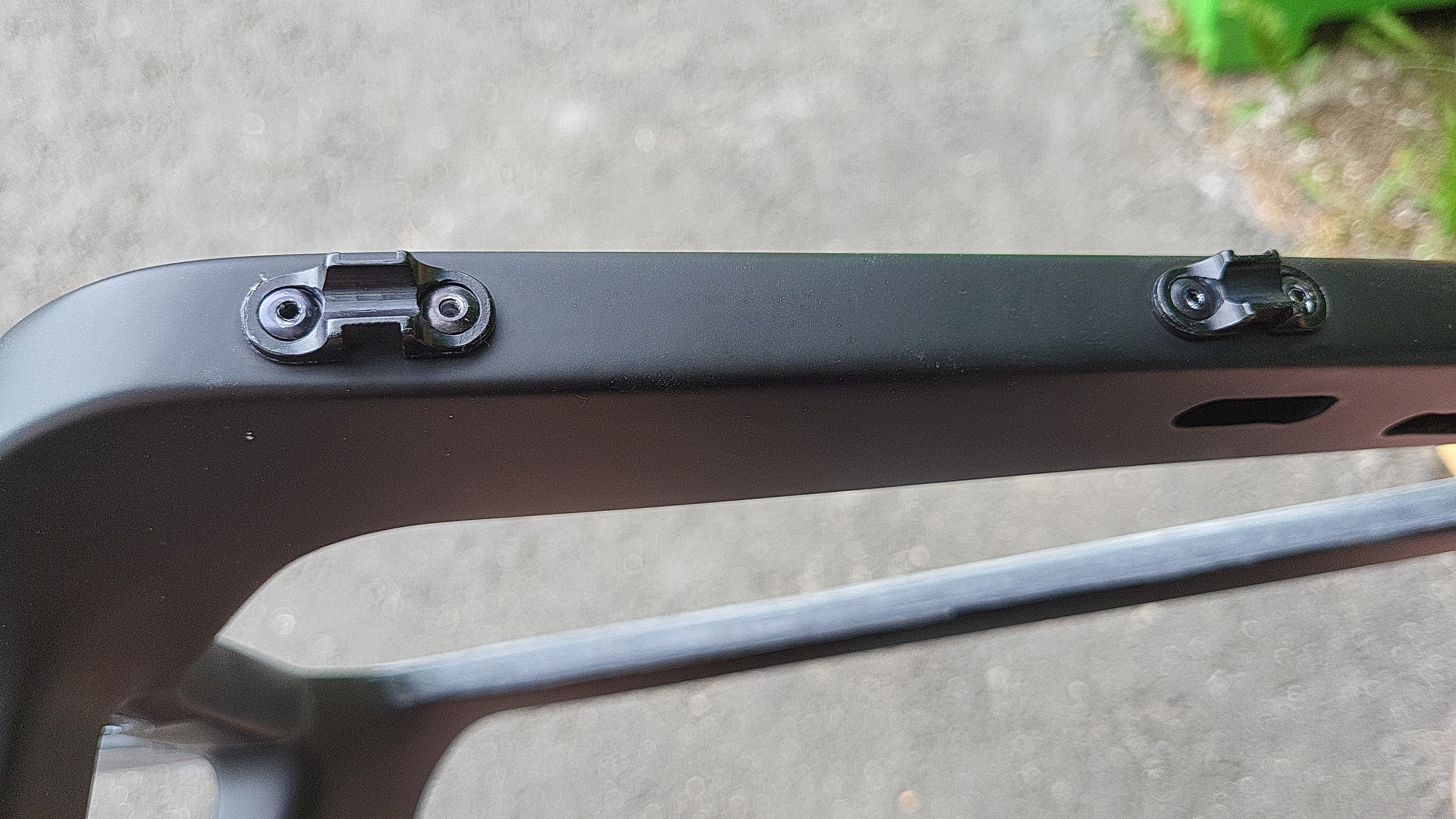

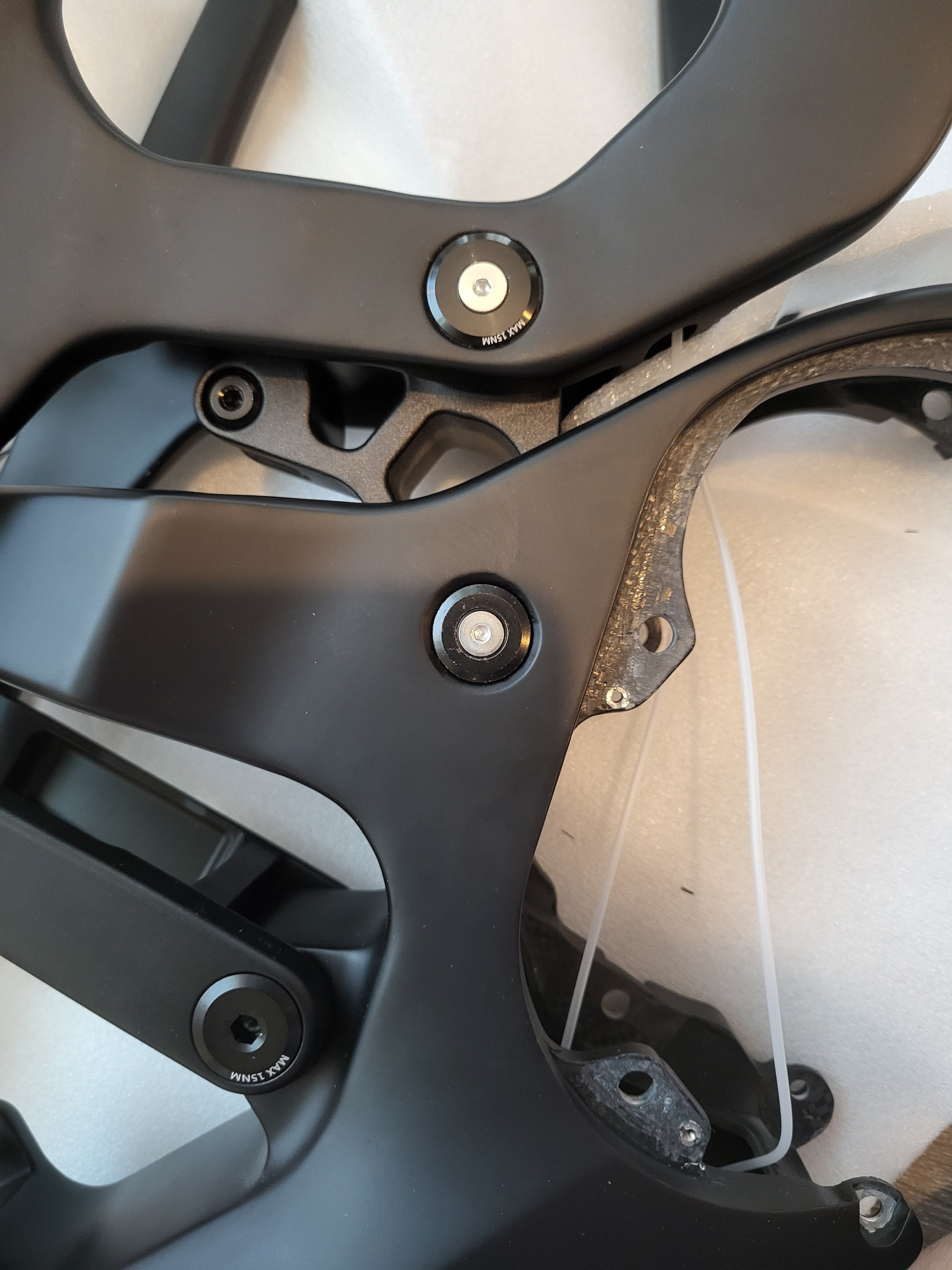

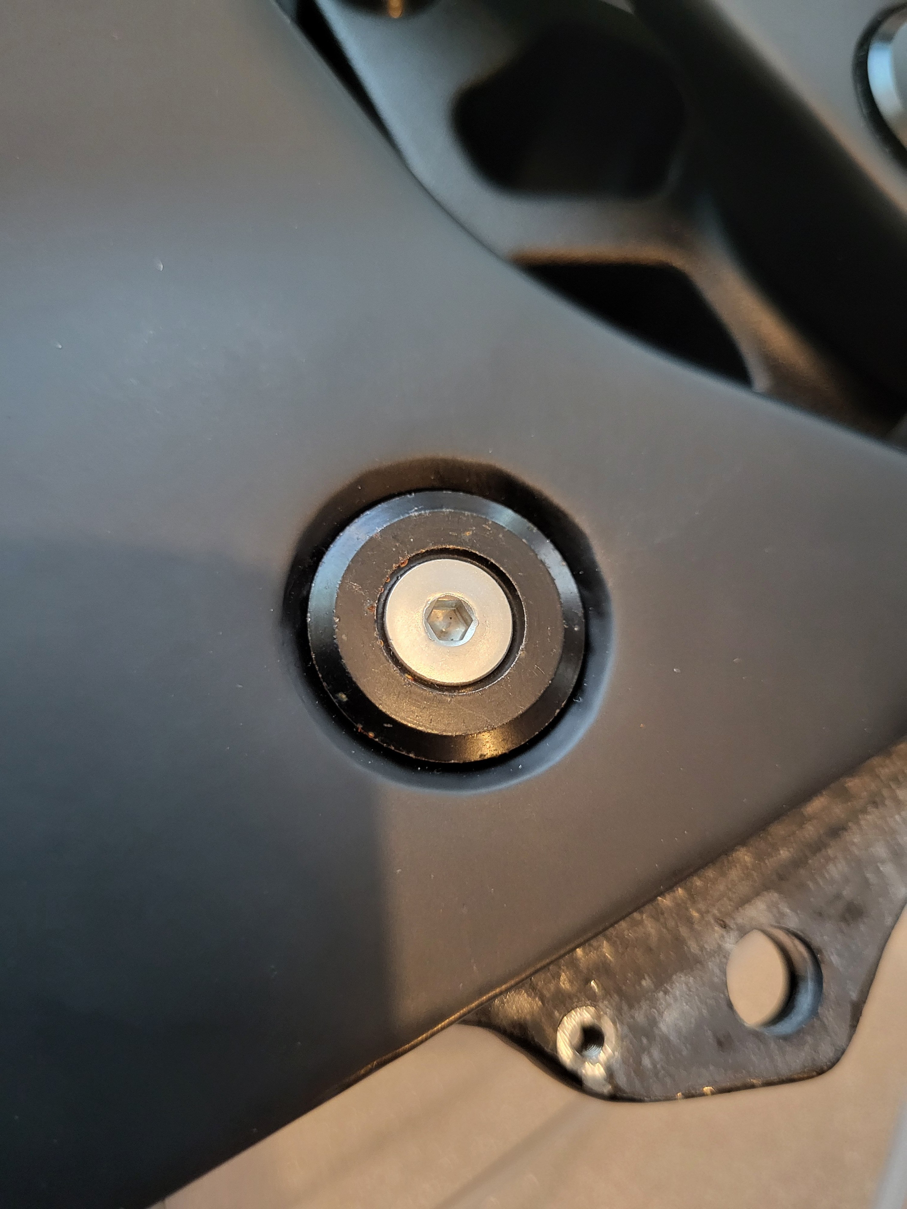

Yeah! I will start a thread later. I'm missing the connector from the battery support system. My frame has some temporary bearing caps instead of the proper ones. They are steel with small rust. I contacted Jim but no response yet. They should all be black aluminium. Other side has proper caps.
The LCE930 doesn't have those guides. Looks like you would have to drill out the rivits. I think I would just mask them. 🤷‍♂️
Yeah that's what I ended up doing :p

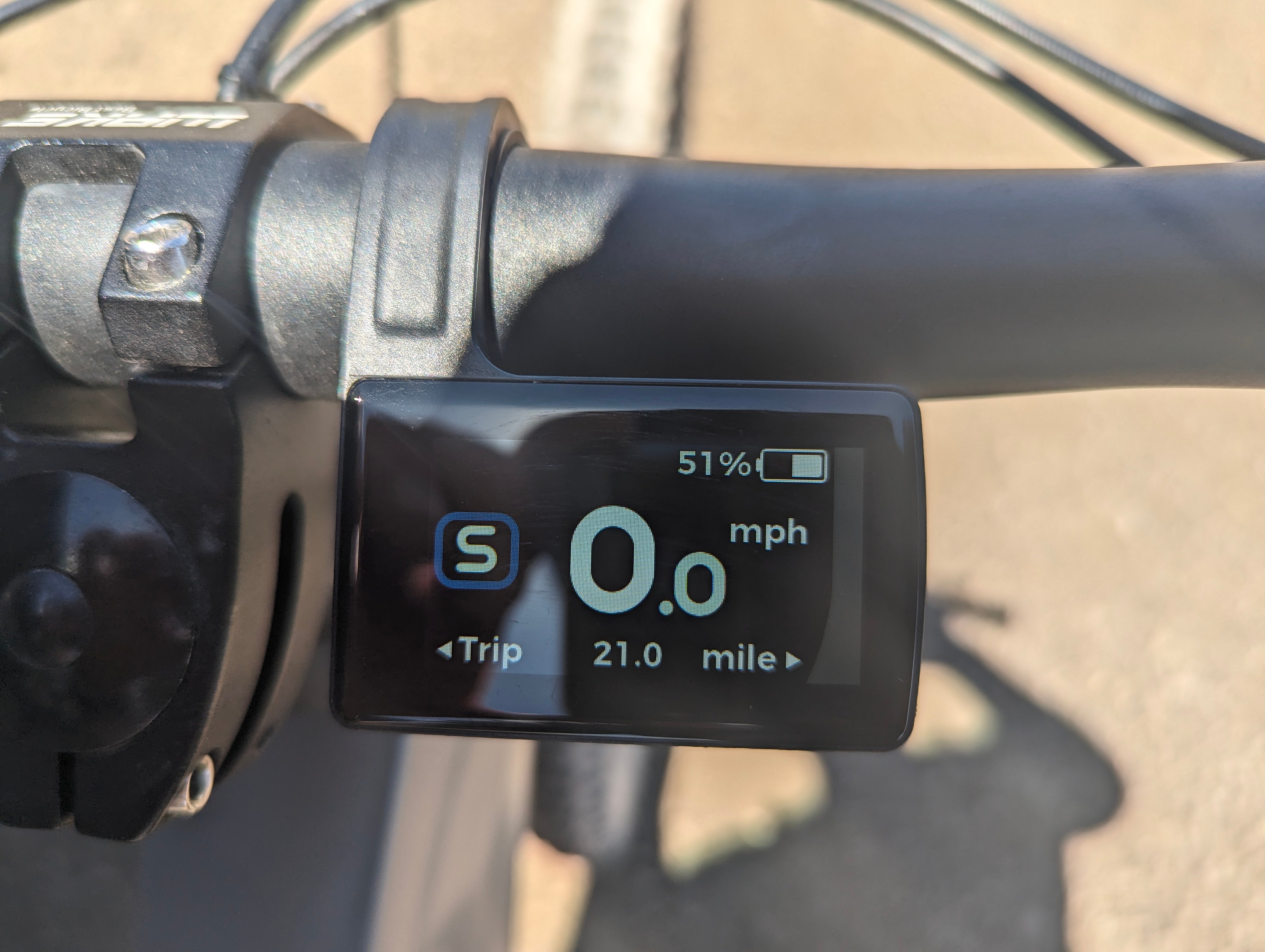

The more I ride it, the more I love this thing! Today's ride was the second ride on the same battery charge. On both rides I rode in sport mode. I am impressed with the range I am getting and the power and weight are exactly what I want out of an emtb.
Ride 1:
Ride 2, mileage is the total of the two:

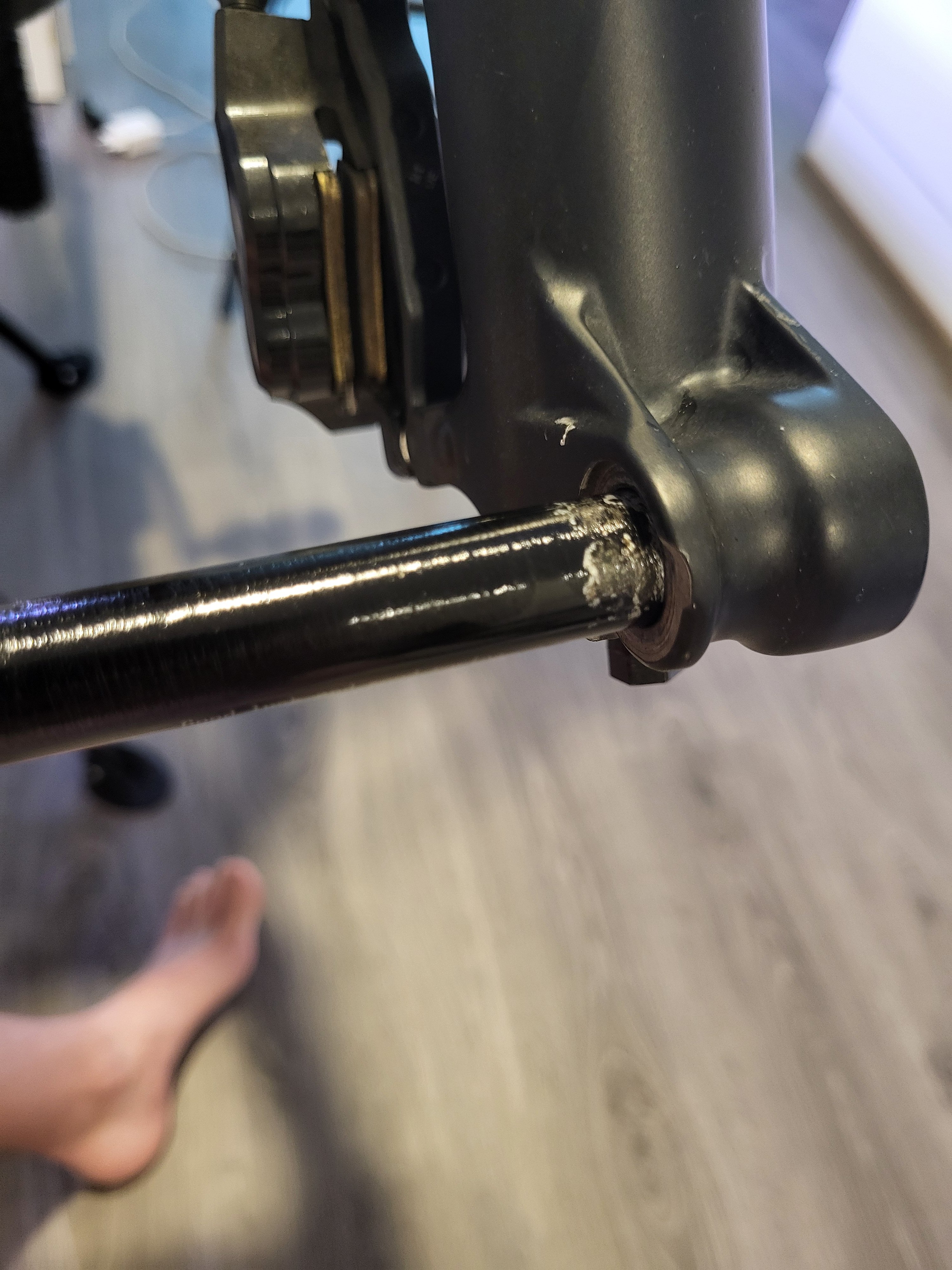

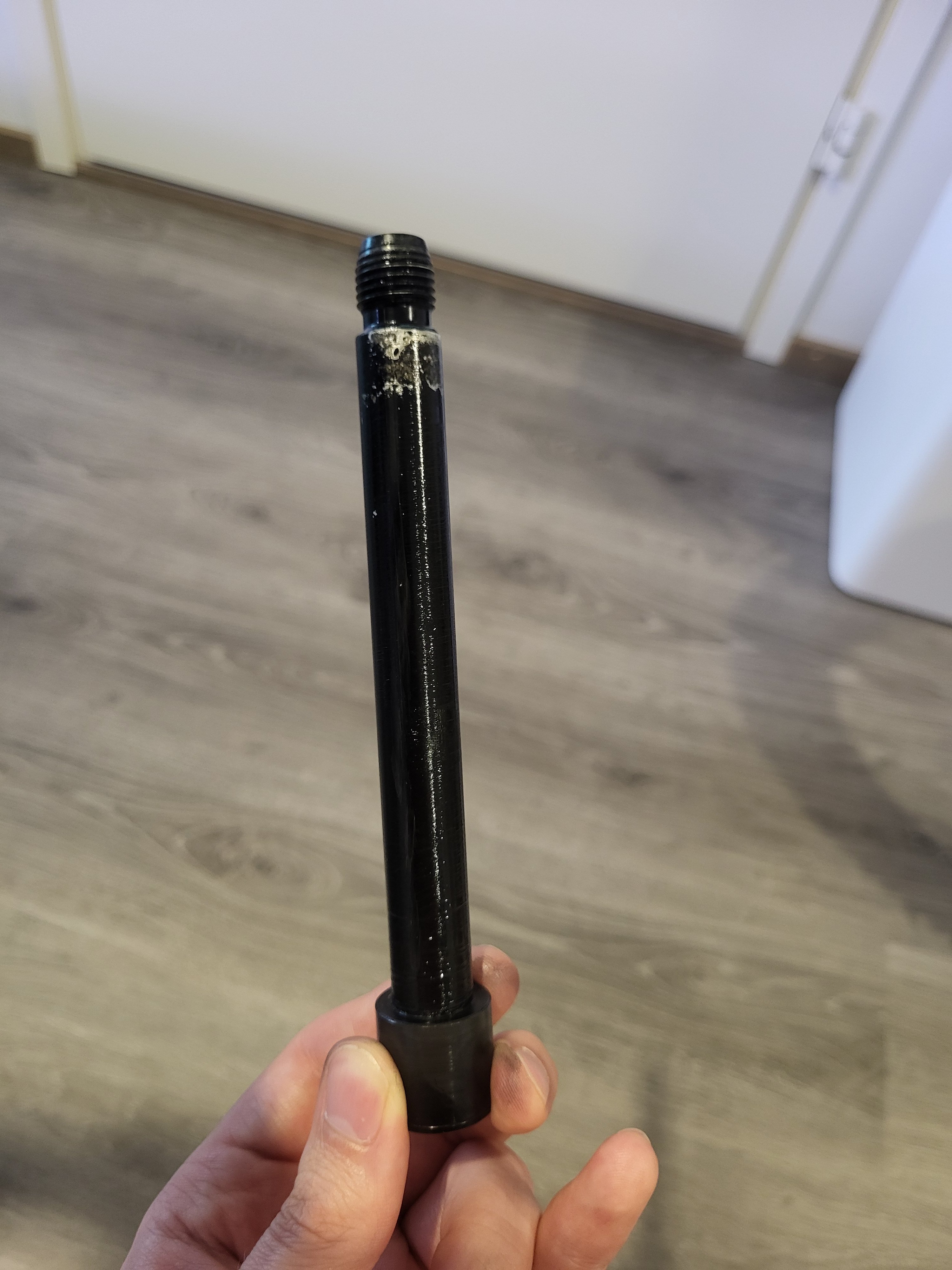

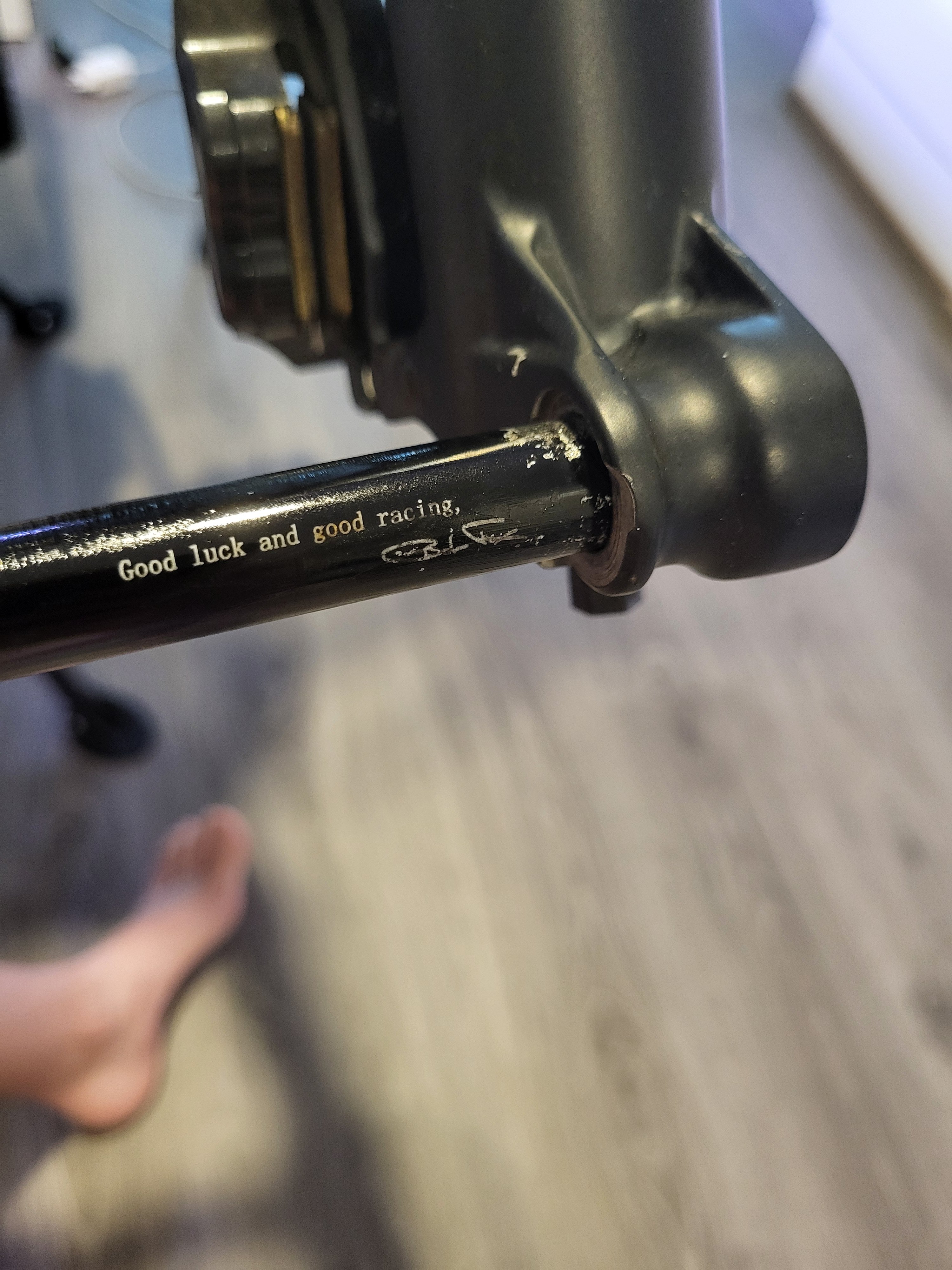

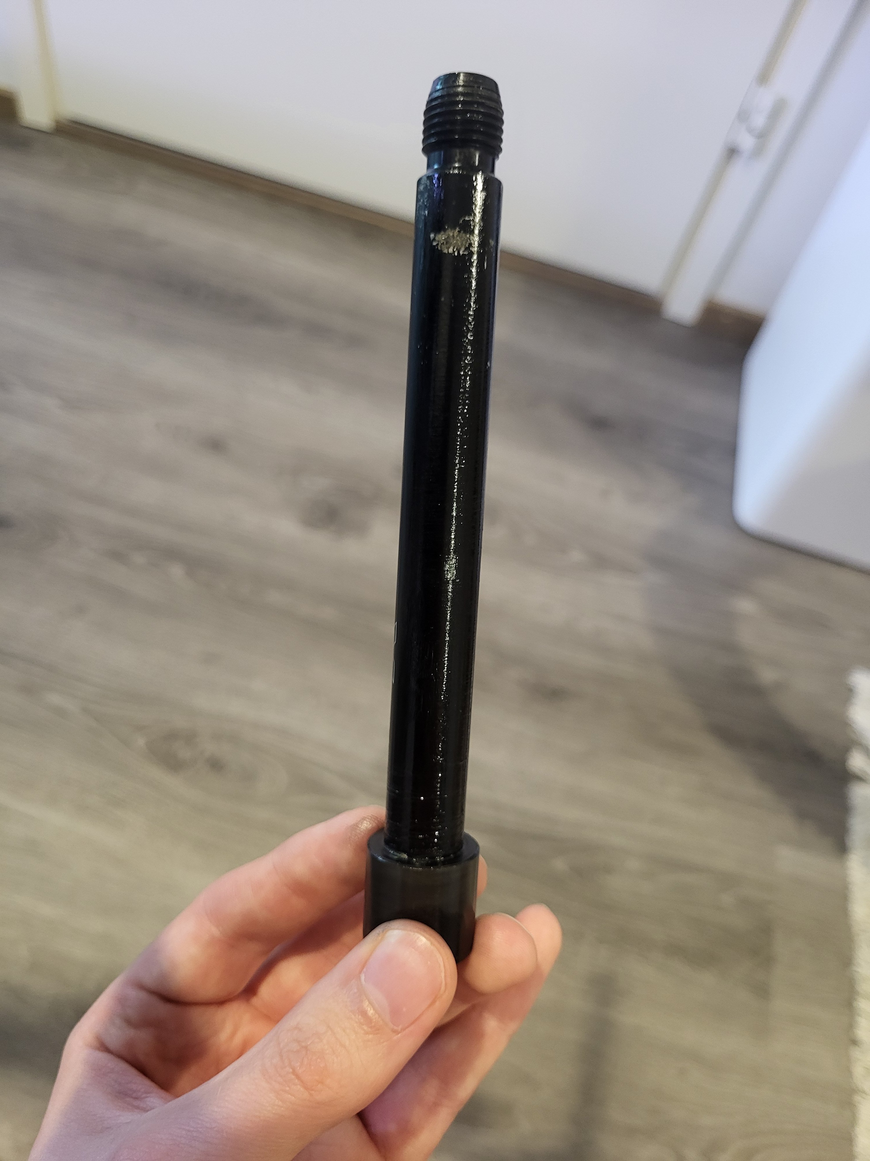

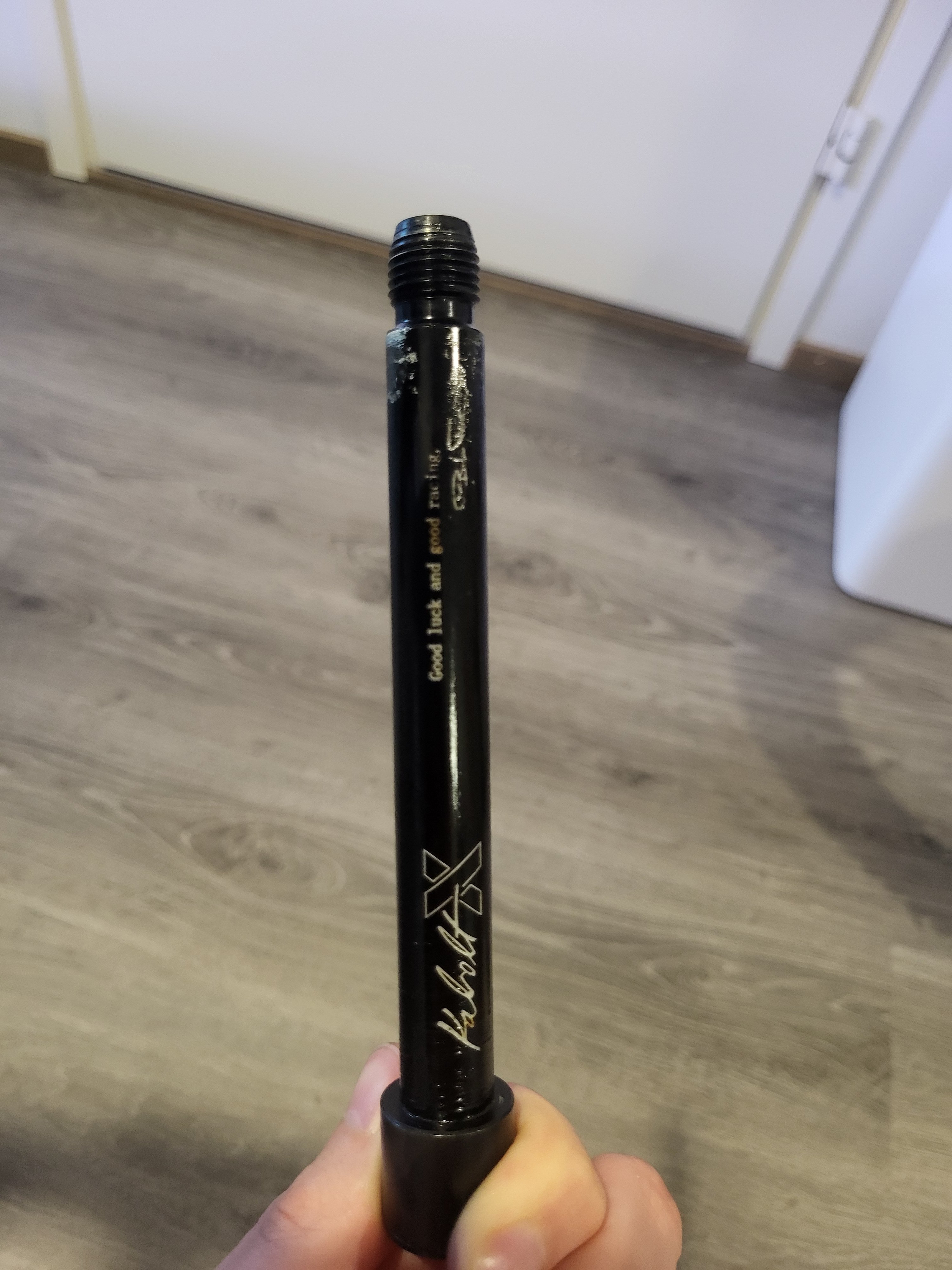

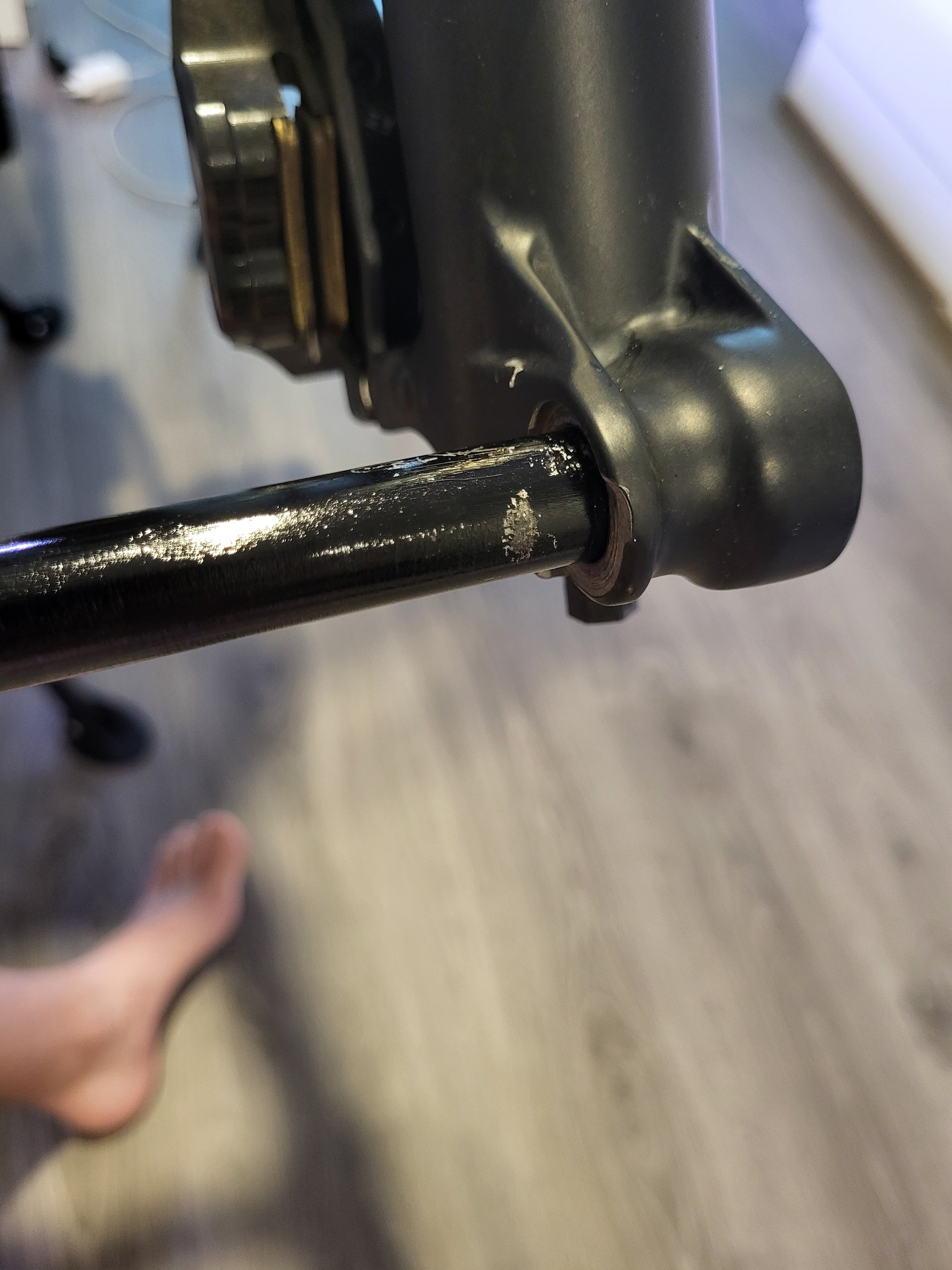

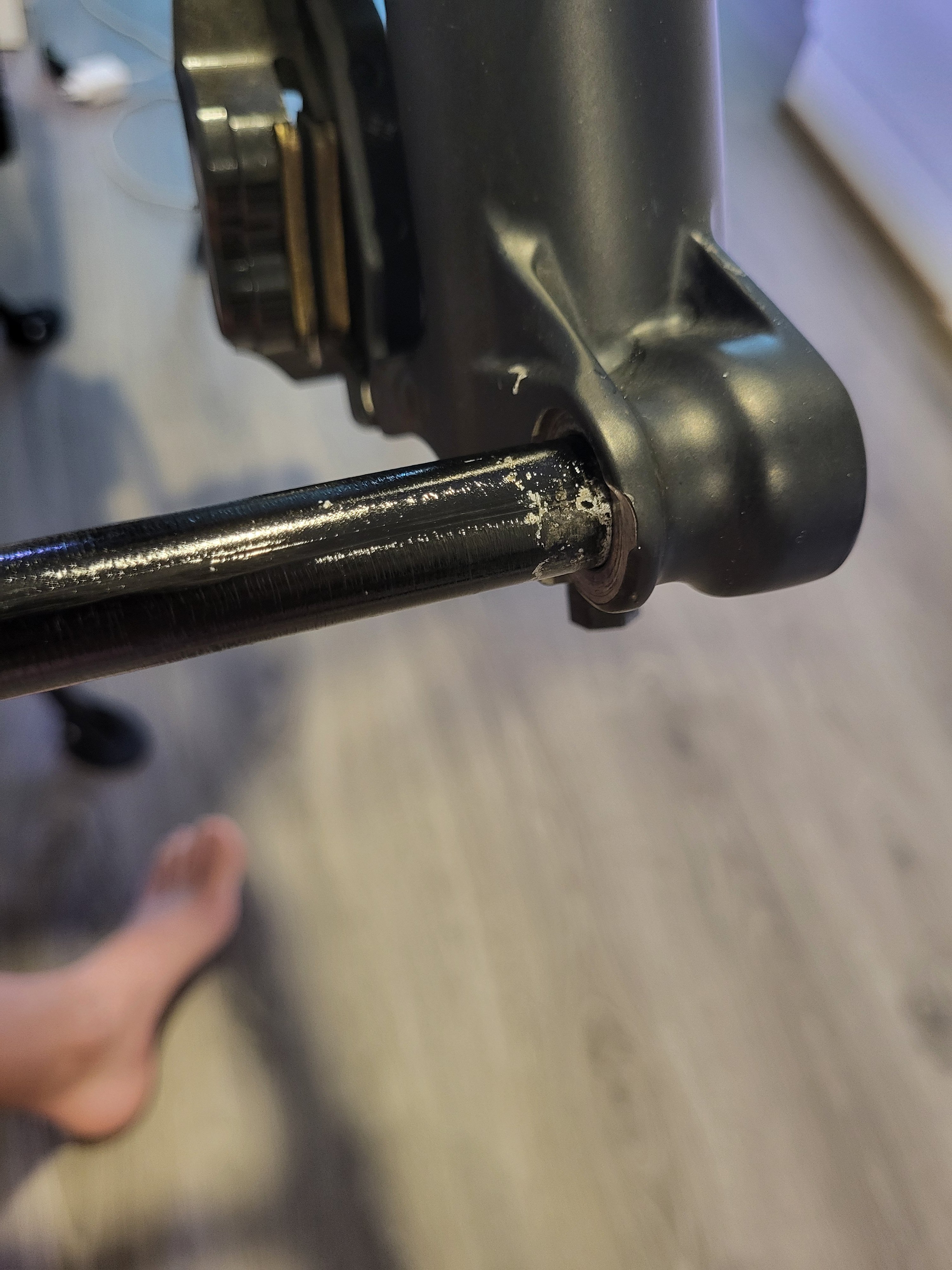

Took my front wheel off and found these marks on the axle. I'm pretty sure they were not there when I received the fork (used). Not 100% sure though..
This is how deep the axle sits when tightened with the wheel.
Other pictures have better view of the markings on the axle.
20240804_150828.jpg 20240804_150843.jpg 20240804_150853.jpg 20240804_150923.jpg 20240804_150928.jpg 20240804_150931.jpg 20240804_150935.jpg
Yeah that doesn't look good. I took mine apart and everything looks good. Is the inside of the hub work on that side too?

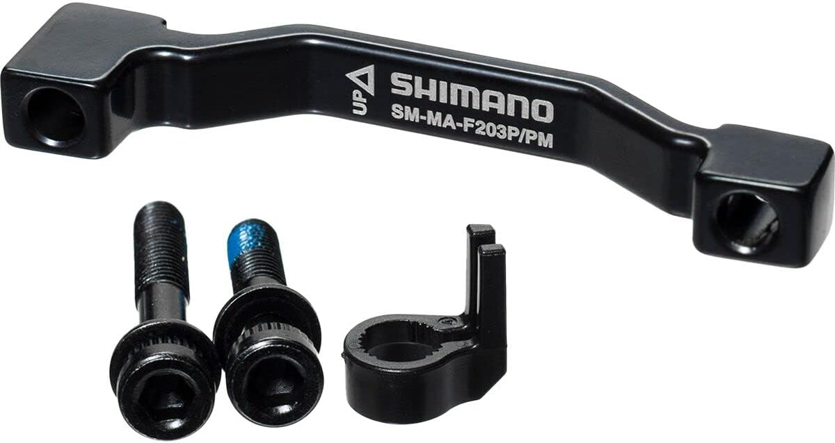

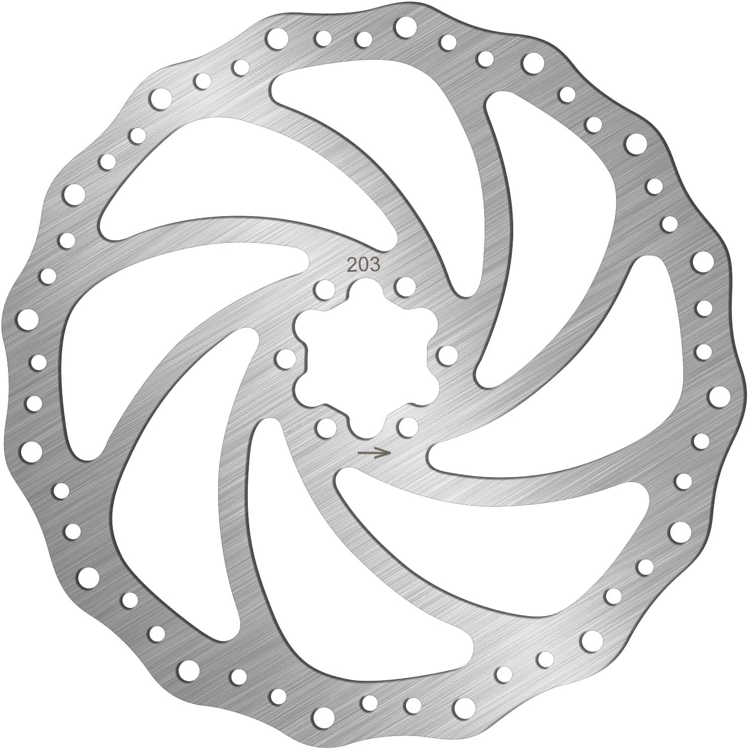

@sandnap which brake adapter you went with that fit the 220mm rotor? If you have links to the adapter and rotor I would appreciate!
I started with 200mm rotor on the front and ordered an adaptor for it. It didn't fit at all and then I had to go to LBS and buy shimano adaptor and it "somehow" fit with few shims...
Looking to avoid these troubles this time that's why I'm asking since you have the same brake caliper as I do 😅
I am using a 203mm rotor on the front and 180mm on the rear. I had the same problem with adapters on both of my bikes and ended up with the Shimano adapters after returning a couple that didn't work. I didn't have to shim at all on my LCE930 but I did have to shim a bit on my other bike and my wife's bike.
I am using Bucklos rotors on the front and rear. So far no issues with the rotors or brakes. I am about 3/4 through my first set of pads.
Oh I thought you had 220mm in the front 😁 I'm thinking of trying 220mm rotor on the front since I prefer really powerful front brake. It might make the front brake too powerful but it's not a high cost just to test it out :p on the rear I don't think there is a scenario where bigger than 180mm rotor would be needed with these brakes.
