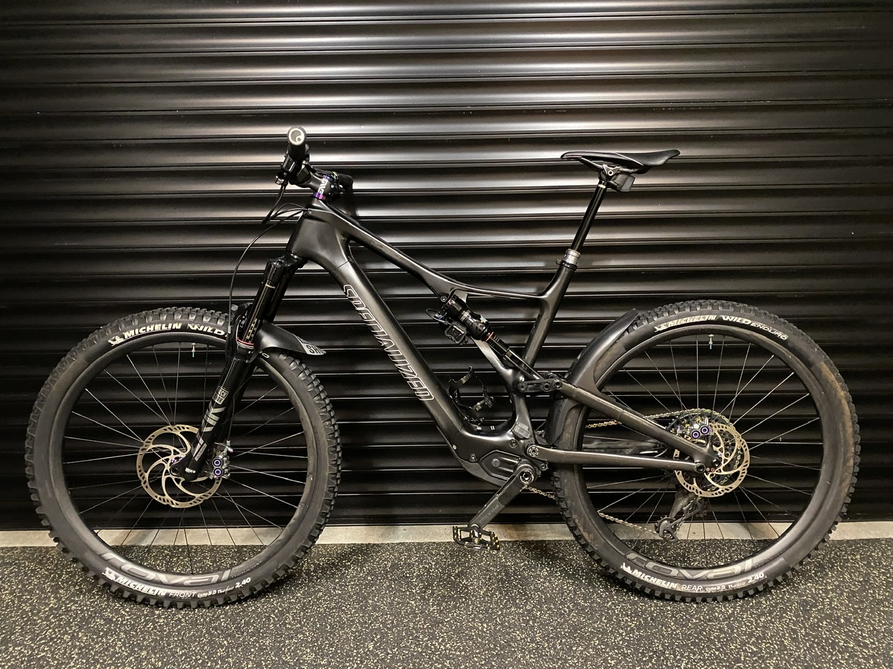

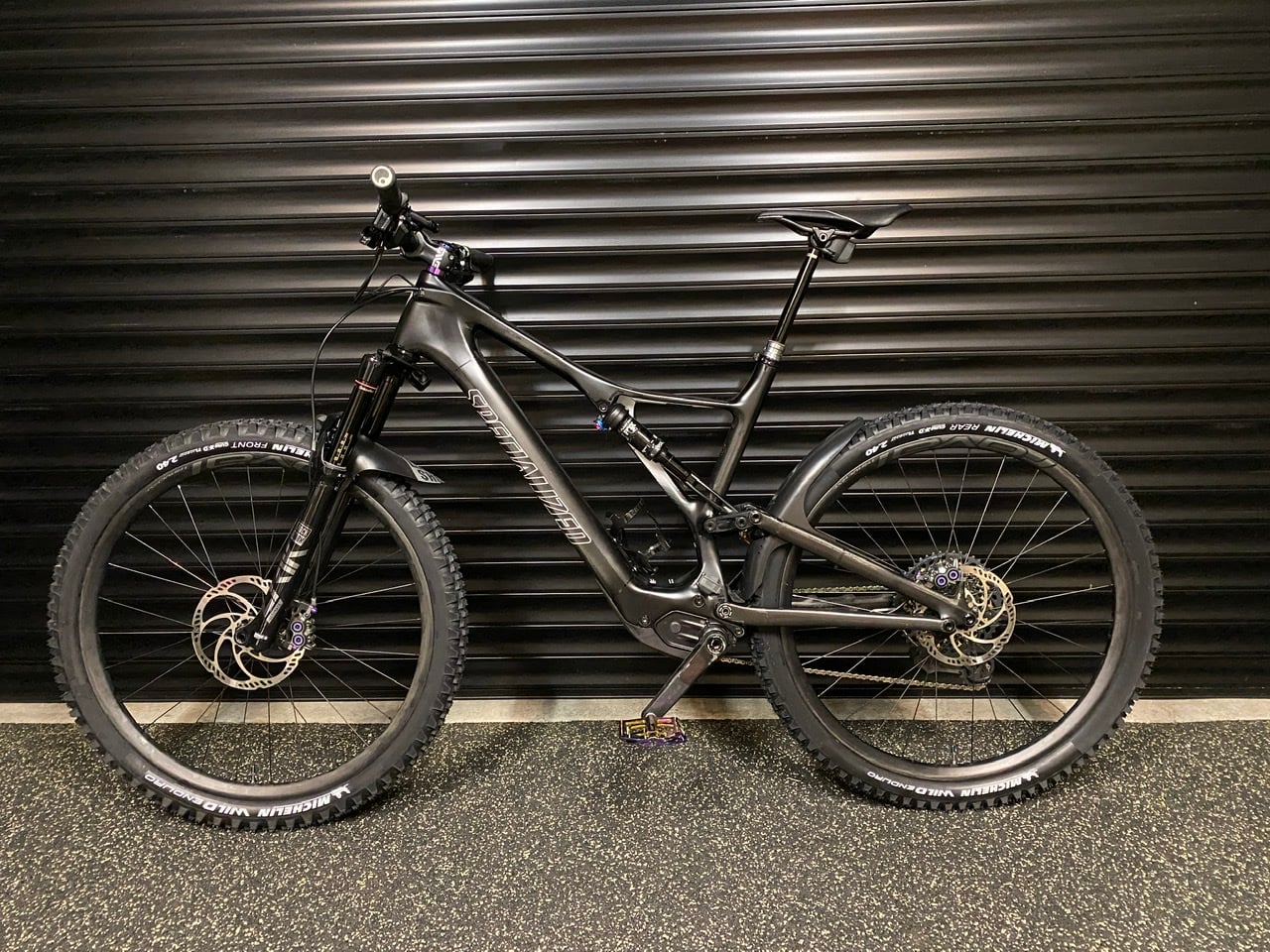

I’ve got a test ride thread out here somewhere that has details of my build in it - but here’s the info in an easier to read format rather than spanning over loads of posts...
My Bike:
Specialized Levo SL Expert - Size XL
What’s changed:
Full Invisiframe kit
SRAM XX1 AXS derailleur
SRAM XX1 cassette
RockShox Reverb AXS 170 x 34.9mm dropper post
RockShox Lyric Ultimate 160mm 51 offset fork
ENVE DH Carbon bar
ENVE 55mm Carbon stem
Magura MT7 brakes
Magura Storm HC Rotors (200mm + 180mm)
Magura Carbon levers
Specialized Phenom S-Works saddle
HT Components ANS-10 Supreme pedals
Ergon GE1 Evo Grips
Maxxis DHF 29 x 2.5 front tyre
Maxxis DHR II 29 x 2.3 rear tyre
Muc Off 45mm tubeless valves
Mudhugger FRX mudguard (trimmed) at rear
Some cosmetic changes - Magura purple rings for the brakes, some titanium iridescent screws dotted about... and iridescent headset spacers.

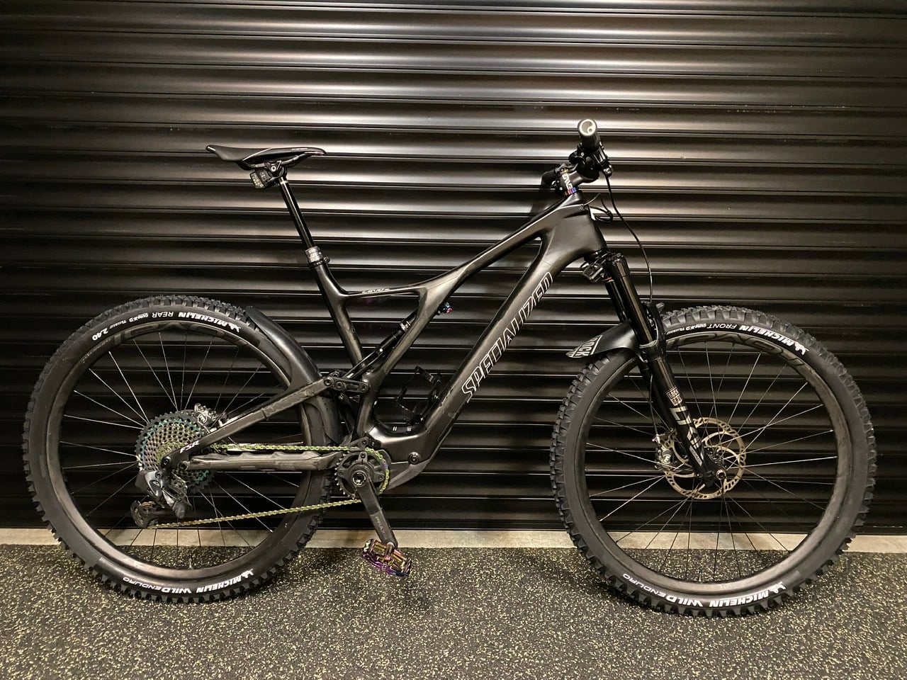

Here’s a what and why of my changes so far - and the difference in weight:
Invisiframe: A necessity to keep the frame in A1 condition.
+60g (approx)
SRAM Eagle AXS XX1 Upgrade kit: I had the AXS shifter on the Rail and loved the instant precise shifting.
Eagle GX derailleur / shifter / cable = 471g
AXS XX1 derailleur / shifter / battery = 445g
-26g
Enve DH Carbon bar: ‘Borrowed’ from my Stumpy.
Specialized alloy bar: 366g
Enve DH Carbon bar: 229g
-107g
Enve 55mm Stem: Also ‘borrowed’ from my Stumpy.
Specialized alloy stem: 153g
Enve carbon stem: 88g
-65g
I weighed the Specialized SWAT headset tool - which would remove another 133g... but I quite like it, so have left it for now.
Magura MT7 Brakes: Stopping power of stock brakes was lacking, and faded really quickly under intense use. Magura’s seem to have a lot more bite to them.
SRAM G2 RSC front brake assembly (short hose) = 287g
Magura MT7 brake assembly (uncut hose) = 242g
-90g (per pair)
Magura Storm HC Rotors: Recommended to go with the brakes. I don’t think a ~17.5kg bike really needs specific eMTB rotors.
SRAM 200mm front rotor = 192g
Magura Storm HC 203mm rotor = 171g
SRAM 180mm rear rotor = 145g
Magura Storm HC 180mm rotor = 140g
-26g (per pair)
Magura Carbon Levers: Changed for to Carbon as I have Raynaud’s Syndrome (perpetual cold hands / fingers). Carbon doesn’t get nearly as cold in extreme temperatures, so will help my fingers stay warmer! They also feel nicer to touch!
Magura Alloy Lever = 30g
Magura Carbon Lever = 17g
-26g (per pair)
Rockshox Lyric Ultimate 160mm: Not a fan of the stock fork. The Lyric Ultimate offers more tunability and a smoother ride... and the extra 10mm slackens the front end a little.
Fox 34 Performance 150mm = 1926g
Rockshox Lyric Ultimate 160mm = 1998g
+72g
Maxxis Minion DHF (29 x 2.5) and DHR II (29 x 2.3) tyres in Max Terra 3C compound: Set up tubeless with Muc Off valves and Stans Racing Sealant.
-250g (approx - for removing tubes, but adding sealant / valves and fitting a slightly wider front tyre)
Rockshox Reverb AXS 34.9 x 170mm: The best dropper post out there bar none! Had this on my Rail and thought it was fantastic. Can drop a few mm by tapping the button when sitting on the saddle.
X-Fusion Manic 34.9mm x 170mm dropper with cable and lever = 752g
Rockshox Reverb AXS 34.9mm x 170mm dropper with battery and wireless lever = 879g
+127g (but well worth it!)
MudHugger FR front mudguard: Trimmed to fit at the rear. Not going to save my ass, but will stop the linkages and hopefully the dropper getting clarted. Essential in Scotland!
+75g
SRAM Eagle XX1 Cassette: After fitting the iridescent Muc Off valves, I looked for other iridescent / rainbow / oil slick / jet fuel parts. The XX1 cassette / chain were mesmerising to look at. Shifting performance is slightly better too.
SRAM Eagle GX Cassette = 451g
SRAM Eagle XX1 Cassette = 368g
-83g
SRAM Eagle GX chain to XX1 chain
-5g
Ergon GE1 grips with iridescent fixings: comfier than the stock grips, and look good.
Specialized stock grips = 54g each
Ergon GE1 grips = 50g each
-8g
Specialized Phenom S-Works Saddle: I have the Phenom Expert on my stumpy, and have been happy with it for years. The S-Works is a bit lighter due to carbon rails, and offers the same padding. I can go day after day on this and not feel like by ‘barse’ (my mates name for the bit between balls and arse) is sore! £230 retail, but managed to pick one up on eBay (brand new - taken from a new Diverge S-Works) for £110.
Specialized Bridge Comp saddle = 258g
Specialized Phenom S-Works saddle = 148g
-110g

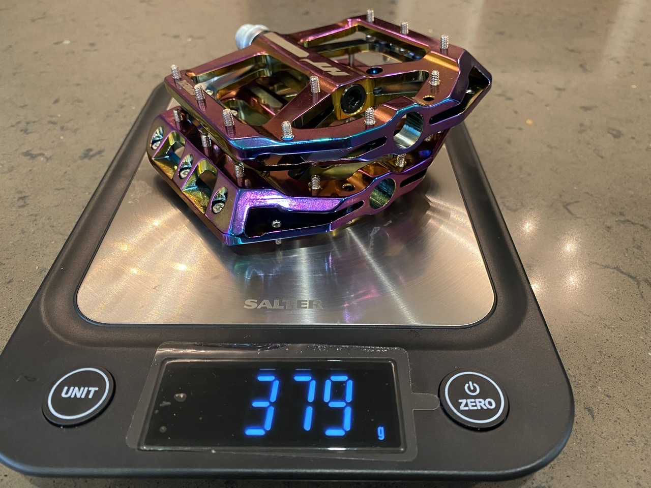

HT Components ANS-10 Supreme pedals: I did have DMR Vault Mg pedals on for the first few rides. Great pedals at a good weight. I wanted something iridescent to add a final touch of sparkle - so went with the HT’s. The Vault Lacun’s were iridescent too - but added about 80g. The HT’s only added 6g on paper - or 7g in real life!
+379g

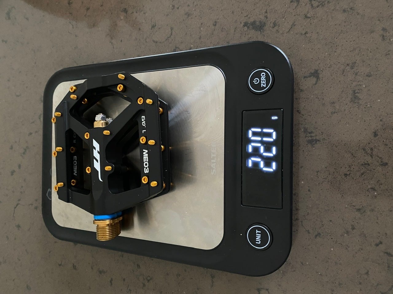

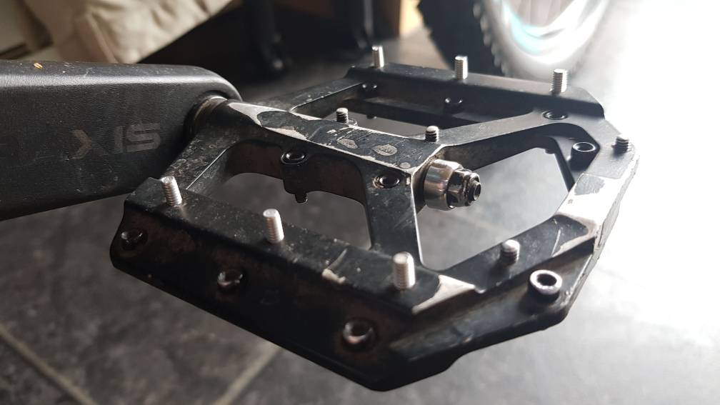

Swapped my pedals over after my oil slick ones started flaking paint off.
Went with new HT Components ME03T, which are a super light and thin magnesium pedal, with titanium axels.
159g saved there... and hopefully the thinner profile helps with pedal strikes. I’m still waiting to get my 165mm carbon cranks, which will give me a fraction more clearance too.
Good luck with those. I had 3 pairs go within about 18m. They then suggested I use the alloy axle instead as it's tougher. They lasted about 6 months as well. They do look the part though and super light.
They come with a 2 year warranty. Good job I have a couple of pairs of spares from the sound of it... can swap them over when they’re back getting repaired ?
The alloy axle version is about 260g if I remember correctly? Still really light.

Yeah they got fed up of me returning them. Hopefully you have better luck than me. Best looking pedal out there IMO. And super light. Yeah even the alloy axle is light.
I removed the small pins and replaced with the larger ones in the spare set for a bit more bite.

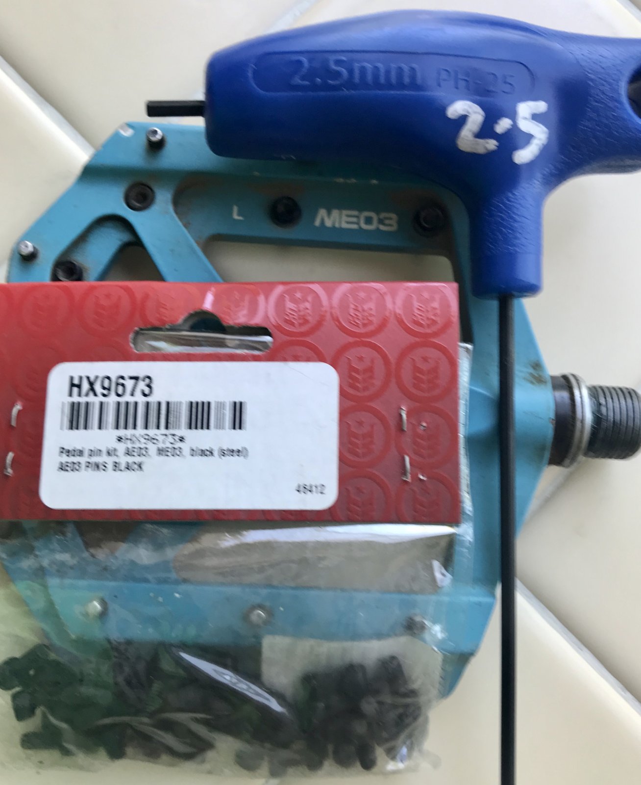

I removed the small pins and replaced with the larger ones in the spare set for a bit more bite. View attachment 36143
Rode with them today, and they seemed to grip my 5:10’s well enough. It was a lot of trail riding, so they might not grip so well on some rougher stuff?
I was going to see if I could order Oil Slick pins for them, as I’m not a fan of the gold. They’re not M2.5 or M3, so must be an imperial size somewhere in the middle?

@p3eps Are you sure a 2.5mm hex doesn't work? That's what the pins my old set of ME03s took.
Here's the part info for black replacement pins:
and like @All Mountain Coaching I had to fuss with the bearings on mine to keep them spinning smoothly.
(However, I don't like using longer pins - the short ones "bite" me often enough!)
I took home some different hex bolts from work, and the corresponding nuts to go with them. The thread of an M2.5 nut is really loose on my spare pins, and the M3 nut wouldn’t go on.
I’ll take a spare into my metrology guys tomorrow and have them measure the thread size / pitch properly with a shadow graph.
It has 2.5mm Allen head, but I don’t think it’s a metric screw.

The pins in the pedal are 4/40 UNC thread. Small ones are 1/4” long, and the long ones are 3/8” long.
I imagine the hex head is not quite 2.5mm either, and is probably the imperial equivalent?

p3eps
Dec 14, 2019
1,931
2,324
Did you ever get your carbon cranks? I just picked up an Expert and I'm curious how much weight they will save.
Turned out the ones they’d ordered me were just Levo cranks, and the SL ones are STILL not available in the UK yet.
Due in September.
£280 for 100g is quite good value based on some of the things I’ve bought over the last few months!

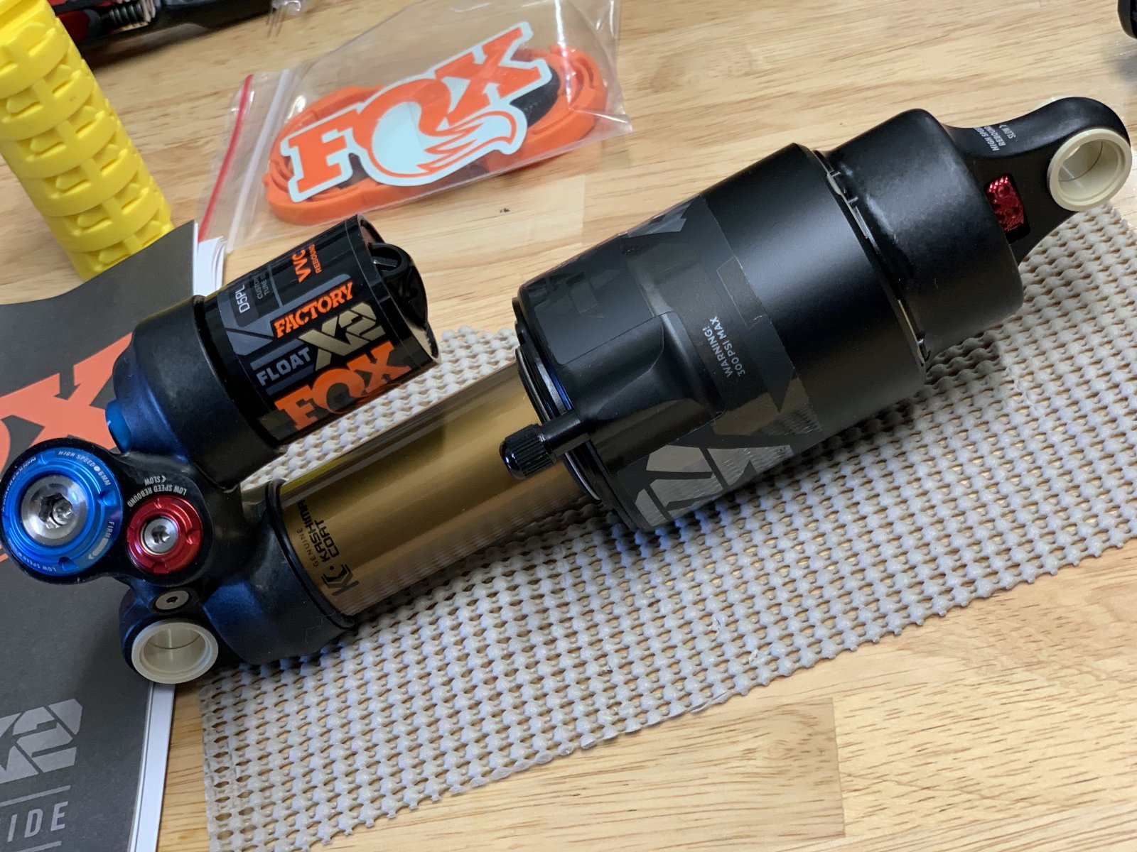

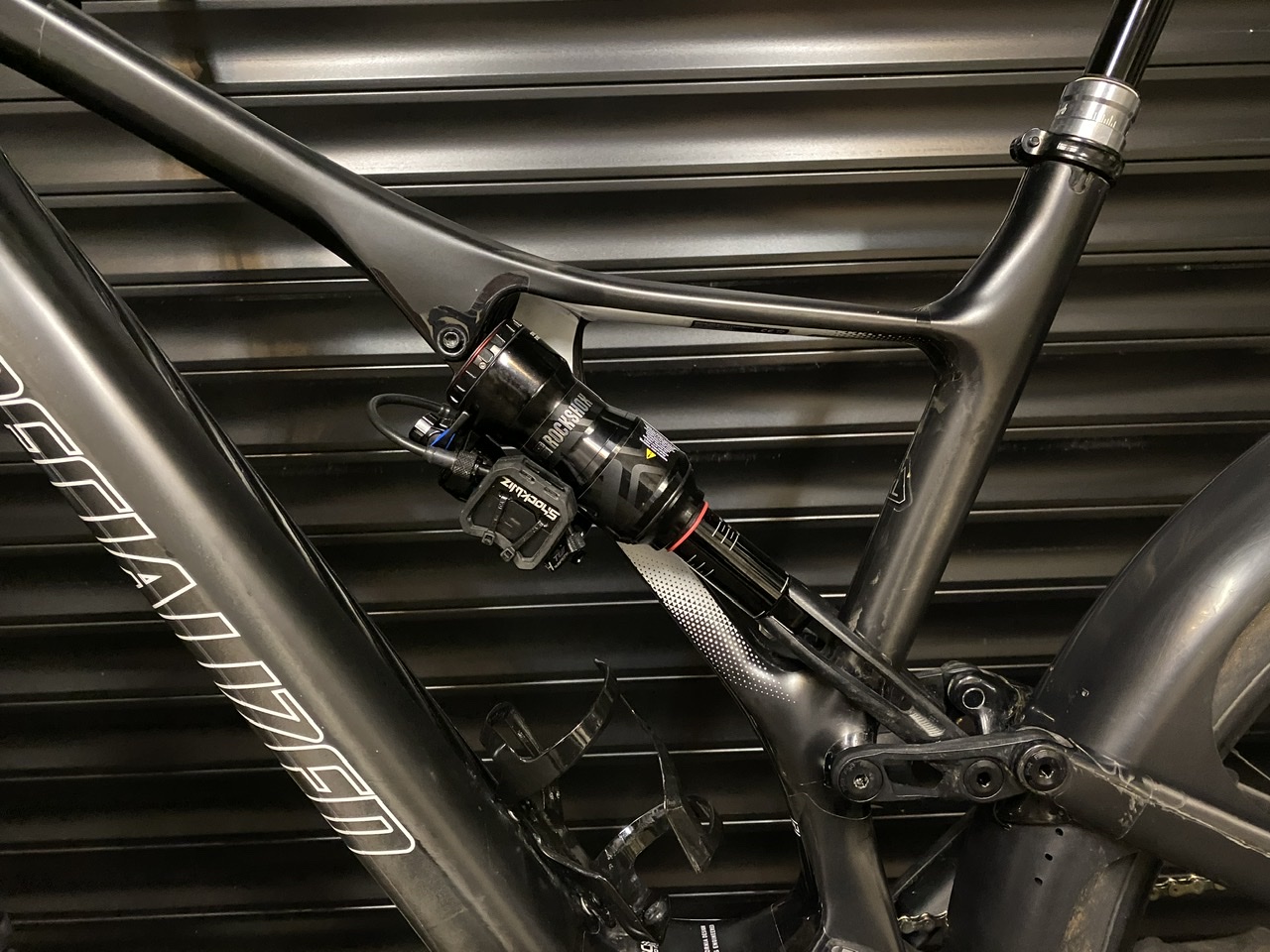

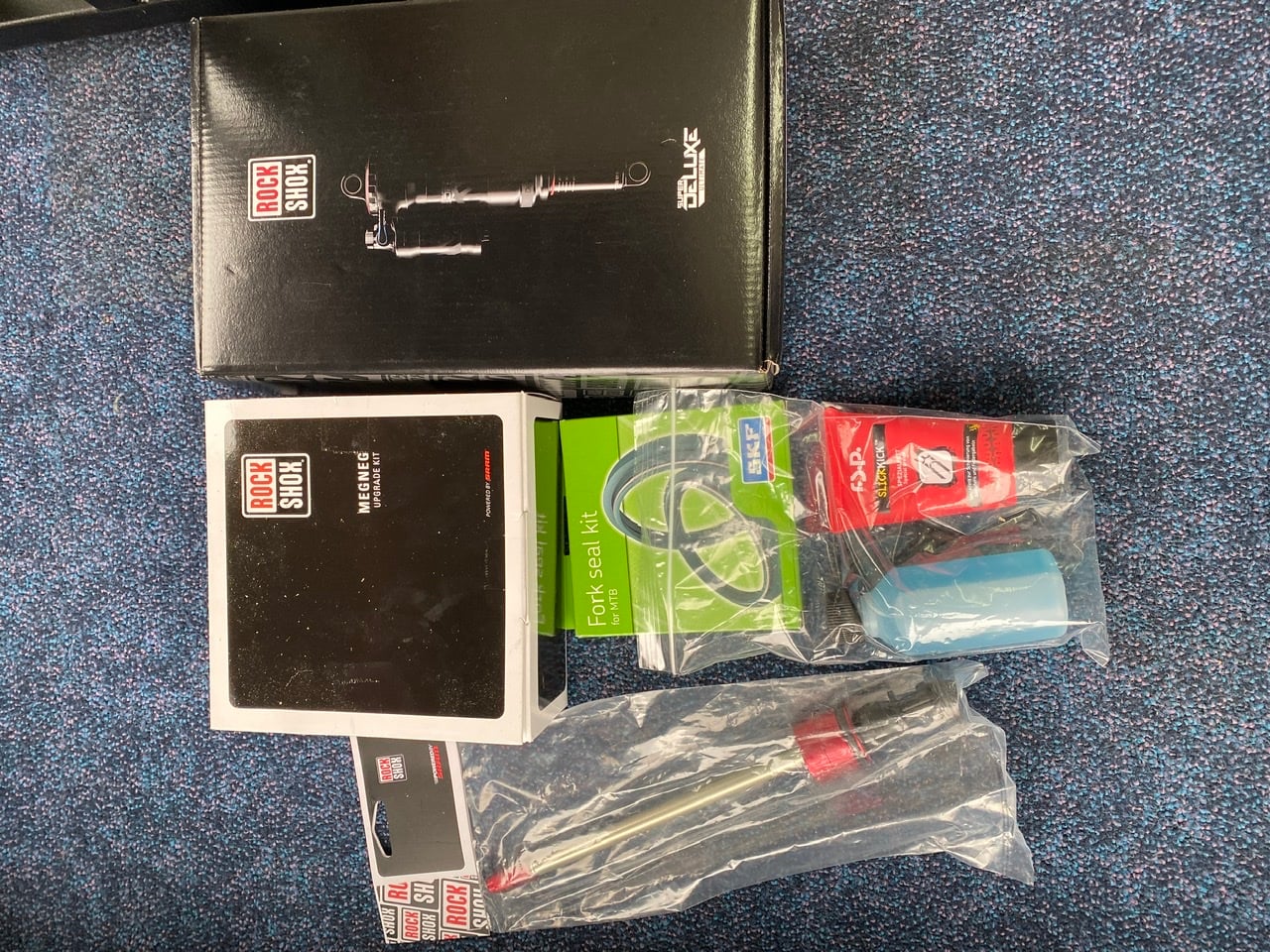

Some goodies arrived at work today...
2021 Super Deluxe Ultimate with Megneg installed / tuned.
2021 Lyric damper, and seal kit / oils etc to service whilst upgrading.
Should get the shock on tonight to test over the weekend, but the service of the Lyric will probably have to wait until next week.
Quite excited to see how it changes the bike!
p3eps
Dec 14, 2019
1,931
2,324

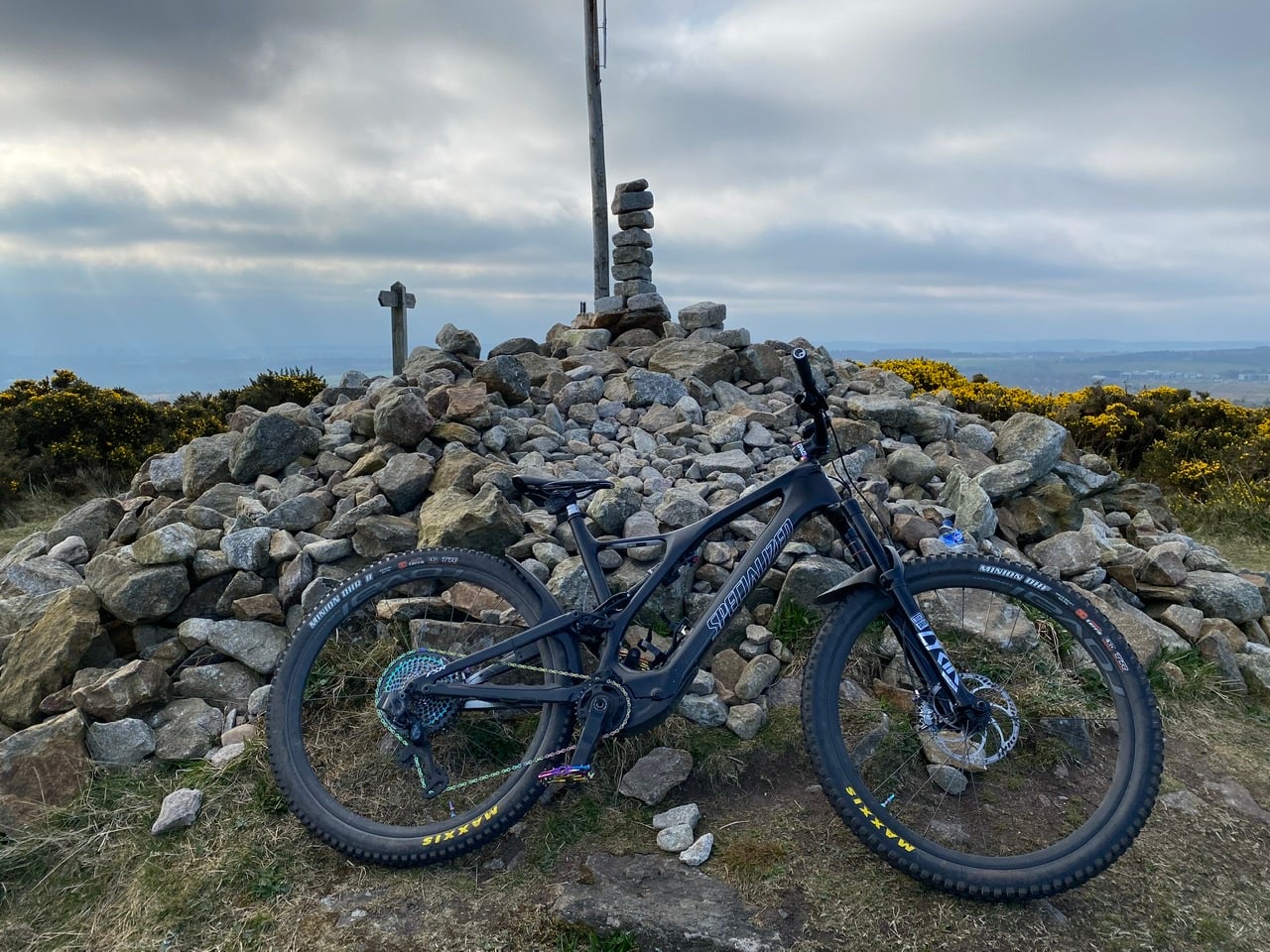

Fitted the Super Deluxe Ultimate last Friday when I got home from work. Was due to go for a ride on Sunday, but did my back in playing golf on the Saturday! Properly ruined, and I lay in the fetal position all of Sunday / Monday as it was the only thing that eased the pain!!
The bike has sat with the shock on for over a week teasing me. Although my back is still not 100%, I thought I’d take the bike for a gentle ride today.
We’re back in Covid lockdown again (although it’s lifting at midnight today ?), so I couldn’t go too far anyway.
Some roads, some fire road type trails, and a little bit of single track. Nothing particularly wild, but I’m really pleased with the shock so far. I no longer feel like I’m riding a bucking bronco when riding over rooty and rocky paths!
Looking forward to getting it out on some ‘real’ trails... hopefully next weekend. By that time, I’ll hopefully have done my 2021 damper upgrade to the Lyric too.
As things stand, the only original parts of the bike are the frame, wheels and cranks... although the cranks will be changed as soon as the Praxis carbon are available in the UK. Due beginning of Sept apparently ?
