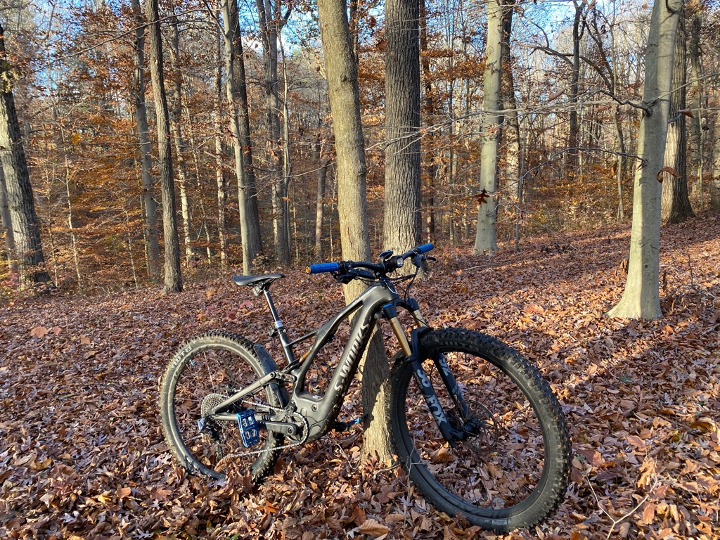

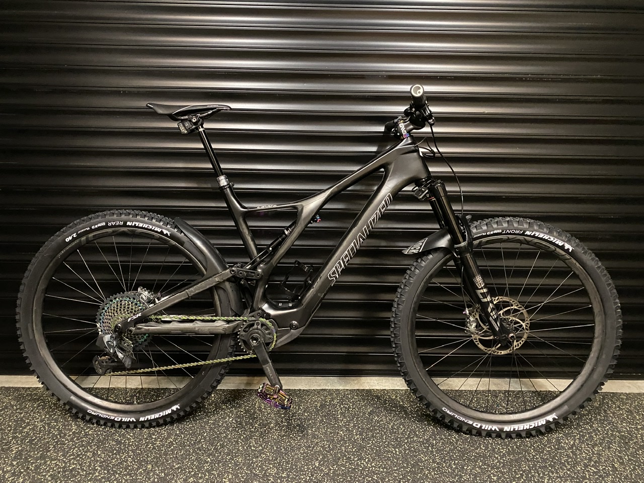

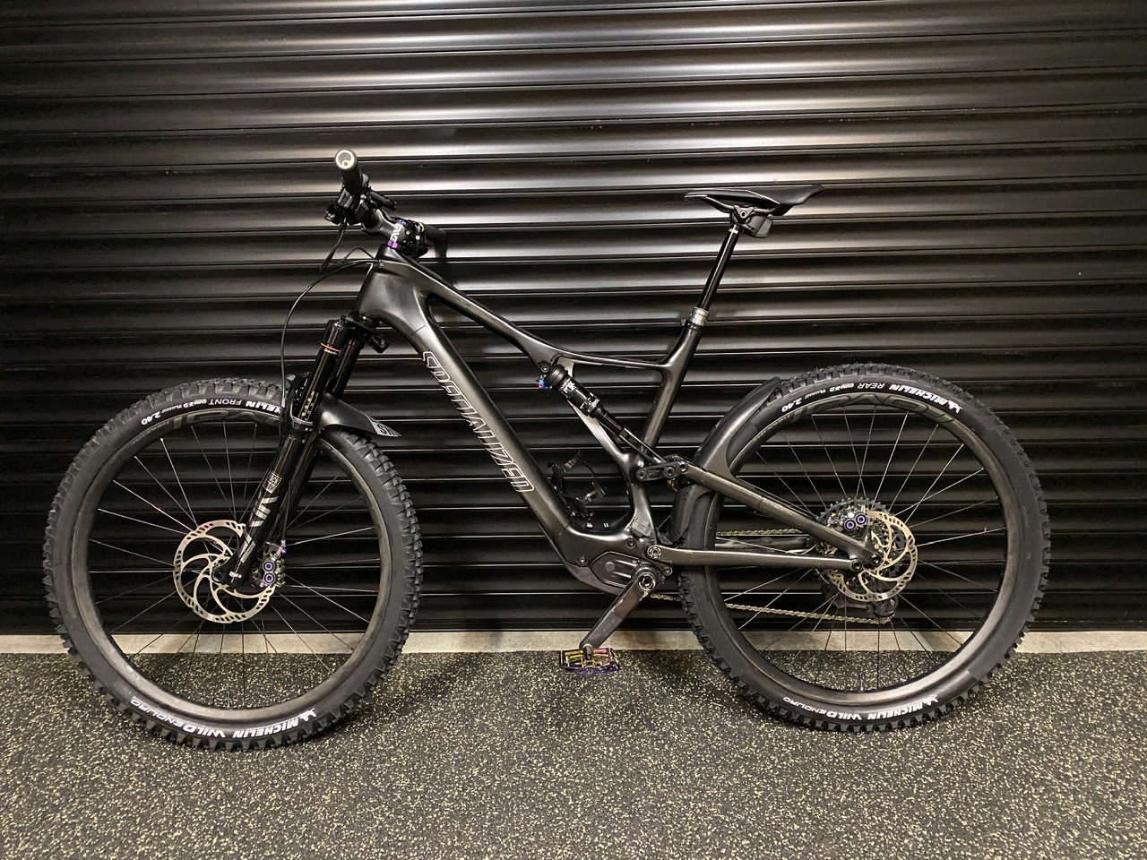

Some new boots on tonight.
Funny how some white decals on the tyres make the whole bike look better!
Michelin Wild Enduro Front and Rear - both 29 x 2.4. Will see how they ride at the weekend.
View attachment 31172View attachment 31173
Out of interest did you get the matte invisiframe kit? Like the Finish of that carbon... do you think you could get 2.6 E-wilds on the back?
I went Matte.
Plenty of people with a 2.6 on the rear with no issues. The SL isn’t heavy enough to warrant an ‘e’ specific tyre though.
Thanks. Of course I forget the lighter weight removed the need for that- presumably the front forks are not E-MTB specific then either?

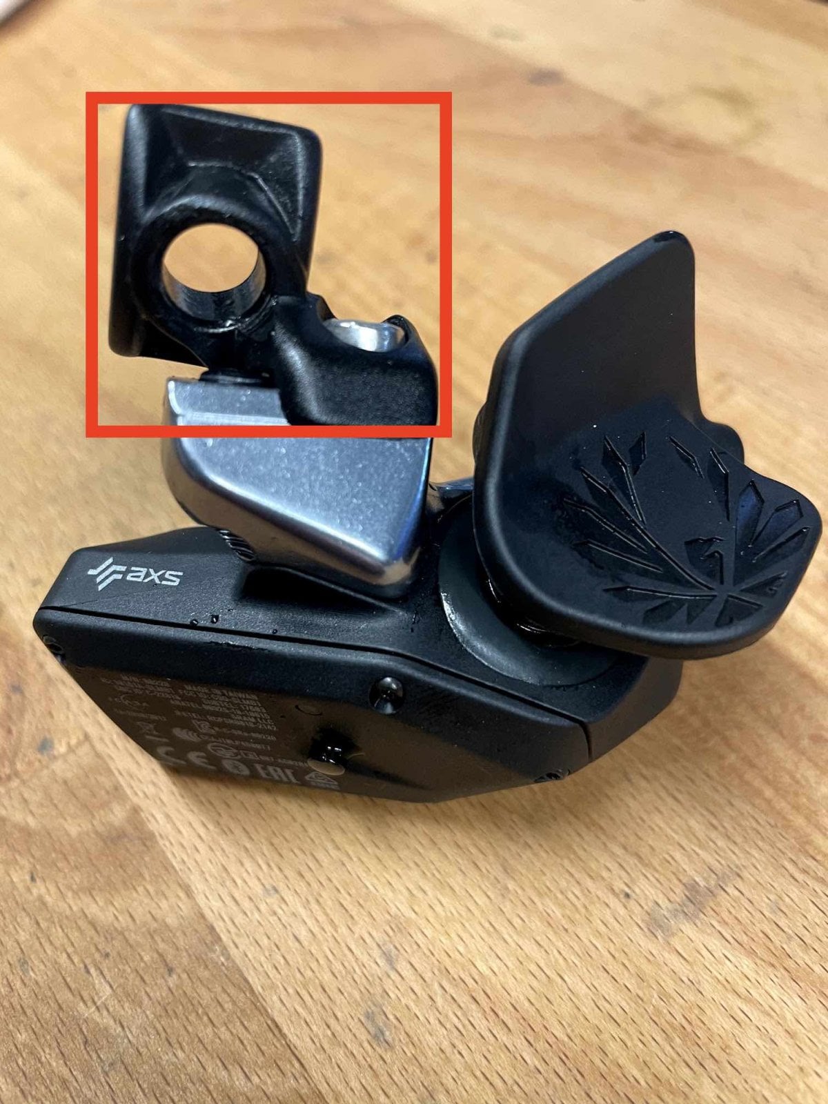

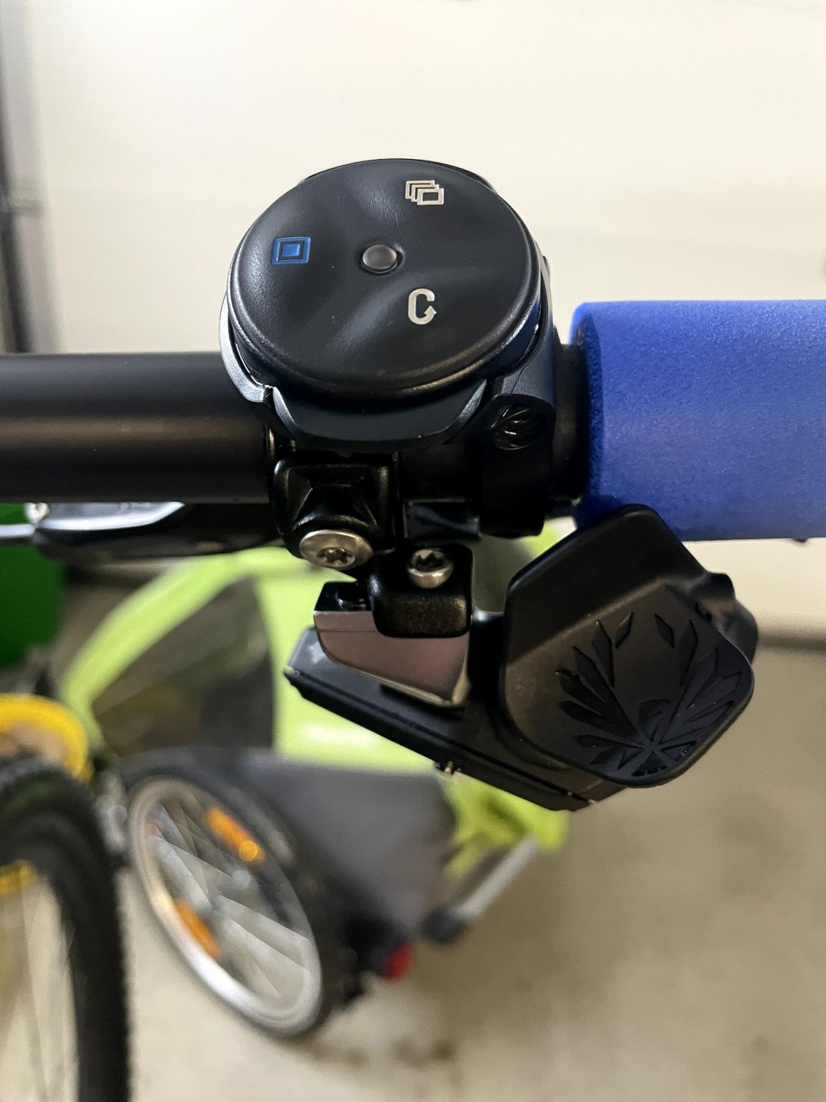

Hi,
I did install a cupple weeks ago an SRAM AXS Upgrade kit. But now, the controller interferes with my ergonomics because it is positioned too far to the right.
Is this attachment (marked in red) also available for the left (inner) side? If so, what are you looking for? Where could I buy this part?
Thanks in advance for your help.
Hi,
I guess it matters what brakes you have. I am running Shimano XTR brakes with AXS dropper and derailleur so I ended up getting these...
Bike Yoke I-Spec EV Adapter for Triggy, Right
Bike Yoke I-Spec EV Adapter for Triggy, Left
from Bike Yoke I-Spec EV Adapter for Triggy, Right
thanks...for that fast response
I use the original Levo SL Expert brakes SRAM G2 RSC...I think, the Matchmaker X is the right part.

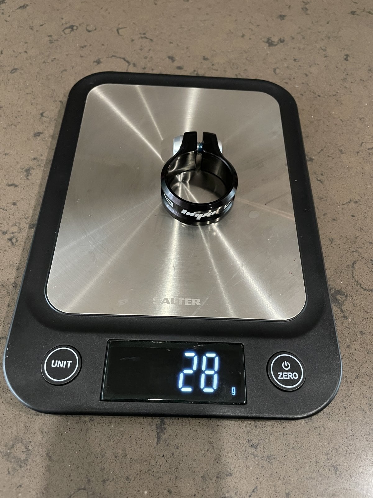

Got on my bike at the weekend, and heard a loud ‘crack’ noise from behind me. When I turned round to see what it was, my seat spun with me.
Turns out my seat post clamp had snapped. Not sure how, cause I haven’t touched it for about 8 months?!
A bit of a panic, as I called 2x LBS’, and neither had an oddly sized 38.6mm one in stock.
With it being Christmas, Tier 4, and having 12 days off, I thought I’d probably want to use my bike... so I managed to find a Hope 38.5mm one in stock, and paid for a next day delivery.
It arrived today, and I was surprised at how heavy it was. It feels thicker aluminium than the stock one... but it has a huge bolt, so is nearly double the weight.
It’ll do for now though, as I’m sure an extra 13g isn’t worth crying about!

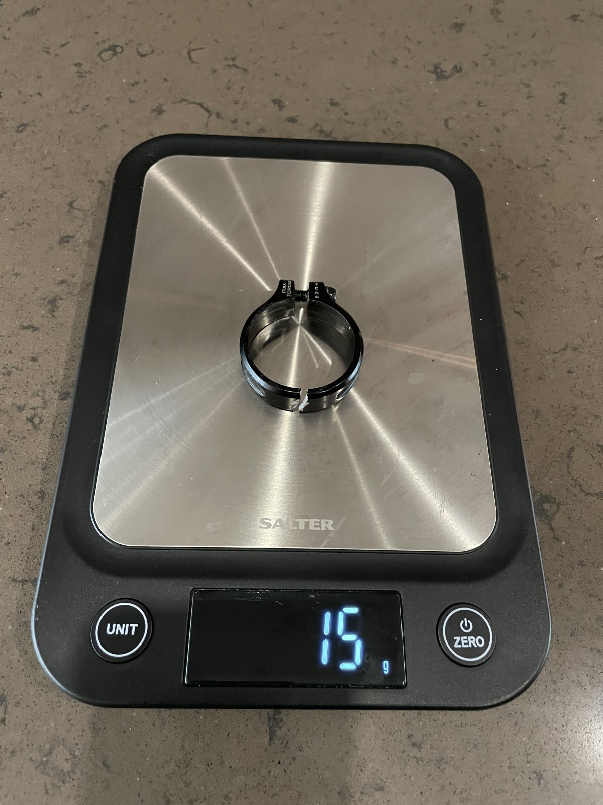

The Wolf Thooth Seatposts are just 21g in Size 38.6mm. So you could safe 7g against the Hope. If you buy 2, then 14g ;-)
I couldn’t find one of them in stock or available for Christmas, which is why I went with Hope.
I like your thinking. Maybe if I buy a whole box of them, I could save a KG ?

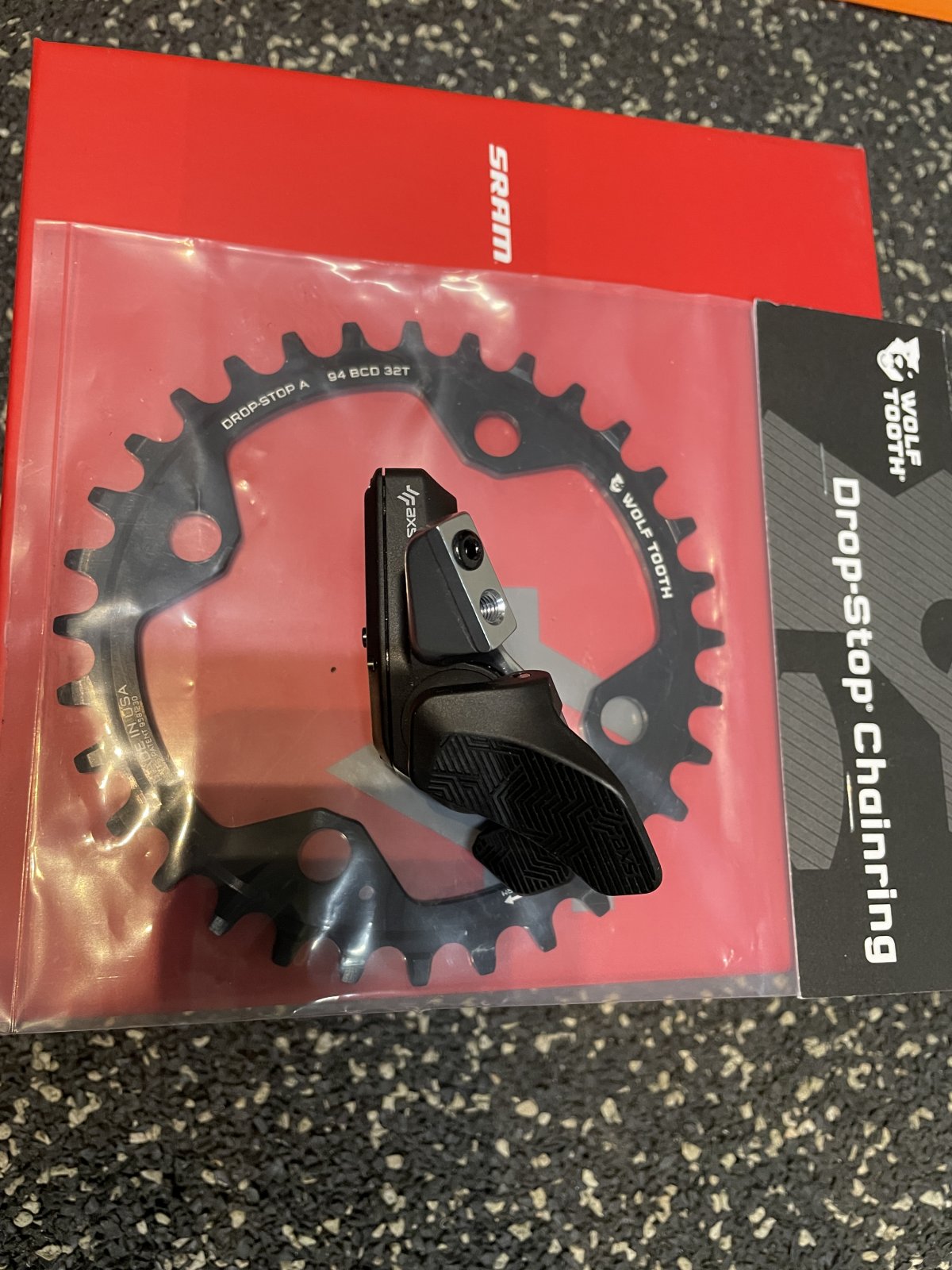

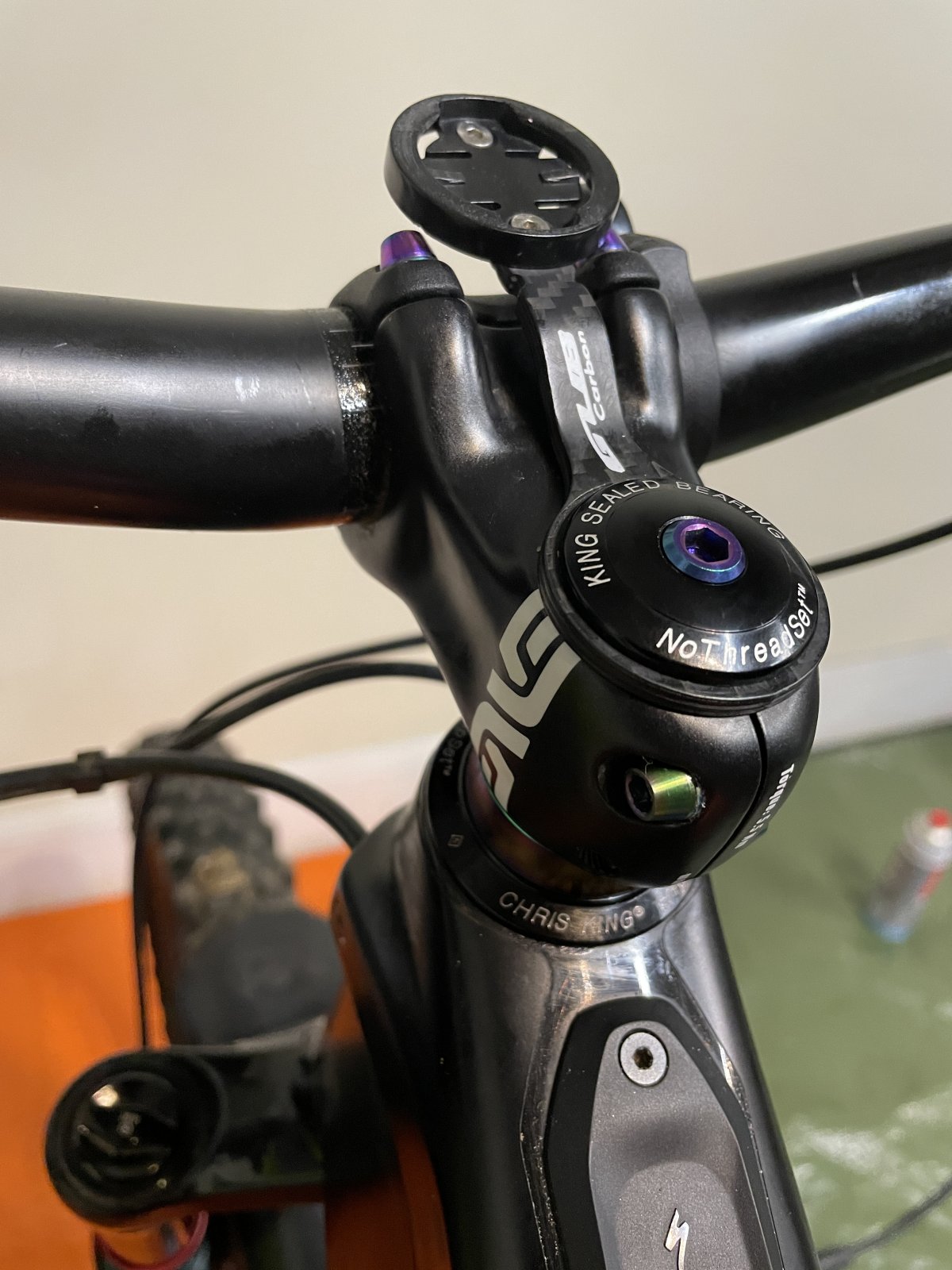

A couple more mods to the bike over the last few days.
Fitted a Chris King Dropset 5 tonight. In doing that, I’ve removed the tool / mechanism in the steerer, so will have knocked a few g’s off the overall weight! The old bearings were pretty knackered and feel pretty gritty.
My chain snapped a few weeks ago. Ordered a new XX1 rainbow chain, and fitted it. The gears kept skipping when under mood. I wondered if it was because the chain length had changed slightly due to it being new, but it turned out it’s just down to a few worn teeth on the cassette. I thought I’d been maintaining it very well - regular lube, cleaning and occasional soaks in the ultrasonic bath at work... but obviously not well enough! I’ve ordered a new XX1 rainbow cassette, but this time I’ve taken the 52T one.
I’ve bought a new Wolftooth 32T chainring too, which will hopefully give me a bit more speed... but with the 52T cog, I shouldn’t lose much of the bail out gear.
I’ve also ordered another XX1 rainbow chain, and am going to rotate the pair of them every 150 miles. Not bike related, but I’ve also bought a whiteboard to put up on the garage wall to write my bike maintenance schedule on to remind me what’s due when!!

I have been running an AXS GX shifter (controller) for the last month as my XX1 one died inexplicably. It went away for a warranty replacement too, and was also out of stock (hence why I bought another). It arrived back on Thursday (took about 5 weeks), and I have received the new style one which doesn’t have the ‘paddle’. It’ll be interesting to see how that is and feels after using the paddle one for over a year.
