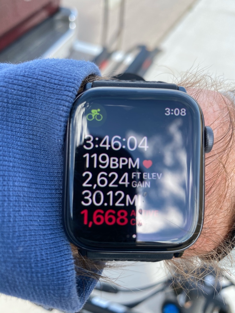

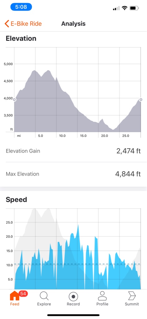

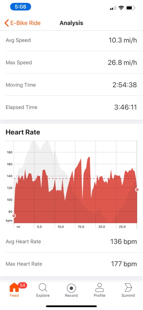

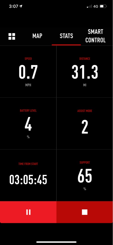

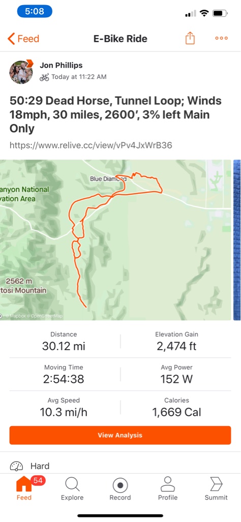

With this fast rolling, low drag config, main battery only:
30 miles
2500’ climbing
Power: 40/100 for the full ride except 4 miles at 60/100 which consumed 20% of the battery.
SL: I think 35 miles/3500’ Climbing is possible on just the main battery in this config.
SL: I think 45-50 miles/4500-500”’ climbing with 1x Extender at 40/100.
I will try for those and report back.

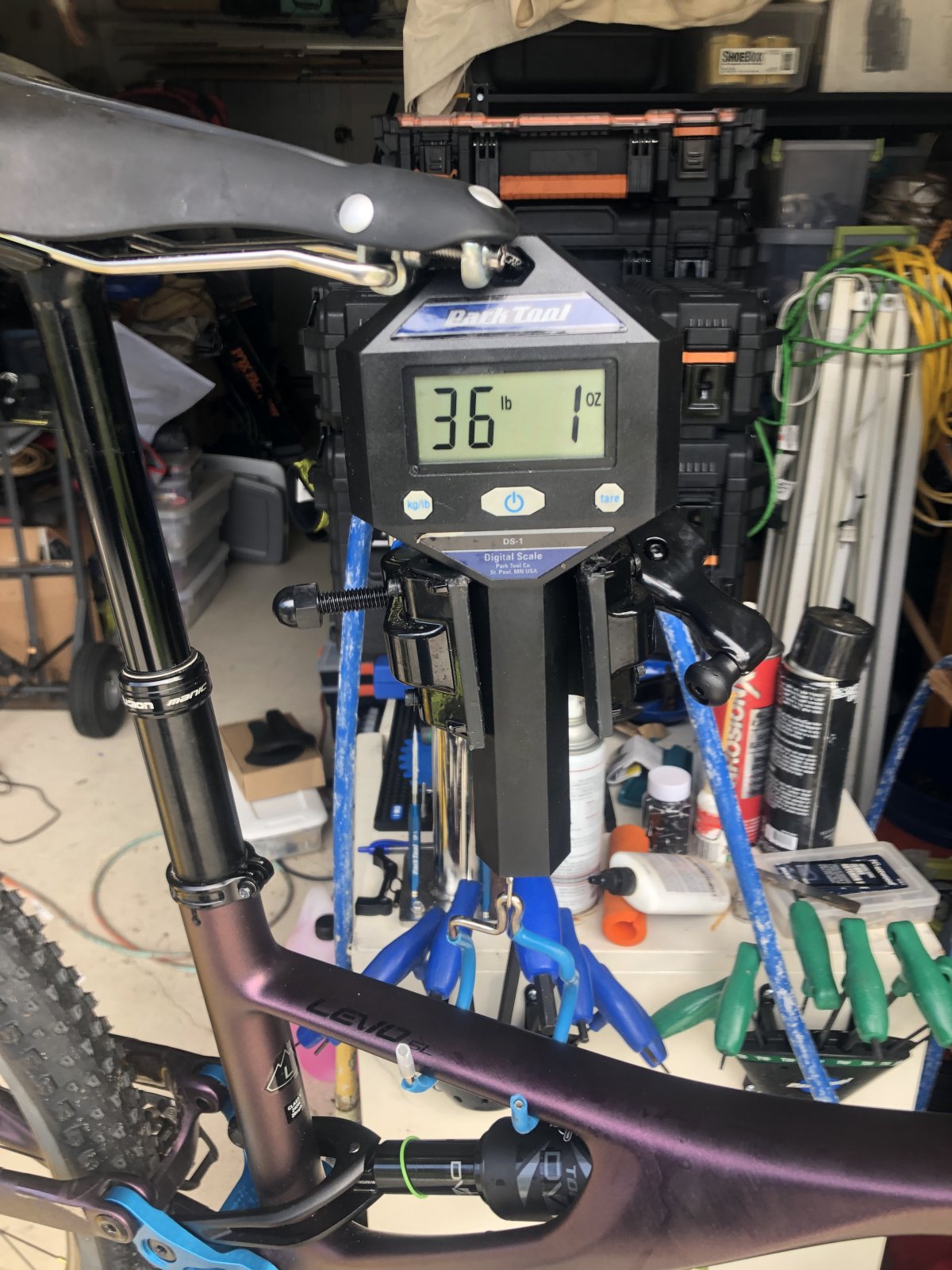

I ordered mine directly from praxis. XT build at 36.1 with tool kit and pedals
This thread is from about 5 months ago - when they weren’t available for general sale.
