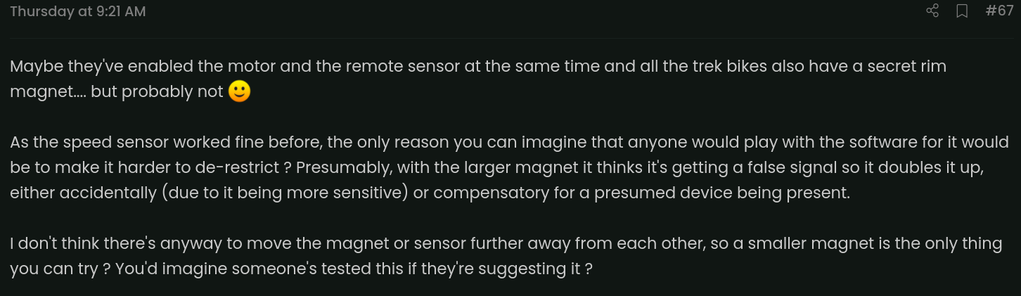

It's a possibility - obviously unlikely though. I'm sure people would have noticed if there was a magic magnet mounted somewhere inside their Rim's. Just drop your bike in a huge box of paperclips and see where they're attached to afterwards ;-)

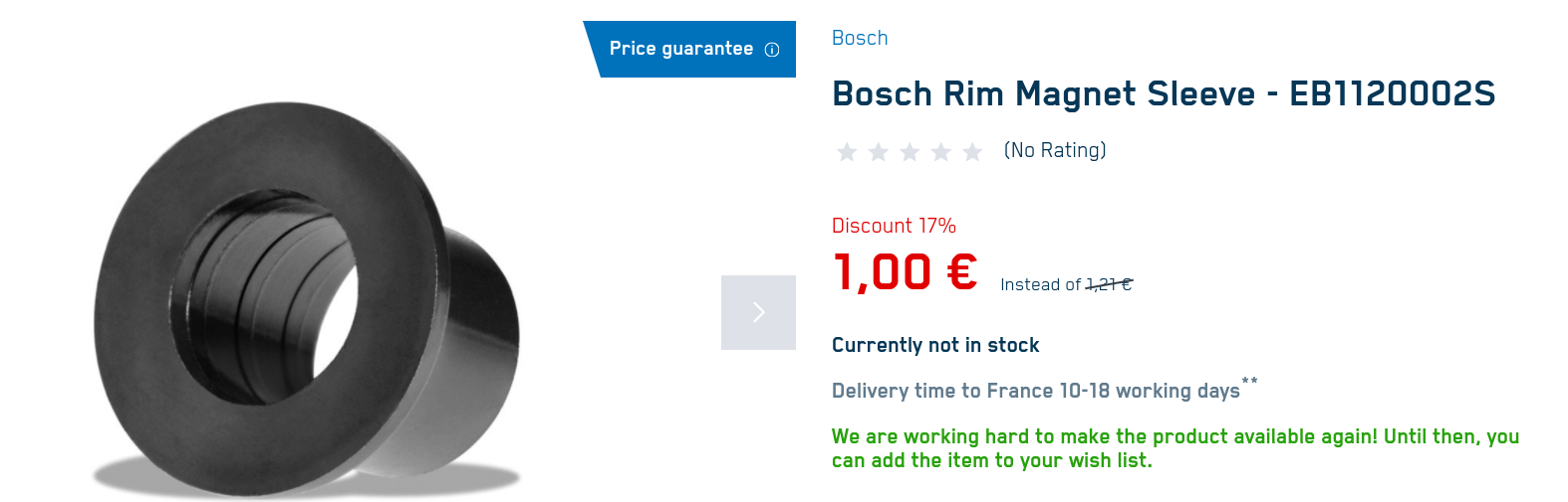

Remember, if you buy one of these magnets (EB11200015) and run a presta valve (Which you probably do), you also need the sleeve (EB1120002S):

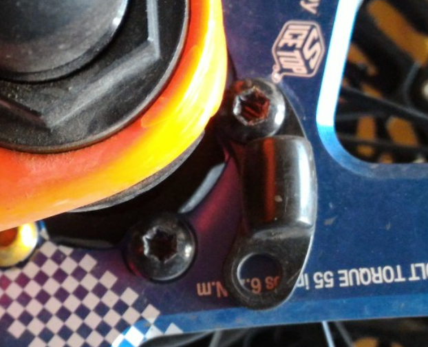

Another thing to try, which I know is grasping at straws again ..
But if the problem is from the system compensating because it thinks there is spurious/de-restriction data/echo, is to re-align your magnet, as conveniently demonstrated in this thread to save me any work .. :-D

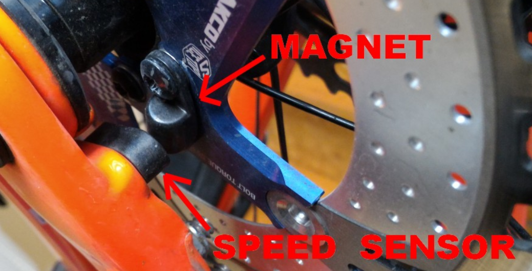

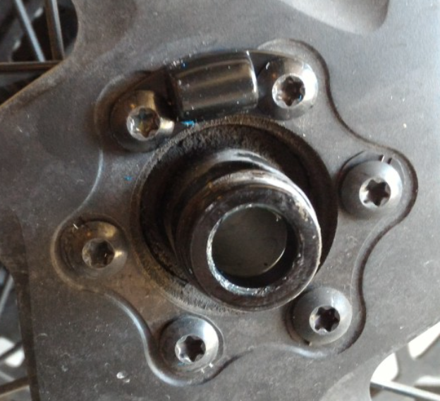

Standard fitting :
Modified install so the magnet runs directly past the sensor (you may need to put a washer behind the sensor so it cansit flush):

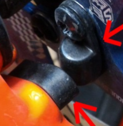

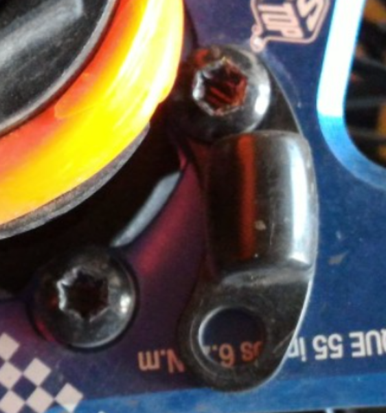

This relies on a larger magnet on the disk and an offset sensor. This must of complied with the Bosch system at the time, but with the latest update, it operates outside of the parameters.
I suspect with the offset magnet the system now reads a magnet arriving signal and a magnet departing signal so it's doubling up.
By rotating the existing magnet on one bolt to line up with the signal it should just receive a single clear signal. You could even just unbolt the Trek magnet and stick a magnet on the disk to line up with the sensor.
With the single bolt magnet mount or the floating magnet, you run the risk that it could move/dislodge, so ideally someone will make a triangular magnet mount to offset the magnet from the standard disk holes, or 3d print a cage (triangle with a round hole in it) to hold the floating magnet in place against the disk.
